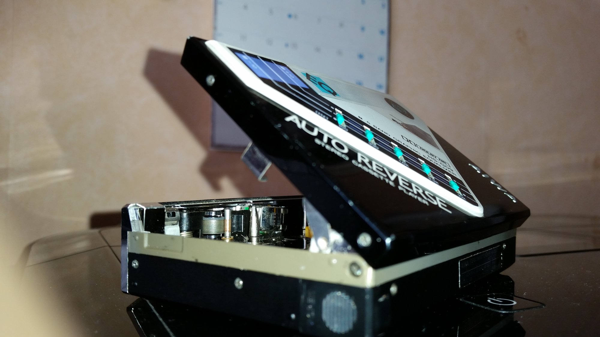

    Hi specialists,
    I have bought an Aiwa HS-G09,
    it looks great.
    A few problems :

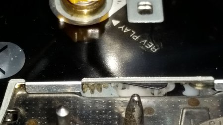

    - Crackling noise while turning volume dial, sometimes only left or right audio channel.
    - Autoreverse eats tape after a few seconds

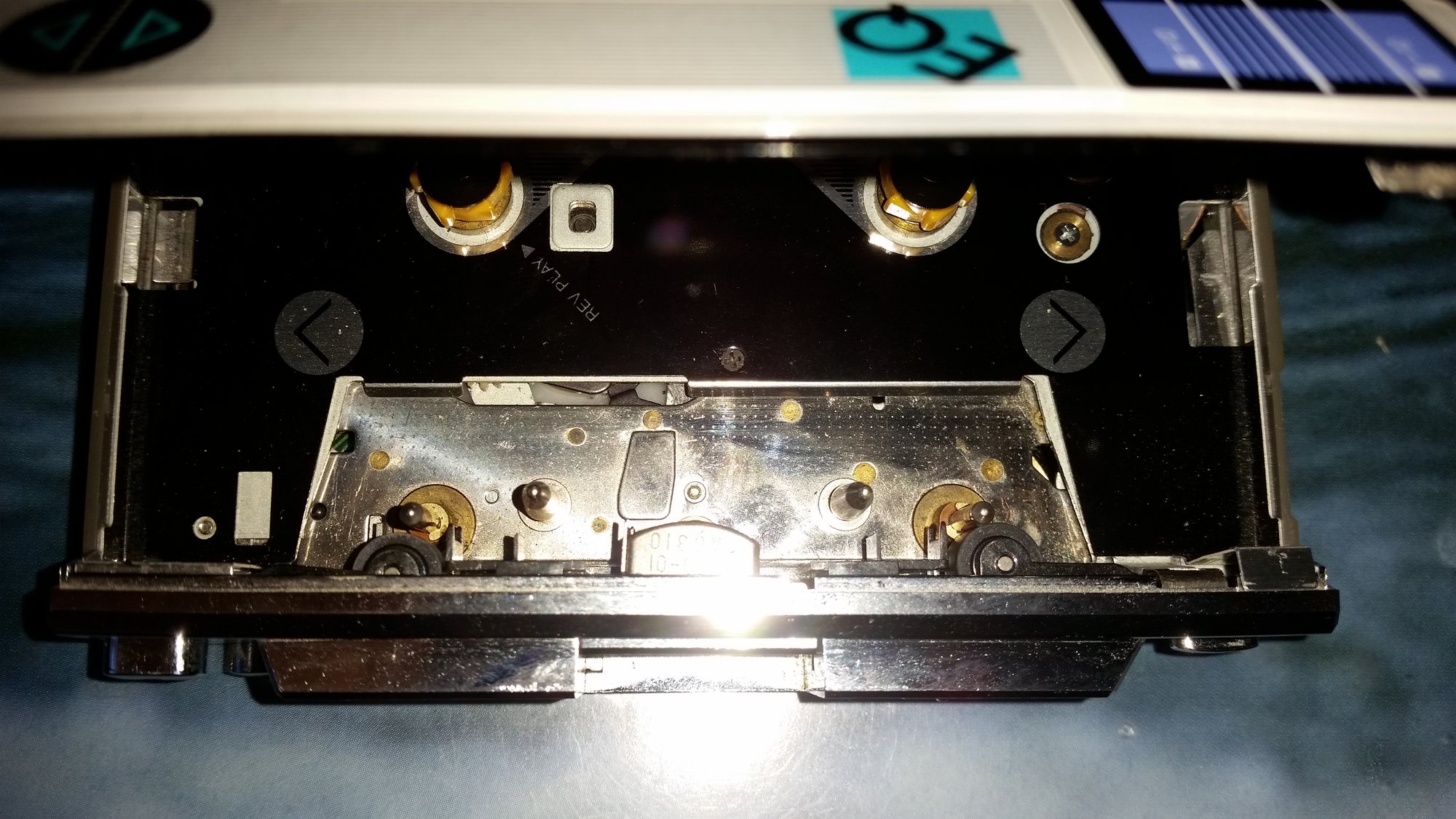

    Possible culprits for autoreverse :
    1) Right pinch roller touches metal turning pin when play button is pressed, left pinch roller does not and had a gap between pinch roller and metal turning pin
    2) 1st darker colored gear on picture doesn't turn at all, tried without tape , play, ff and rw. 2nd and 3rd white gear turn.
    Offcourse it's possible that the first gear does turn, but only with cassette inside and when autoreverse kicks in.
    Impossible to see.
    3) belt wrongly placed
    See pictures in the post below.
    4) tape head not horizontally alligned
    If you look close at the picture you will see the tape head is not straight/horizontal
    Maybe this has entirely nothing to do with autoreverse problems, but what do I know, right ?
    So I really hope this is enough info for the specialists in here to maybe offer any suggestions in helping me.
    I don't have a service manual,
    but I'm not sure it will even have info about how the auto reverse is supposed to work. Some exploded views and such perhaps, but other necessarey info maybe not.
    So maybe the service manual is a waste of money ??
    I hope that anyone assist me with these problems.
    Thanks in advance.

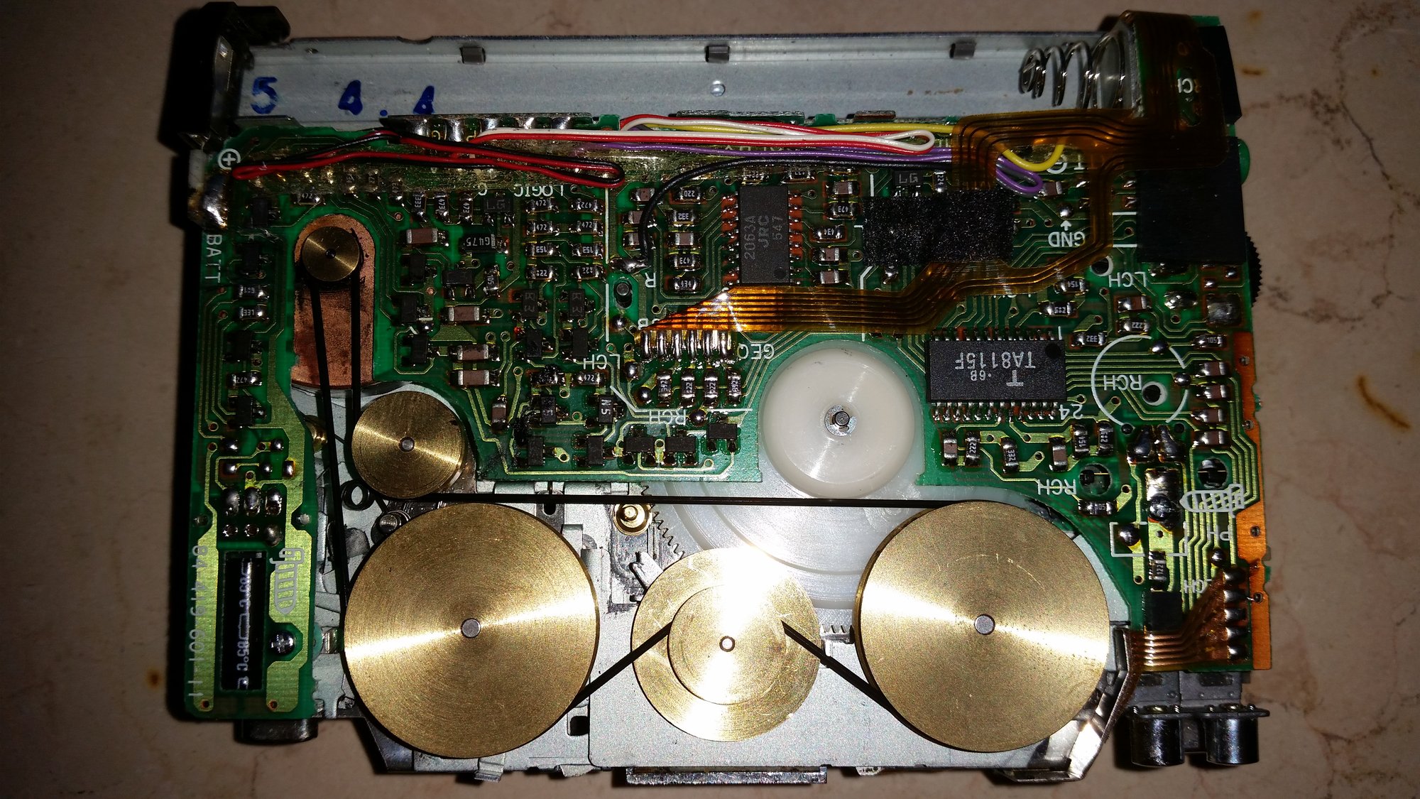

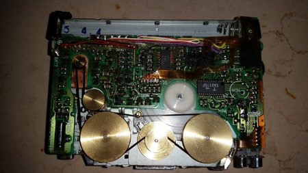

    I've managed to open the back and this is how the belt is positioned when I opened it.
    In the middle there's a metal pin, the belt doesn't touch it. Is this right ?
    Or does it need to be like this ?
    In my opinion the autoreverse problem is either because of the pinch roller not touching the metal turning pin or the first gear not turning at all, or a combination of the 2.
    Maybe there's supposed to be a second belt underneath the black plate ?
    I hope someone can shed some light on this problem.
    Is it possible to adjust the pinch roller ?
    And can I remove the black plate on the inside without trouble, so that I maybe can see why the 1st gear isn't moving ?
    Thanks in advance for the help.

    first picture is correct
    Pinch rollers. Only one pinch roller engages at a time, depending on the direction of play. Both Capstans will turn... but only one roller will engage with the capstan.
    If your tapes are getting chewed, first u need to ascertain the condition of the rollers? Are they matt black and rubbery, or hard and glazed, shiny or covered in tape crud?
    I use this stuff to clean and rejuvinate all my pinch rollers
    http://www.officenerd.co.uk/info/af...hTLSWJ8ODblb6SvTsivKuEAAmu6XNkmMaAr3aEALw_wcB
    It doesnt dry that quickly, and may require a few cleans, but really works great. Trust me, I have tried them all.
    Its also worth asking what tapes you are using that are getting chewed. Decent new old stock tapes, or old pre-recorded tapes? Do you get the same results?
    If you really want to see whats going on with the tape, I would suggest removing the lid. Then get an old blank tape and make some adjustments to the shell so you can see whats going on as you engage play.
    Is the tape nice and straight?
    Is it weaving?
    Are the tape edges catching any of the guides?
    16s likes this.

  7. doublecee
    doublecee Active Member
    378
    Earth
    My initial thoughts on this are as follows
    And please don’t take offence.....
    My worry is that if your struggling to comprehend the basic mechanics and premise of the Pinch roller engagement for autoreverse, you should perhaps step away and get this machine to someone who can repair it.
    I only say that because it’s a lovely machine (I have three) andnit would be a shame to see its condition worsen.
    As I said earlier, only one pinch roller engages at a time depending on direction.
    The action that facilitates this is a small series of arms and sliders that can be accessed once the silver control plate (play button side) is removed.
    This slider that governs which roller is engaged gets dry after the tiny amount of factory grease dries out and gums up.
    Rectifying that should see that action come back into play.
    With regards to the playing back the audio in reverse... that’s a new one. Check your belt path is correct
    Ball000 likes this.

    I do agree with everything that doublecee just said, except that imho the belt path is not the culprit there. I didn't have to service my G09 yet so i'm not totally sure, but usually there is a lever in the auto-reverse mechanism, that acts on a switch on the electronic board and the position of this switch determines which side of the head is feeding the audio path. So I would think that this lever can't act correctly, or the switch would need a severe clean-up... As always, I hope I make sense, not English-native and all that.

    Also the walkman, when in play mode,
    is supposed to play the other side when you press the rewind button.
    So when I press it, it does start to rotate the other way, but after 5 seconds it switches back.
    So that's not normal either I guess.
    By the way with or without a tape present, it doesn't matter.
    If you want a video of that, let me know.

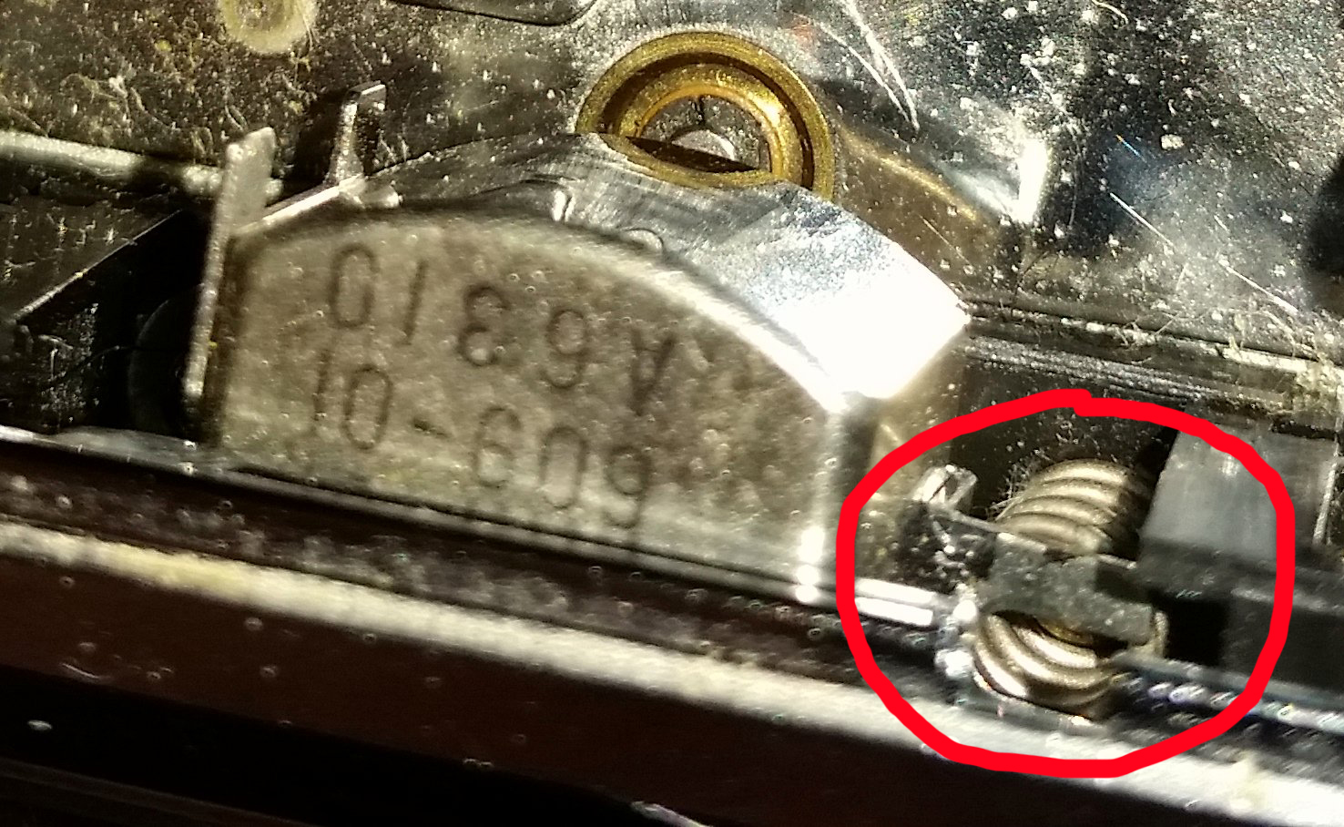

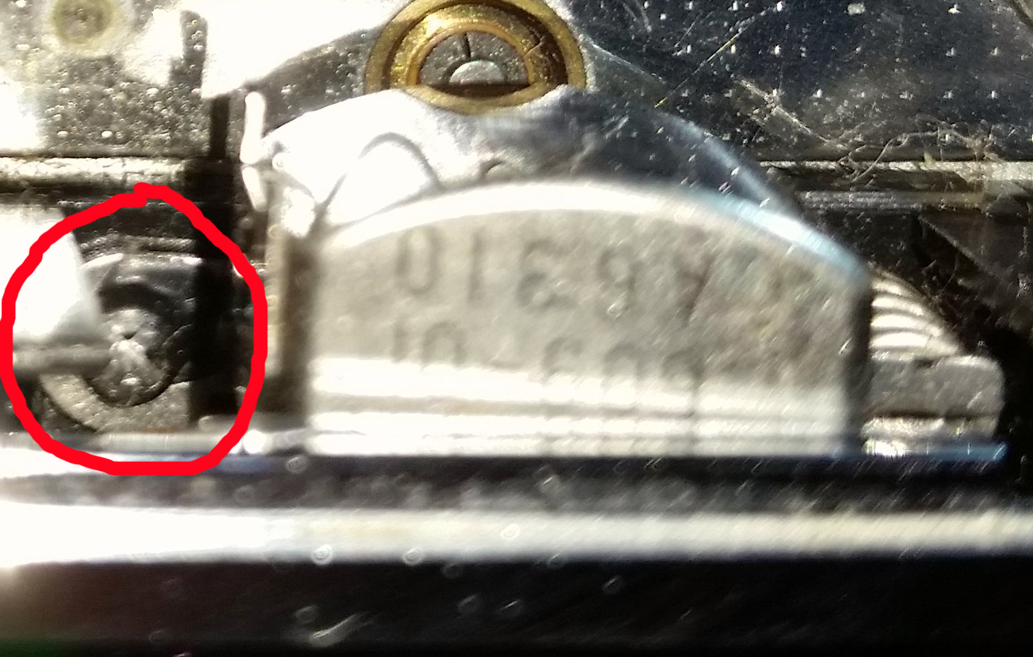

    I've just learned that a tape head has a mounting screw on one side
    and a spring and adjusting screw on the other side.
    Now I've looked at my tapehead and BINGO
    - mounting screw - CHECK
    - spring - CHECK
    - Adjusting screw - NOT PRESENT
    What sort of screw can be used for that, how can I be sure which screw to use ?
  16. Soxbrother
    Soxbrother Member
    104
    Belgium
    Tape head - mounting screw
    Tape head - Adjustment screw missing
    So maybe at least I can fix this myself ?
    Don't have a clue, which screw I can use...

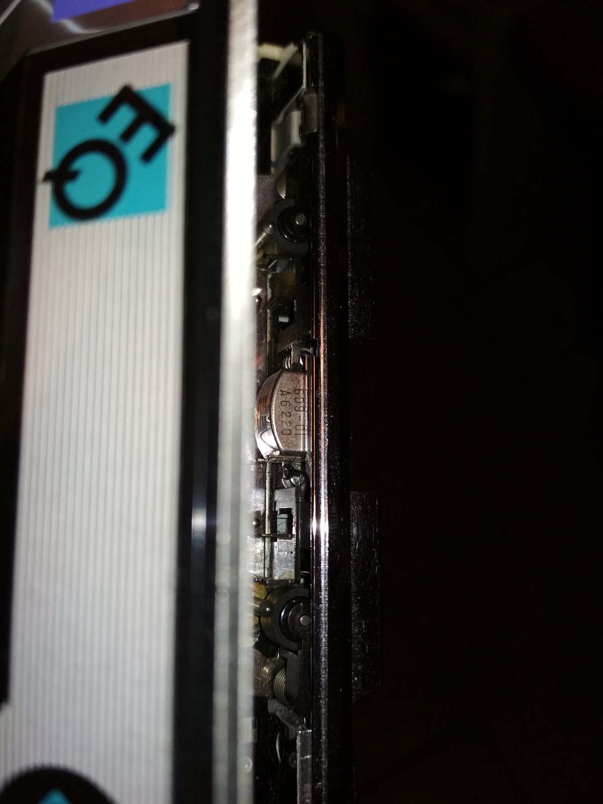

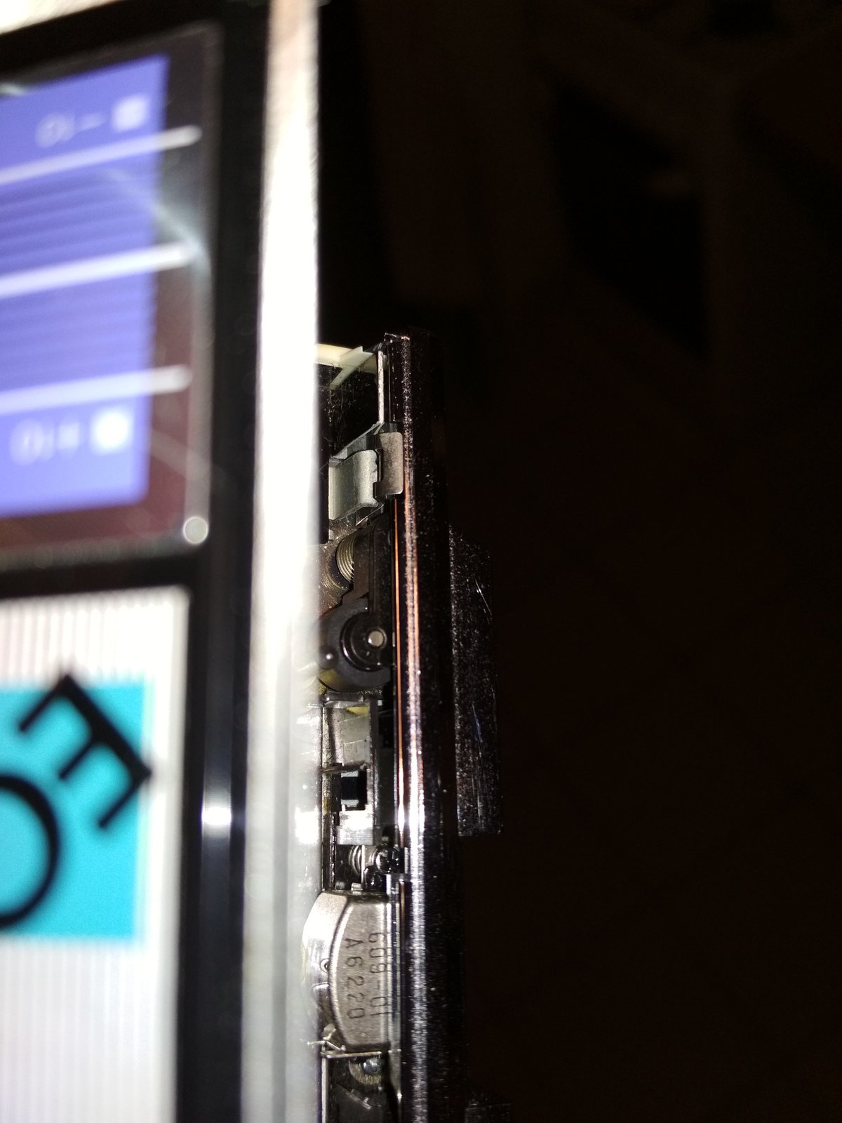

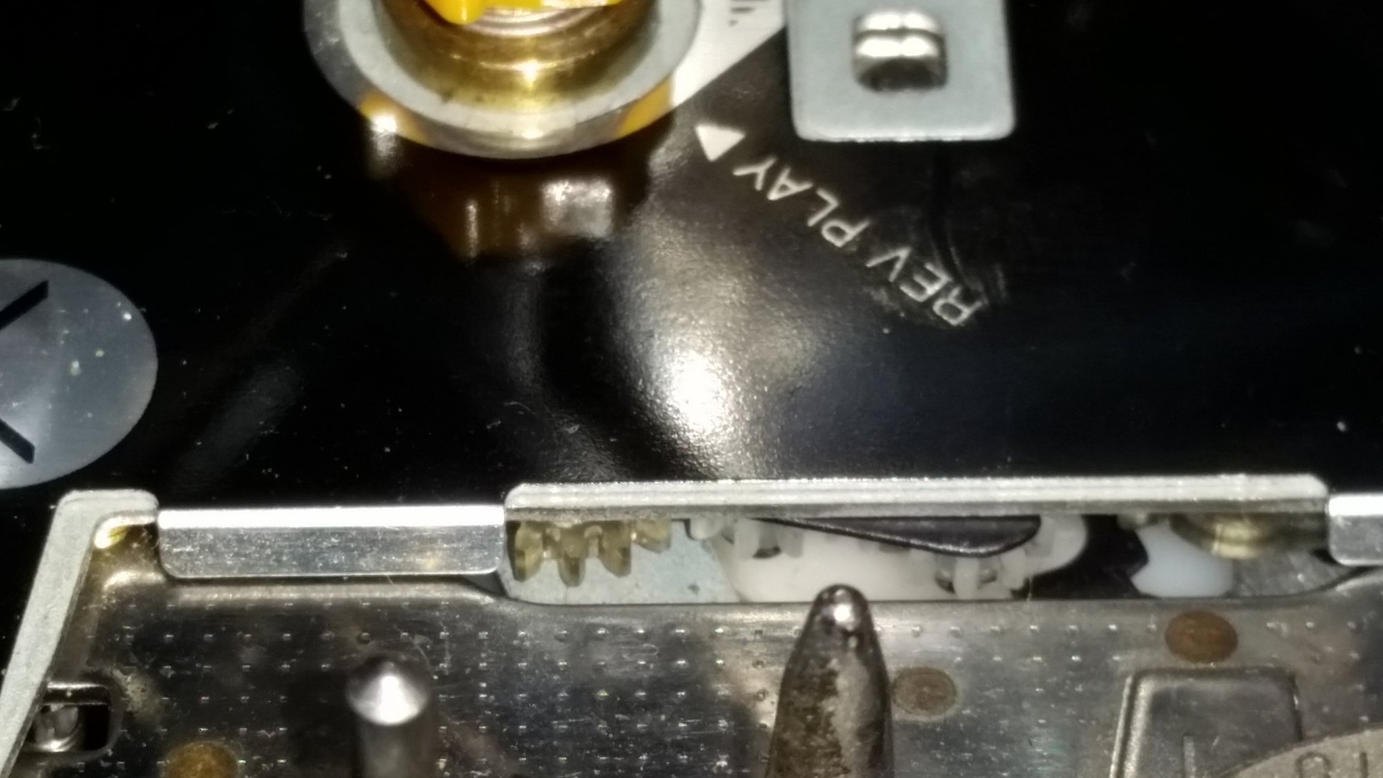

  17. Ball000
    Ball000 Member
    96
    Daoulas
    So your new video shows that the pinch rollers are OK in forward mode: the left one is released, and the right one is pressed.
    I've attempted to take photos from mine so you can see the screw but that was not easy at all!
