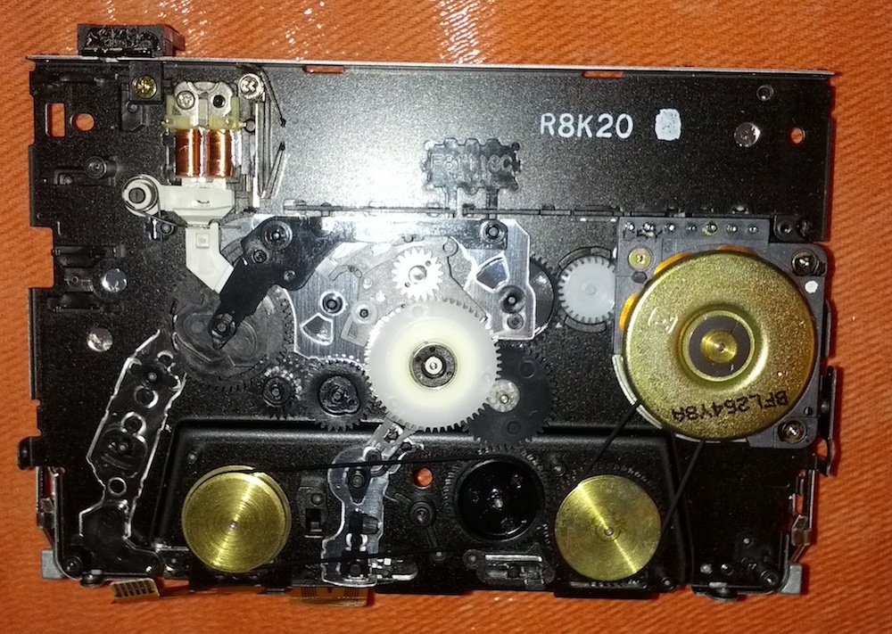

    Hello there.
    I have a belt problem on this model.
    There are two belts.
    21mm and 41mm internal diameter.
    Both are 0.7mm thick.
    Does anyone know where I can buy them?.
    I found a belt approximate dimensions that I merged with super glue,and it works great 20170102_125543.jpg
    with barely audible flutter.

    Yes,I bought a larger diameter belt, cut it to the correct diameter, take the sandpaper, processing ends to glue caught and connect belt.
    Then deal with the attachment point with sand paper.It is finest aluminum paper.
    Then I play some music usually jazz and listen to see if there are vibrations.if they are present i cut the belt for 2mm,and I try again.Sorry for my English.

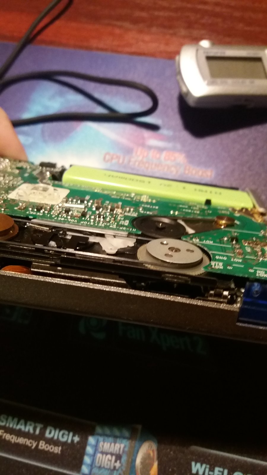

    These belts are connected with super 20170117_191409.jpg glue.
    Do you see a place of compound?.

    I see some part different color (darker) so probably that is the glued section
    As far as i can see from photo it is side by side gluing rather than end to end. Is that right?
  18. George
    George New Member
    24
    Serbia
    No,it is end to end.

    I tried side on side method but there is lot of flutter.
