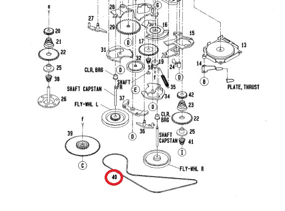

    Also, I cannot see any belt on the mechanical exploded view from the service manual. Is there a different mechanism without belt in this model ?

    The unit does have a belt for sure, it's part #40 marked in this picture:
    Very few walkmans don't have a belt and most of them are the DD (disc drive) series from SONY. Panasonic RX-S40 and RX-S41 are the only 2 that are truly direct drive (the capstan/flywheel assembly and the motor rotor are the same part).

    Stupid me, the cassette mechanism exploded view was 2 pages further. OK, there is a belt. I knew about Sony DD but Panasonic RX-S4[0|1] are new to me. I expected to find a belt in this Aiwa HS-PX377.

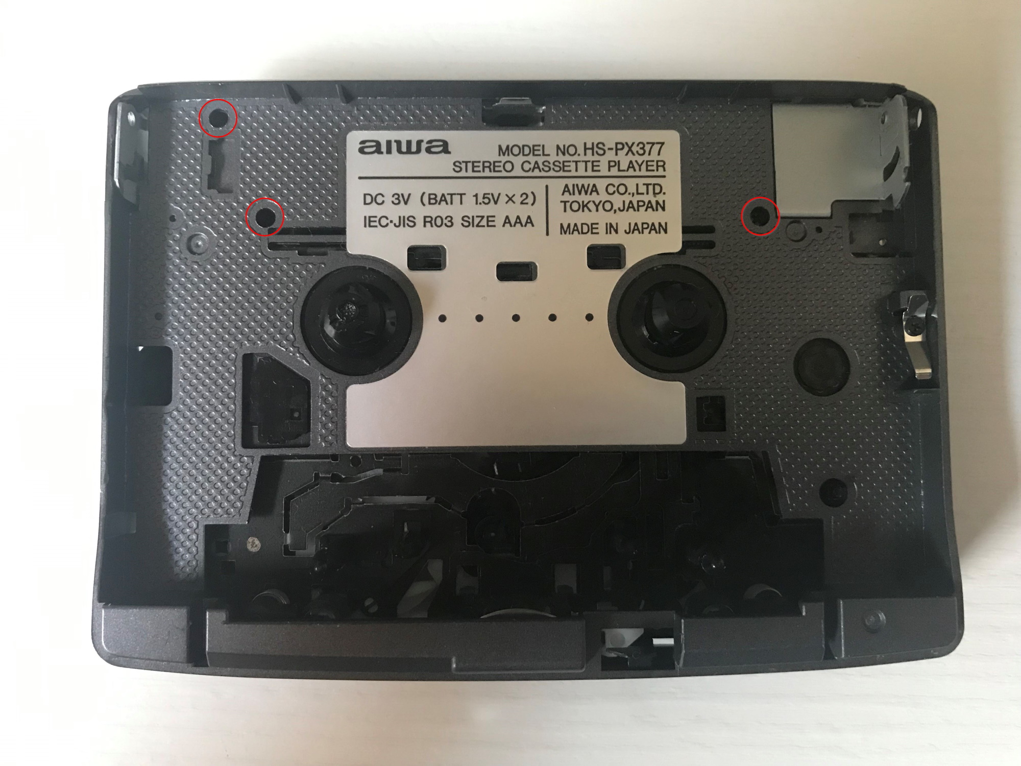

    OK, here we are. To open this model, you must first remove the cassette door. There are 2 screws to remove on the left and right side.
    Then you can access inside the device. Remove the 3 screws marked red on this picture (note that the screws remain attached to the unit so no risk to loose them:
    Then you can remove the back cover using a spudger to detach all the plastic clips.
