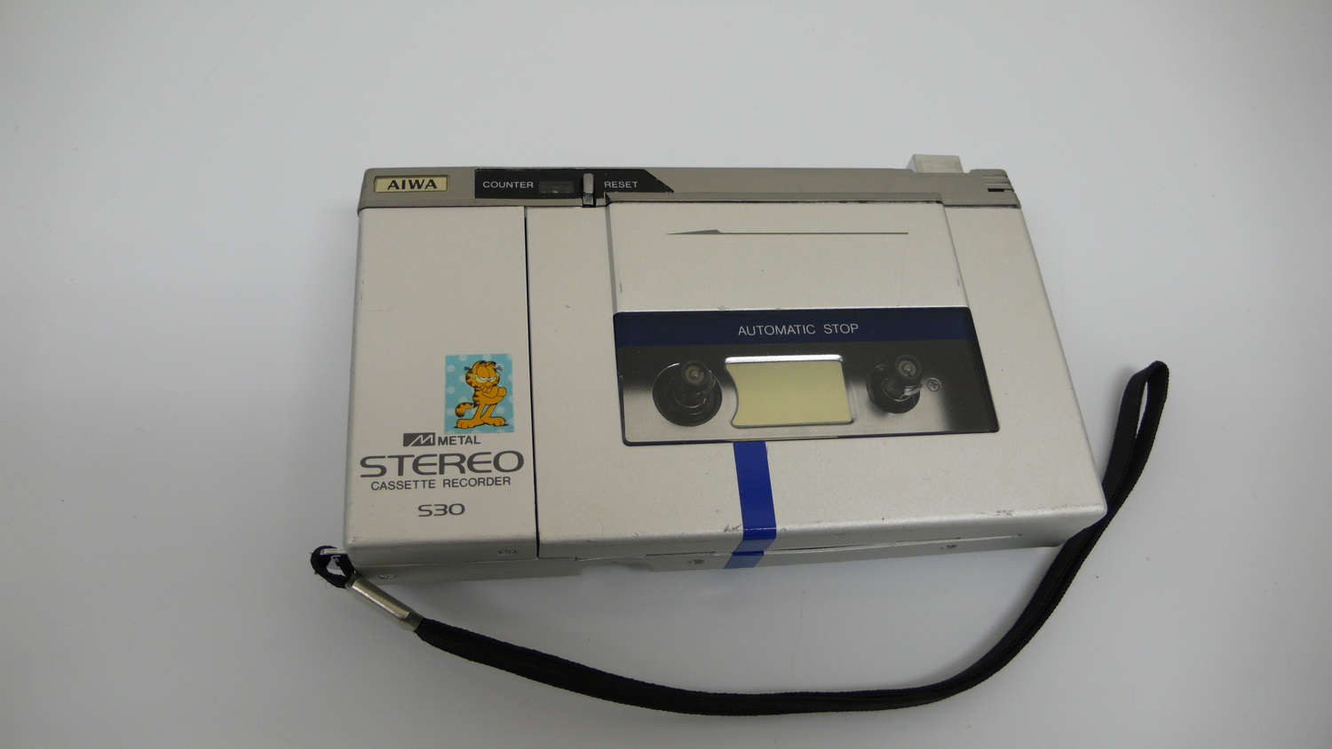

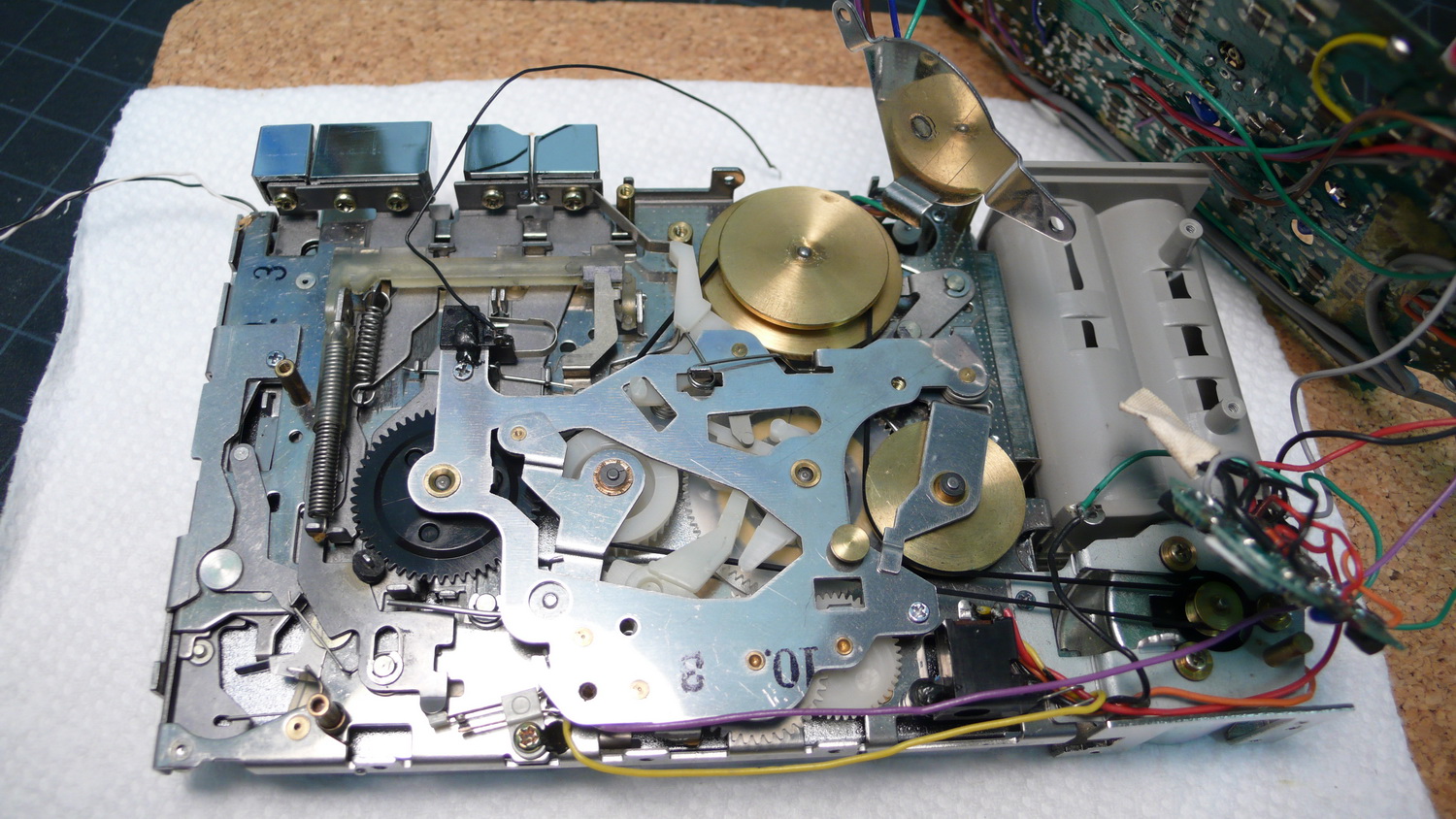

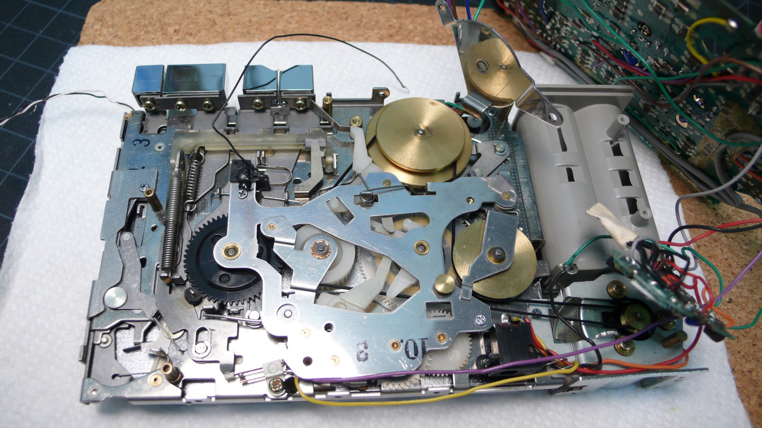

    Hi there,

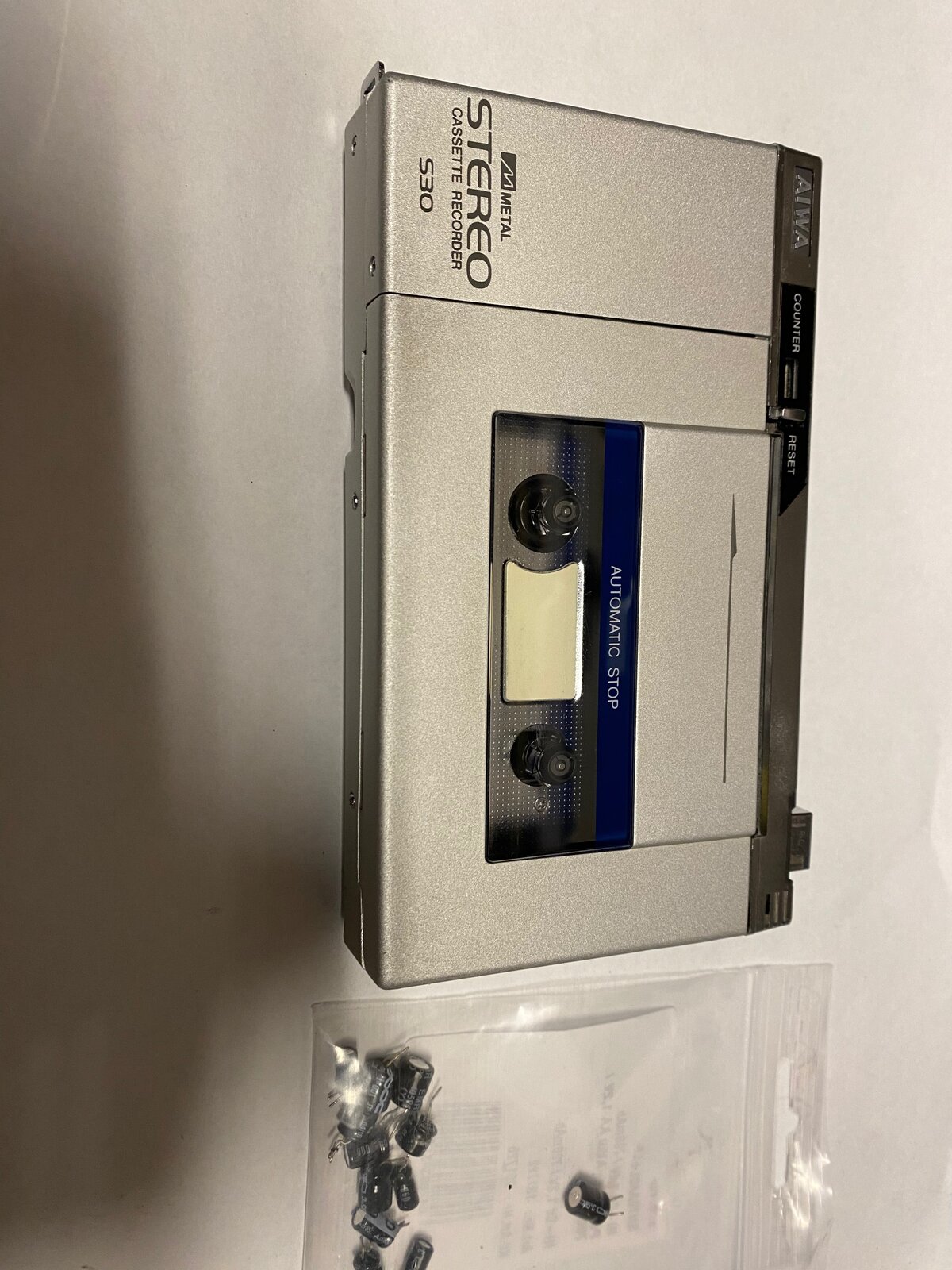

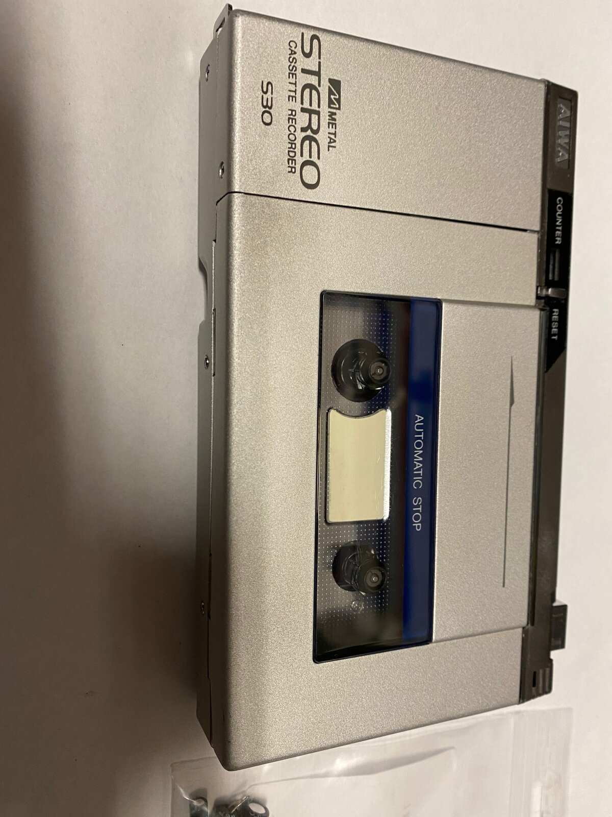

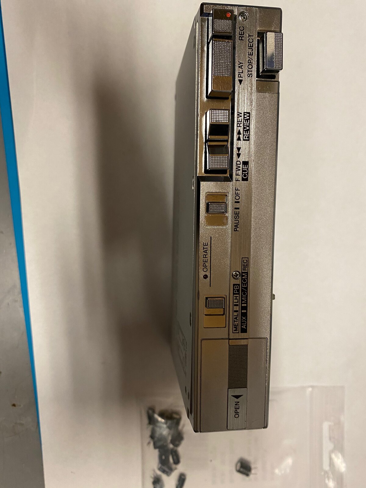

    This week I restored a TP-S30 cassette player, i normally only do Sony's (DD series, D6C and other high end players). I must say I am impressed by this walkman. Its mechanical really a masterpiece in my opinion. It was not just changing the belts but the where a lot of other issue's to get this piece working. But it was worth it. I recapped it, change the belt and solved some mechanical issue's and its working great again.
    I understand this is the first Aiwa that was made to compete with the Sony TPS-L2, and in my opinion the Aiwa is superieur. I bought it from the first owner that bought it back in 1981 for $725 (converted from 1350 Guldens). The original user manual and soft case where included, he tried to fix it but was unable to get it back working. Because the unit was already opened by someone else it was much more difficult to get it working again.
    This unit is a real undervalued collectors item in my opinion, what are you think about it?
    Greets Tom

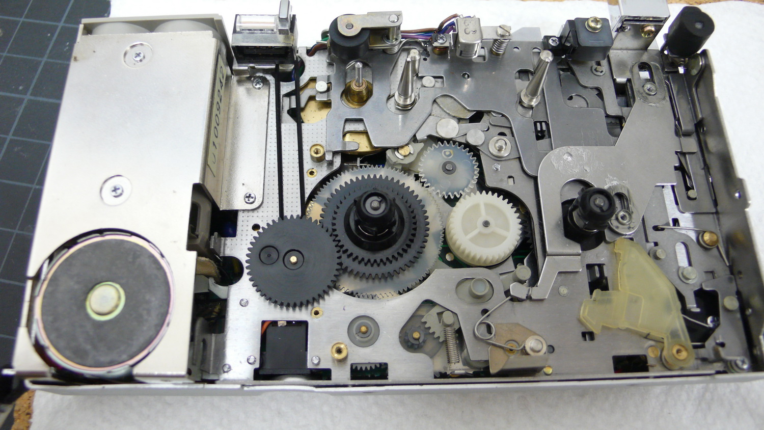

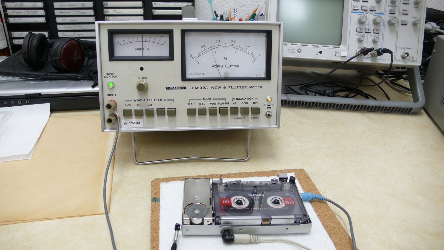

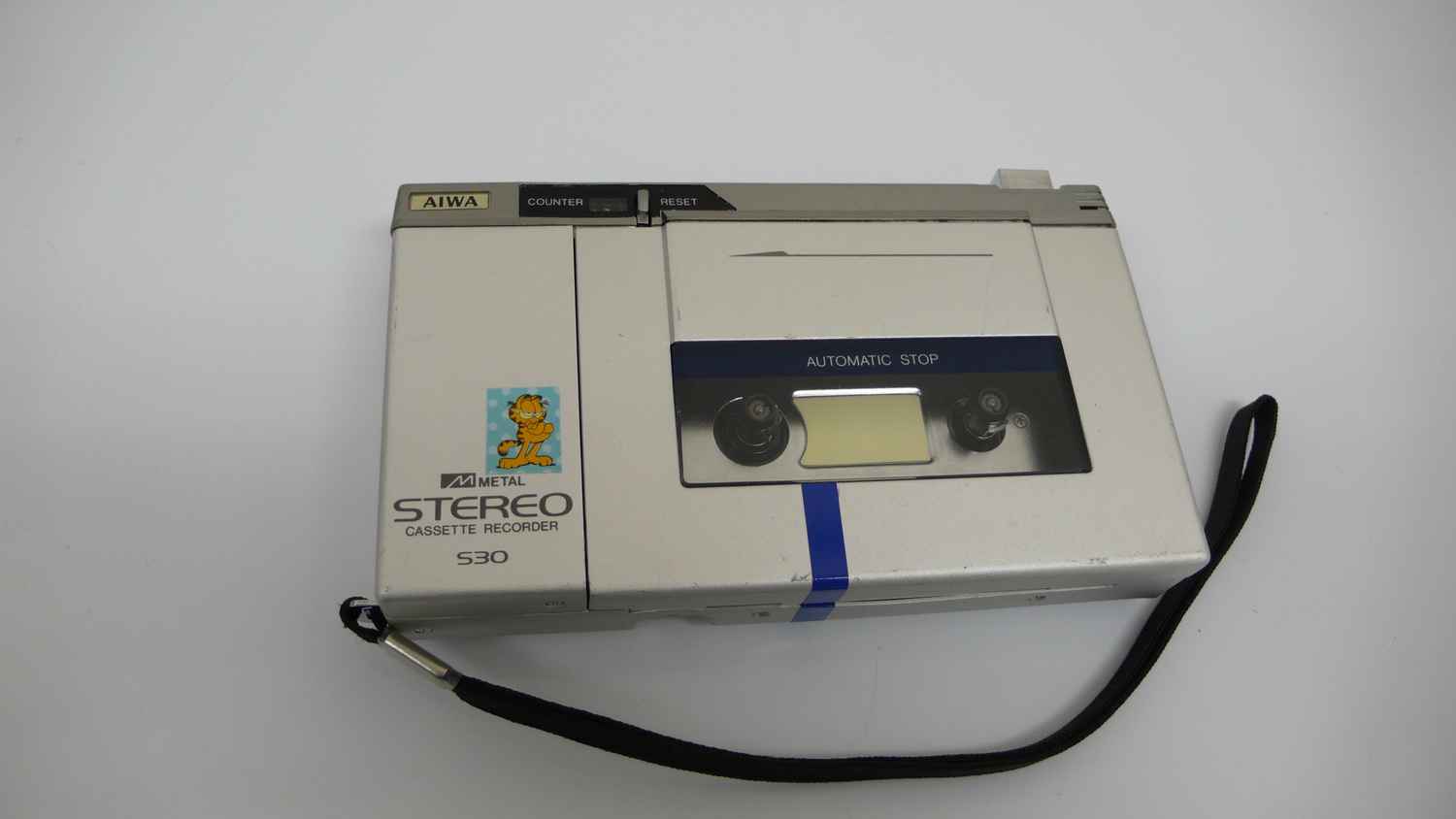

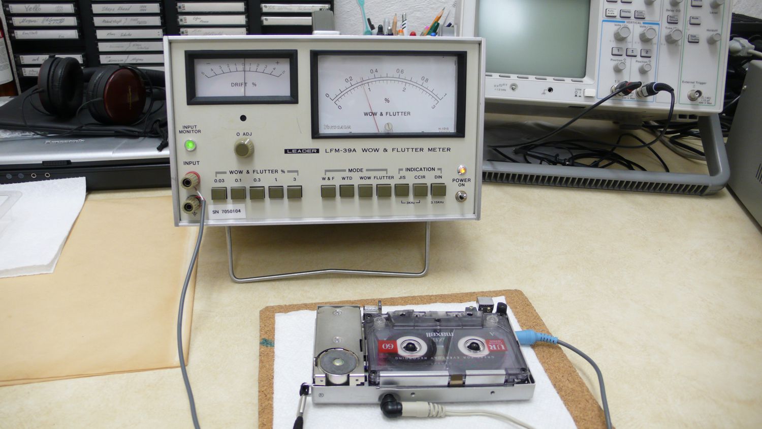

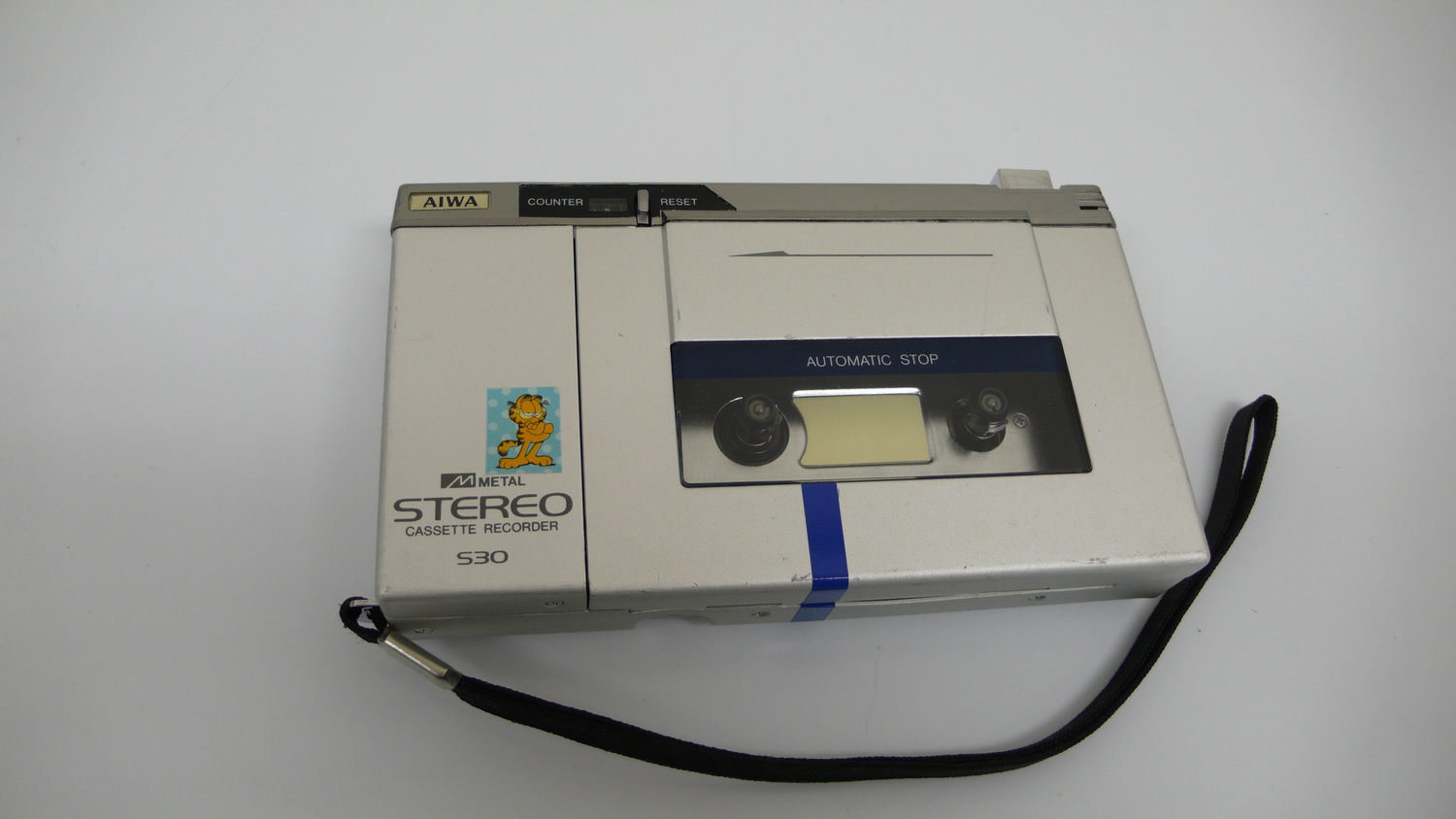

    My Aiwa TP-S30 also gave me a hard time, almost gave up on it and succeeded only on the second or third attempt. Mine was in a pretty miserable state when bought, AIWA logo had to be re-made, Garfield and blue stripes cover especially nasty scratches:

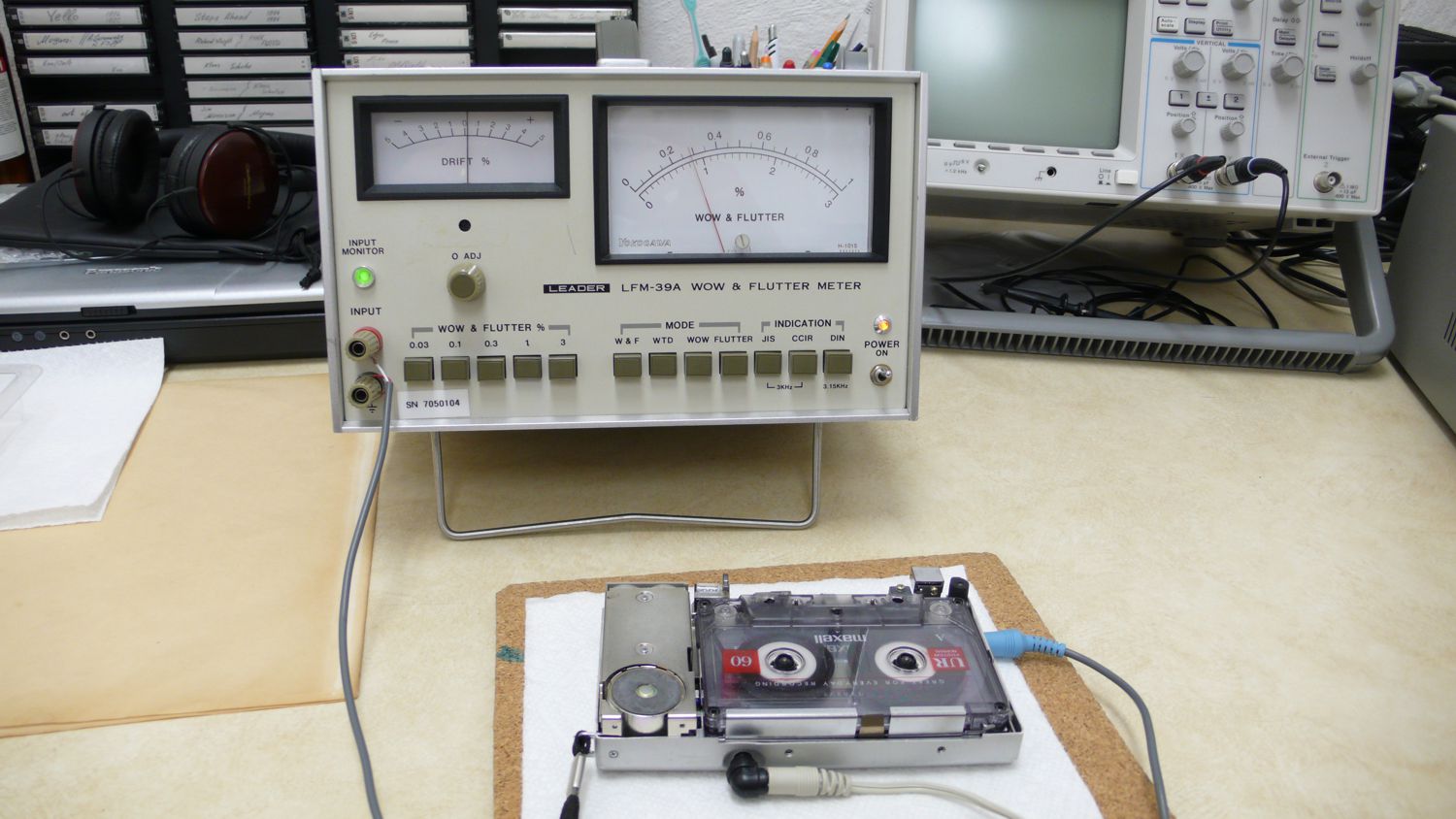

    Totally agreed, cassette mechanism, once you figure out whats broken and how to fix it, is beautiful. W&F below 0.3, OK for a Walkman:

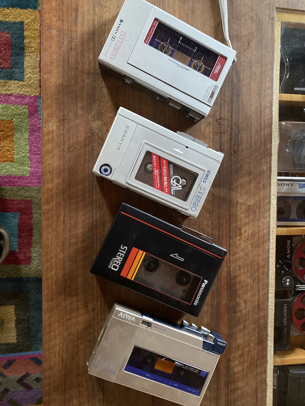

    i agree, the AIWA is definitively a better player as the TPS-L2. i also agree, that as underrated as it it, it is a pain in the bud to fix, but also later fun, when you know how to do it.
    now you have to find the early JVC, Panasonic etc. to find out that they‘re better quality than the one wich came with the big name ;-)

    see also: JVC CQ-1K, Sanyo MR-555 and Panasonic RQ-J9 image.jpg
    (this Aiwa is an HS-F1)

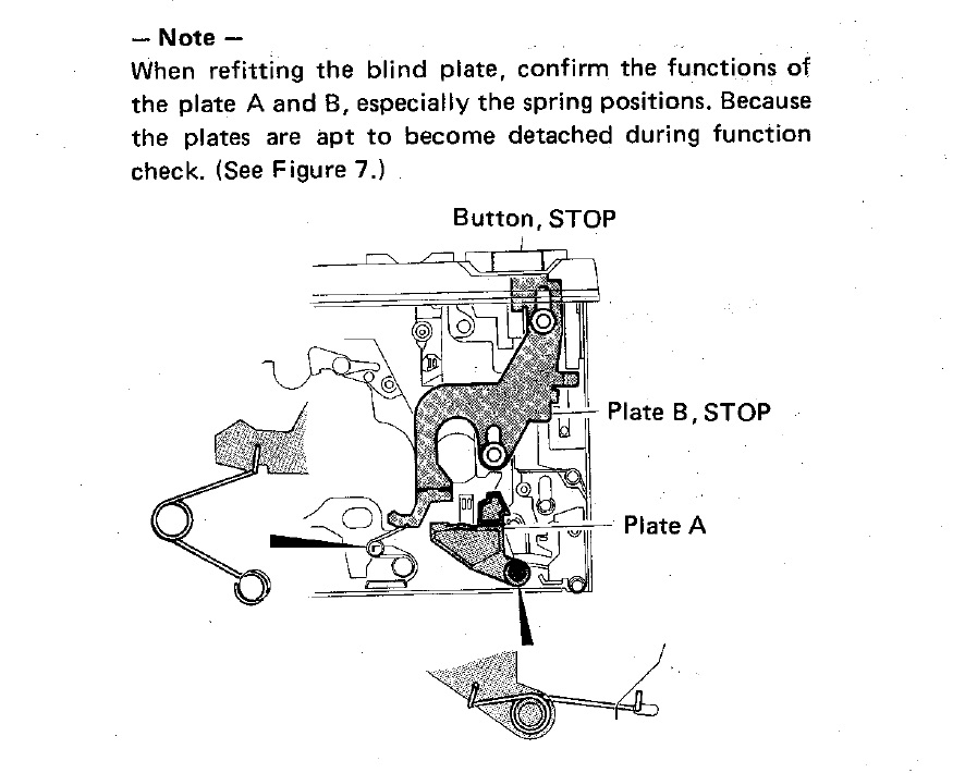

    Thank you very much for your response the wow flutter is also around the 0.3 at my device. I saw your pictures and I noticed something and that was plate A that you have fitted. According the service manual it has to be fit different then what I see in your picture.
    Jorge and Mister X like this.

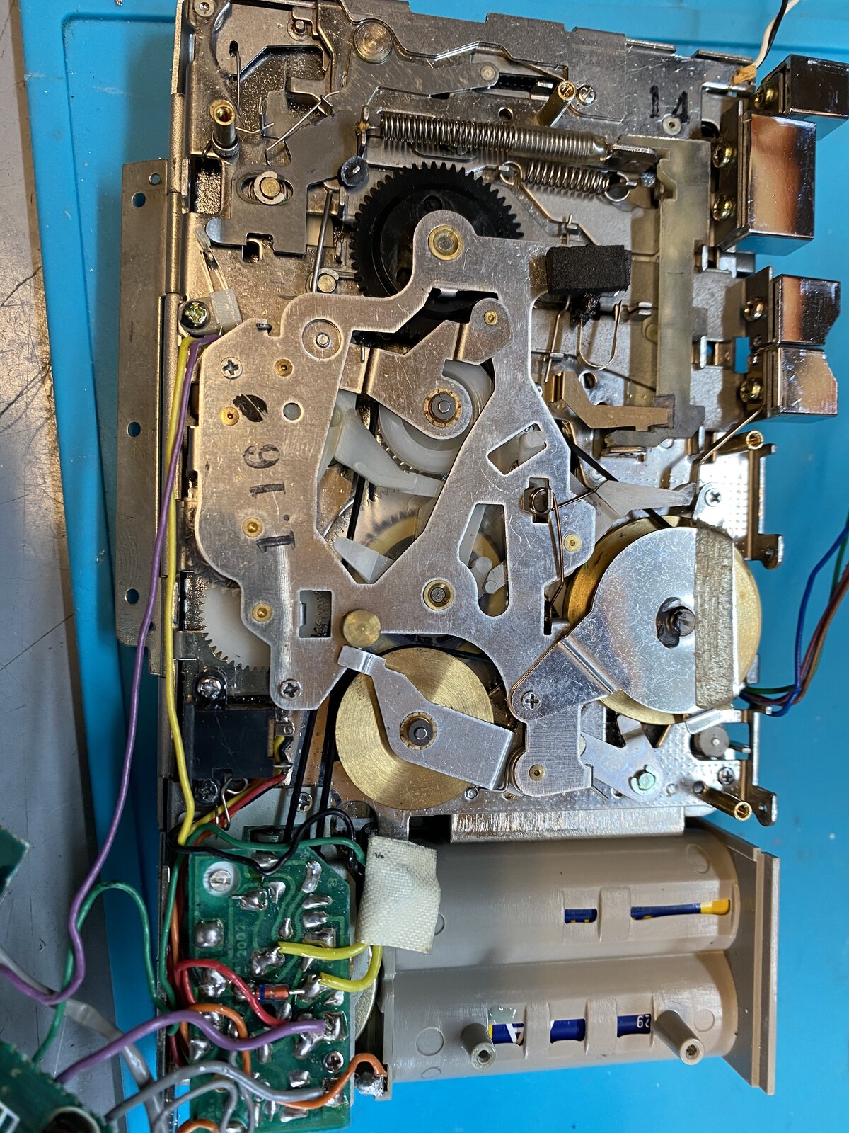

    Hi everyone, thanks for posting the service manual. I managed to replace the belts and my Aiwa TP-S30 is working again. Mechanically everything is fine (Play, Forward,Rewind,Stop) do their job.
    Unfortunately I can't hear the music only strong hissing and sometimes some beats in the background.
    I have uploaded a sample file for you to listen. I recorded it with volume on 10 on the Aiwa (max).
    Maybe someone can give me a hint wants wrong with my it :(

    You need to replace the capacitors. They are leaking and out of specs.
    Greets Tom

    You mean these bigger ones? How many are there? Can you remember the specs?

    All of them need replacement, the specs are on the capacitors and also in the service manual.
    Greets Tom

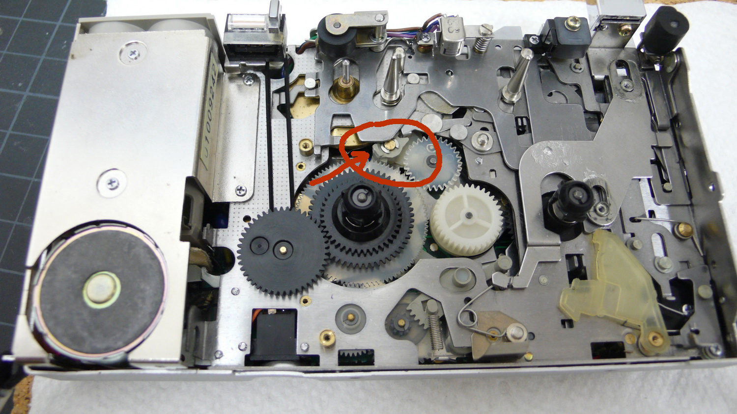

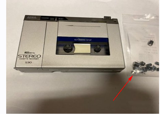

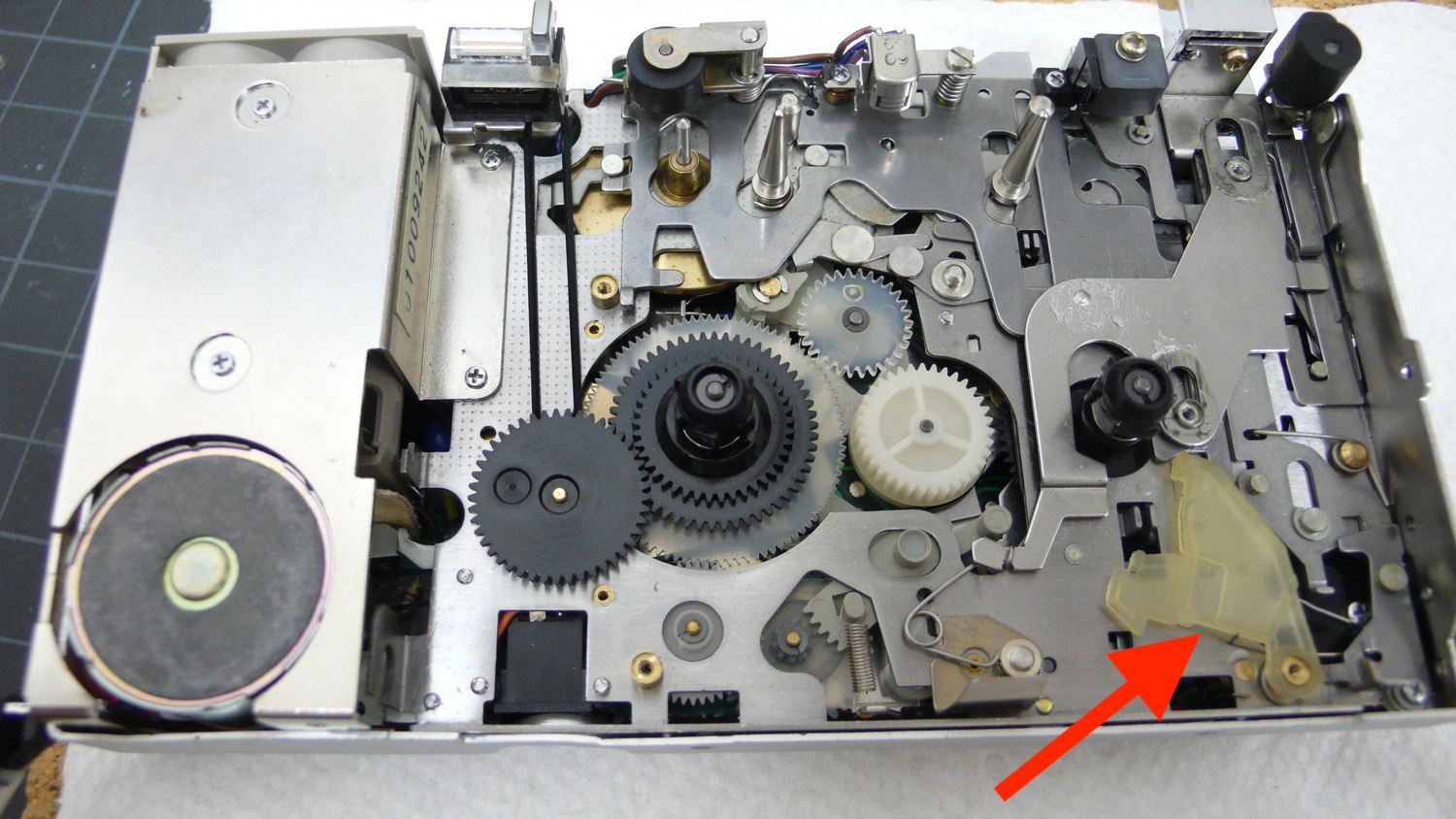

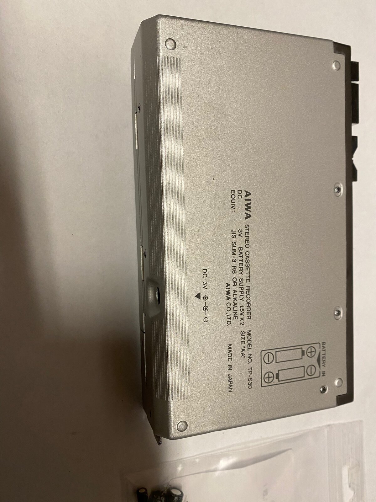

    Hi all,
    also on my tp-s30, this highlighted part is broken. What is it for?
