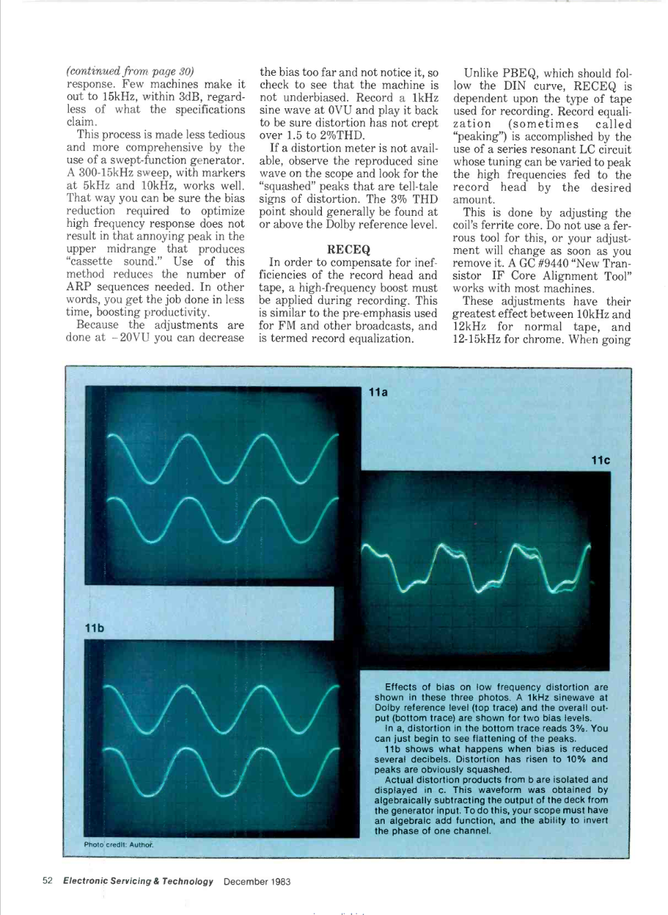

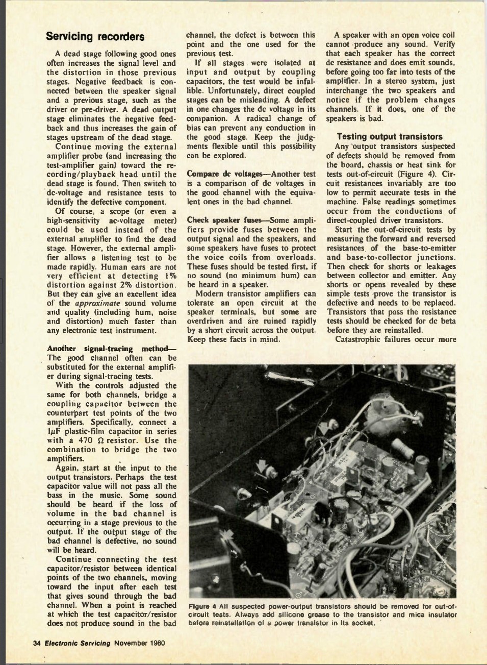

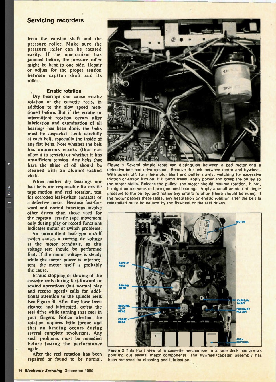

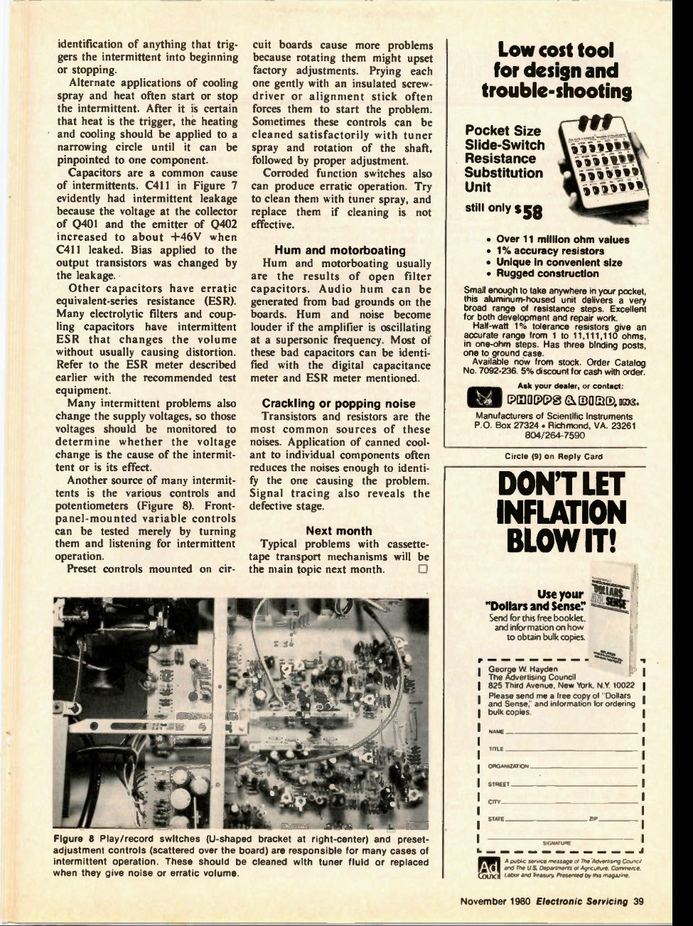

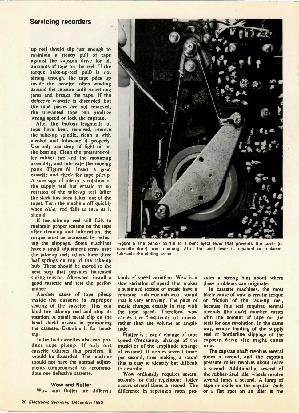

    Here's the previous articles referenced in the above copy, from 1980
