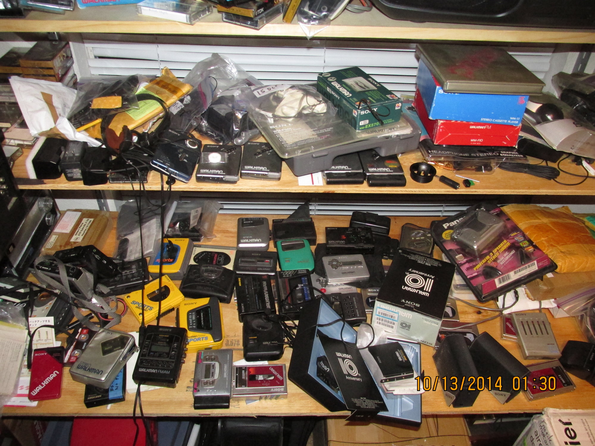

    I have a few walkmans but I have not had time to get to them just yet as I am still working on the bigger portables.

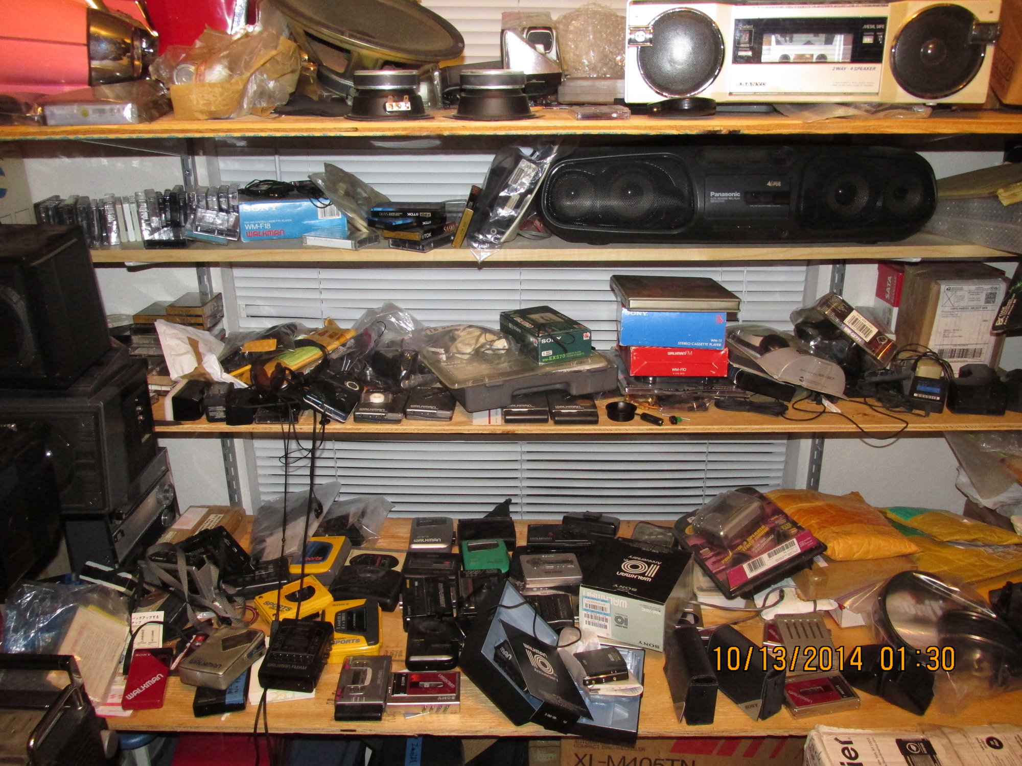

    Here's a old picture of mine of stuff that is now all in packing box's somewhere
    ok I will share three pictures FULL SCREEN ok :)
    IMG_1324 Middle room Mono Boombox.JPG IMG_1325 Middle room Sony WM Walkman.JPG IMG_1326 Middle room Sony WM Walkman.JPG

    Whoops My bad !!... thanks mate.. will check the audio caps next.. I bet they are smaller than a grain of rice on this thing ! That's a nice collection you've got there :hi:reelspin::reelspin:

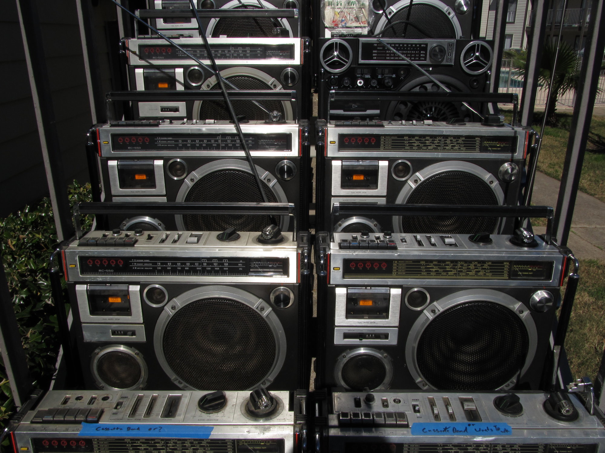

    @Cassette2go I was wondering what are those cute little radios on the bottom shelf... and suddenly realized those are 6 (six!!!) El Diablos... Mamma Mia!!!

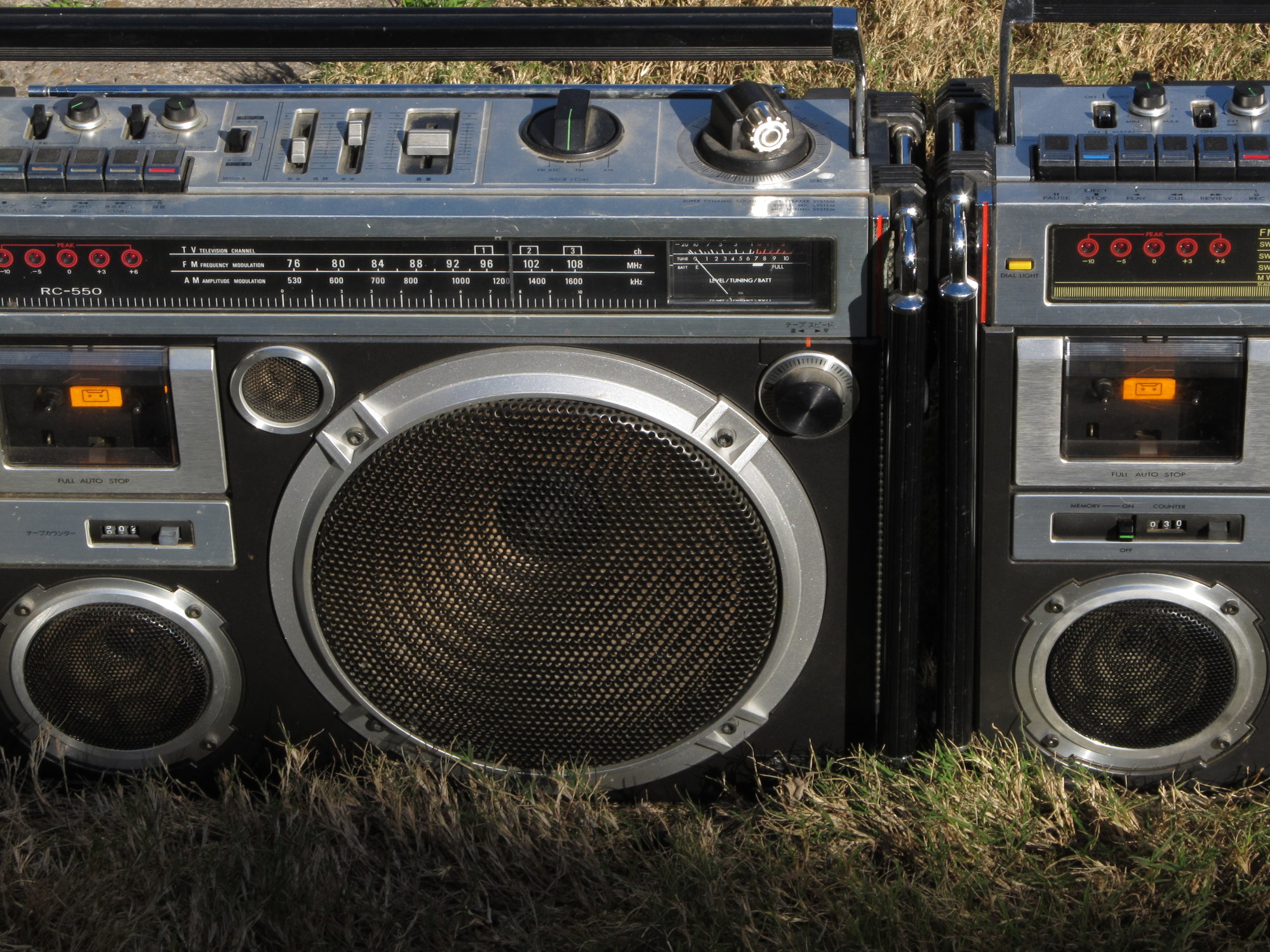

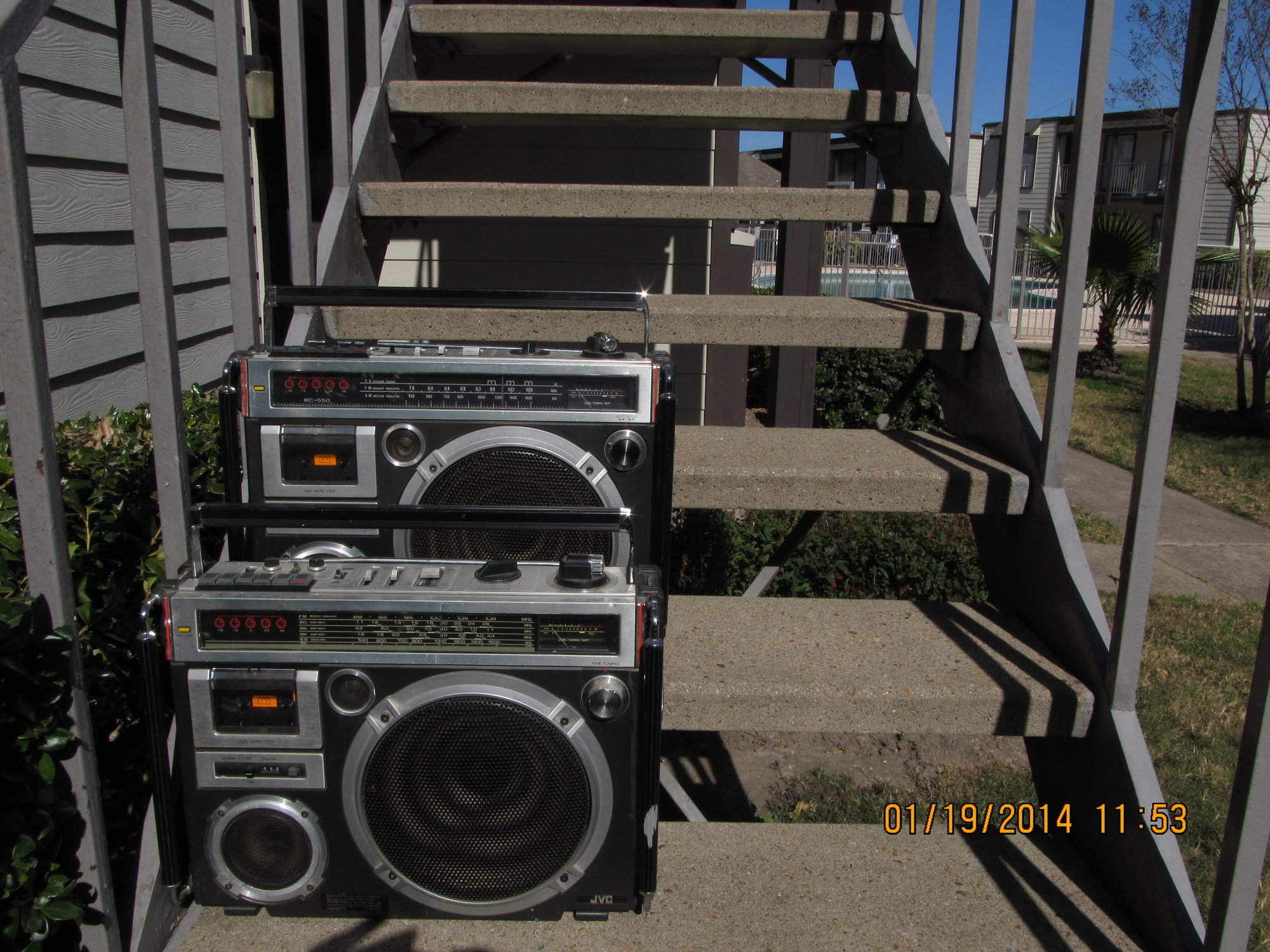

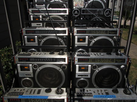

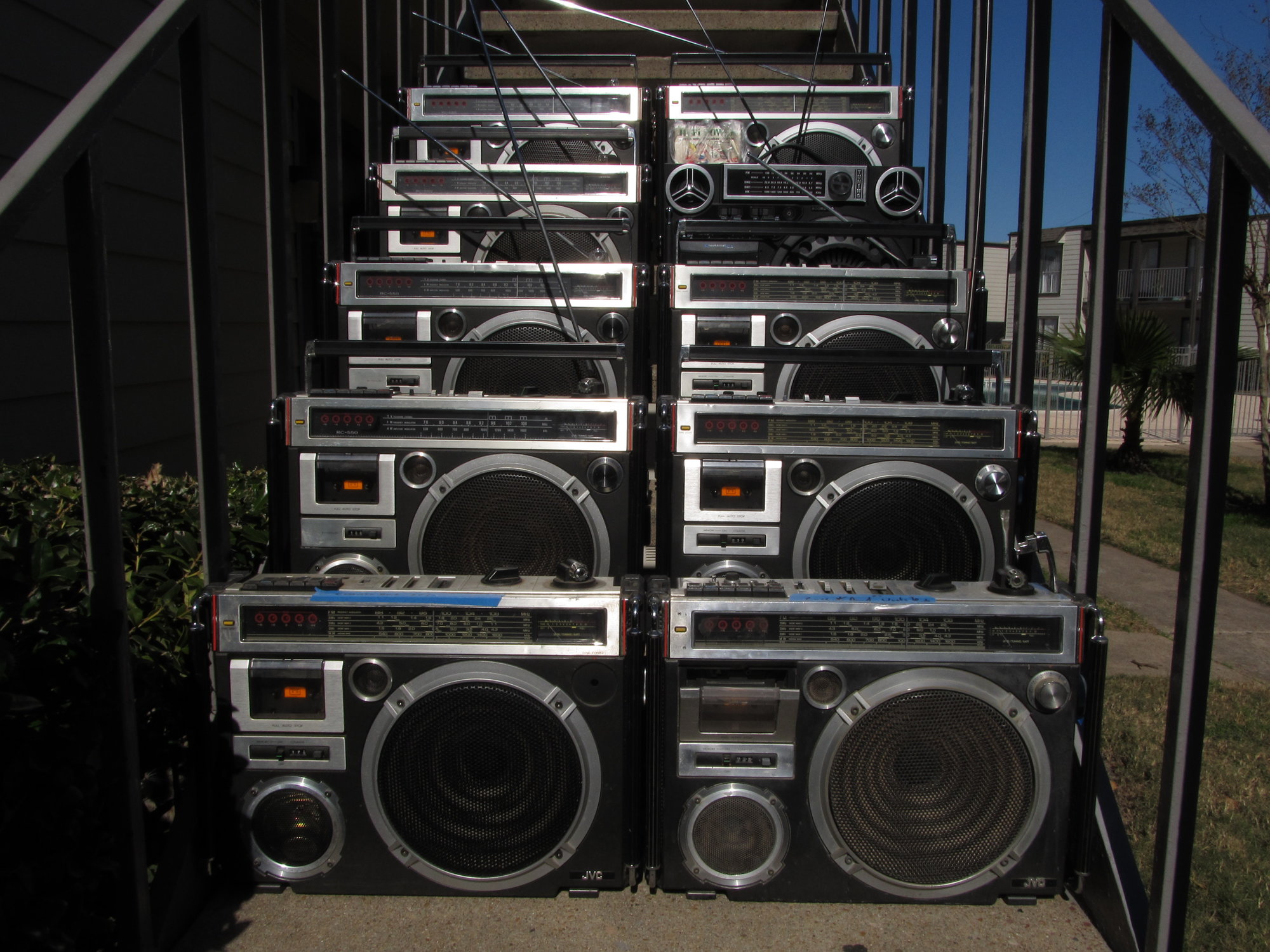

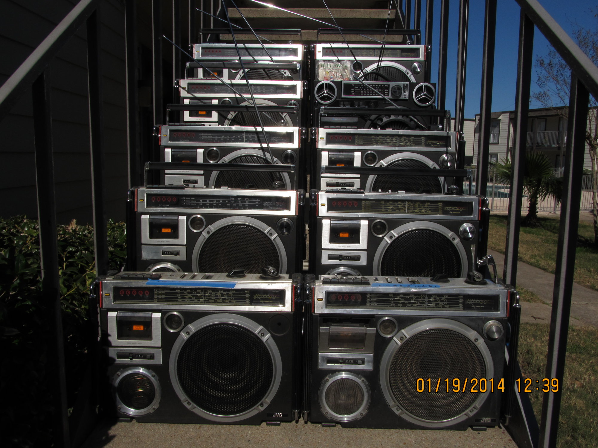

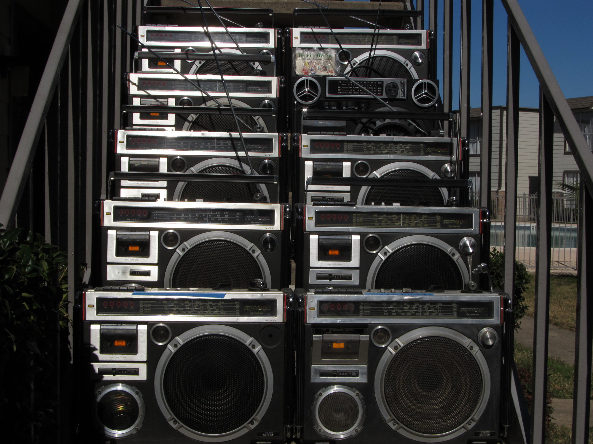

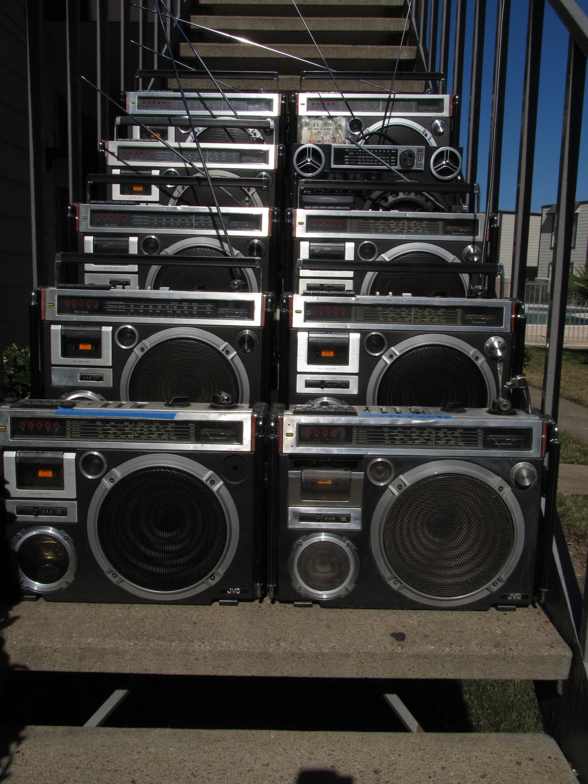

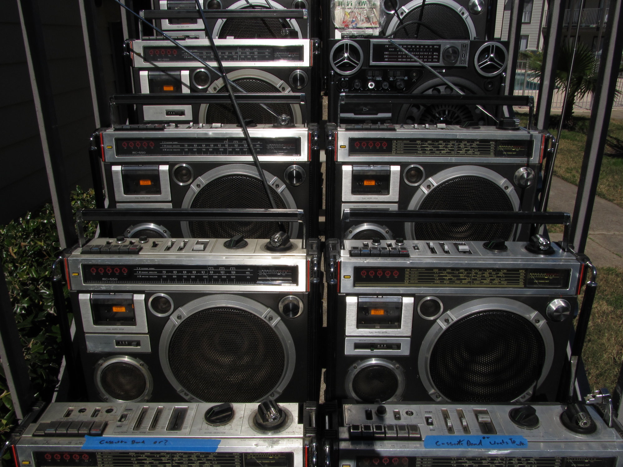

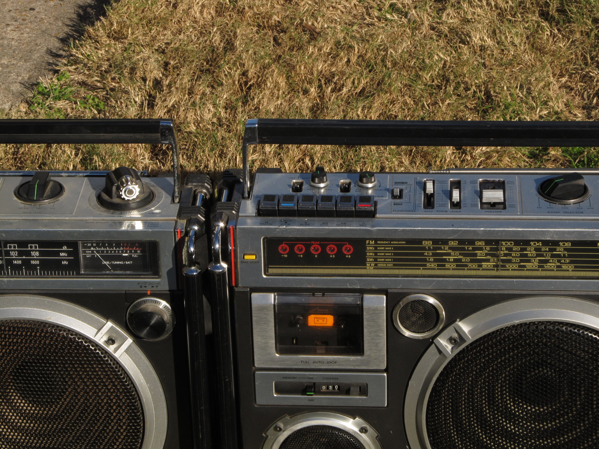

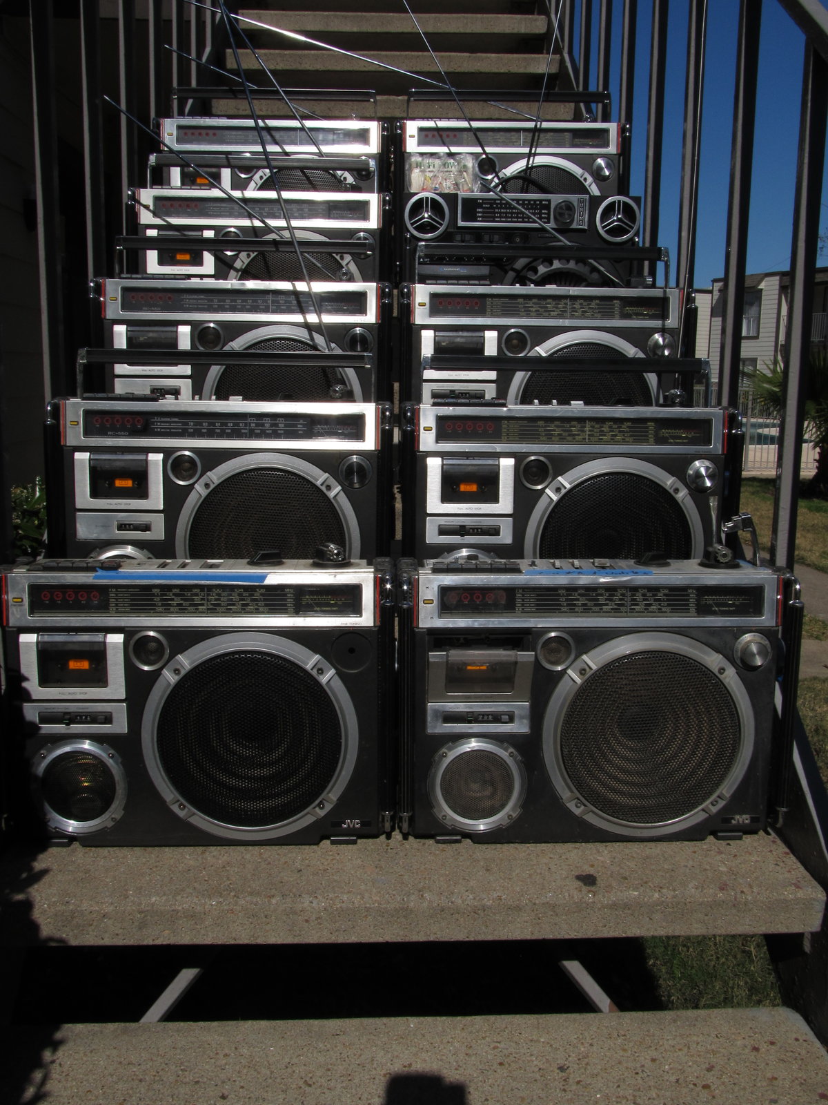

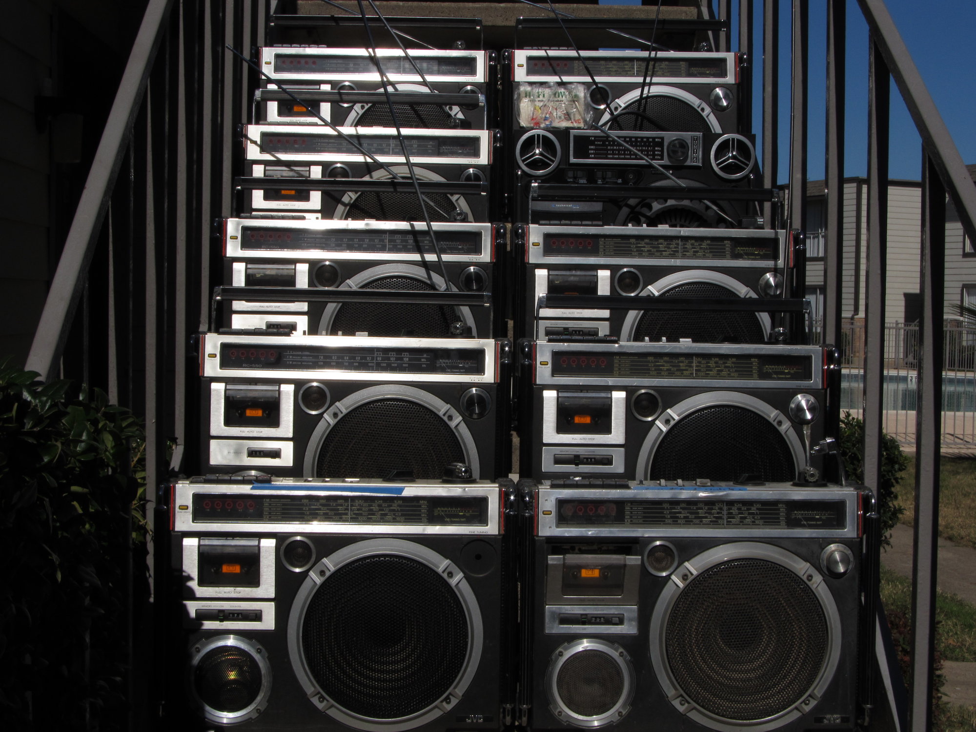

    I had NINE RC-550's but I sold some.
    Present day I have 1 'very broken and needing the entire function switch linkage' JVC and 4 Victor's in the model rc-550.
  8. Jorge
    1,754
    Someone at boomboxery once said that Victors are the Thing, JVCs of the same are mickey-mouses(mice?)!!! :)
    And you got FOUR of them, Real Things!!!!! Wow!

    Been a while since I've poked in one of these but I remember solving an issue by fixing a break in the flex.
    Just what was your solution for the

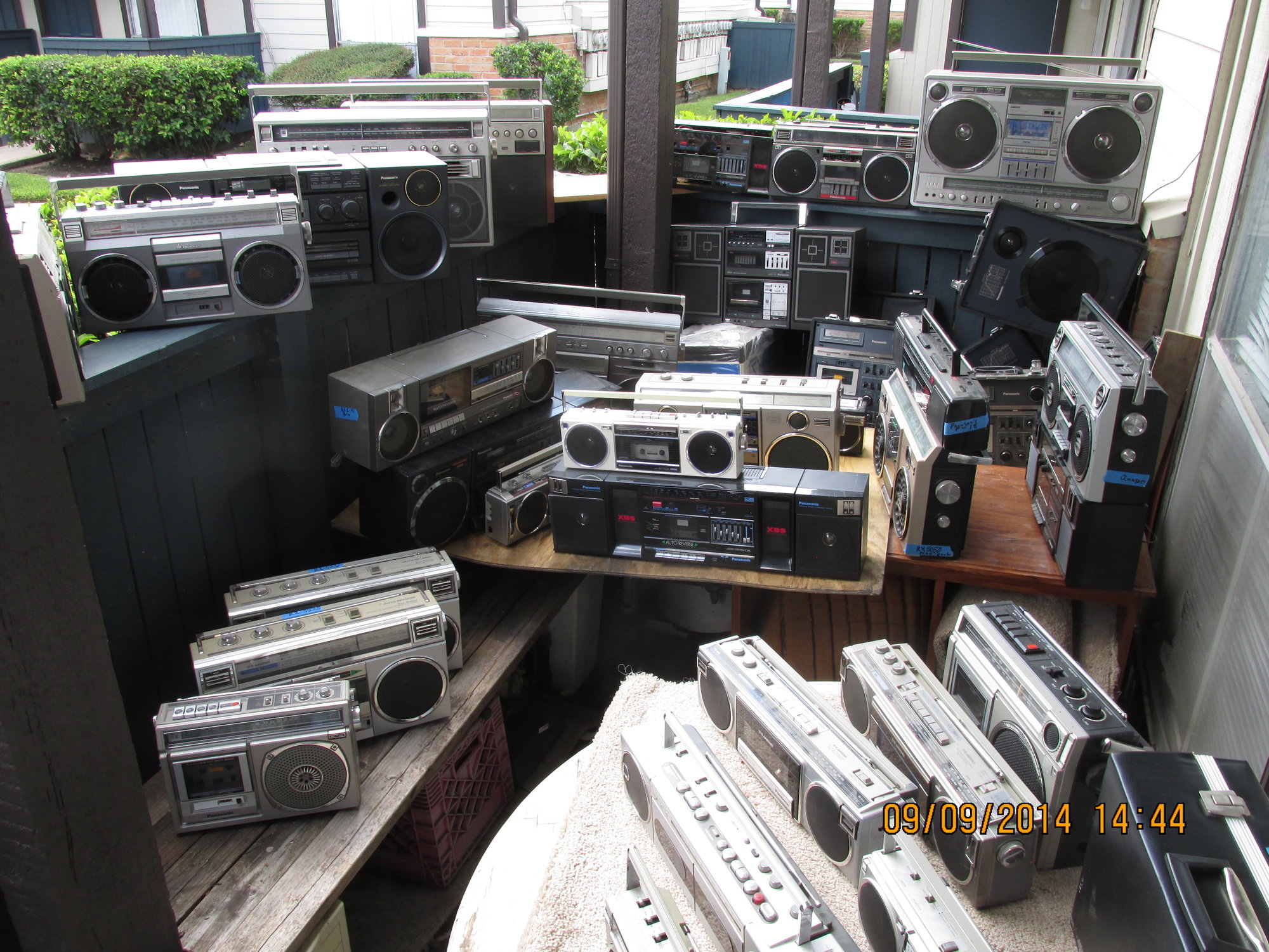

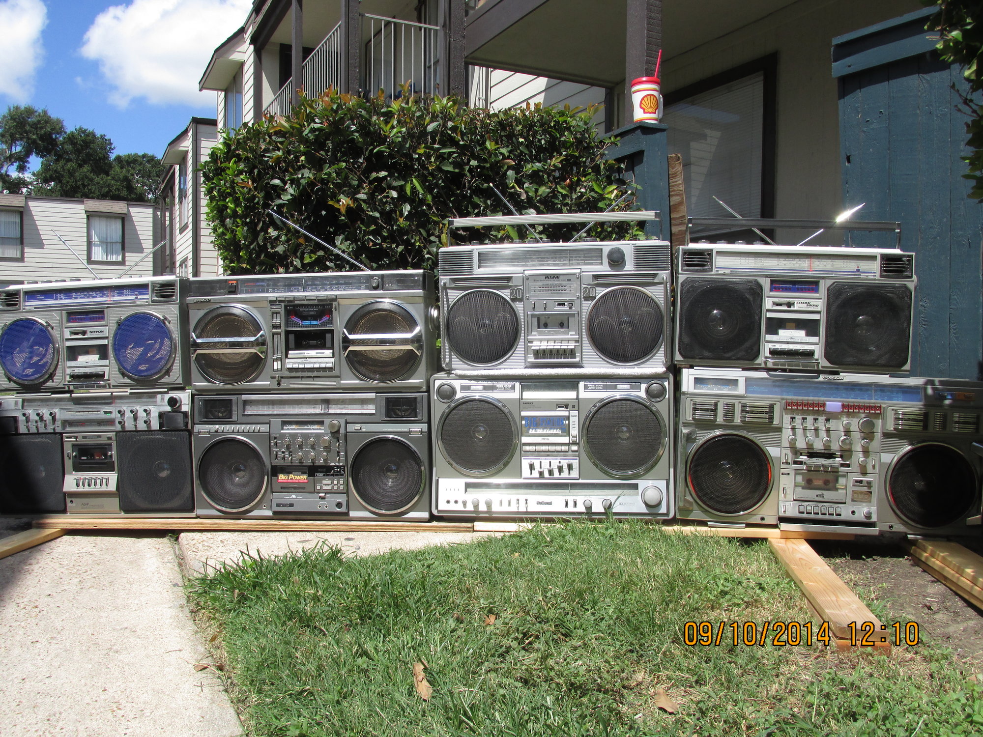

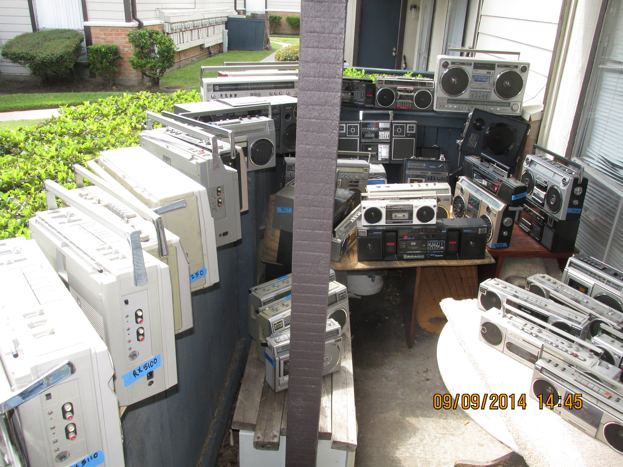

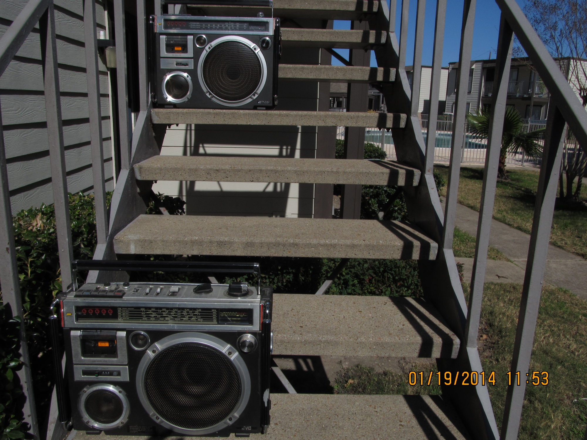

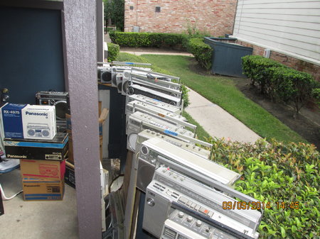

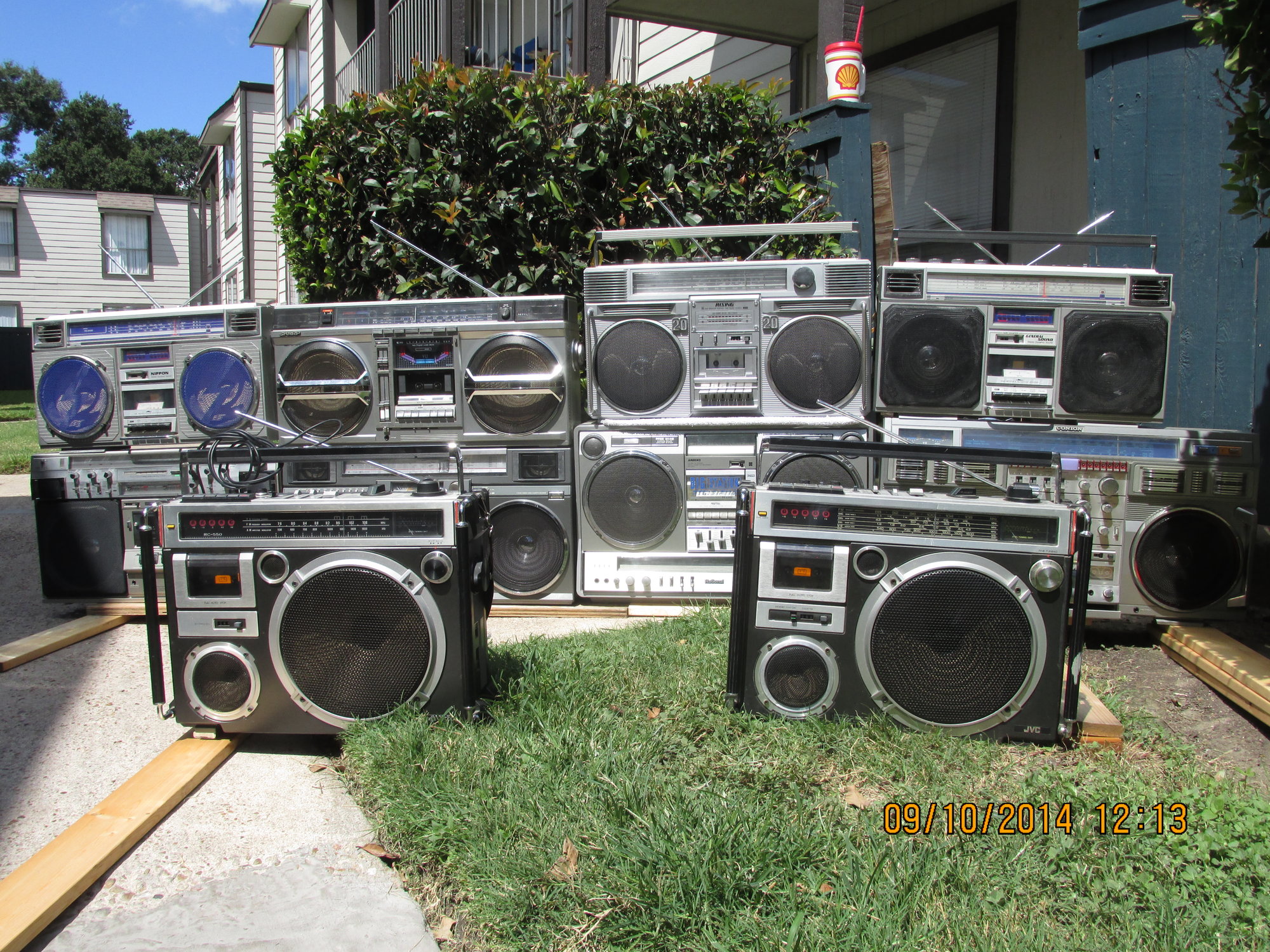

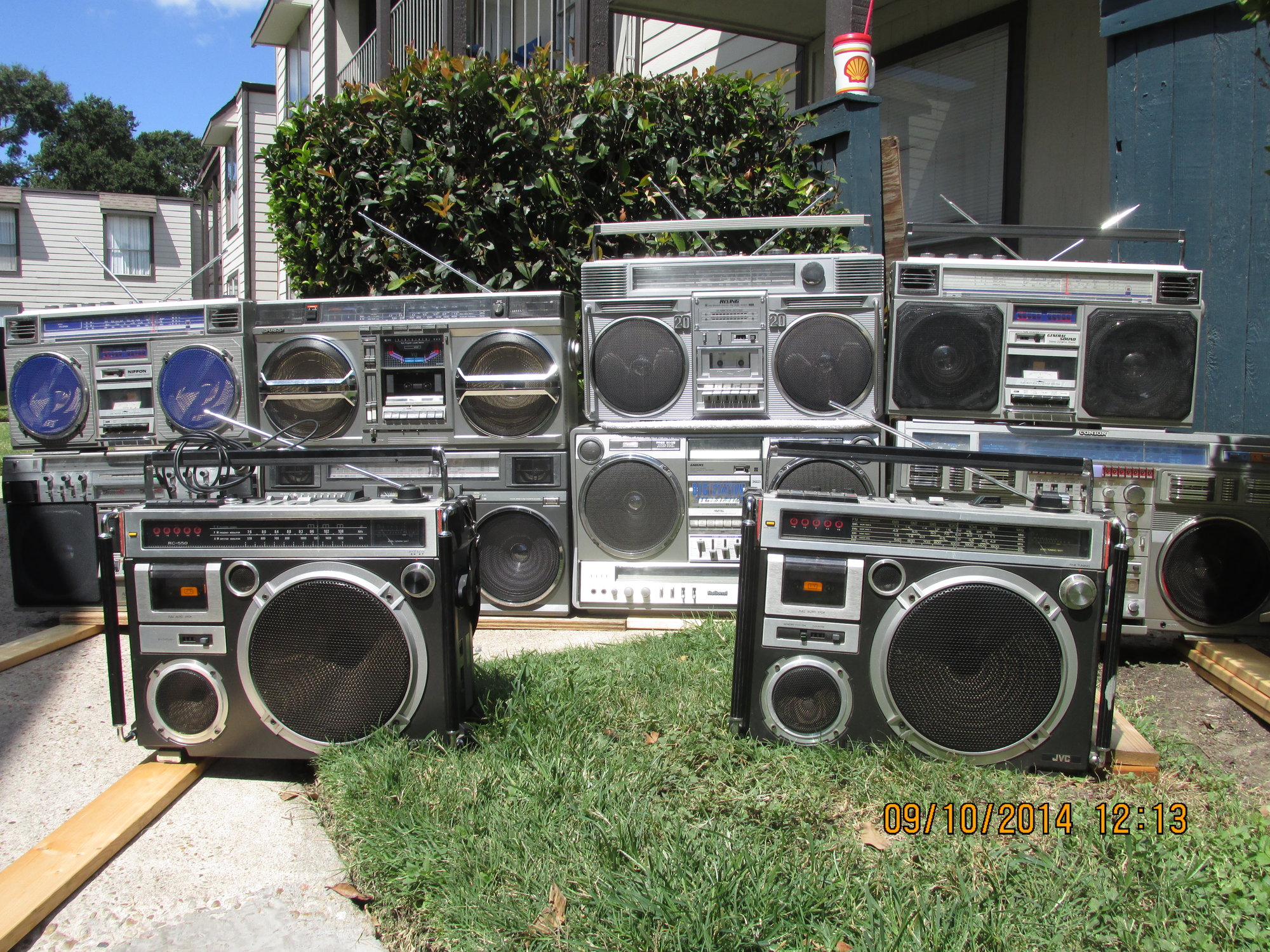

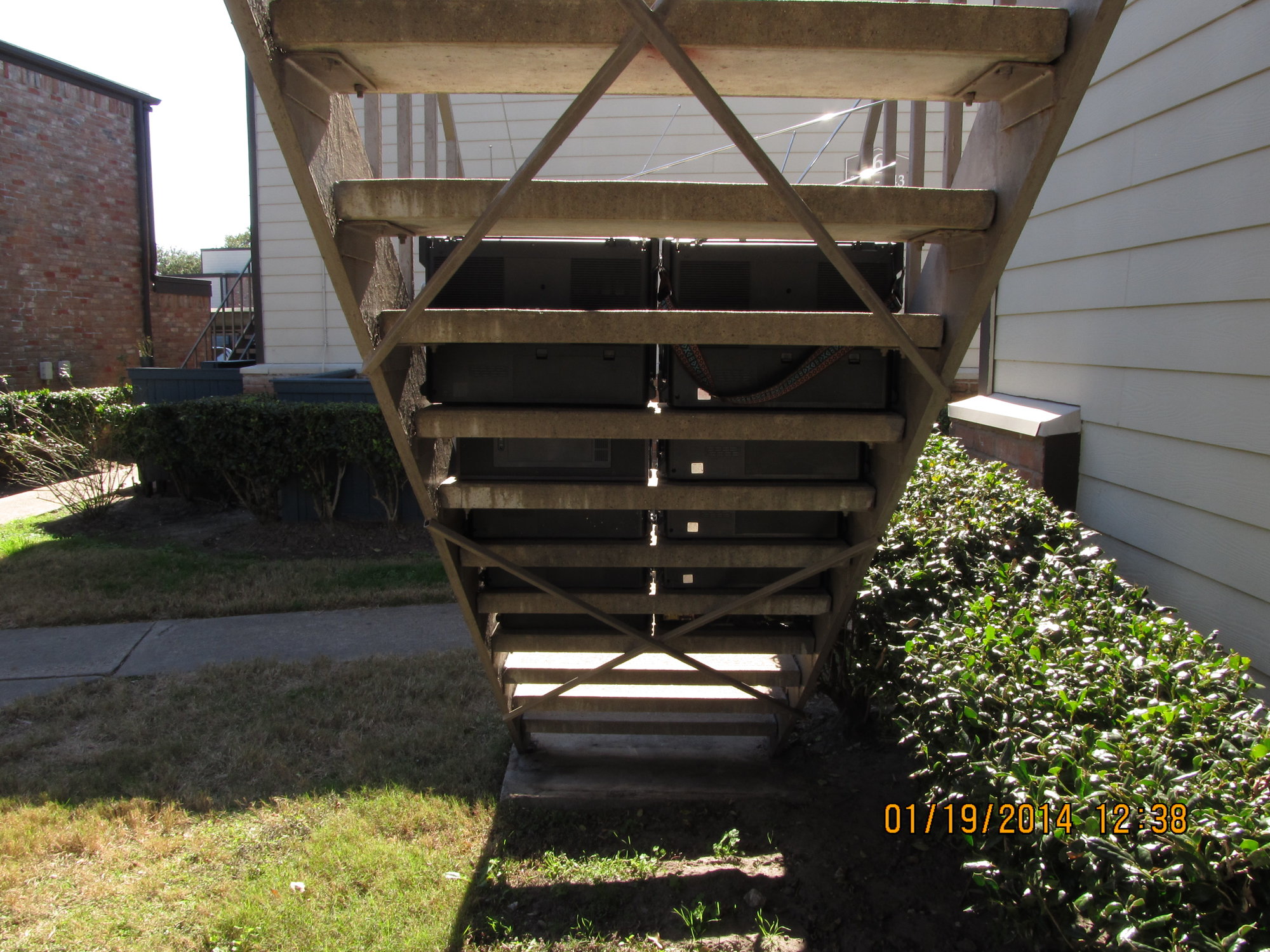

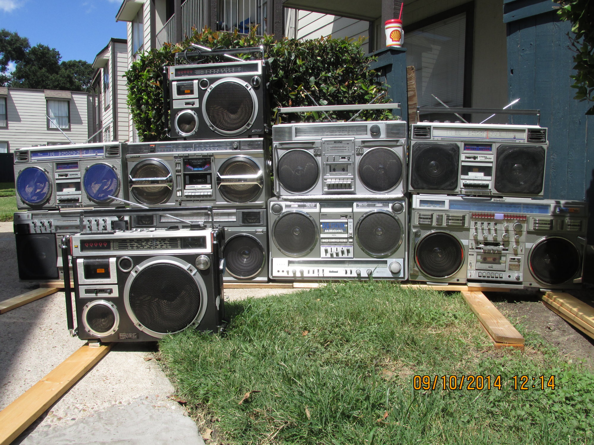

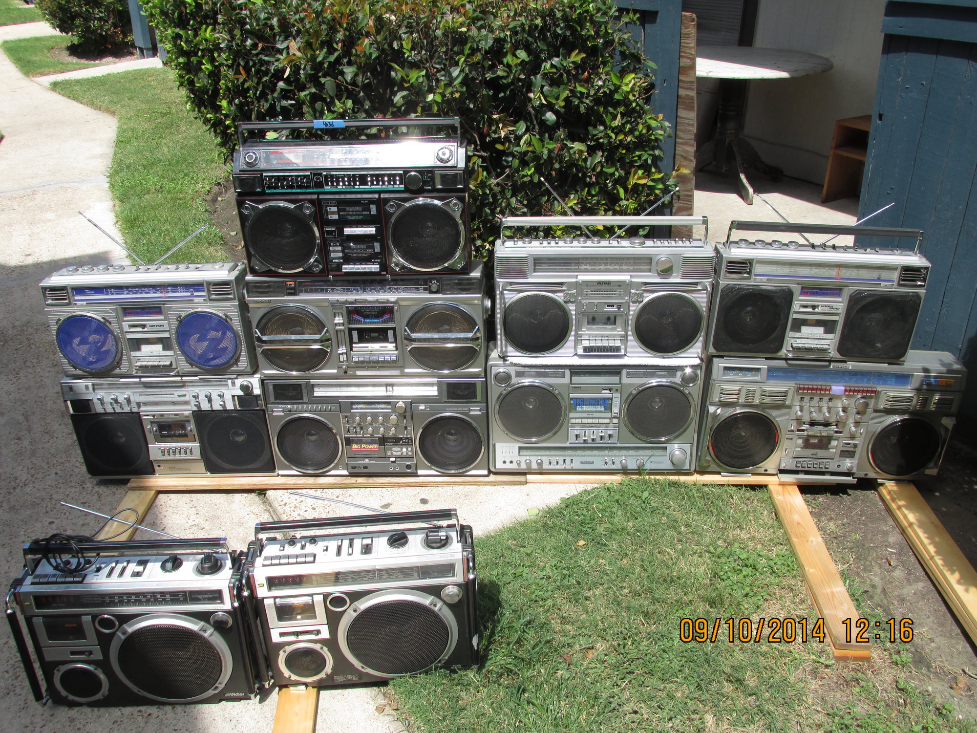

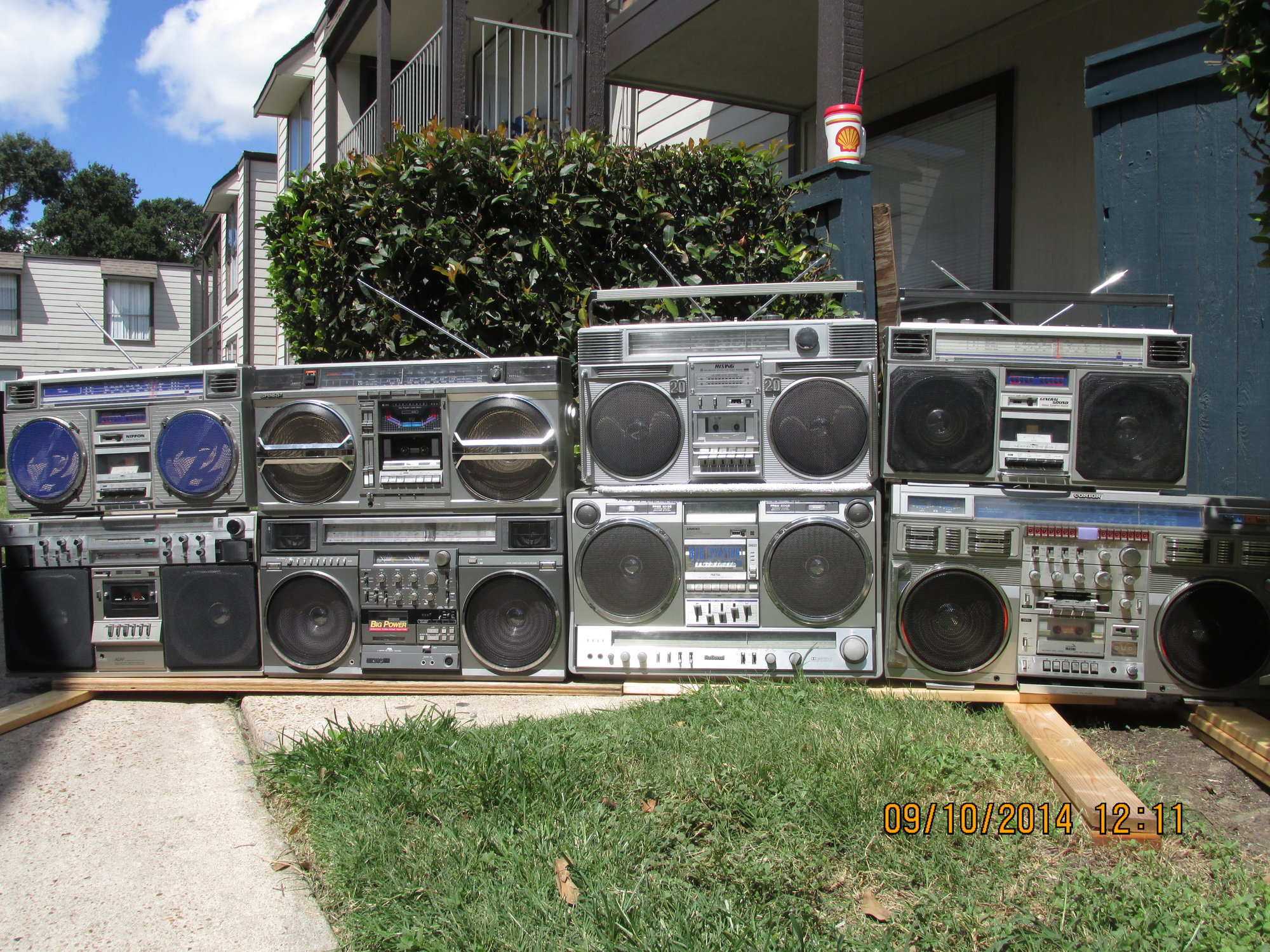

    Here please allow me to be a bit silly and just dump the entire folder of pictures of the Nine I had, ok :)
    and while I am here // here are a few more from a different folder - just for fun :)
    Lastly here is one I just shot today IMG_3470 REI Novarra Aspen AL 24-Speed bicycle James selfie M90 M50 M70 ( with my Canon EOS 70D ) IMG_2068.JPG IMG_2069.JPG IMG_2070 behind 4 Victor 5 JVC RC 550 Boombox9.JPG IMG_2071 4 Victor 5 JVC RC 550 Boombox9.JPG IMG_2072 4 Victor 5 JVC RC 550 Boombox9.JPG IMG_2073 4 Victor 5 JVC RC 550 Boombox9.JPG IMG_2074 side ways view 4 Victor 5 JVC RC 550 Boombox9.JPG IMG_2075 4 Victor 5 JVC RC 550 Boombox9.JPG IMG_2076 4 Victor 5 JVC RC 550 Boombox9.JPG IMG_2077 4 Victor 5 JVC RC 550 Boombox9.JPG IMG_2078 4 Victor 5 JVC RC 550 Boombox9.JPG IMG_2079 4 Victor 5 JVC RC 550 Boombox9.JPG IMG_2080 4 Victor 5 JVC RC 550 Boombox9.JPG IMG_2081 4 Victor 5 JVC RC 550 Boombox9.JPG IMG_2082 Victor RC-550=no shortwave Boombox JVC RC-550=has shortwave.JPG IMG_2083 Victor RC-550=counter Boombox JVC RC-550=Memory counter.JPG IMG_20724 Victor 5 JVC RC 550 Boombox9.JPG IMG_0945 Panasonic Boombox for sale Pictures from Decentman4you video September 2014.JPG IMG_0946 Panasonic NIB box boombox patio.JPG IMG_0947 Panasonic Boombox for sale Pictures from Decentman4you video September 2014.JPG IMG_0948 Panasonic Boombox for sale September 2014.JPG IMG_0949 Panasonic Boombox for sale Pictures from Decentman4you video September 2014.JPG IMG_0951.JPG IMG_0952.JPG IMG_0953.JPG IMG_0954 8 inch woofer boombox.JPG IMG_0955.JPG IMG_0956.JPG IMG_0957.JPG IMG_0958.JPG IMG_0959.JPG IMG_0960.JPG IMG_0962 CW from JVC RC-550 Victor Unisef CX-1430 Nippon FS-2420 M90.JPG IMG_3470 REI Novarra Aspen AL 24-Speed bicycle James selfie M90 M50 M70.JPG

    @Cassette2go it looks like I officially hijacked the OP... Oops!!! ;)
    I never realized that its Your photo of a dozen Diablos on the fire-escape which haunted me!!!!!!!:mad: Totally Wicked!!!!!
