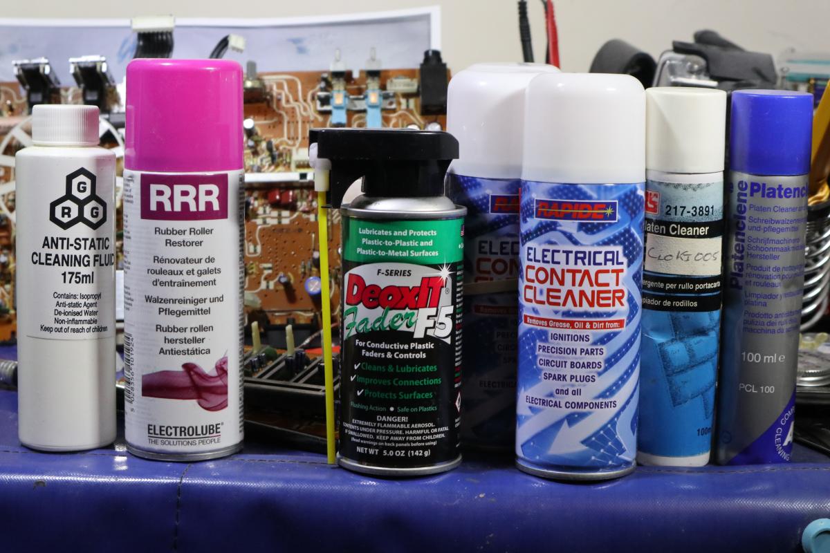

    OK - this sounds a bit bonkers, but before I embark on this, I'm checking my cleaning materials before I potentially do something stupid. I'd rather look like a dumb ass, ask advice and do it right, than potentially do damage to all this.
    For the faders and things I would normally use the electrical contact cleaner, followed by the Deoxit F5. I'd also tend to use the same things for the pots as well. Is it really advisable to use DN5 for the pots instead?
    For the heads, is the anti-static cleaning fluid of use, or should I toss that and use unmixed isoprop/meth instead?
    Regarding the pinch rollers, I do have some platenclene and some rubber roller restorer that I believe are hung on from my days as a hardware techy, working on MFD's and the like. So, are they of use in boombox/walkman repair, or should I toss them out?

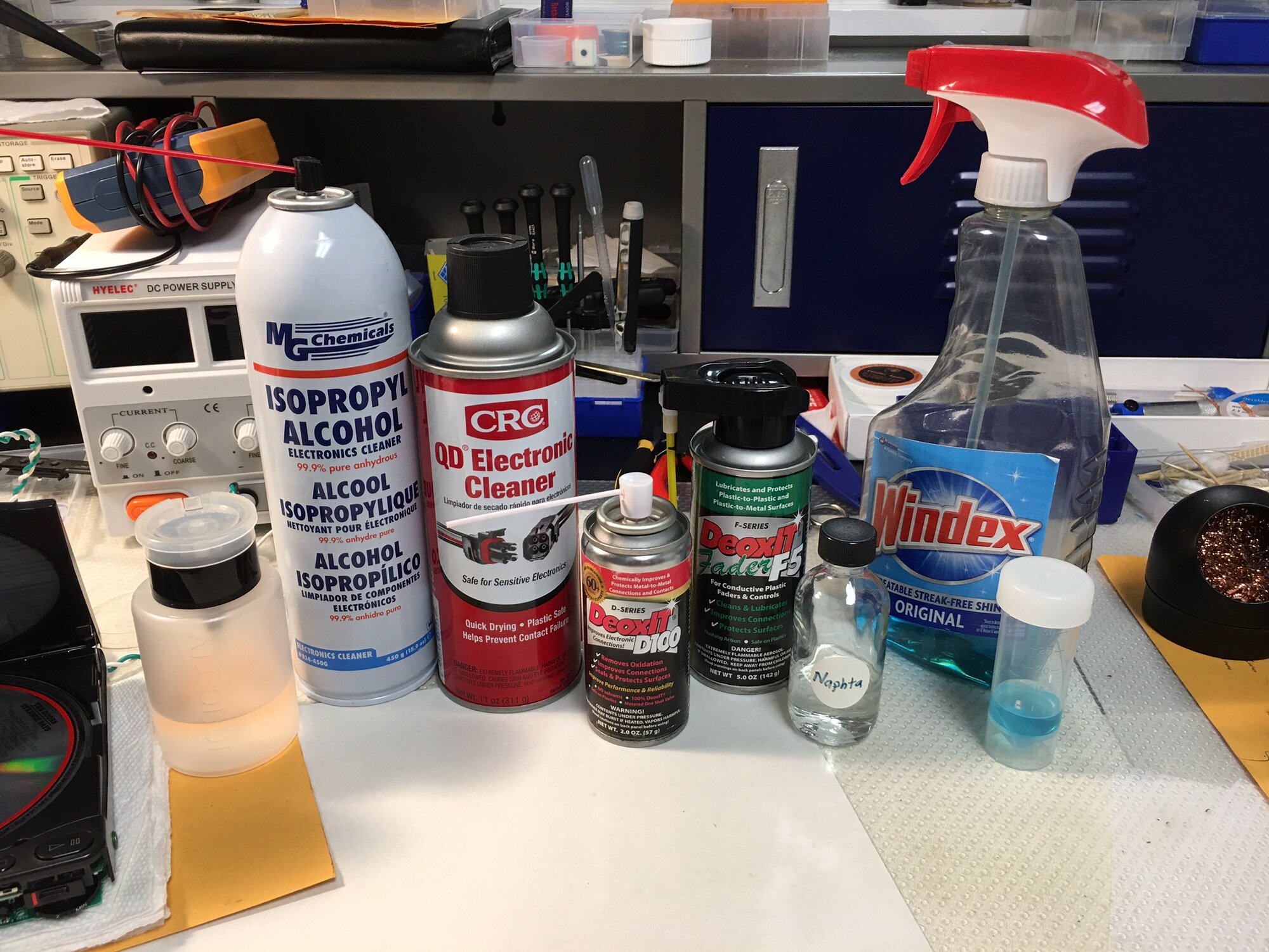

    Here is mine:
    Haven't used F5 yet, but I think it was @Longman or maybe @Mister X who said it must be used for the sliders instead of D100 so I bought it. Naphta lacquer thinner works magic on pinchrollers and rubber tyres, at least on those which still can be 'rejuvenated'
    What is anti-stat fluid for? To demagnetize cassette heads I use this cheap gizmo:

    The anti-stat fluid ... that was originally used for the cleaning pads for floppy disk drives. These days I mostly use it to clean my glasses.

    ... plus it will take a-while to clean bbox with a Windex! ;) I use Windex for Discman's cases only. Not sure about the sheen, but you should never-ever use Windex on dusty laser lenses (if bbox has CD): any ammonia-based cleaners attack glass. I will try to find some of my photos taken under epifluorescent microscope from the slides I washed with Windex: instead of a black background you have a night sky with zillions of stars and nebulae as a backdrop for the sample :confused: A few years ago Leica rep left me a few cc of some household cleaner safe for optics, but since I did not catch the brand, I use Carl Zeiss Lens Cleaning Spray for my eyeglasses or any lenses
