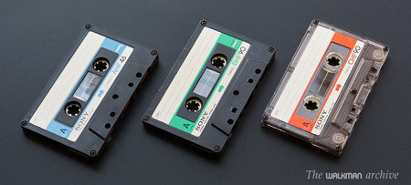

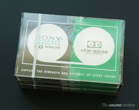

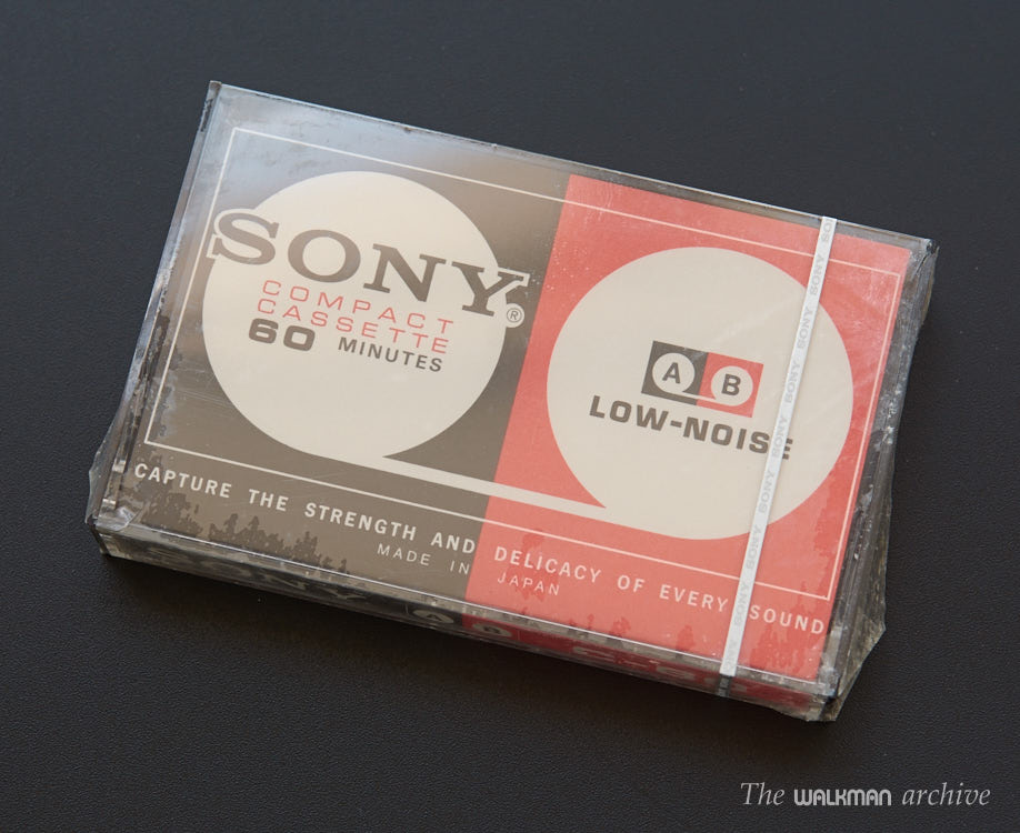

    While I was in travel for a work, I could take a walk and see some old electronic stores that still survive since the 80s and 90s. Luckily I could find some brand new, SONY sealed cassettes there… but I didn’t figure out what did I really bought until later…

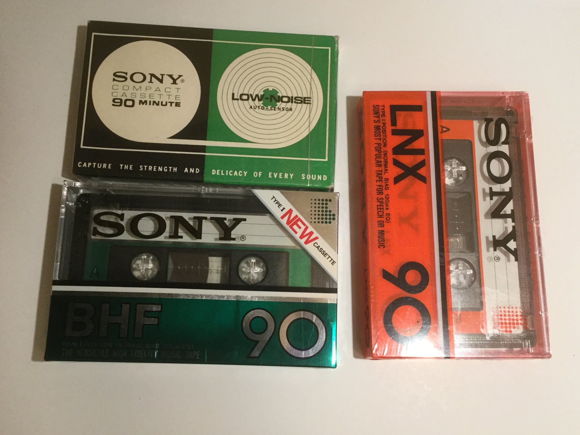

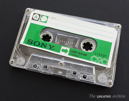

    Then I came home with my trophies and took some photographs of them. Luckily I got 3 sealed cassettes, so I thought I could open one of them and do some tests with it. I was very curious about the sound quality of a cassette from the early 70s. My surprise came when I open one and I saw many signs of low quality… how could a brand like SONY make those mistakes?
    Suddenly I realized that was not an original SONY cassette, especially when I put it into my K909ES: the quality was horrible. Truly horrible, the worst cassette that I’ve ever tried, by far. Not only the hiss was high, but the output level (MOL) was very (and I mean VERY) low and there were also other issues. Then I remembered that in those years there were clone cassettes, not very easy to find in some places, but yet not that uncommon.
    Without knowing it I bought my first clone tapes! Some time later I got a few more used tapes and there came some SONY from that era, so I thought I would be nice to make a comparison between them.

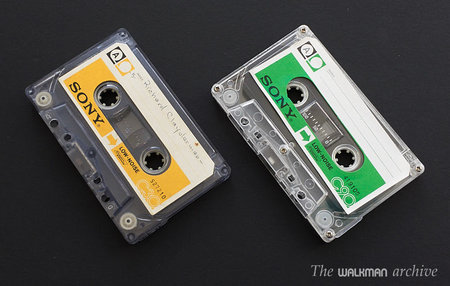

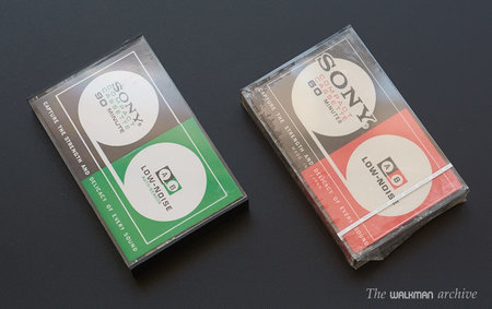

    Left: clone, right original.​
    In the photo above there can be seen a few differences between them that I think correspond to the real designs. I mean: the green one (clone) must be probably identical to the original. The real difference between the original one is probably the lack of alignment between the printing plates. If you look closer, you’ll see some misalignment between the red and black ink in some places. But the original one is perfectly aligned.
    But things get more interesting when I start to analyze the sound. While the original one (I didn’t open the orange one, I used another already used one) sounds ok (pretty good for such an old tape) the clone sounds more like a piece of magnetic junk. I love cassette designs from early years. The look very opaque with that small window. SONY had some nice designs that I really love, like these ones:

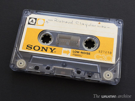

    I tried to calibrate the original one and I had to push the Rec Cal a bit (not very much, though) and lower the bias a lot, almost 90º counter clockwise. Then it sounded pretty good. It had not a very high resolution and not a very low noise cassette, but it still was OK.
    An original one. Not the very same one (this one is C30) but definitely the same kind and -probably- same performance as the C60.

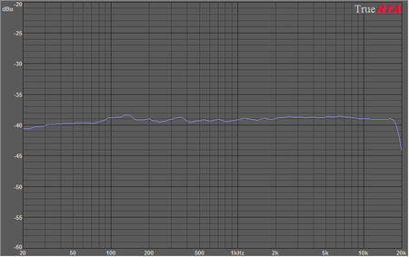

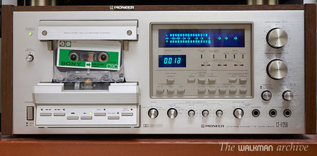

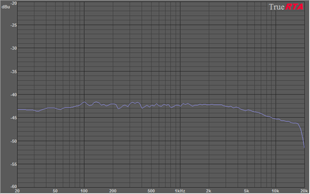

    I decided to take some measurements with the oscilloscope both to the clone and to the original one, in my K909ES. Here’s the response at -20dB, which usually gets very flat with almost all tapes:
    As a reference, here’s the response of the original cassette with same conditions:
    As you can see, the original one is pretty flat until almost 18 kHz while the clone starts to fall off at 3 kHz for up to 4 dB until 18 kHz. And that’s with the minimum bias!

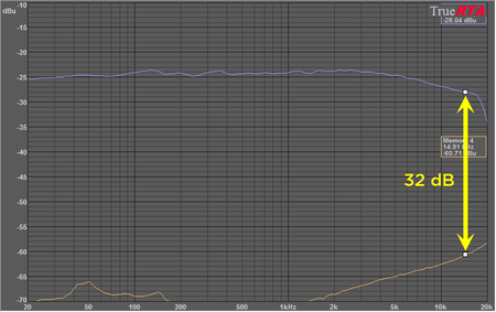

    Then if I compare the difference between the 0dB level and the background noise, it can be seen this:
    And the difference between the maximum and minimum level is only 32 dB! As a reference, a good chrome tape has about 58 dB, which is 250 times lower!

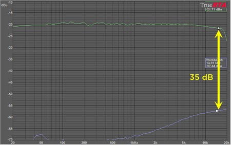

    Where we can see 35 dB, which is two times the dynamic range and also the background hiss is half the level of the clone. I haven’t measured the distortion of both them but there’s a big difference for sure and I can clearly hear it. Finally, here are some sound samples.

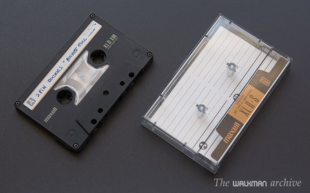

    I have used a Maxell XL-IIS recorded in my SONY K909ES using the original release CD as source, encoded with dbx. I recorded onto the clone tape both without NR and with dbx, calibrating to my best (as previously described).
    The source tape. Forget that label that says "Spin doctors"; I just didn't deleted it, but I have over recorded it.

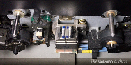

    Final note: after only 10 minutes recording, this is how the rollers on my K909ES looked like. I had cleaned them before putting it and, obviously, immediately after seeing this…

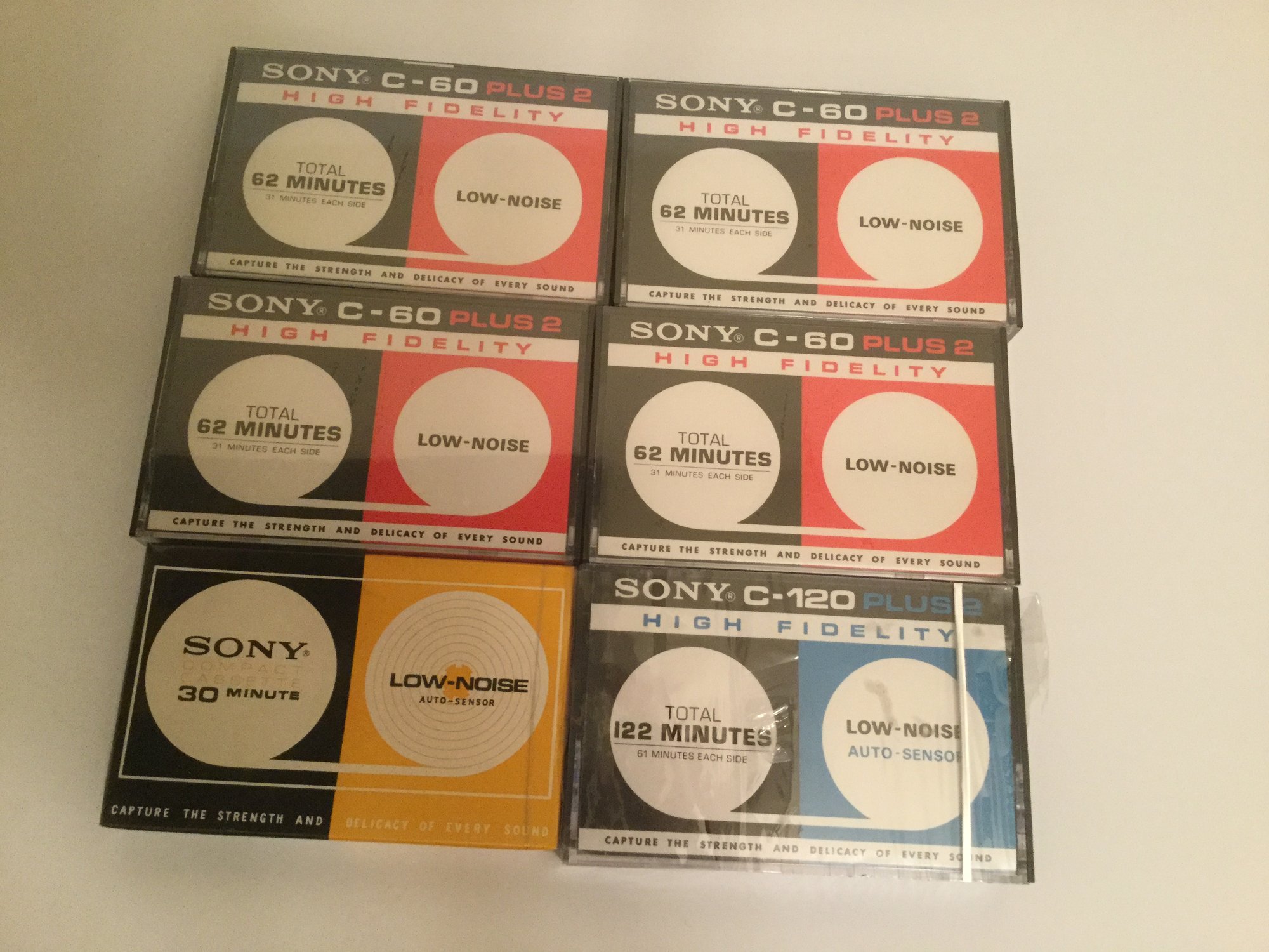

    Interesting, I found a couple of those Sony C60 tapes the other day at a estate sale. The case is made of cardboard and doesn't have a plastic case.
    Some pictures: http://imgur.com/a/o53Pk

    Those ones look like original ones. I've seen that cardboard case. My friend @mankamaz showed me some he found at flea market.
    PS: Just FYI: http://www.stereo2go.com/forums/threads/how-to-post-photos-in-the-forum.53/
    Post some detailed photos of the case and we quickly figure out if it's original or not...

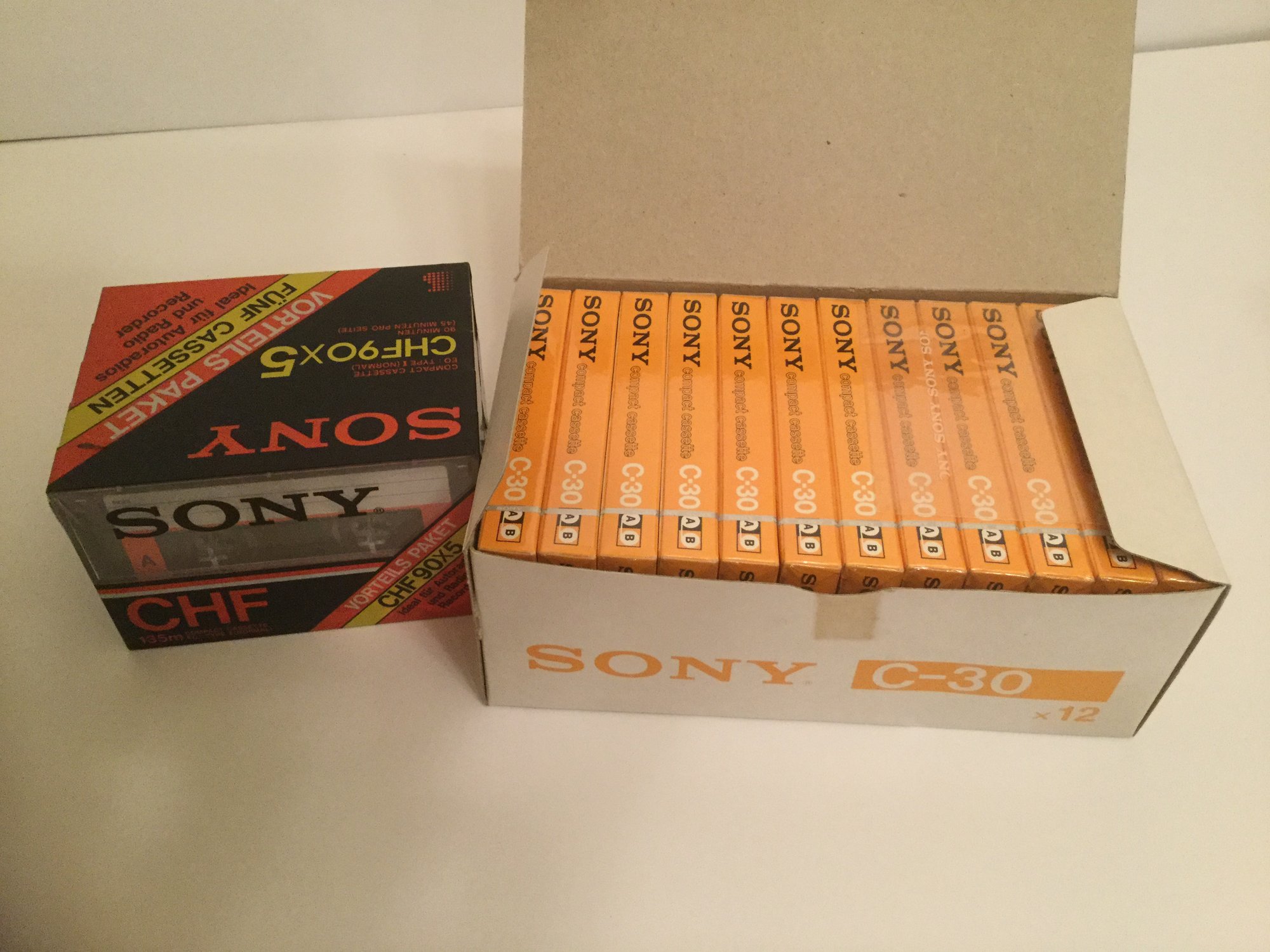

  5. AE_Stereo
    AE_Stereo Member
    85
    UAE

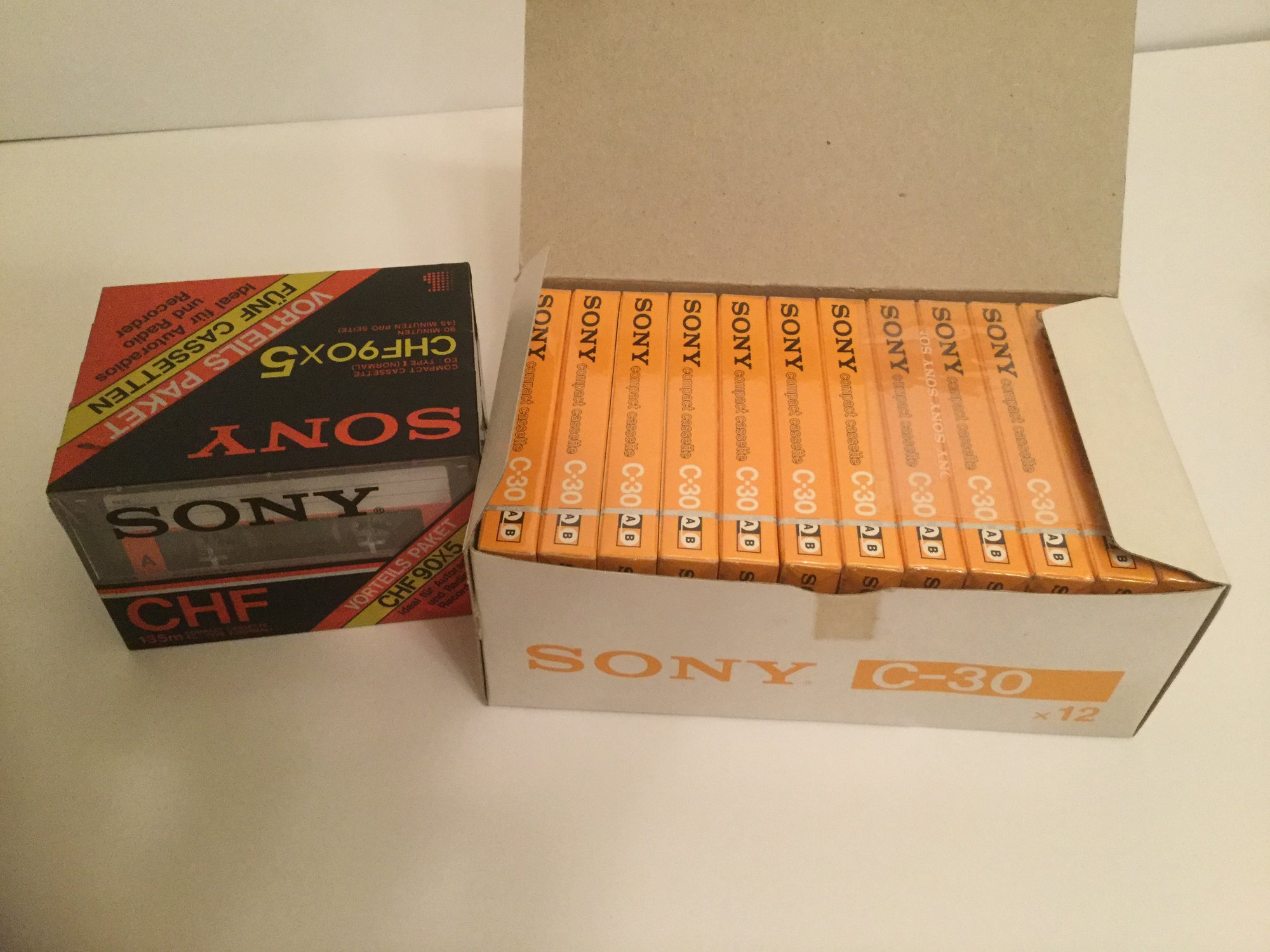

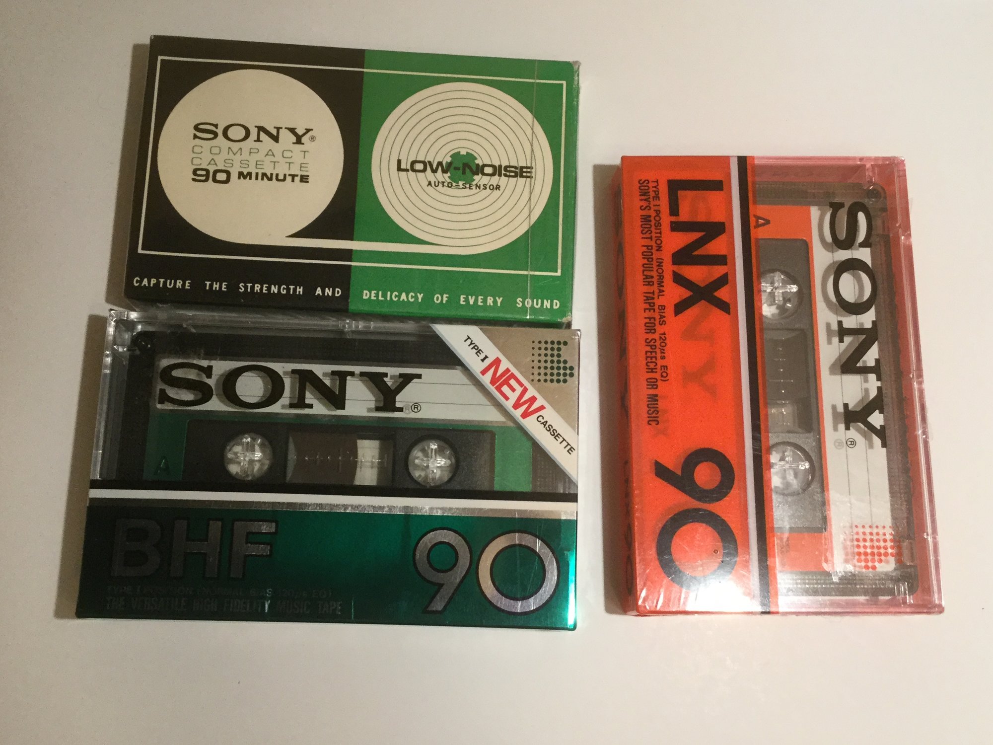

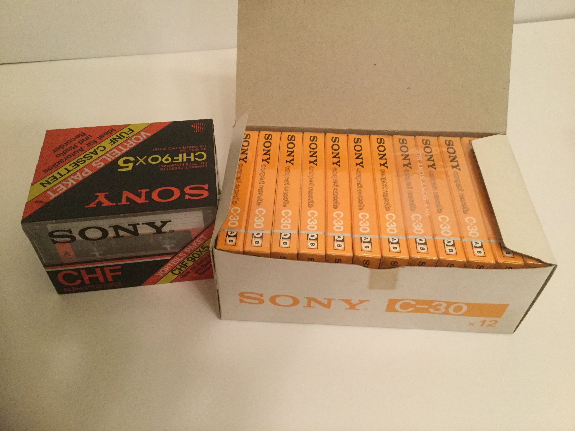

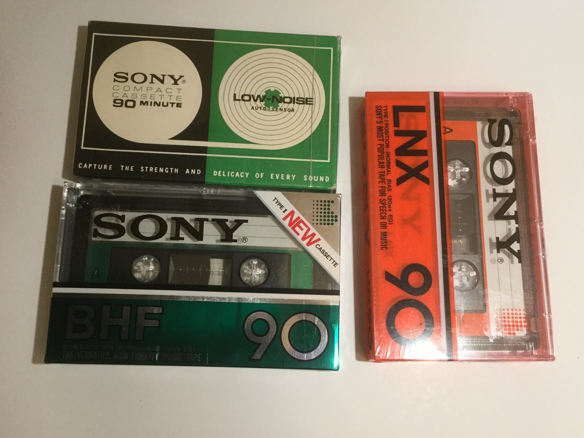

    It was a common problem back in 80's & 90's to get clone tapes. The most I have seen is the Sony CHF (the right most one in the below picture).
    The problems with these tapes were more than just sound quality.
    It will shed the oxide coating as if sanding with sand paper while playing. In fact the head will get clogged in 2 minutes of playing. If you just touch with finger, it will come off in some cases.
    Also, some of these tapes will make a screeching sound from the head while playing and some times it reaches to the speaker as well.
    And back then when we didn't have a good deck to make our own mix tapes, we used to avail the service of some recording centers run by individuals. They have collection of all titles available in either LP or cassette form and they will make mix tapes for a fee, which is their business. (Copy right laws were not implemented strictly at that time in those places)
    However, what happens is, often when we get back the recorded tape, we found that the tape inside would have been replaced with these shoddy quality fake tapes.

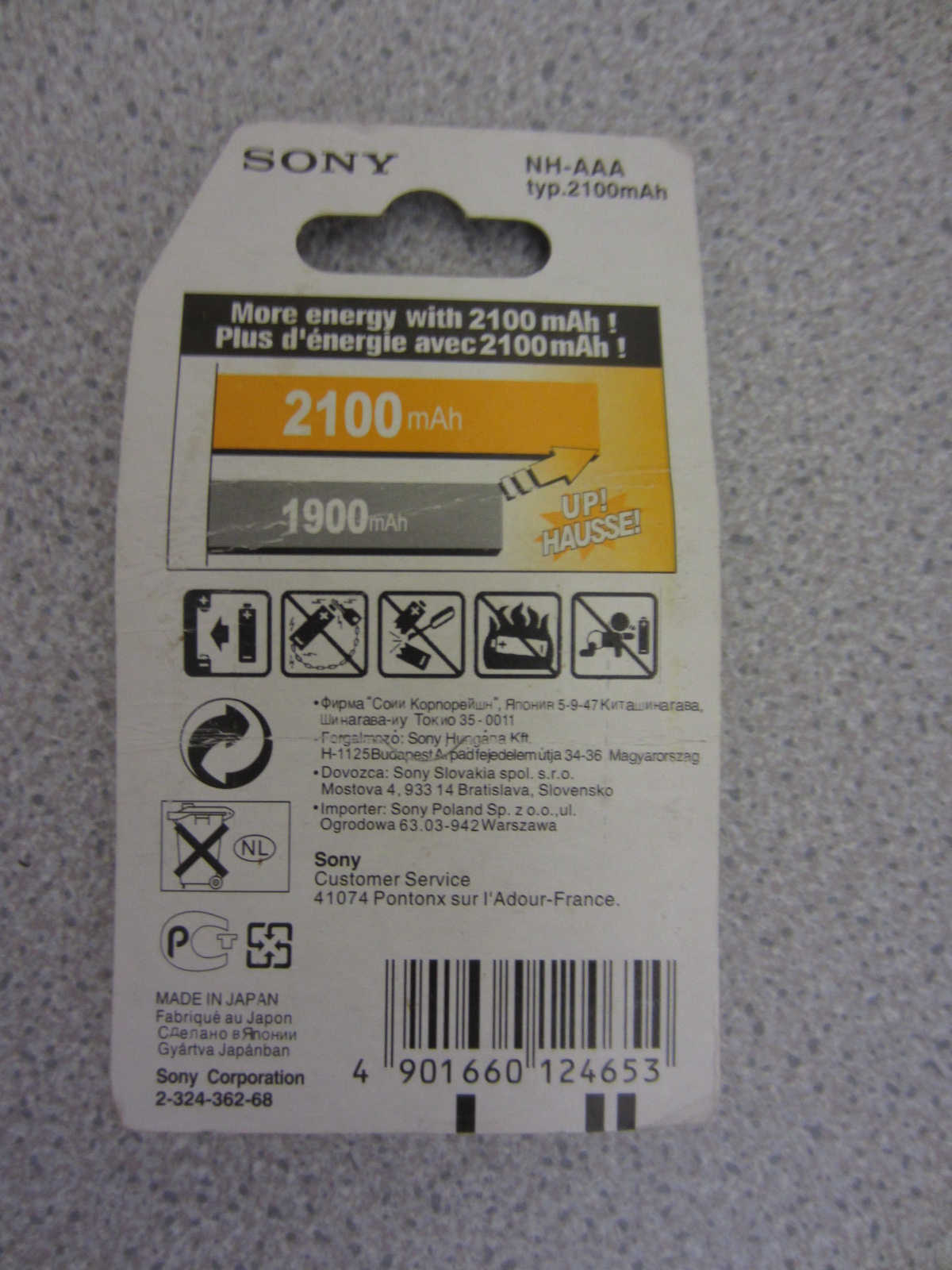

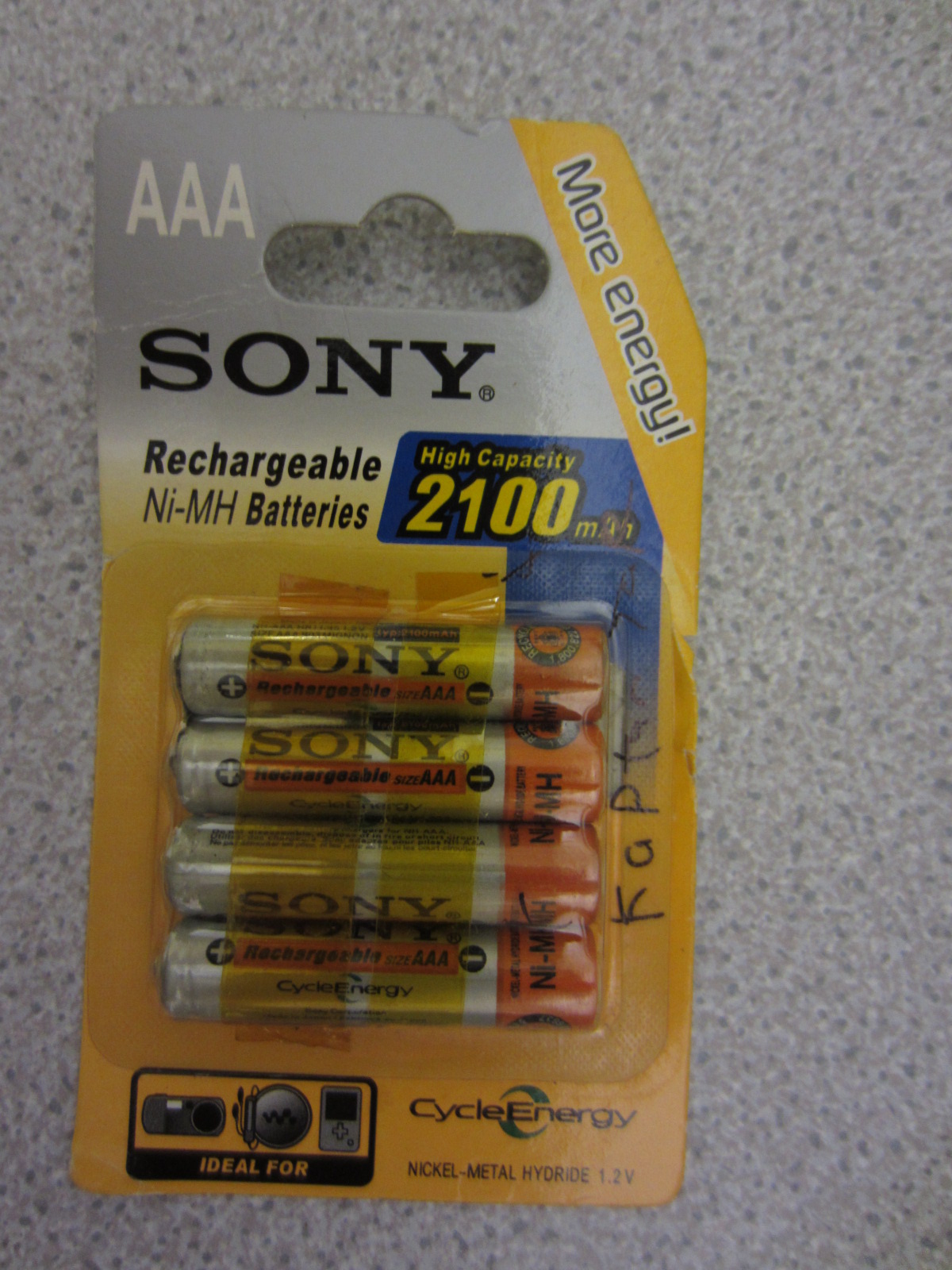

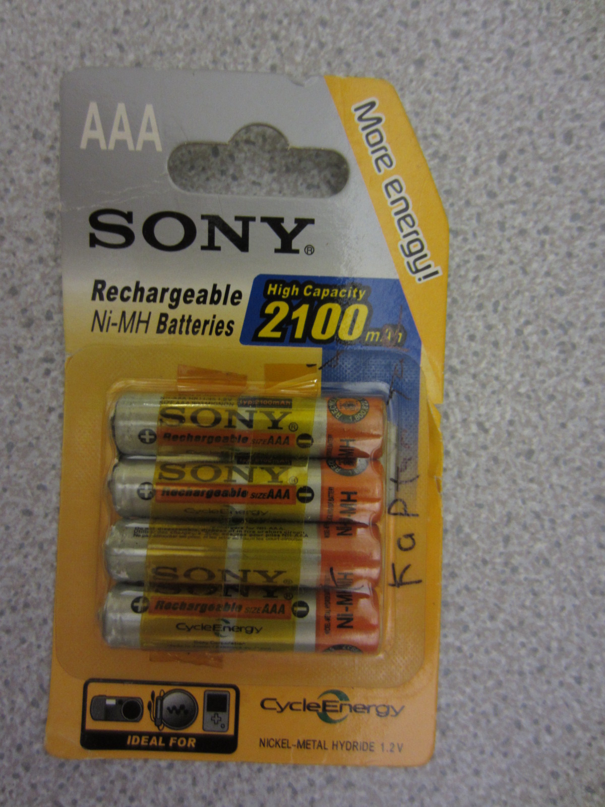

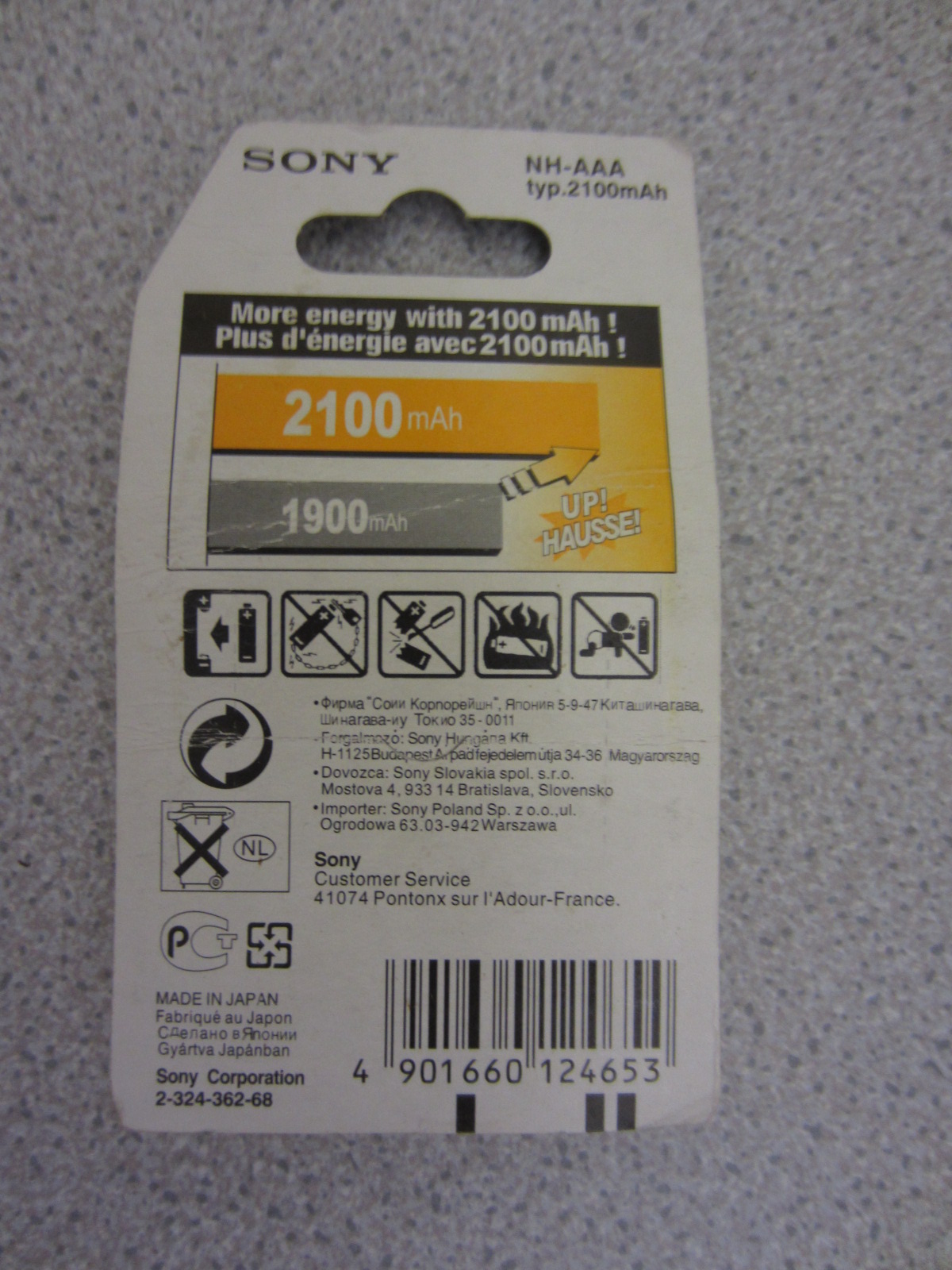

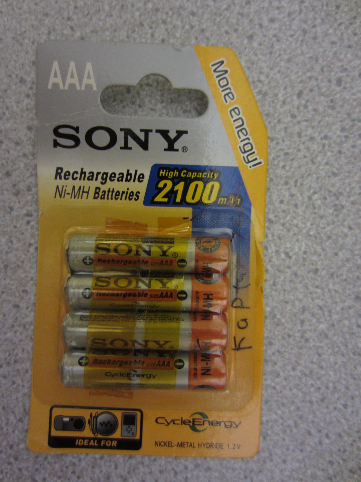

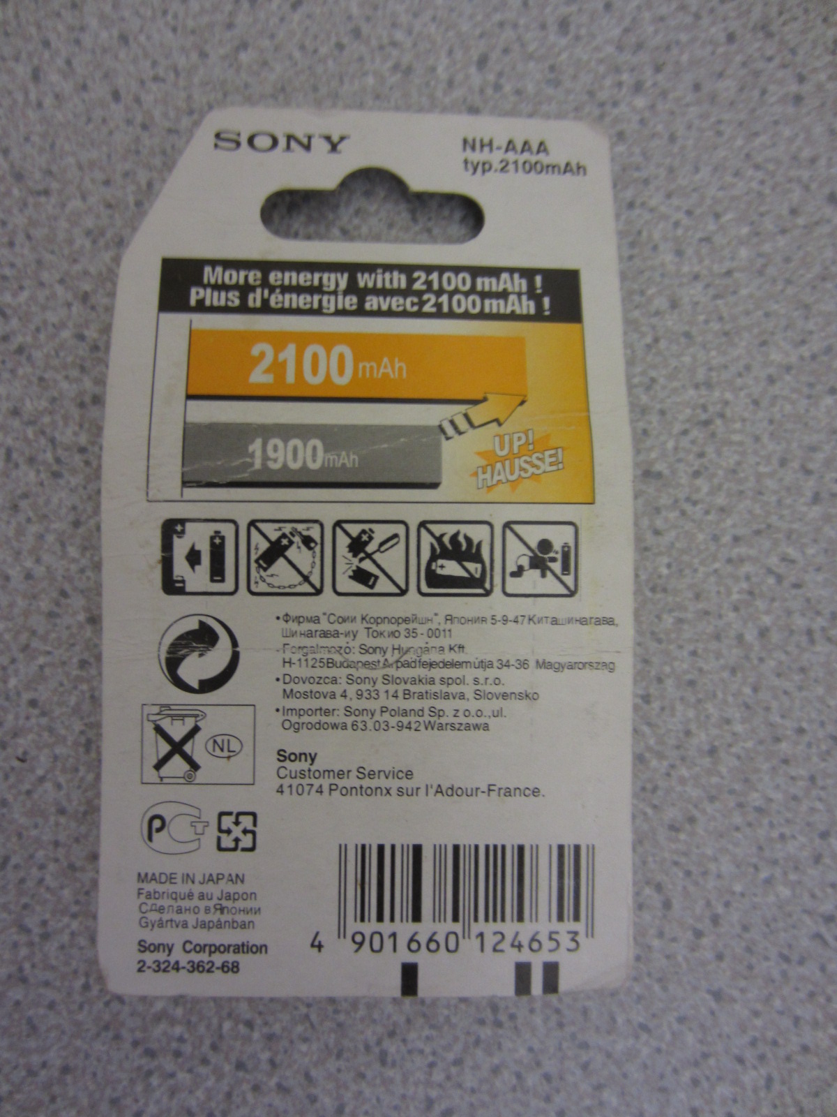

    It is not just tapes. I still can't believe I fell for these:
    Ignore the Kaptan tape on top of the pack. Storing it is the only thing these are good for.
    2100mAh seems quite believable for a NiMH battery but AAAs? :crazy

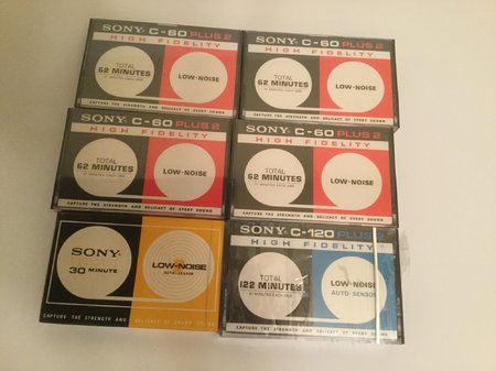

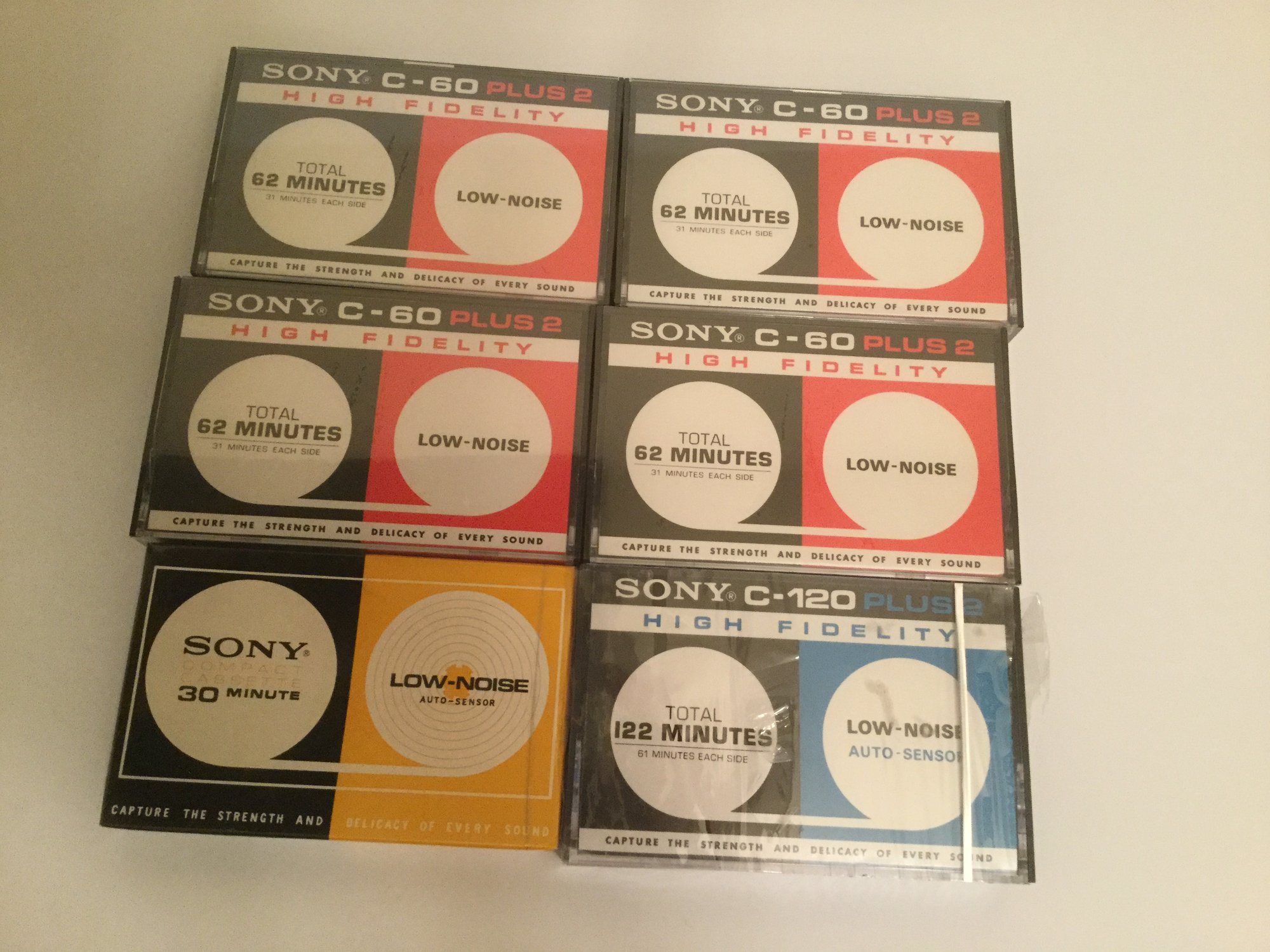

    IMG_1580.JPG IMG_1581.JPG IMG_1583.JPG These are some of my Sony cassettes that are similar to those models. Mine don't look like replica
  8. walkman archive
    1,881
    Wow, yours look awesome. I'd like to find a few in mint or sealed condition to make some tests. I'll look for some

    1,881
    Indeed it's very strange to see AAA batts with such high capacity when some of the best today only achieve about 1000mAh...
