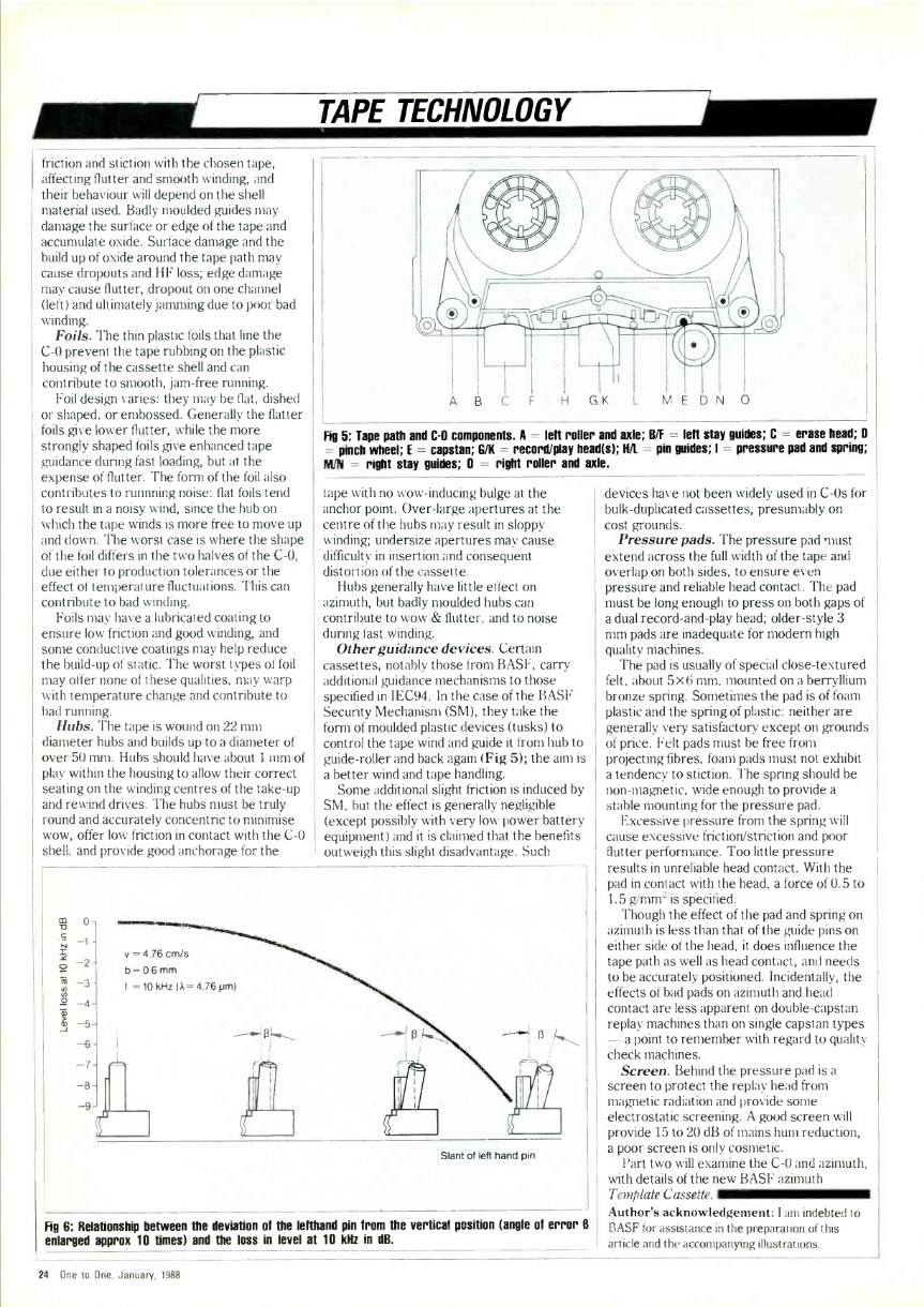

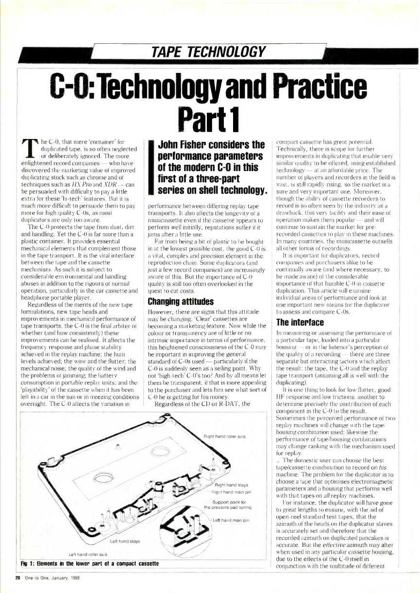

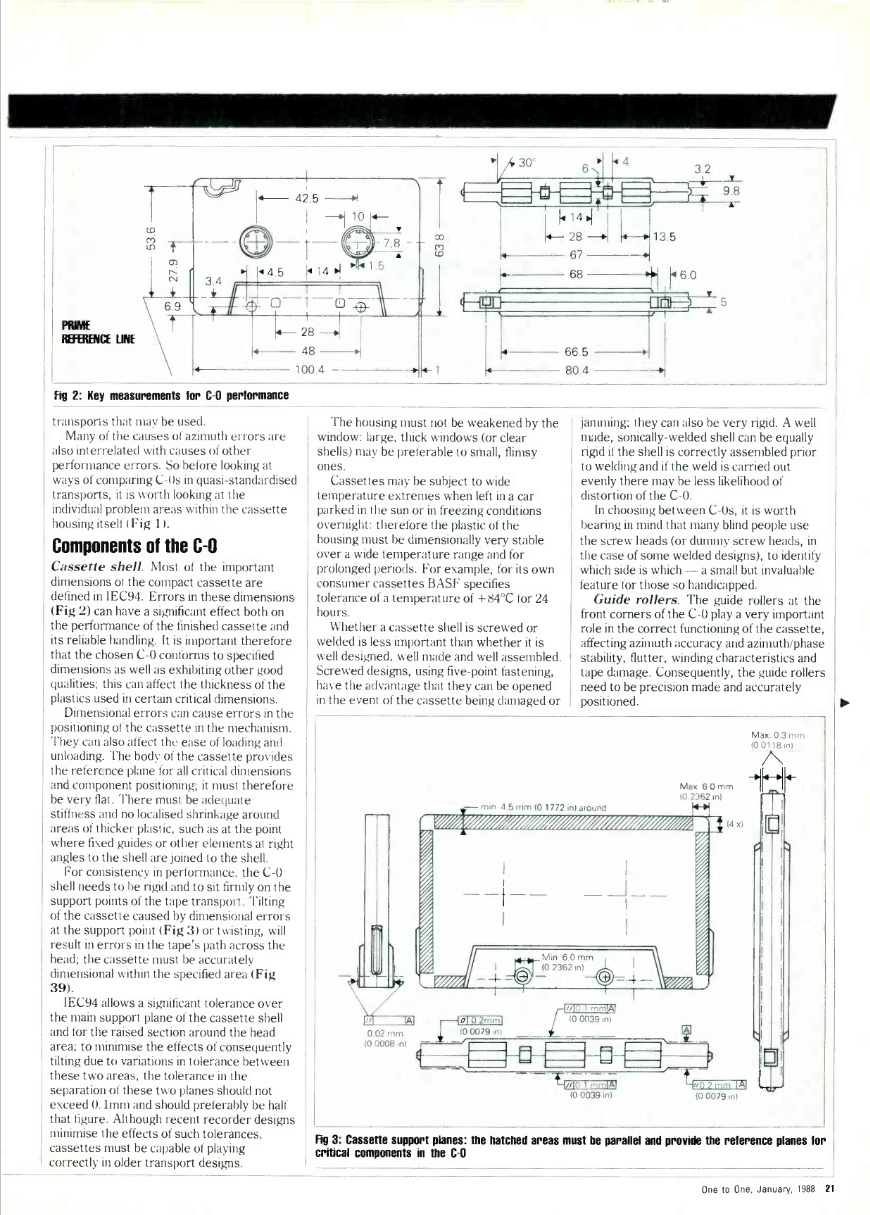

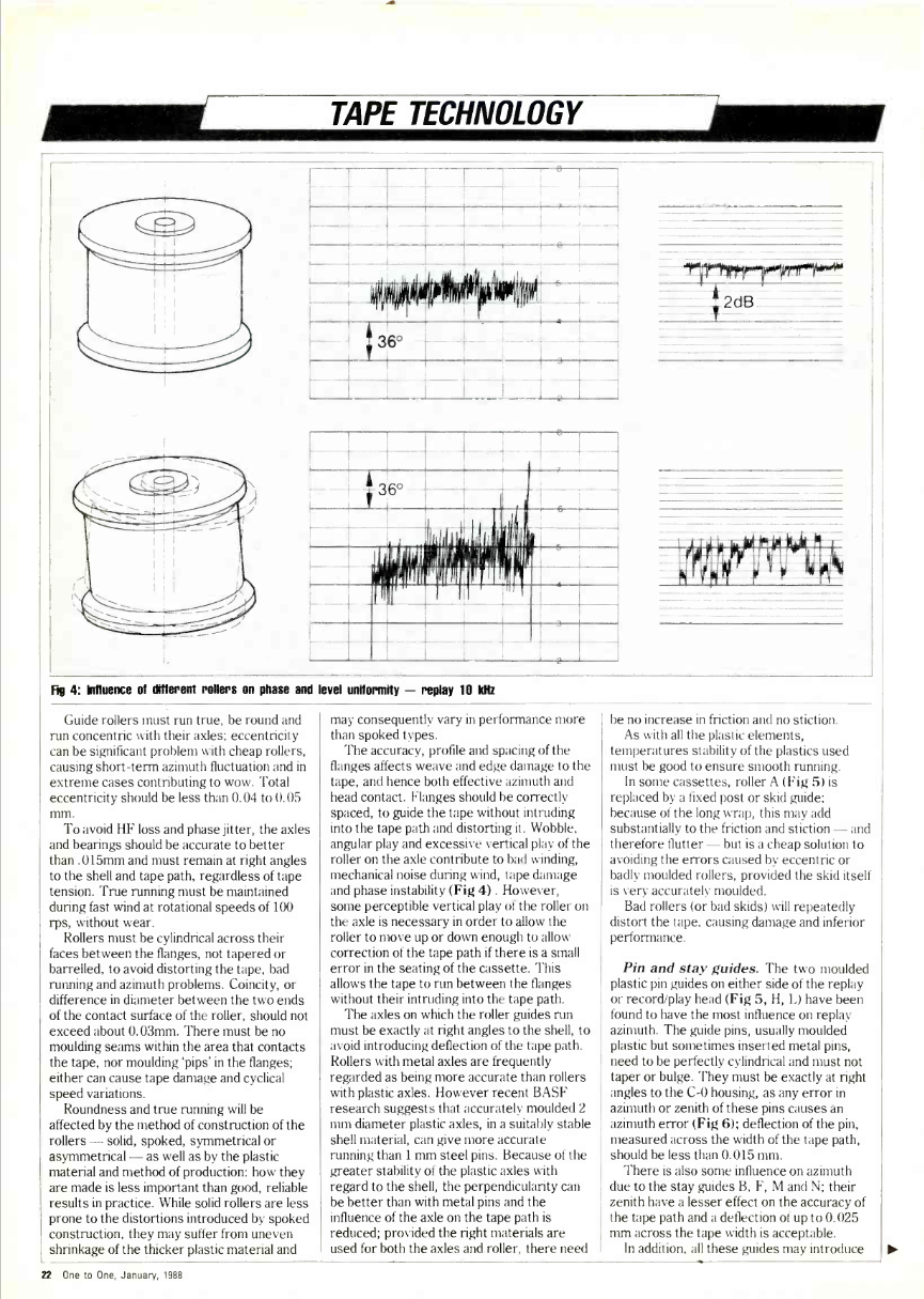

Cool Technical Article on the Cassette Shell
Discussion in 'Cassettes' started by Mister X, Mar 28, 2020.
    16,833
    From One-to-One Magazine, 1988 found on the AmericanRadioHistory Website
    Jorge and Deb64 like this.
