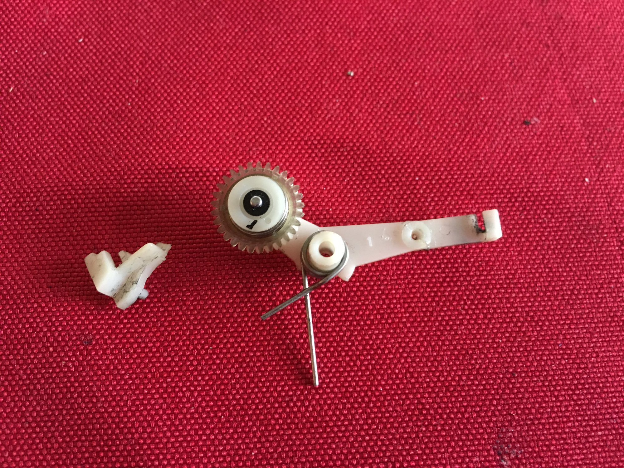

    Hello again!
    I posted here a few weeks ago about my Panasonic recorder RX-S28, and the broken nylon part that I found. Unfortunately I didn't get any respond for this post. I guess this recorder is not very popular/ important ;) I'd like to know, if you may, if there is a technic to create a copy of this broken part. I searched about 3D printing option and I found it too pricy for this matter. I wonder if I could find some affordable way to recreate this part, also, maybe there is an option to make it from other material? I read a lot about how challenging it could be, to mold a nylon part. Considered that it is not a gear, it only host the two gears, maybe there is a way to prepare it from different material - What do you think?
    * I give up for the option of gluing it, the glues are not strong enough to keep such small part intact, especially when it has to be under continuous friction/ pulling weight from the spring it has above it.

    One very cheap technique which might work is to use glue but use some kind of reinforcement of the joint. In some repairs I have drilled a small hole through the two parts and put something metal like a pin through the hole before glueing.
    Alternatively (now I have had a better look at the photo) put a very thin sheet of metal (like a washer) over the join i.e. underneath the spring. What you need to do is make more area for the glue to hold. As the repair will be inside the Walkman go for strength rather than prettiness.
    For glue I would use some kind of slow setting epoxy (which tends to be the strongest). Super glue tends to be a bit brittle and not very good on some plastics.
    Otherwise keep looking for similar Panasonics and swap parts over.

    Hey Longman! Thank you so much for your response and thorough input - I'll definitely try this pin/ metal technique - I'll update when it's done. You're 100% right about the way it looks - I don't care about it ;)

    Many nylon parts with spring tension on them will break.
    No glue seems to work on nylon.
    If theres extra space you could fix it
    what does it look like installed ?

    Hey folks... I've tried the drill and pin/ epoxy method that seemed sturdy enough after drying, but when I placed the tension spring... it started to break apart. So, I don't think there is any cure for a broken nylon part. The only solution in the future will be finding cheap 3d scan and print. These days it could cost $200 for creating a 3D file and print it. I could buy probably at least 4 working good recorders for this price...
