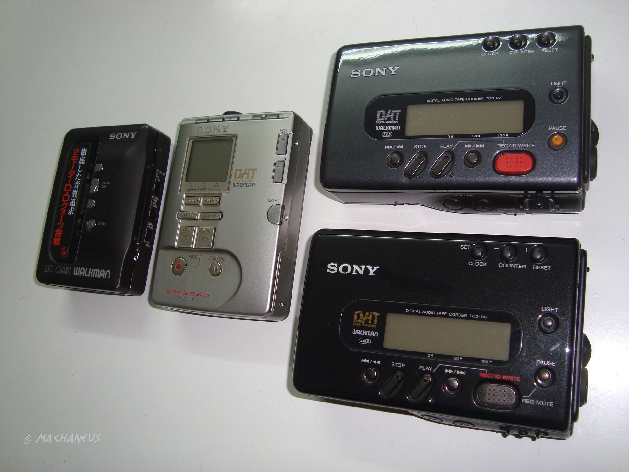

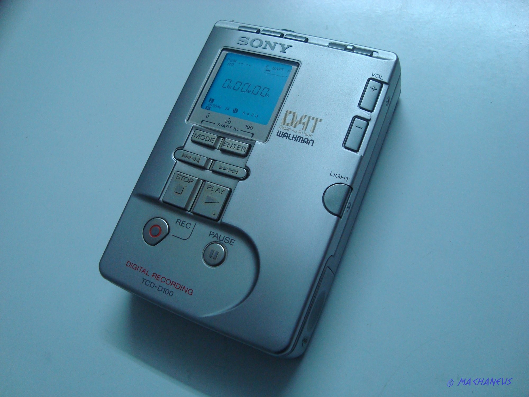

    Having said that, I love DAT and have a small collection, a Sony TCD-100 , a Sony TCD-7 and a Sony TCD-8 ,all great , I won't get into comparison details but TCD-100 is my absolute preference with its handy size and somewhat better quality construction (titanium shell I think) and of course the looks.

    My DATs , (Sony WM-DD9 is there for size comparison).

    @Machaneus The TCD-D100 really seems like a nice device especially in size, though it's probably out of my league considering the prices I've seen. Some (in good to mint condition) seem to be sold for around 600€, that would be more than the max. budget I could bring up for DAT equipment right now. :scratch2

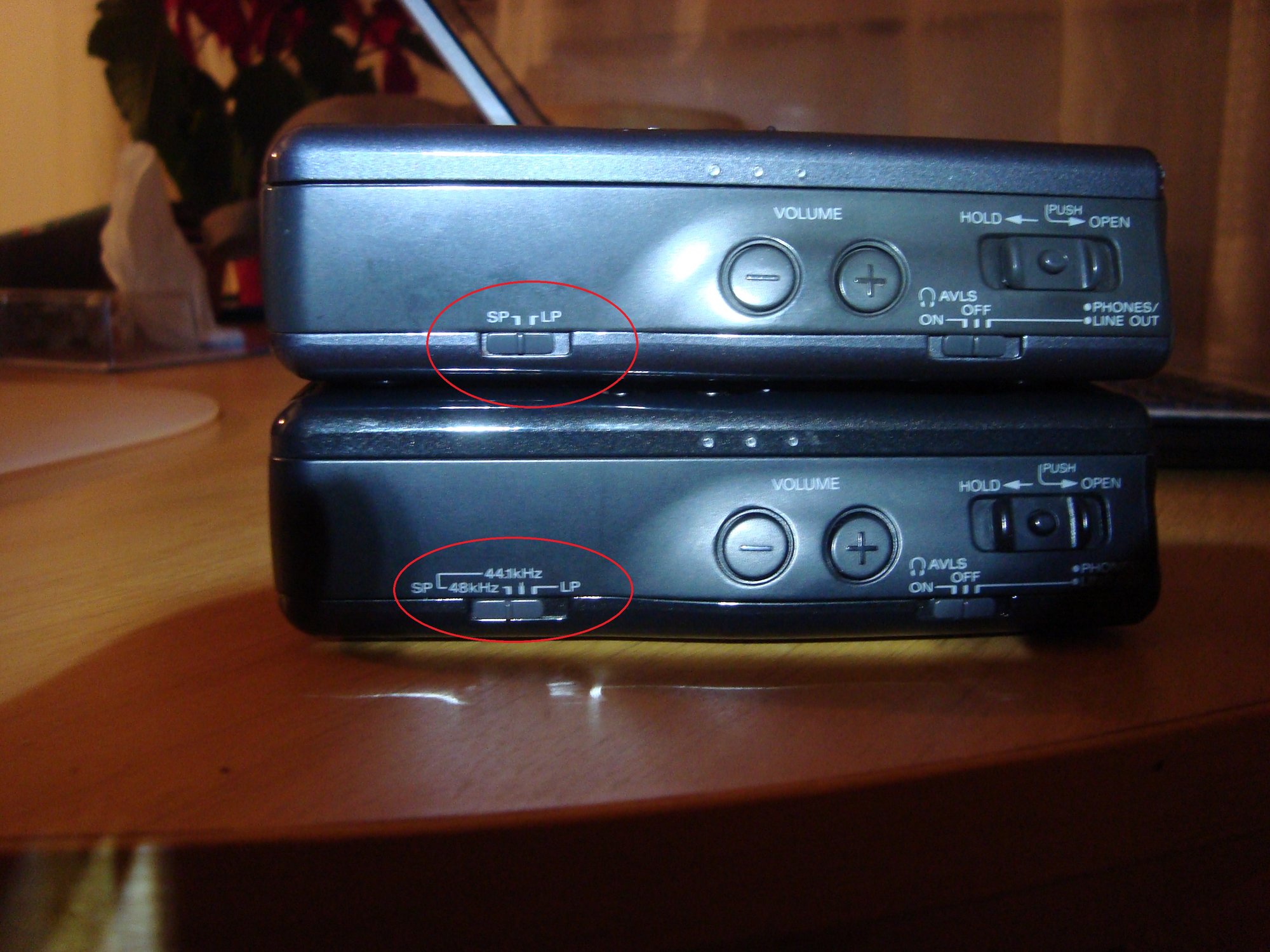

    Externally TCD-8 has a darker color than TCD-7 and SP position has a choice between 48Khz and 44.1Khz ,since I bought mine both used I can't be certain but TCD-8 seems to be more stable , no interrupts during play ,TCD-7 some times interrupts but that varies depending on the recording.In general TCD-8 seems to be an evolution. Soundwise can't detect any difference.

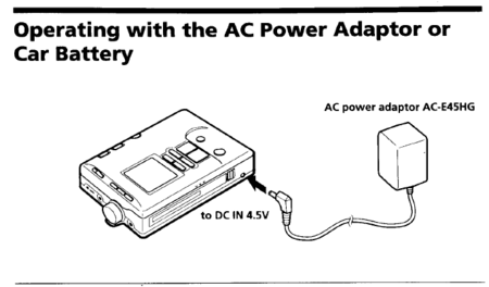

    If finding the adapter prevents you from buying this TCD-100 , you'll need the one below that you can buy for about 10 euros here.
