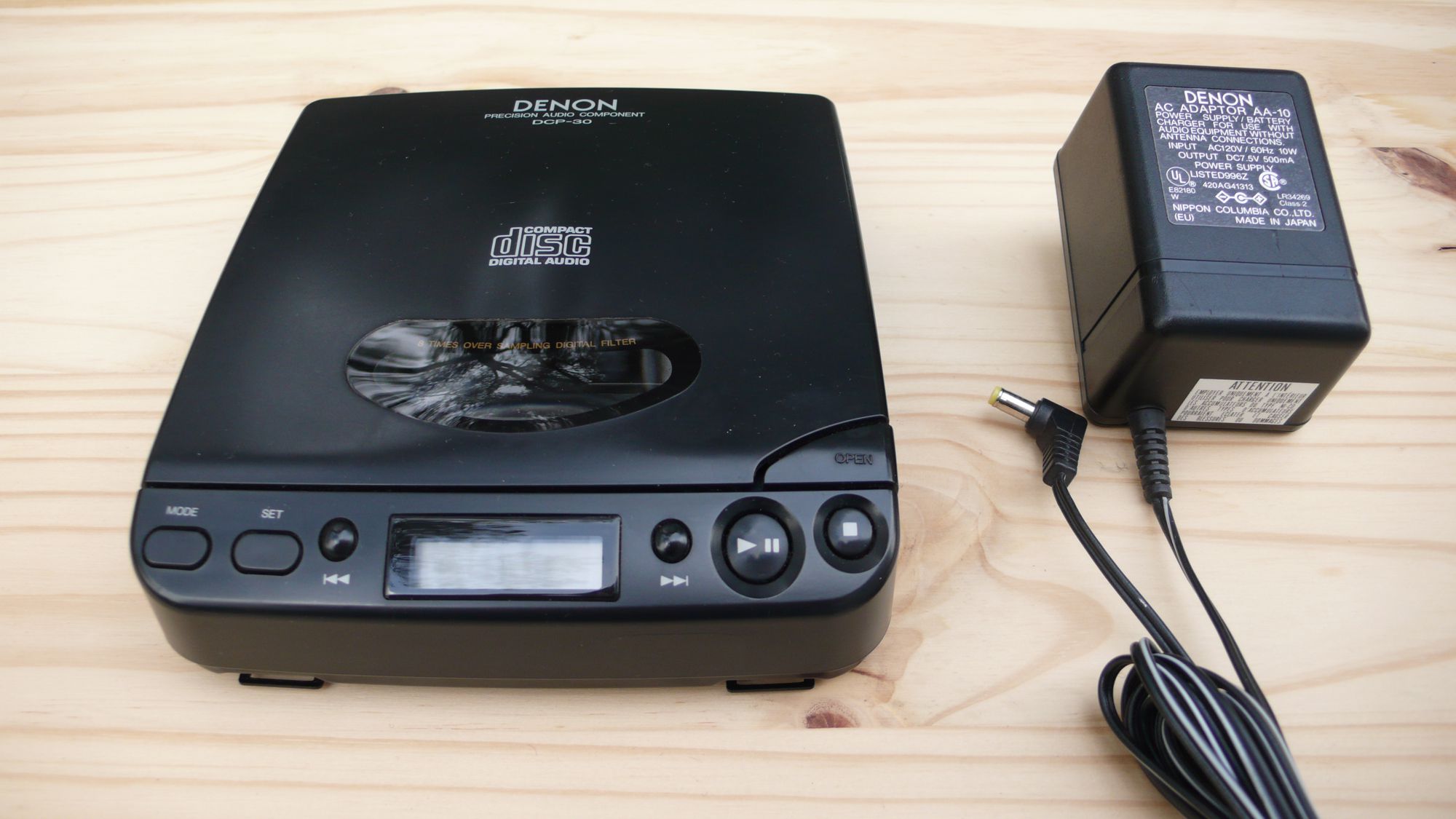

    Hi

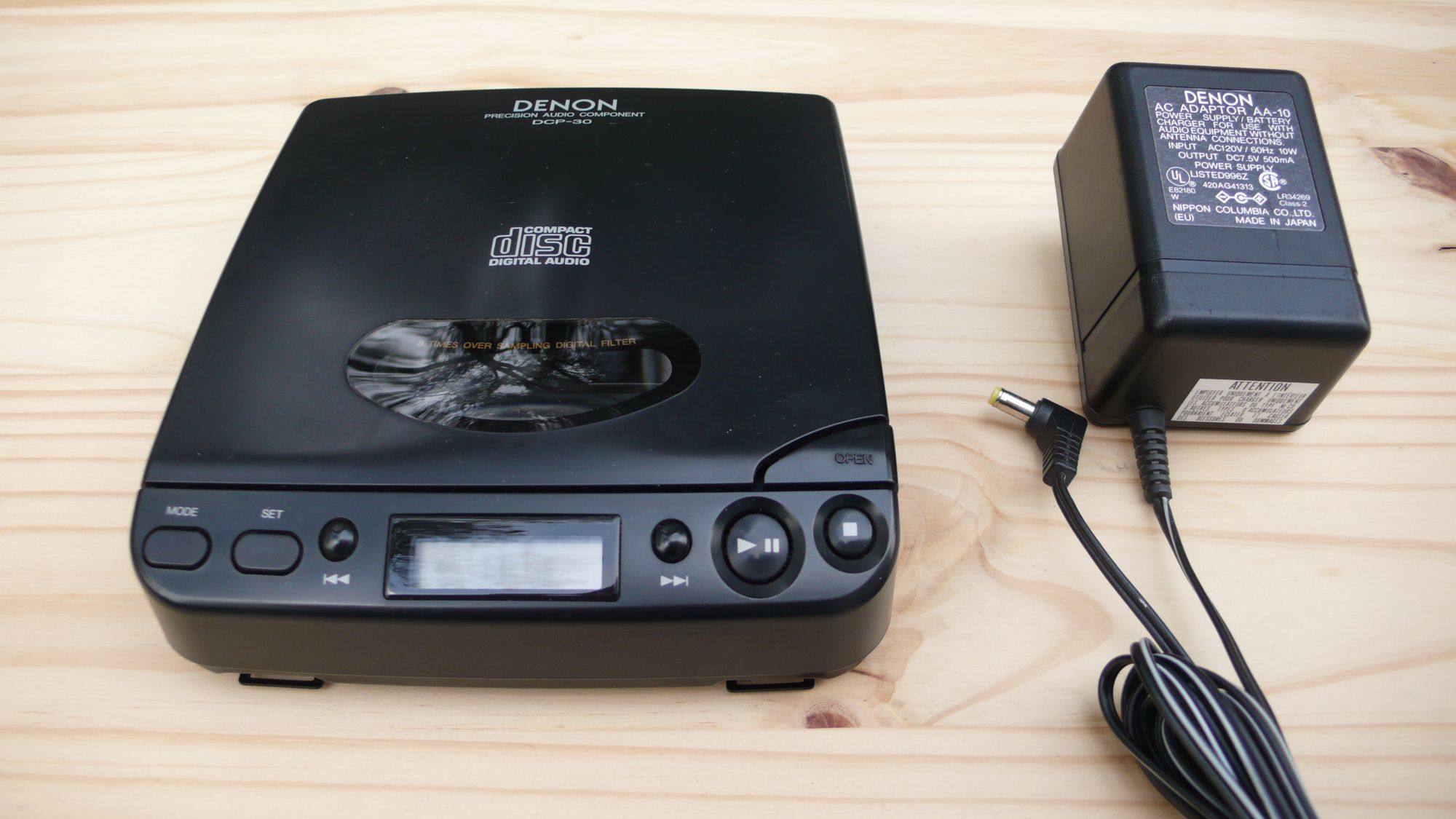

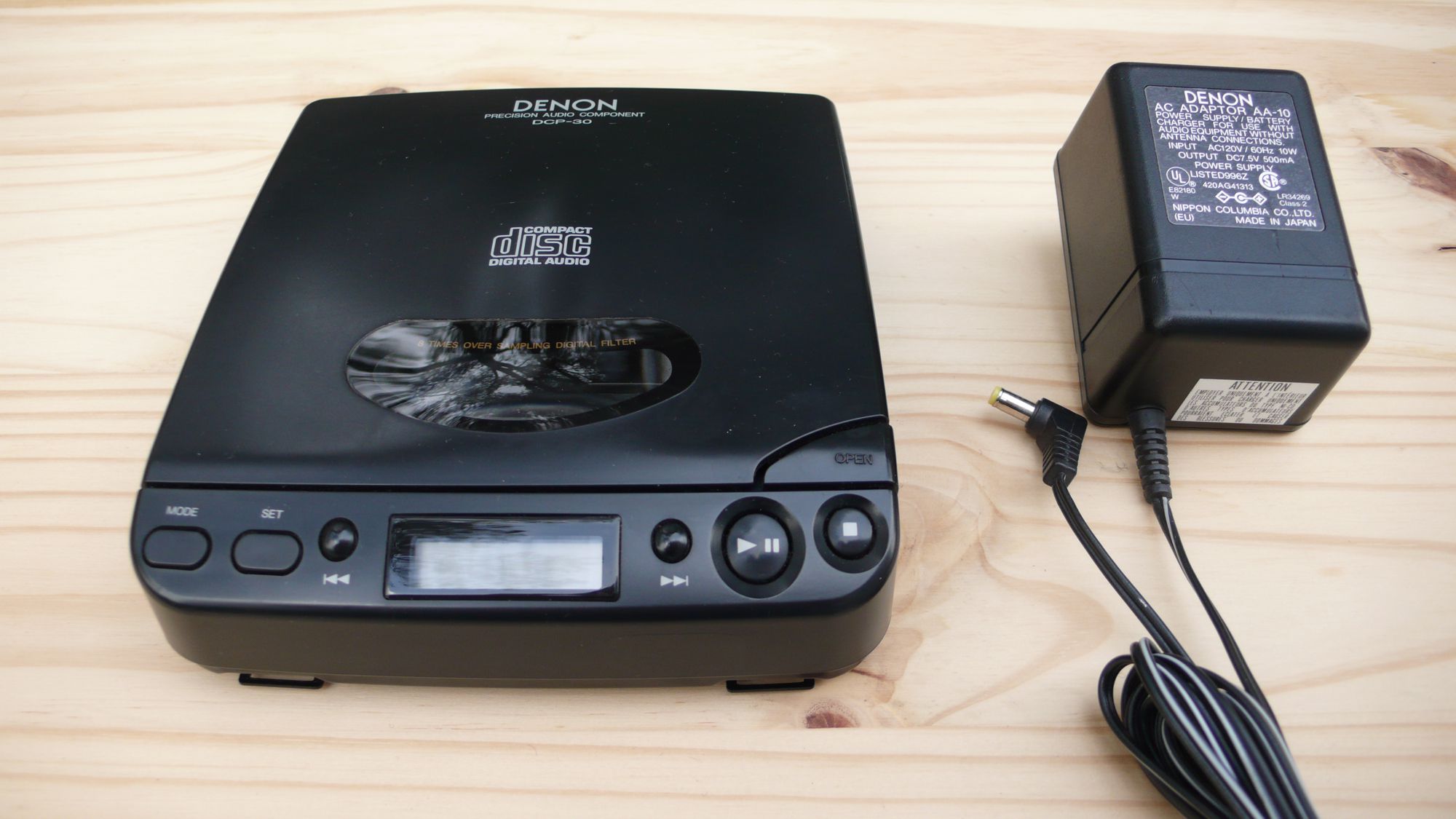

    My name is John. I have a vintage barely used Denon DCP-30 disc player.. I have not used in in 20+ years. I cleaned it and replaced the batteries. It will not power on with either the batteries or power cord.

  2. Jorge
    1,772

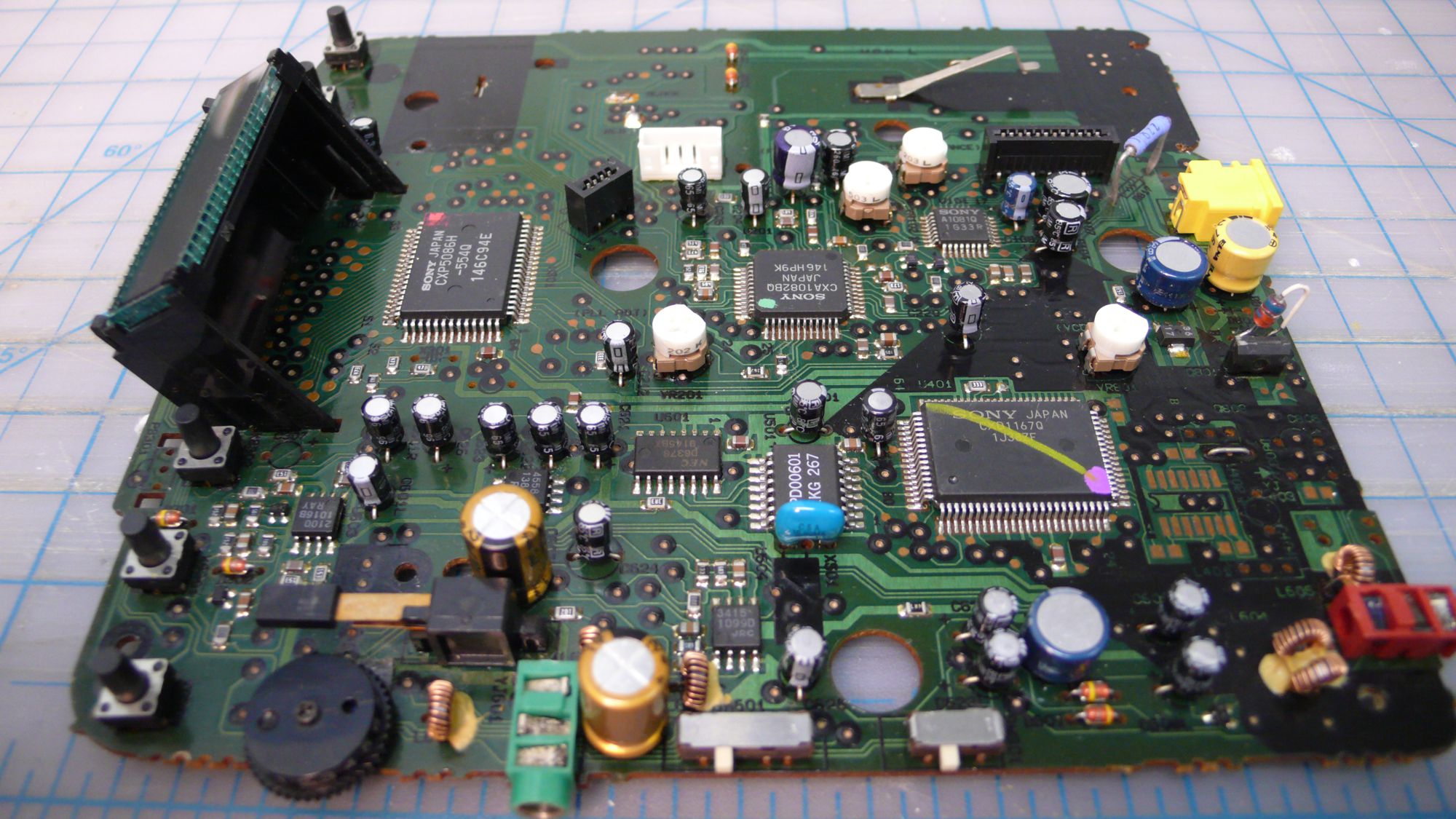

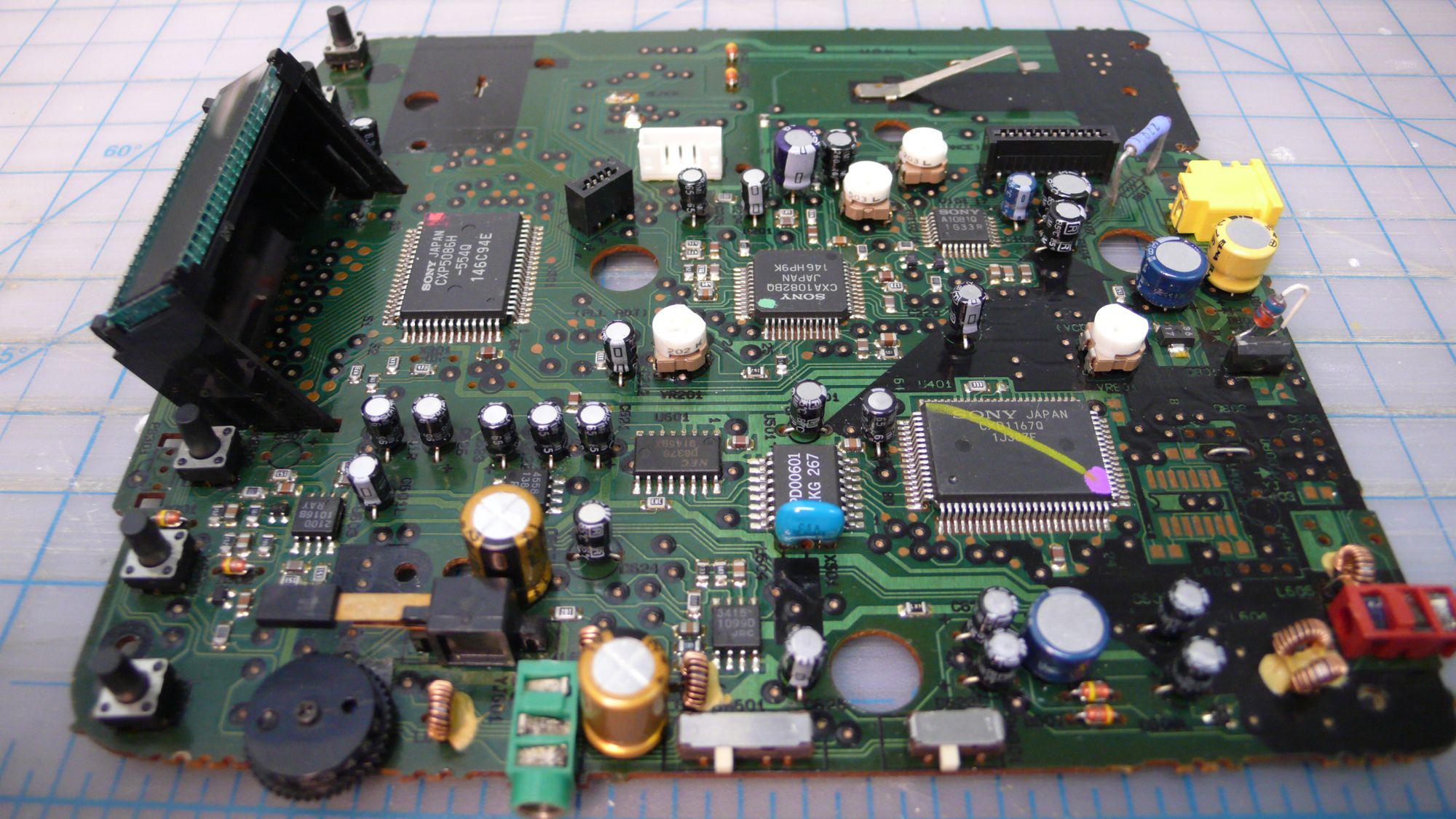

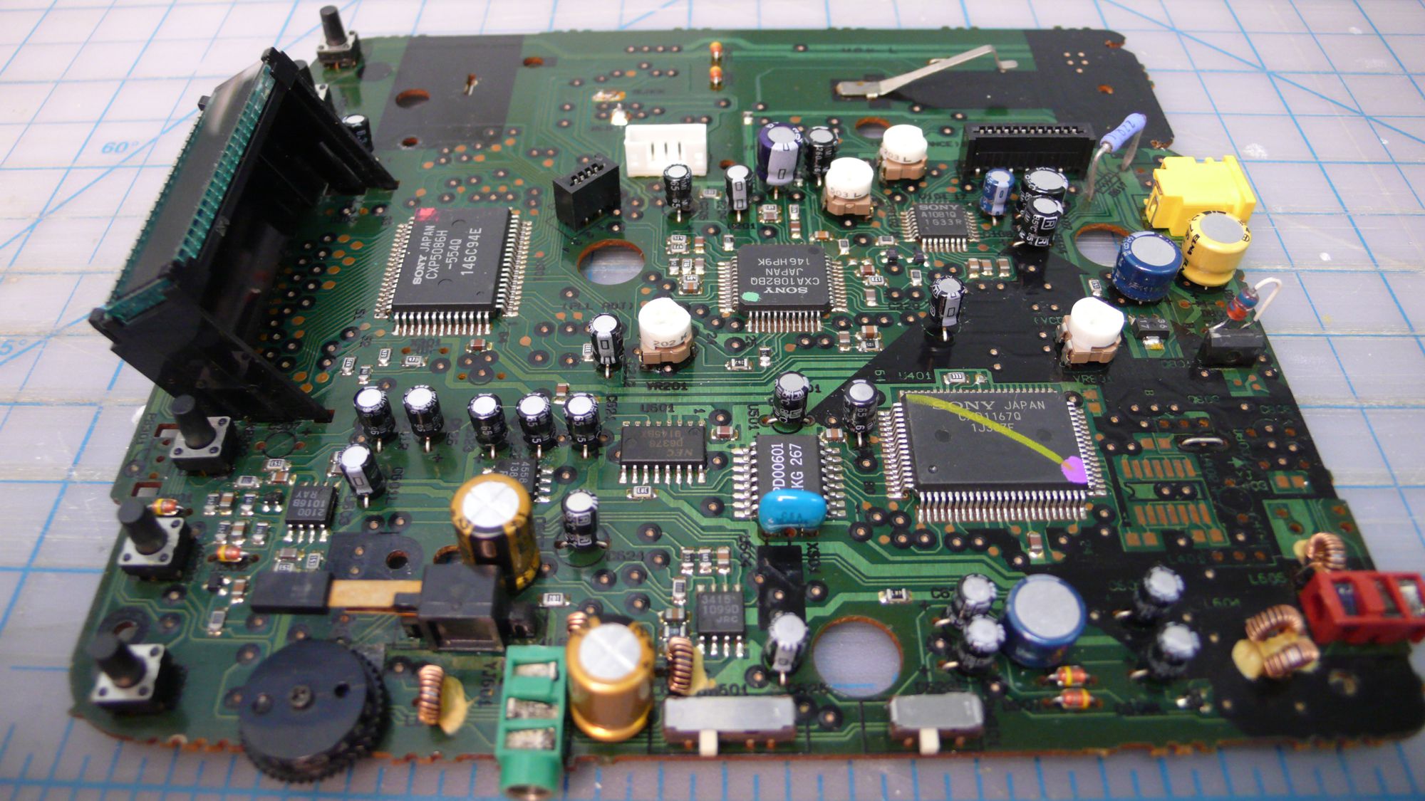

    DCP-30 does not look like much but it is one of the better Discmans out there. I managed to fix a few, here is one already fixed and recapped with FineGold "Muse-series" caps:
    DCP-30 is one of the easiest Discmans to open. From the list of my fixes:
    1) check power/DC jack, reflow it
    2) check Q801, in one of mine it was toast
    3) start with C107 but check all electrolytics around DC for leakage
    Nice thing about DCP30/50 is that Kaosun of kaosuncd.com reverse-engineered DCP-150 and can upgrade these cheaper models to the status of the Best-Discman-Ever-made

    17,151
    You can see some crust (corrosion) around the green and red jacks on Jorge's Unit. This get inside the female connection as well and there's a chance you won't power with a good cleaning.
    Not having power could be several issues but it's odd that both battery and wall-wart don't work. You'll have to do a step at a time to rule out the easy stuff first.
    Pictures of the jacks and battery terminals would help and are you using the Denon Wall Wart or something else? Denon has center pin "+" which I think is the opposite of Sony.
  4. Jorge
    1,772
    @Mister X - your Kung-Fu is better than mine :) ... I do not see it o_O maybe it is a digital "pixie-dust"? I know that volume, h/p (green) and line-out (red) had not been DeoxIt-ed yet, at that time I did it only after Discman was put back together. Then had a few Discmans with broken volume and had to change my routine
    In any case, this particular Discman can not have even virtual crust/corrosion no more - it is in Digital Heaven :cool:

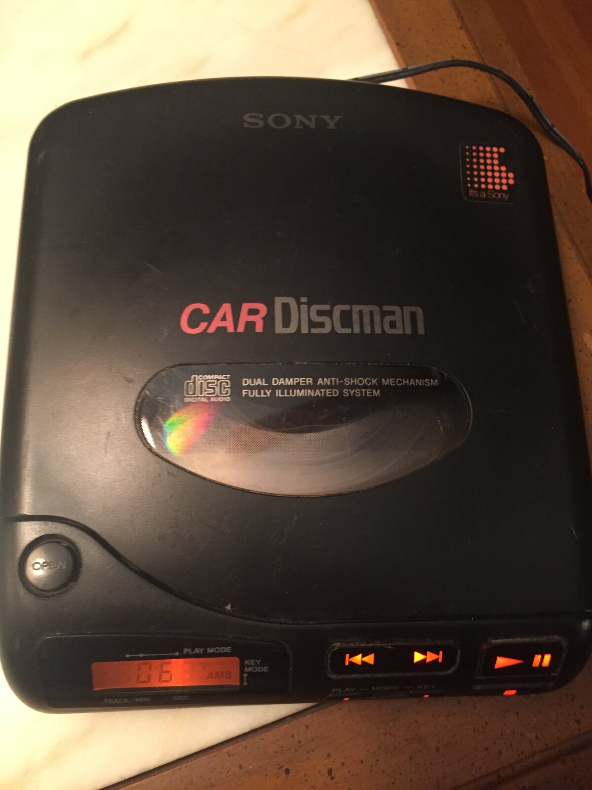

    I have a Sony car discman from same time period which works. Any thoughts on how it compares to Denon DCP-30?

    Denon DCP-30 will sound similar to your Sony Car Discman, you can see for yourself here that internally they are quite similar.
