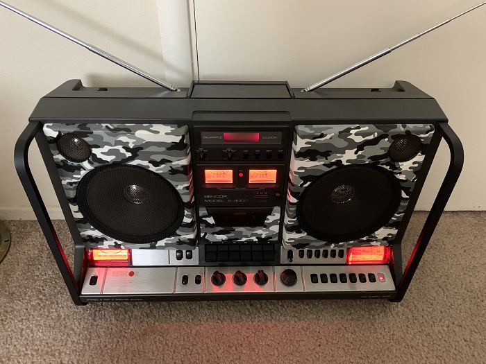

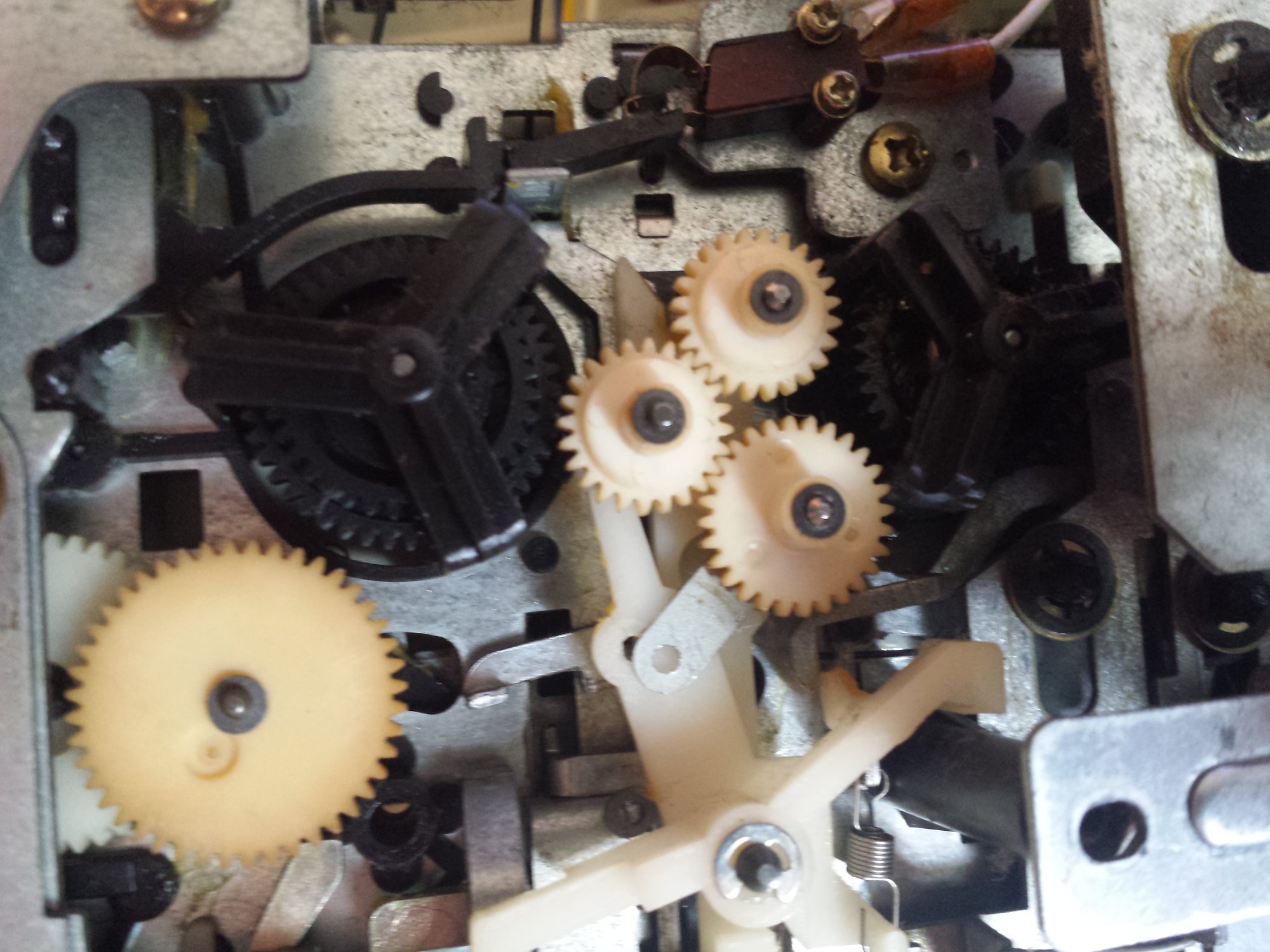

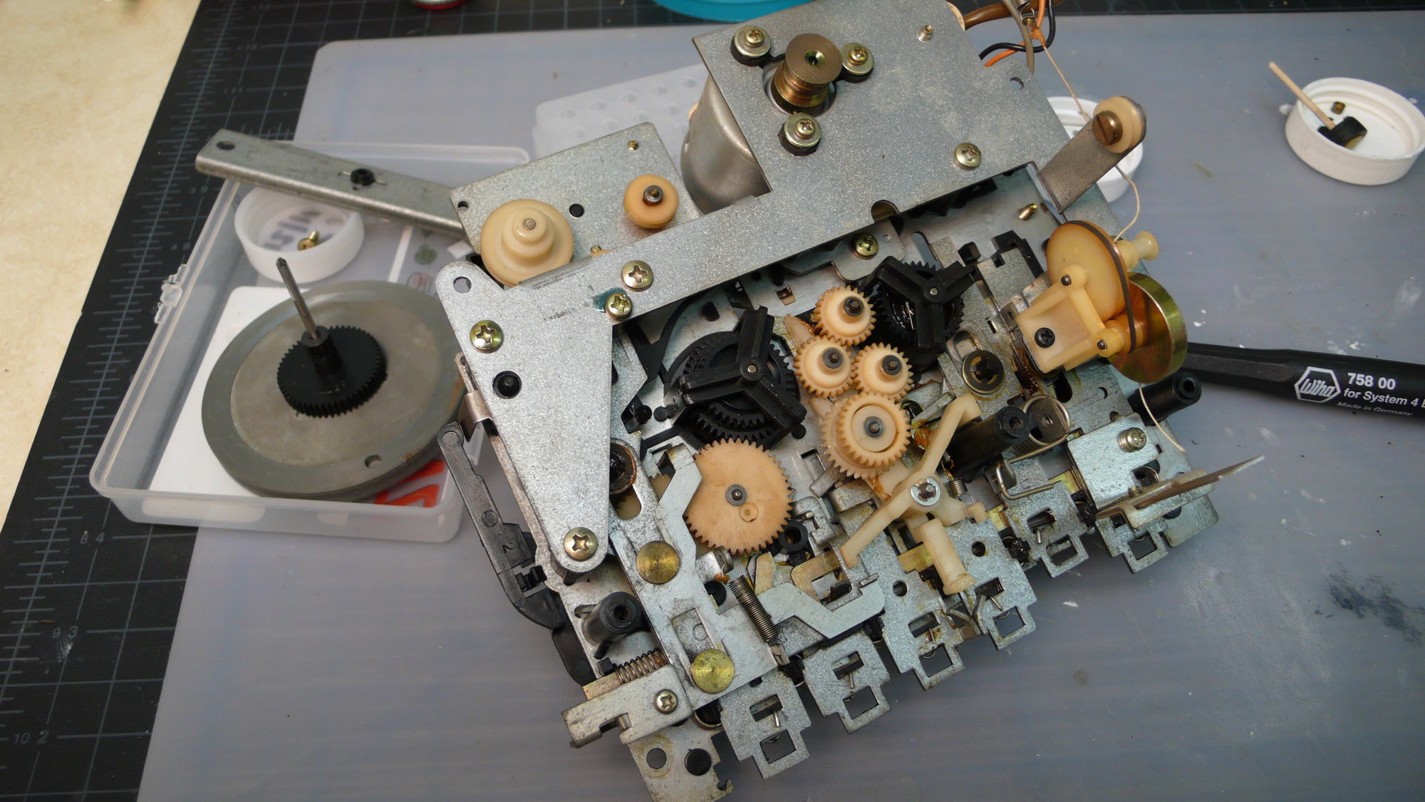

    @Easthelp it is funny that you mentioned St.Nick/ @nickeccles It was he who pushed me into the troubles of uploading my resto efforts! I also wonder sometimes who designed cassette mechanism for my "Swiss-designed" Sencor S-4800:
    probably "made in Japan", as all other Sencors, but did they go into troubles to design mechanism from scratch? I spent days repairing/reinforcing all those gears, and then snatched this mechanism, in like-new condition off eBay for $30. Talk about wasted time!!!

    Uh, no offense, Jorge, but why do I get the impression that there's something somewhat creepy about the sight of that Sencor S-4800 cassette-deck mechanism? There just seems to be something undesirable about those four beige (or "off-beige") gears or cogs or whatever they are, roughly in the centre of the side of the mechanism opposite that of the motor. Silly as this sounds, my skin started grumbling at the sight of them. Even the sight of my Aiwa's mechanism doesn't quite creep me out. (Shaking this head of mine)
  7. Jorge
    1,717
    Those are the horrors next to impossible to fix... And the flywheel to the right, with rubber band and broken string, that is the contraption for smooth door opening! Problem solved by Philips and Panasonic with a drop of viscous silicone oil. I can almost see the engraving: "Swiss-made. Patek Philippe. complication 5396R". With one catch: it is impossible to adjust. It is either too slow or too quick, and even when adjusted it drifts off in a few days of use. So, maybe it was designed from scratch by Swiss dudes.

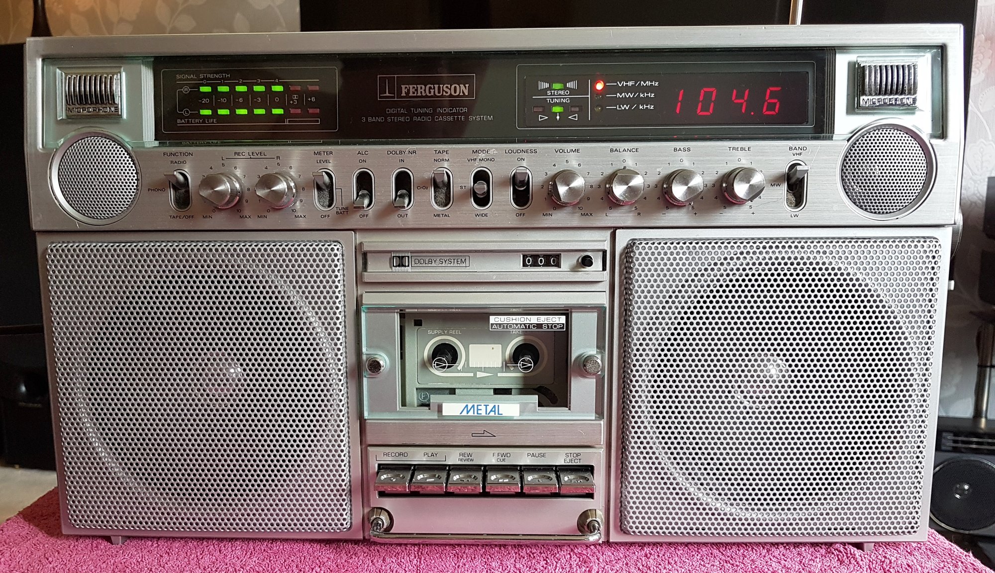

    I KNEW I had seen that cassette mechanism somewhere before........
    It's a slightly reworked version of the Ferguson 3T18 deck & imo a very good deck all gear driven just one large flat capstan belt!!
    The full auto stop mechanism can be problematic though & I ended up buying a scrapper just to get the deck out which was perfect after a rebelt & service restoring my 3T18 to perfect working order!! Took around 3 years to get all the parts I needed to build a minty one!!
    I MUST get my elephant repaired! They are so beautiful to look at too even when a little poorly like mine!! :wink:

    And the Sencor, when they say "designed in Switzerland" that's really all they mean.....Draw up a design and tell someone in Asia to build it, lol.
    Nice looking red panels on yours....I got mine camo-dipped

    Not very pleasing to read those comments from Reli about the Switzerland-based Sencor brand being a “design only” company when it came to building boomboxes and other electronics. Not pleasing to read that Sencor would leave the actual manufacturing to some Japanese plant or another. But not really unexpected. (Shrug) As I’ve told myself often enough of late, Japan was “King Of Consumer Electronics” by way of the firms in that nation designing and manufacturing many popular, frequently high-quality appliances and electronics in the last few decades of the 20th century and into the 21st century, with an expertise that non-Japanese (and more broadly non-Asian) manufacturers couldn't always match.
    Interesting re-finishing of the façade of that Sencor boombox. (Is it an S-4800?) It seems to be in good condition. Is the backlighting for the various dials original?
