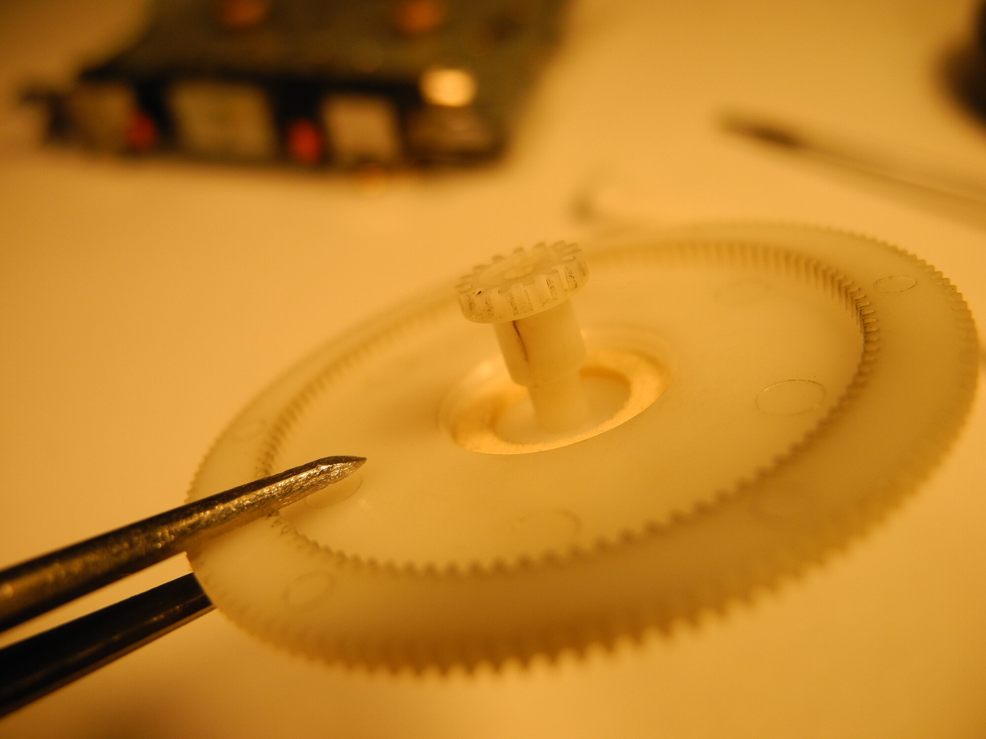

    The Mechanism didn`t swap the Pinch roller and eats the Tape (Bandsalat).
    This is what i found.

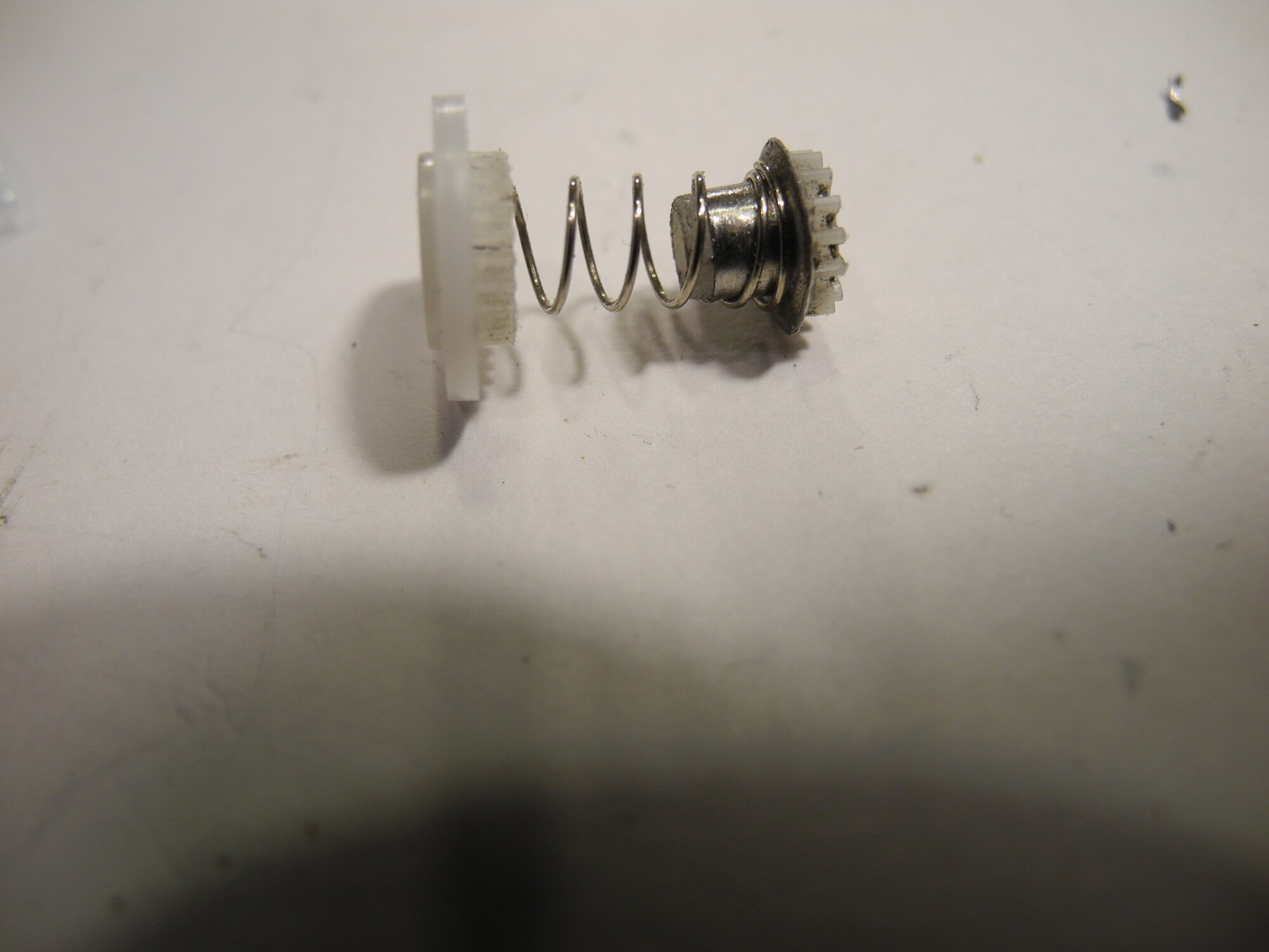

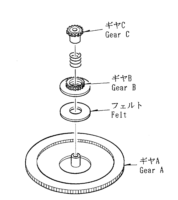

    A broken Gear C .
    For a better View without the Spring and Gear B.

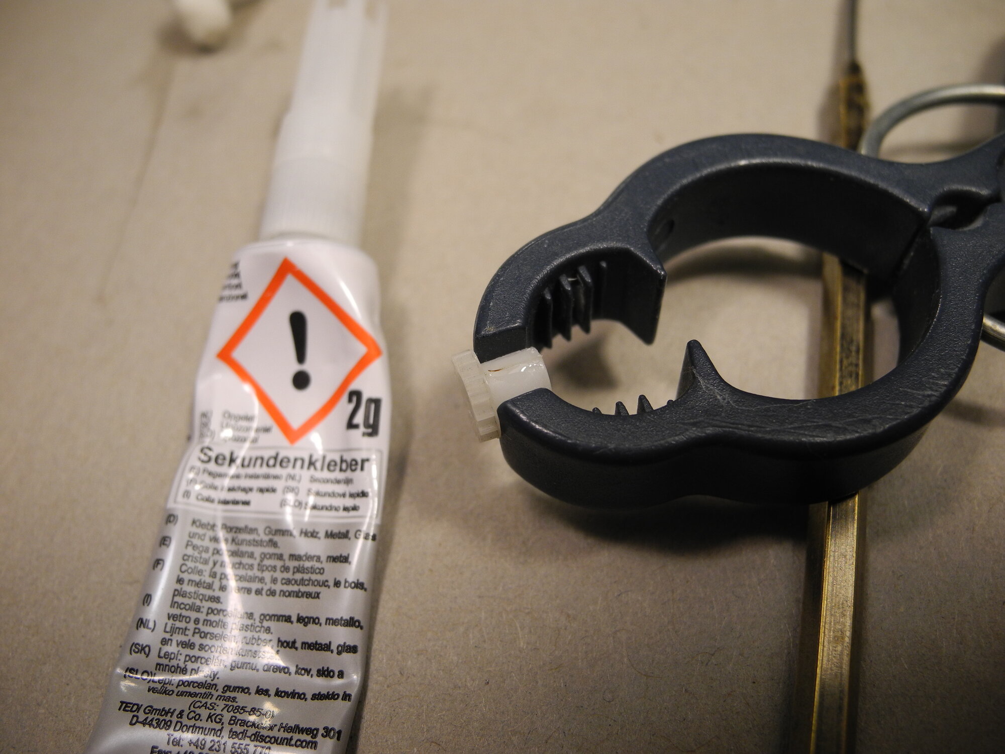

    1. Attempt with superglue. Failed .

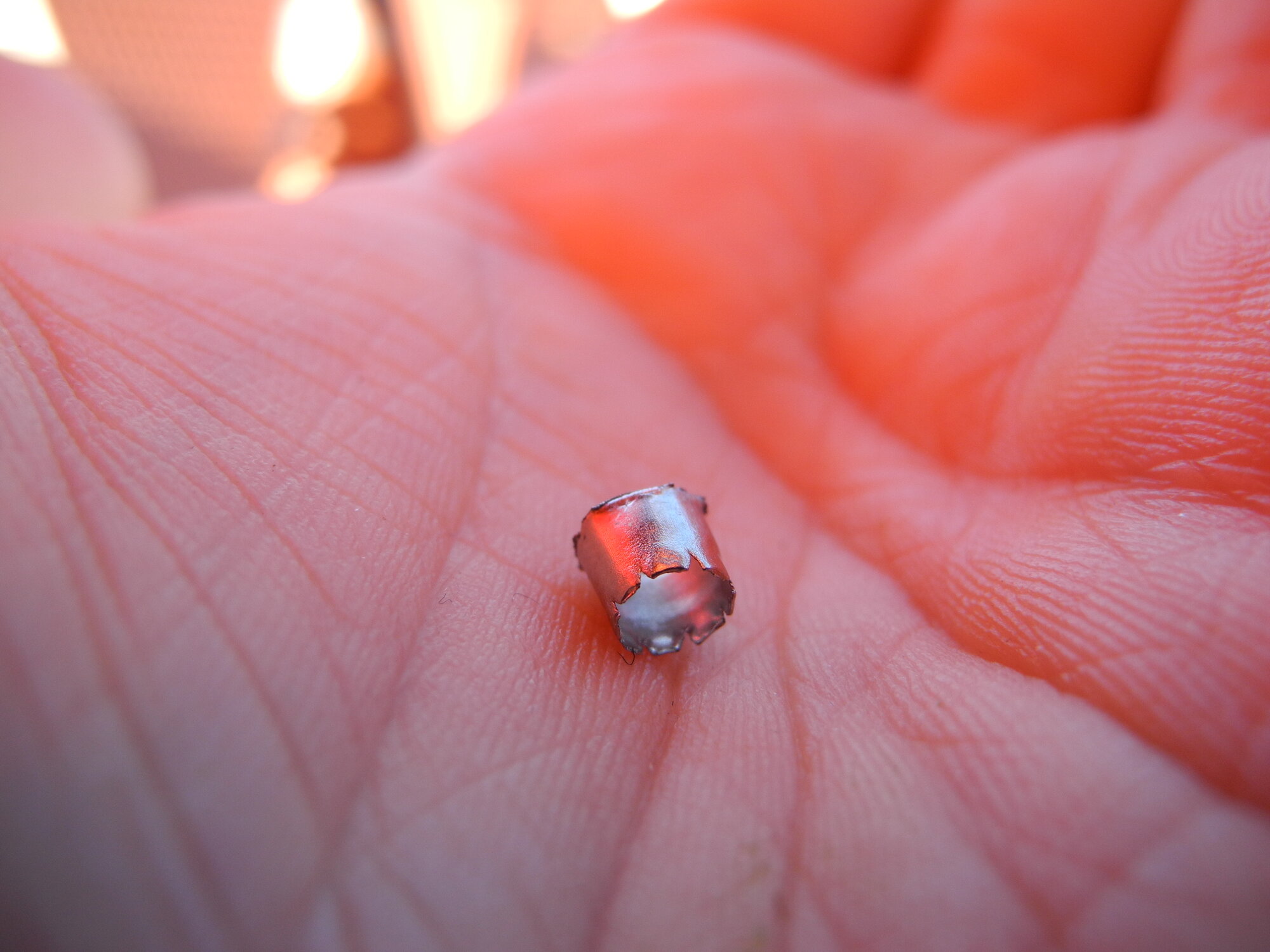

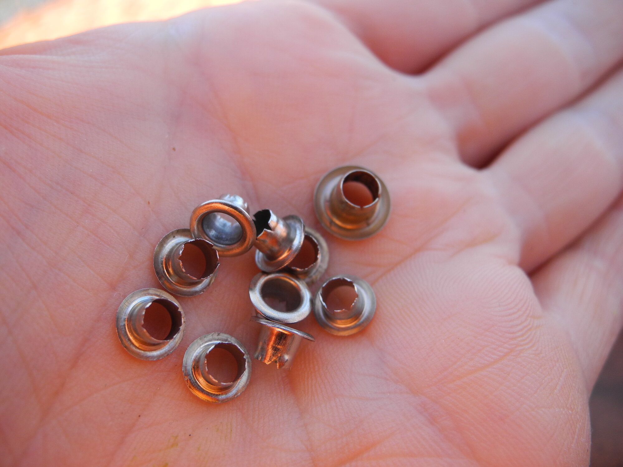

    2. Attempt with a Hull.
    I found a hollow rivet which was just a bit to small.
    I deep froze the Gear C and boiled the rivet and pressed it together.
    First it works very good . The Pinch roller swaps but the speed was not good .
    It sounds like chipmunk and there was a noise in the gear.
    The connection was not in the right angle and the collar from the rivet was rubbing.
    I carefully disassembled everything and cut the collar off.
    Pressed it together and checked that the Gear B was moving on the felt washer.
    It is a really good connection and the speed is stable on both sides.
