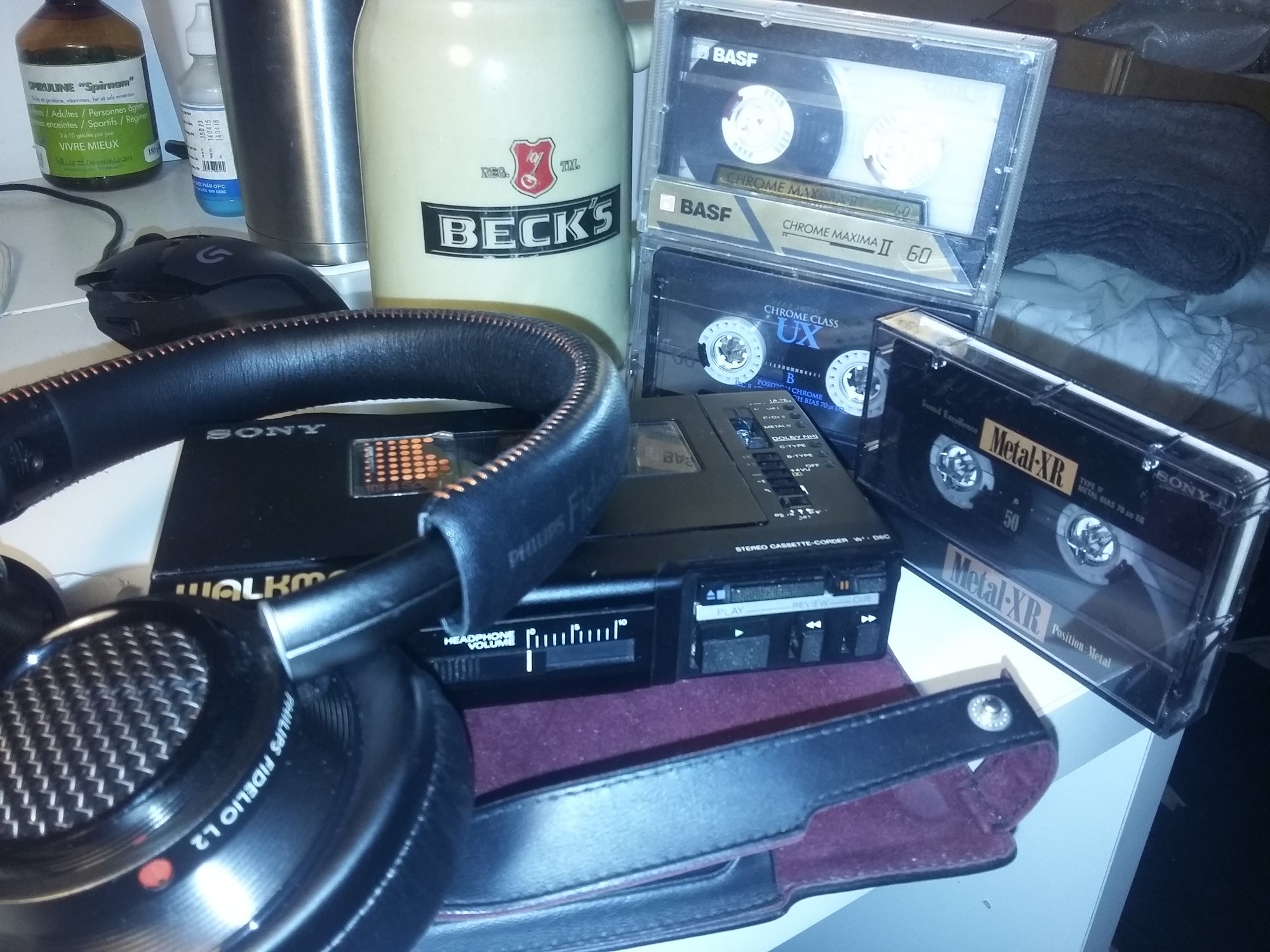

    Before I try shipping my Aiwa hs-PC202mii and WM-D6C I want to make 2-3 mix tapes and record an album on my tapes: a sony Chrome class UX 60, a BASF Chrome Maxima II 60, a TDK Type II Sa-X, and a type IV Sony Metal XR.
    The Input will be from my computer playing lossless files. I'm currently working on a list for the songs, I'm trying to follow Hugo's article for excellent recordings, but I am confused with a lot of the steps and am not sure how to calibrate for recording on the D6C.

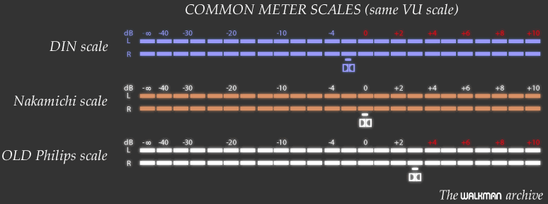

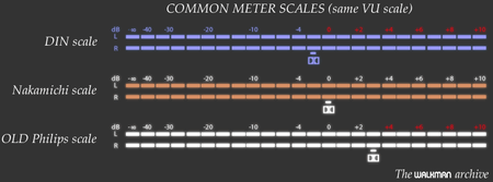

    When I mean numeric values like +3, I mean +3 over the real zero mark. The problem is that the vast majority of decks, except Nakamichis don't have a zero which is real zero (which is the Dolby mark, not the zero in the deck's own scale). There were different standards for the zero mark of the scale that caused lots of misunderstanding.
    Here are the three different scales. The D6C seems to have the DIN, with Dolby mark over -1dB, so in practice there's not big difference, even less considering how low is the resolution of its meters.

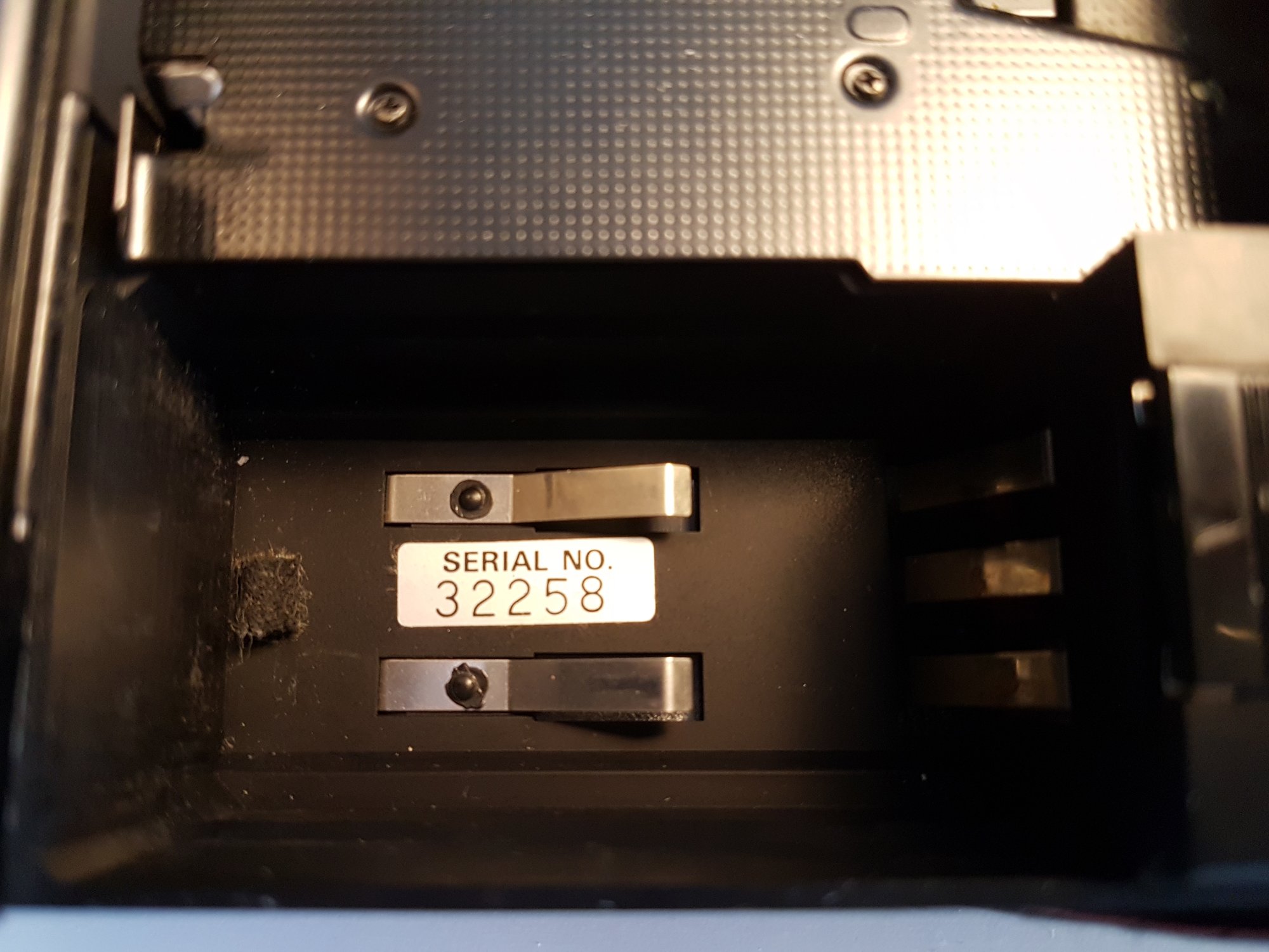

    I have no idea how to mess with the guts of the machine. I'm assuming i can get the year based of the serial number?

    Your 32258 is an early Rev1. Congratulations! You've got the better head. However, biasing on my example was way off and sounded bright as hell. But it's a relatively easy adjustment.
