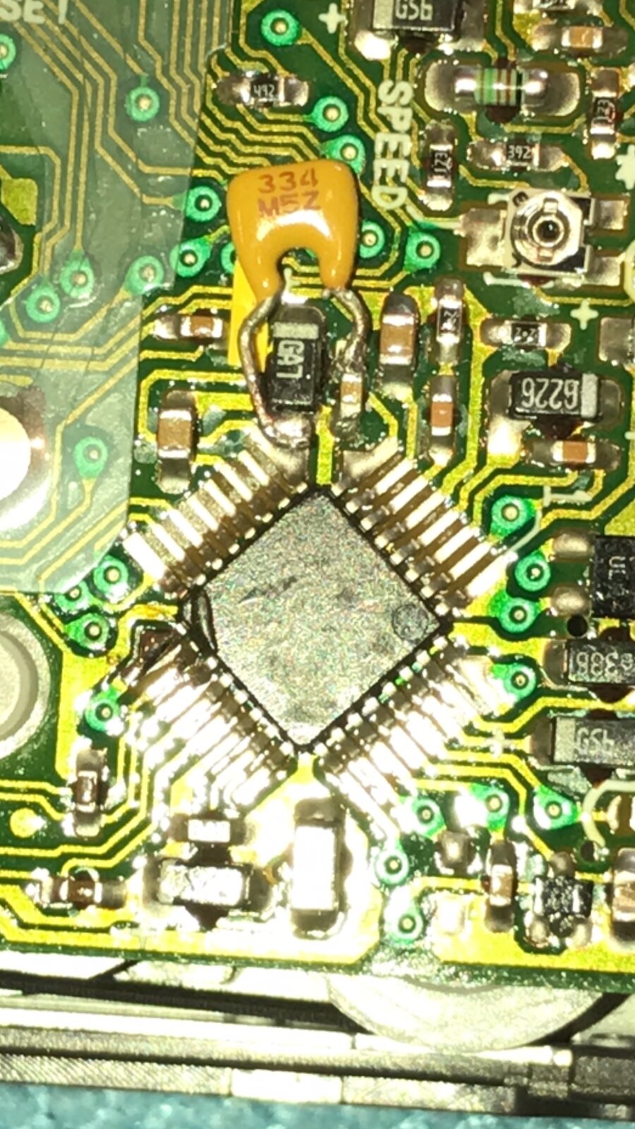

    I bought 2 panasonic walkmans recently. I changed the belts, and started playing old cassettes. I didn’t remember how annoying was this s-xbs Bass boost. The amount of bass is ridiculous. I remembered why I always prefered not to use it in the past. But unlike 20 years ago, now the service manuals are online for most of the models. I only know basic things about electronics, but i think i found a cap (surface mount, of course) that is responsible for that excess of bass. I soldered an ordinary cap in parallel (after testing a few different values) to the surface mount one, and for my ears, there is a big improvement in the sound. Now, when i turn the s-xbs on, there is more bass, but not too much, not annoying, not saturated, more defined low end. It really sounds much better. Now i always leave the s-xbs function active.
    As i said, my knowdelge in the fields of electronics is very limited, and i don’t understand why there is less bass.
    Here are the technical aspects:

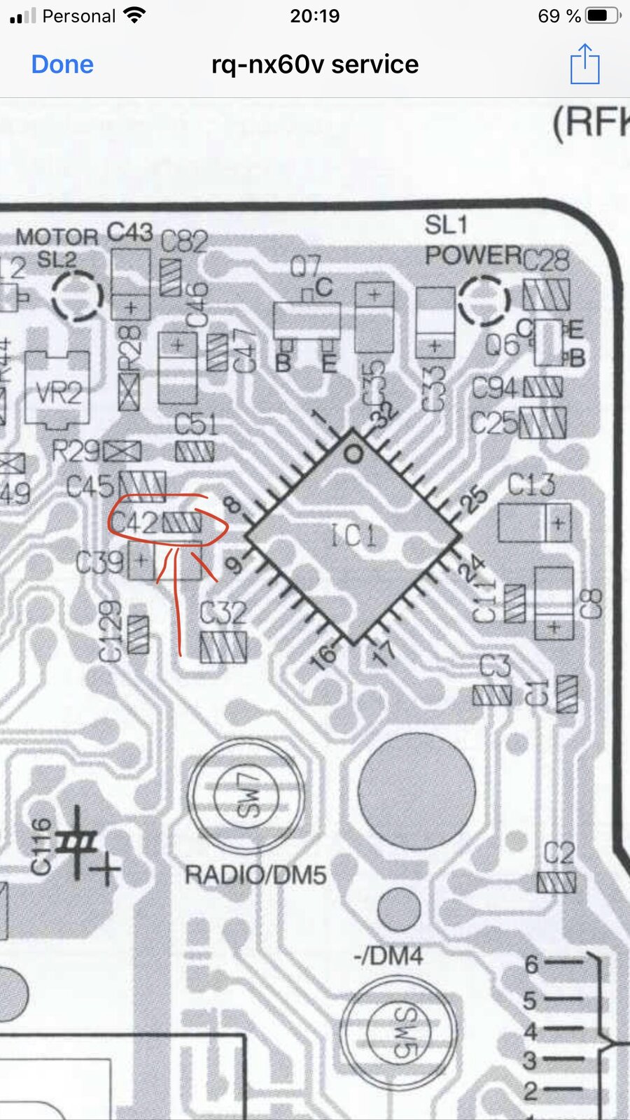

    I modified 2 walkmans. RQ-e30v and RQ-NX60v. Both share the same IC to control the xbs system. I searched in the manuals and found a pin of this IC1 that was labeled LPF (low pass filter i asumed!). Related to this pin, there was a cap (0.1uf or 0.22uf depending on the walkman model). As i said before, i tested different values in parallel with this cap, and noted the higher the value of the cap, the less bass i was getting in the earphones. That has no sense for me, because in a LPF the freq. is higher if the cap value is lower. Is it ok? Is my thought right? And if it is, why is there less bass in this circuit when the cap value is higher? Will my mod eventually blow the ic? For know, it has worked flawlessly. Can someone help me with this? I didn’t find any info in the web, so if someone can help i’d be very glad to learn what happened.

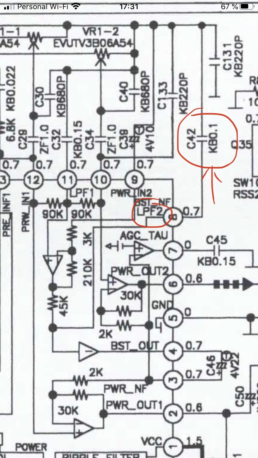

    I understand your theory, but i think that it cannot explain why adding a cap in parallel would attenuate the low fequencies, because when you use caps in parallel, the values in uf add to each other, for example:
    Cap 1: 0.1uf
    Cap 2: 0,33uf
    Total c1+c2= 0.43uf
    And as you said, the higher the value in uf, the more bass you may obtain, and that is exactly the opposite that happened in my circuit (i raised the value in uf and then the bass lowered).
    My theory is that may be, the cap that i’m adding, is not exactly related with the LPF frequency. Maybe it is related with the amount of bass in the final signal?

    About the bad cap theory, if the stock cap (0.1uf acording to the service manual) was faulty in both of my units (strange but possible) , the new cap (0.33uf, you can see it in the pictures) may cut much more treble or high frequencies than the stock one.
    I think our mistake here is that we are assuming the stock cap is related to the LPF. It may be part of another circuit or it may have another function not directly related with frequencies....

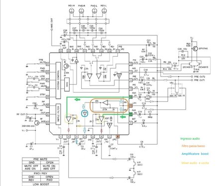

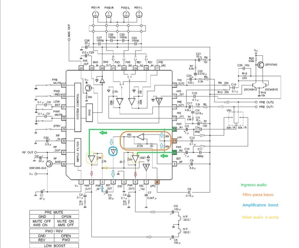

    ... I found this to see what pin 8 does
    Honomo and Machaneus like this.

    My crude calculations are for reference only and took account only the 45kohm resistor in the IC and the fact that the sound is affected when a cap is added to the circuit.
    Certainly it is more complicated , noticed that the LPF in discussion on IC pin 8 is actually LPF2 while on pin 11 there is LPF1 and they are related.

    yes!!! You re right!! I’ve noticed there are 2 LPF pins (before performing the mod), but I First started playing with pin 8, and when it worked, i decided not to mess with the other one.... maybe LPF1 is related with the circuit while XBS is off? But i can’t be sure. I just decided not to take the chance to get the IC burned...;) I observed the performed mod in pin8 didn’t affect any frequencies when the bass boost is OFF. The mod ONLY affects the sound while XBS is ON.

    Correct me if I'm wrong….So let's see if it is correct ... pins 10 and 12 audio input ... which in part goes towards the output amplifier and a part enters the low-cut filter ... the output of this filter is amplified and output from the pin 4 Bst Out and return from pin 3 to the output amplifier which is mixed with the input audio.

    Yep it looks correct , (now someone to correct us both !:D) , thanks for the ride !
    The amplifier/resistors setup of LPF1 , following pin 11, seems to be an active LPF (meaning amplification is used to maintain passive LPFs output , gain , etc disadvantages ).

    I didn't comment before as I couldn't see where the other end of the capacitor was going, but in this schematic I can see that the other end of the capacitor (on this schematic C8) attached to pin 8 feeds through to the negative input of a a couple of amplifiers. Negative feedback will attenuate the signal. The other key pin is BST_NF which I would guess is short for Boost Negative Feedback.
    For more understanding of how amplifiers are controlled using negative feedback have a look at

    Hello Longman, than you for your contribution! As I’ve told you earlier, It is hard for me to understand circuits , but i try, i read and i learn every day. So i need to clarify this:
    Is it right to say that raising up C8 value would increase negative feedback over the amplifiers related to the LPF circuit, and that would explain why i hear less bass? If i am right: Which cap is responsible for the cut frequency of the LPF? C8? C12? Both?

    Without a better datasheet or application note for the IC it is difficult to say, although I think you are right that increasing C8 increases negative feedback which means less bass. The actual cutoff frequency will probably be dependant on a different combination of capacitors and resistors. If you look at the circuits around 11, 12, 13, and 14 they look similar to the networks you get in the tone control examples in the first link.
    Sorry i can't explain better but it is nearly forty years since I was learning this sort of thing at college.
    After that I chose Digital Electronics as a career.
    A little tip I do remember is that in normal operation the + and = inputs of an op amp have to have the same voltage. Otherwise the output will saturate. That is useful for DC condition calculations (which I actually used when fixing a complex record deck) but less so with AC.

    Very probalile both c8 and c12 .... but at this point I would also check the proper functioning of c3 which is located at the output on pin 4 ...
