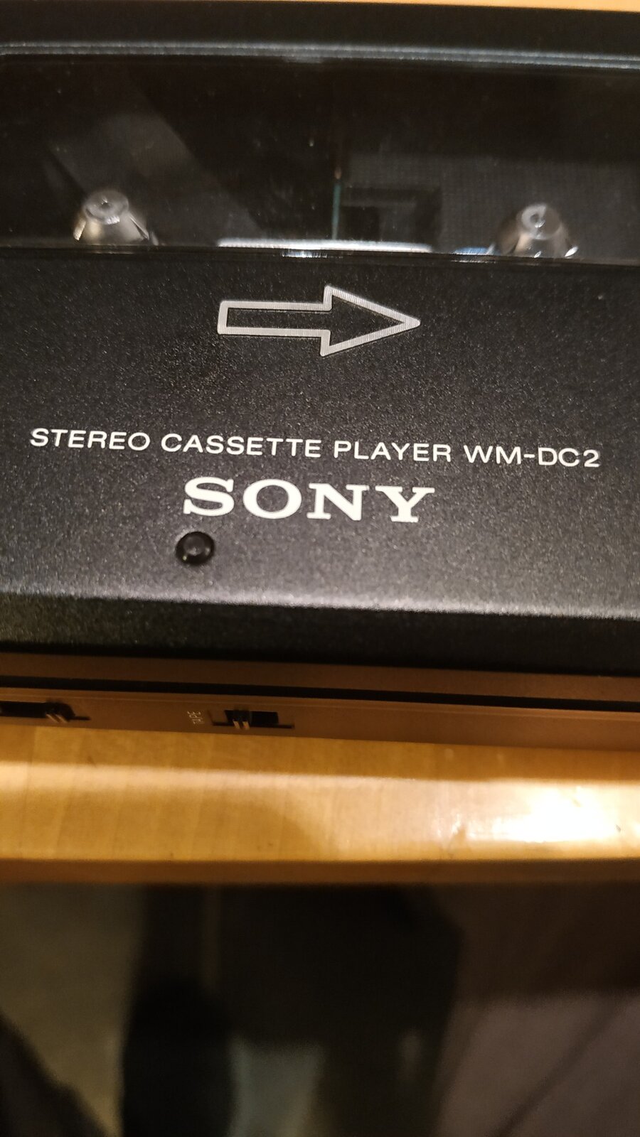

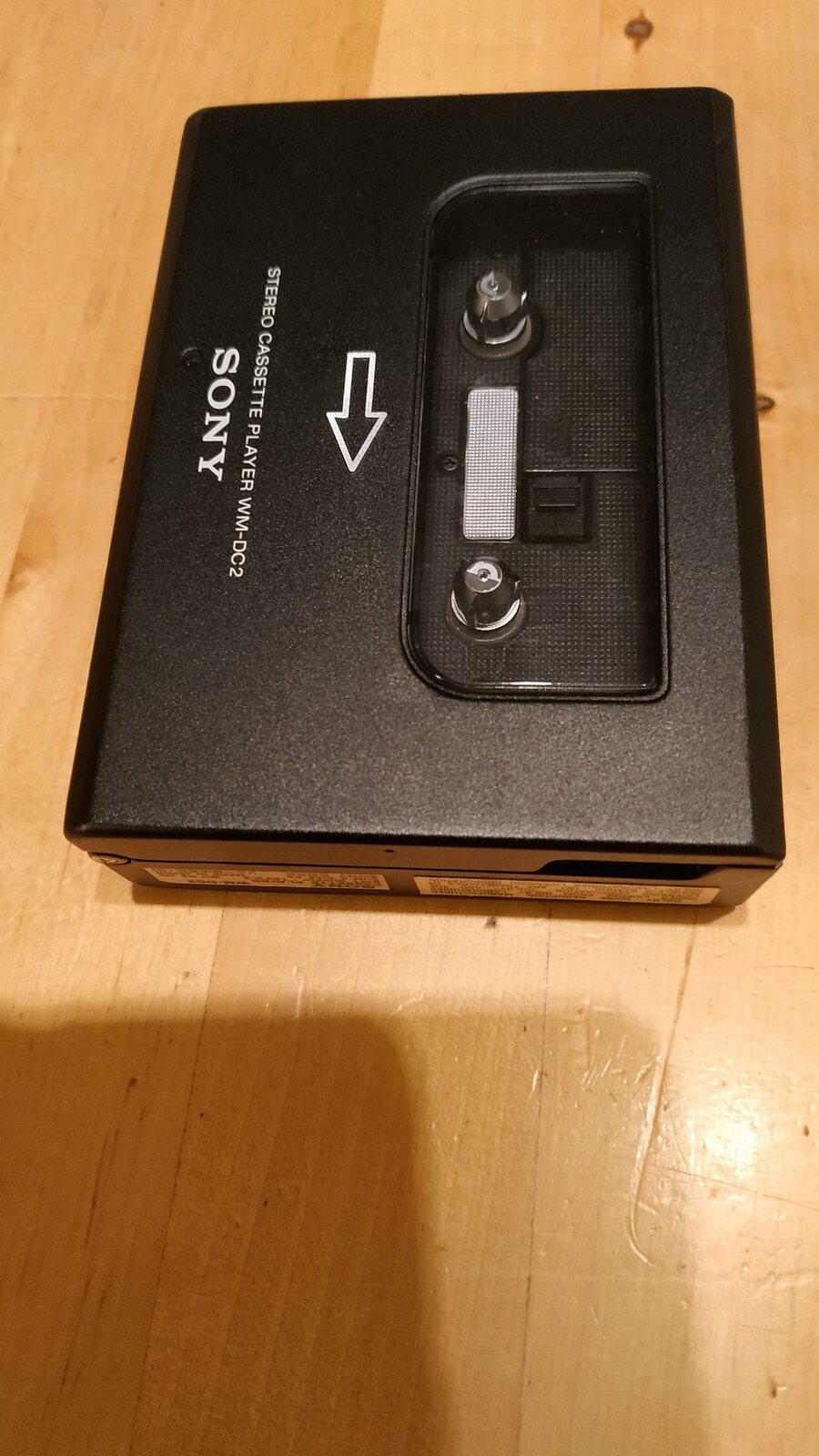

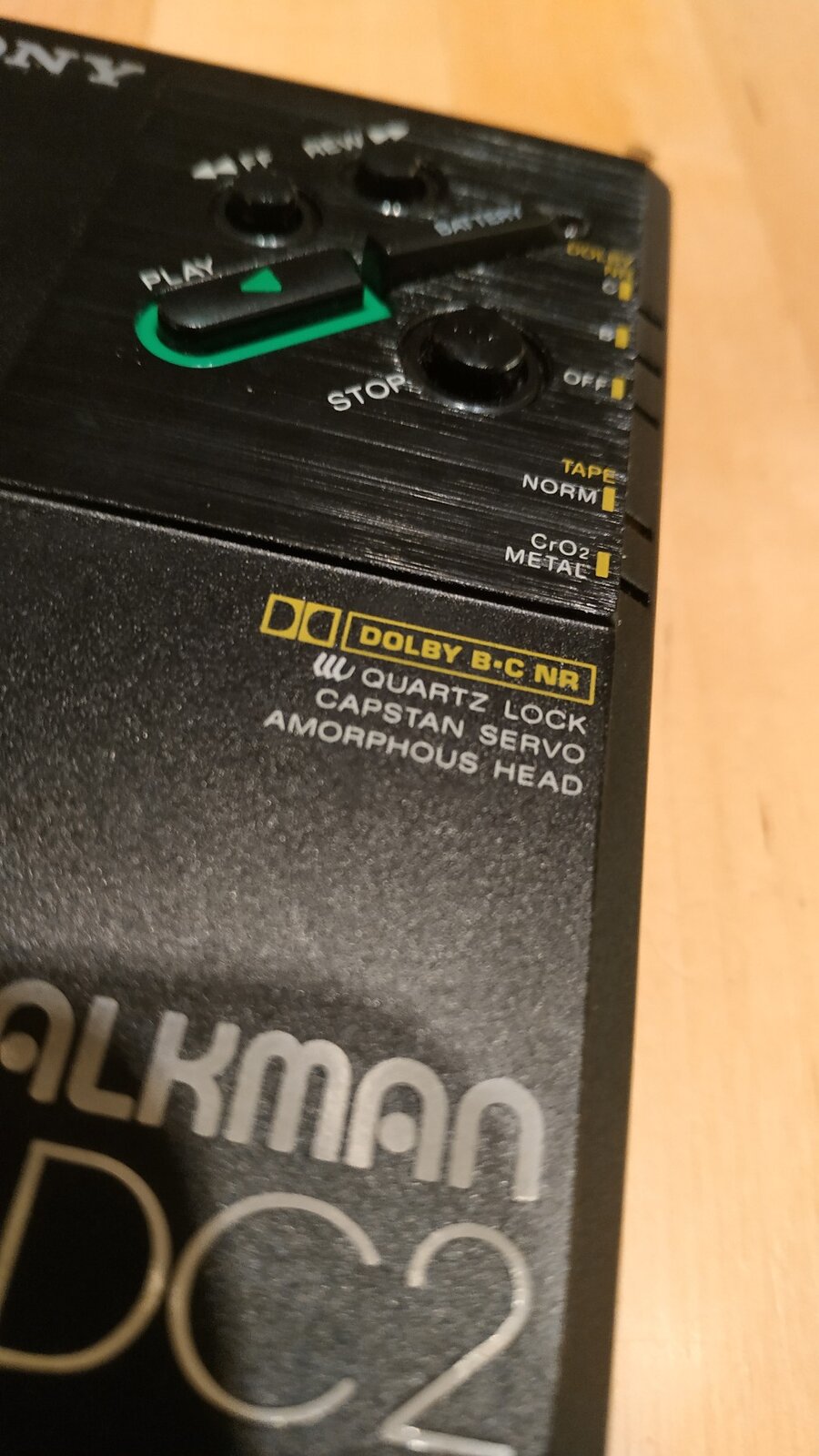

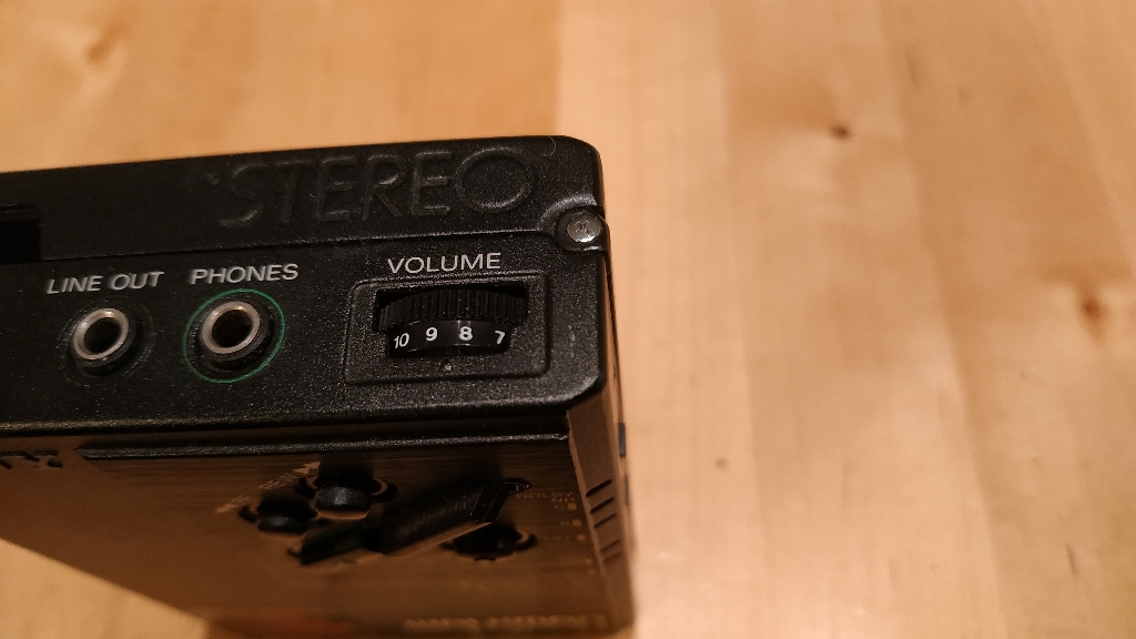

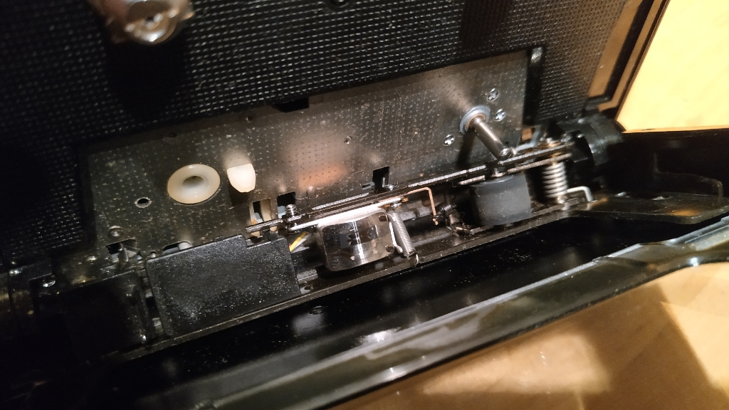

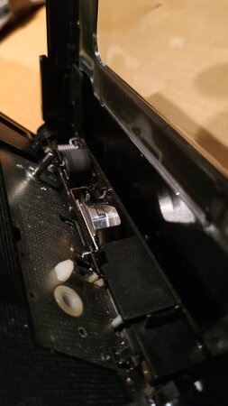

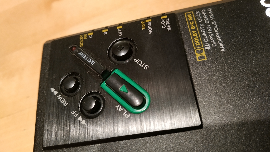

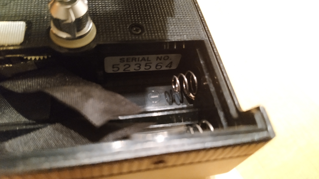

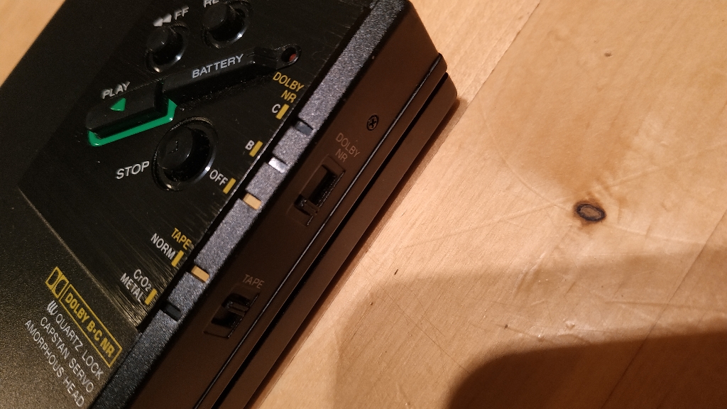

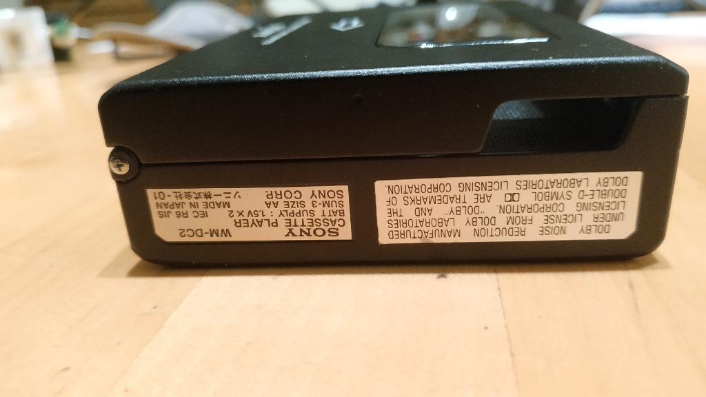

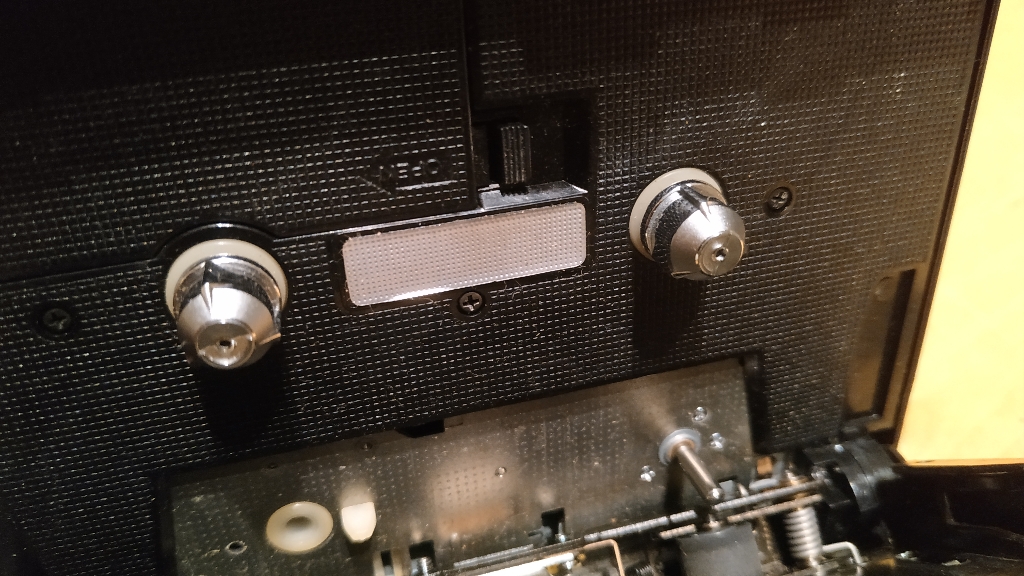

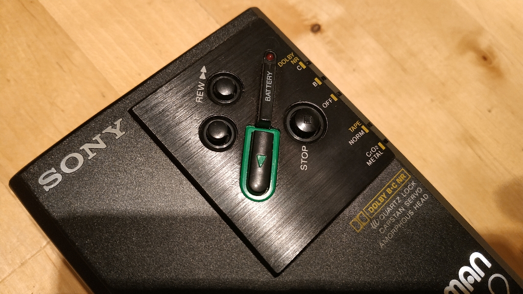

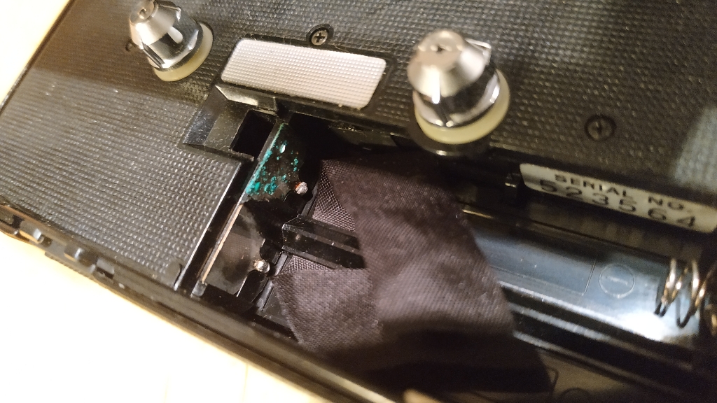

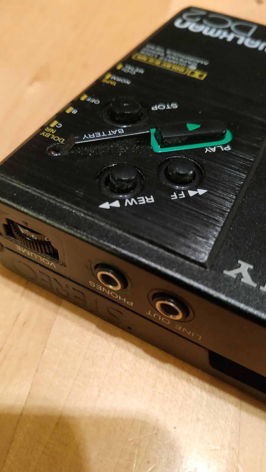

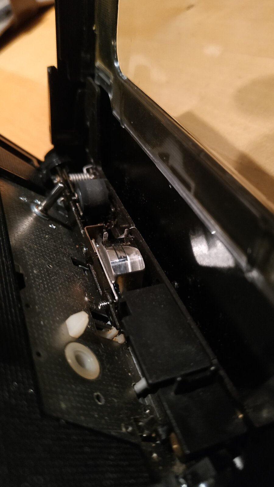

    IMG_20231027_184803_copy_1024x1820.jpg IMG_20231027_184826_copy_1024x1820.jpg IMG_20231027_184803_copy_1024x1820.jpg IMG_20231027_184826_copy_1024x1820.jpg IMG_20231027_183004_copy_1024x1071_copy_1024x1071.jpg
    Valentin and autoreverser like this.

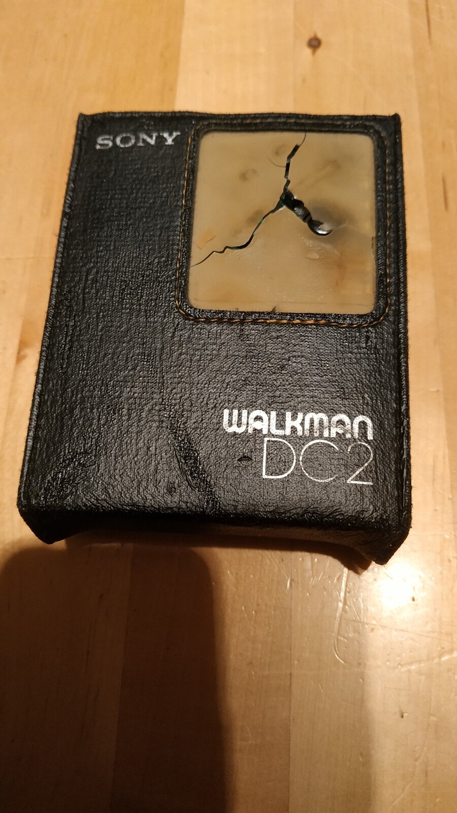

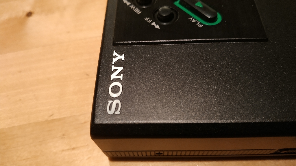

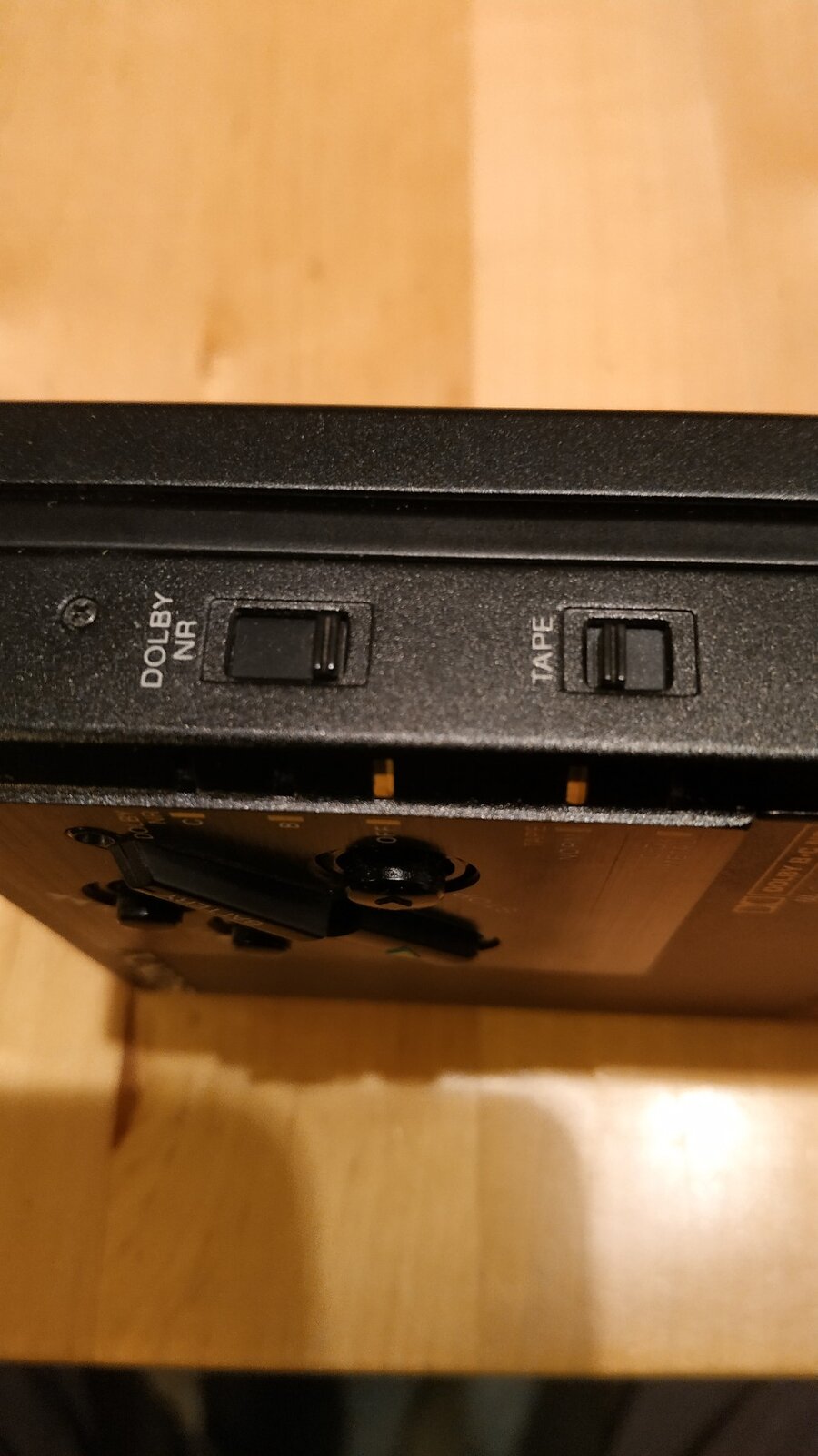

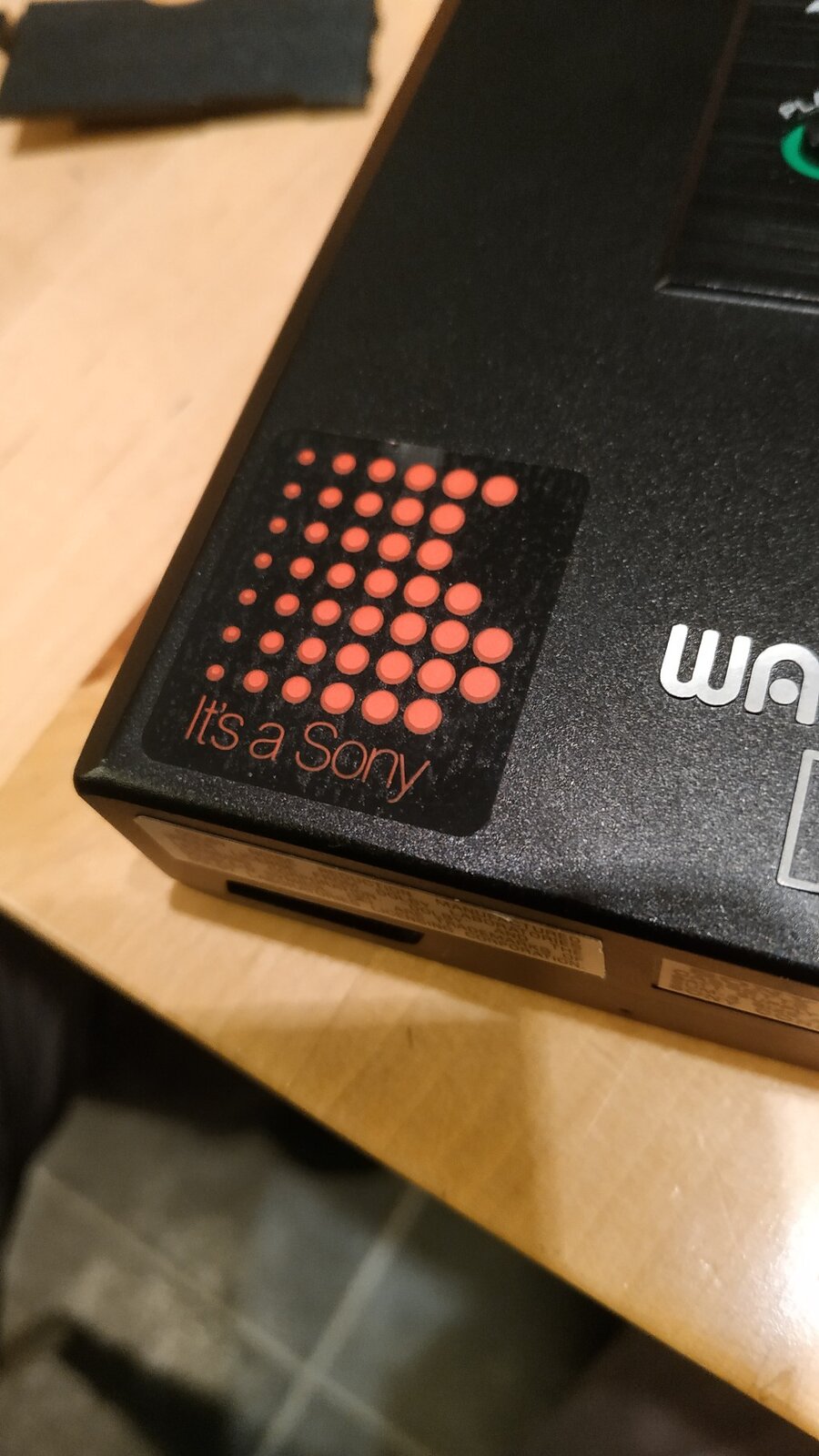

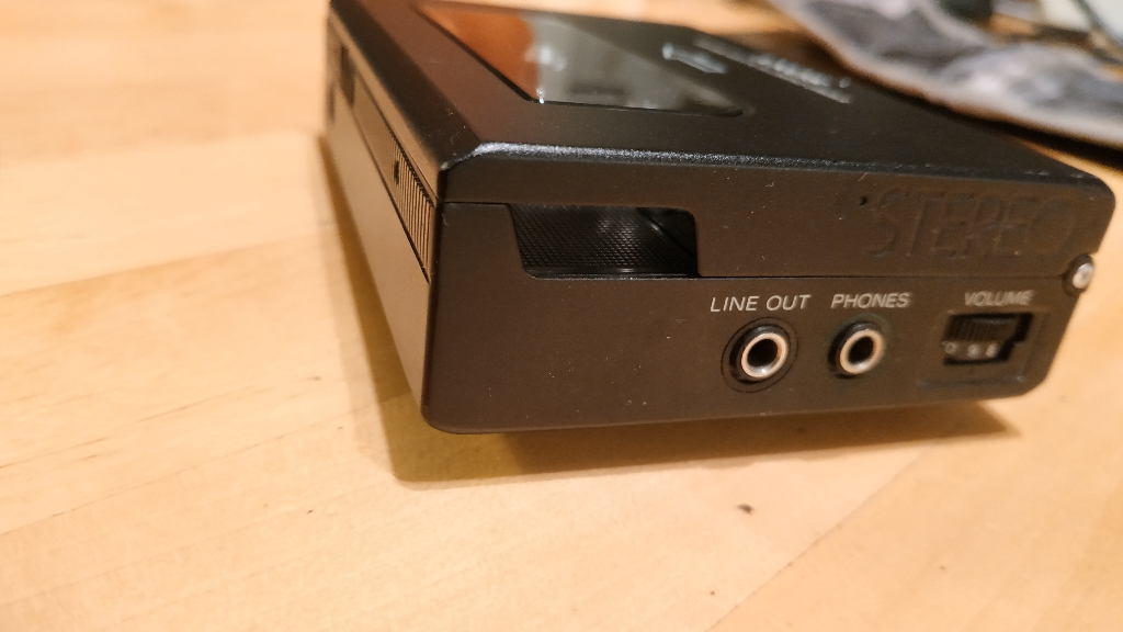

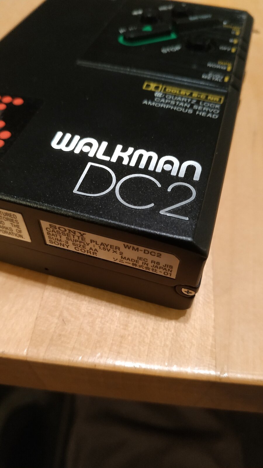

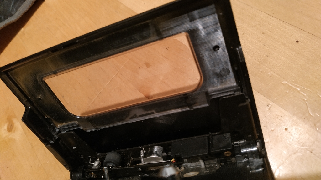

  11. Jonrrolyat
    Jonrrolyat New Member
    5
    United Kingdom
    I might have got a bit carried away with all the photos. I spotted 2 imperfections, one of which I wasn't aware of until I zoomed in.
