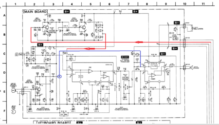

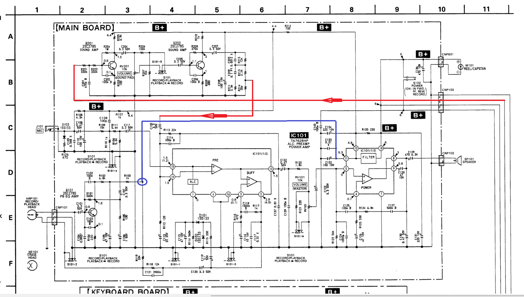

    There is a service manual available on Elektrotanya for this device: https://elektrotanya.com/sony_tcm-4040_cassette-corder.pdf/download.html
    Looking at the schematic and based on information available so far, TA7628 IC works fine (since drumpads are working). Signal from drumpads marked in red.
    Potential culprits are:
    - head preamp (Q101 and adjacent components): not getting power or other failure;
    - S101-2 not making a good connection on playback;
    Caps don't fail suddenly unless they fail short-circuit. This is a possibility that some capacitor shorted and a voltage supply rail is low or missing because of that.
    First thing I would check is if the 5.3V rail is present at blue circled point. This rail is generated by ripple filter inside IC101.
    S101-2 could also not make a connection in play mode, although less likely.

    Thank you so much for your time to look into it and narrowing it down! Unfortunately I'm not very good at reading those schematics. At least I think I found the circled spot.
    I already had the area Q101 in mind but I didn't see anything wrong there.
    Would it be enough to check the areas you mentioned for continuity with a multimeter and use this method to look for any short circuited capacitors as well?
    Thanks again!
    [UPDATE] !!!
    Oh my god! I checked the paths you mentioned for continuity and I realized there was in fact something off with S102. It showed some continuity but not enough. I cleaned the area and now it plays MUSIC again.
