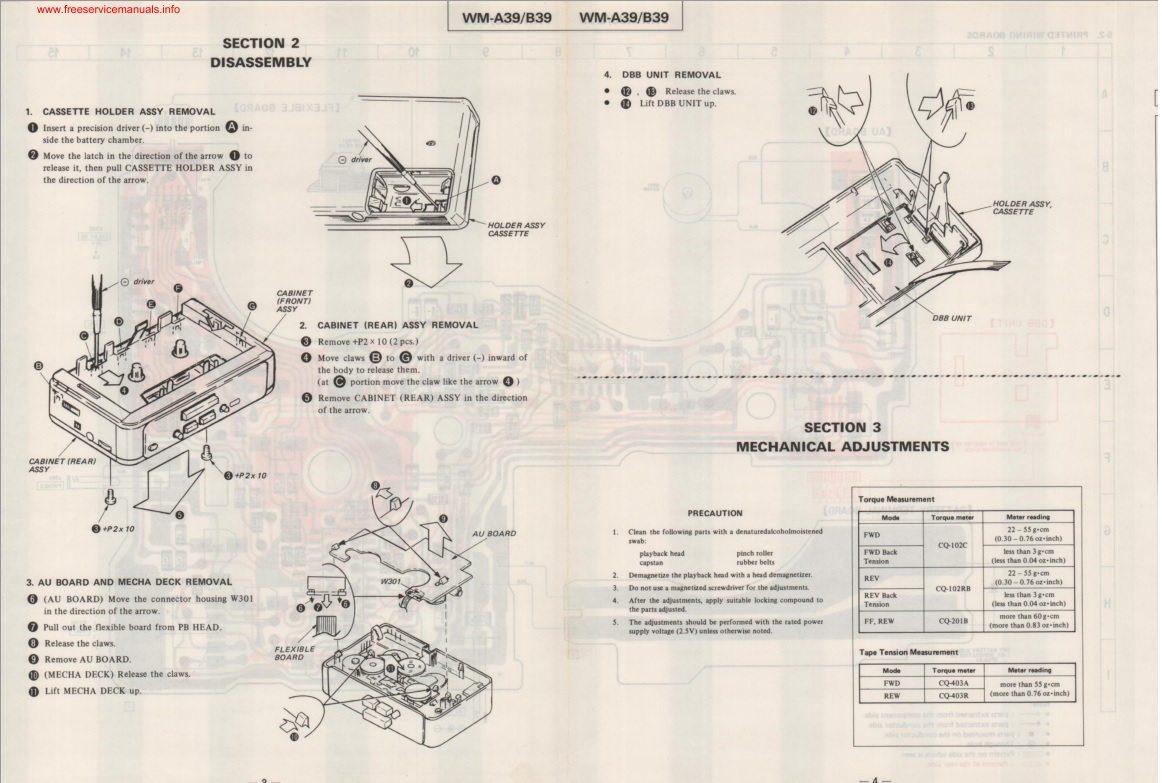

    Here is the service manual (different model number but same chassis etc), contains opening instructions. They are a pretty easy one to work on.

    Can't see the service manual, is it an attachment?
  9. T-ster
    1,465
    Hmm, it keeps uploading but not displaying, here is the relevant page as a jpg

    Got it, thanks mate.

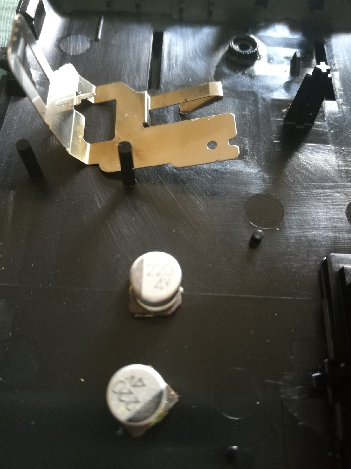

    Right I've managed to repair one of my wm-b39 but I'm stuck with my other one. Il upload a pic to show you that two of the cells have come off the board and I'm not sure how you are supposed to reattach them.
  13. T-ster
    1,465
    Those are surface mounted caps mate, they will need to be resoldered on. You will need to get replacements, desolder the old legs from the other ones and solder on new ones. Its pretty tricky. I recapped a walkman recently and it requires a good amount of skill i would say.
