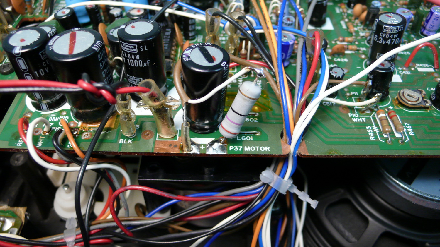

    I had this exact problem with my (surprisingly, also Hitachi) TRK-5190H. Speed was not adjustable for that model. My cheap'n'dirty fix was 2W resistor:
    A few weeks ago I bought myself another TRK-5190, it will be interesting to see if it has the same problem.

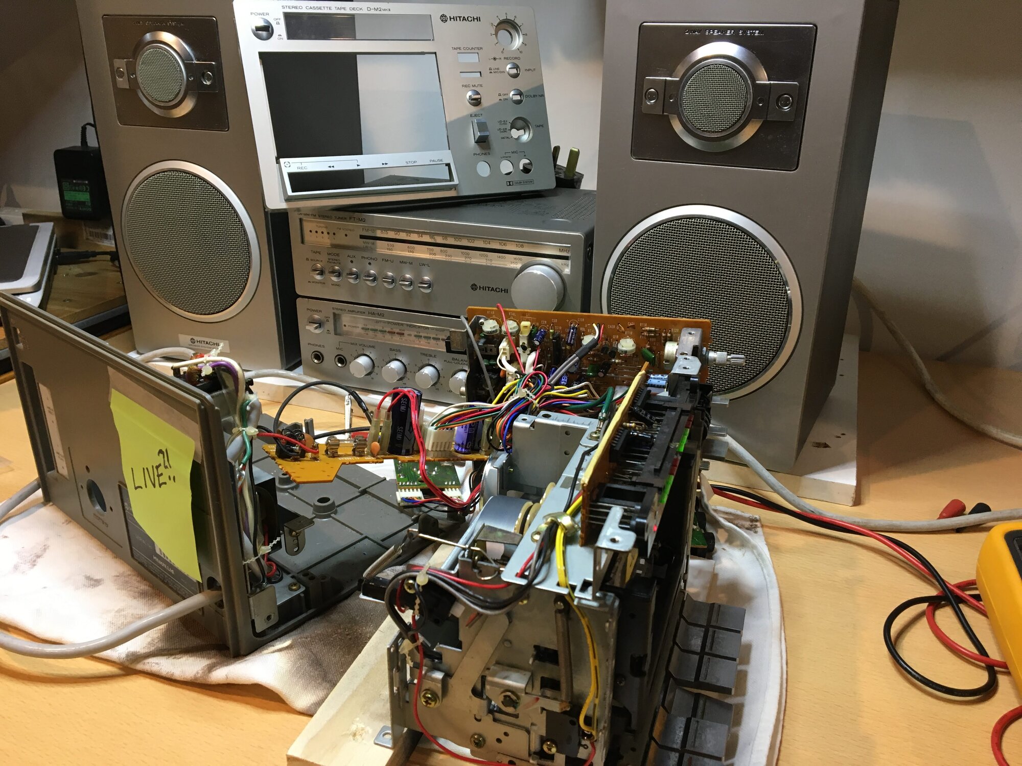

    I will load some pictures.

  5. Jorge
    1,754
    do not see much from this angle... except that your Hitachi looks real nice! Should you decide to be that crazy, reduce only capstan/flywheel pulley. Pickup works thru slippage of the reel, the hub itself rotates at higher speed anyway.

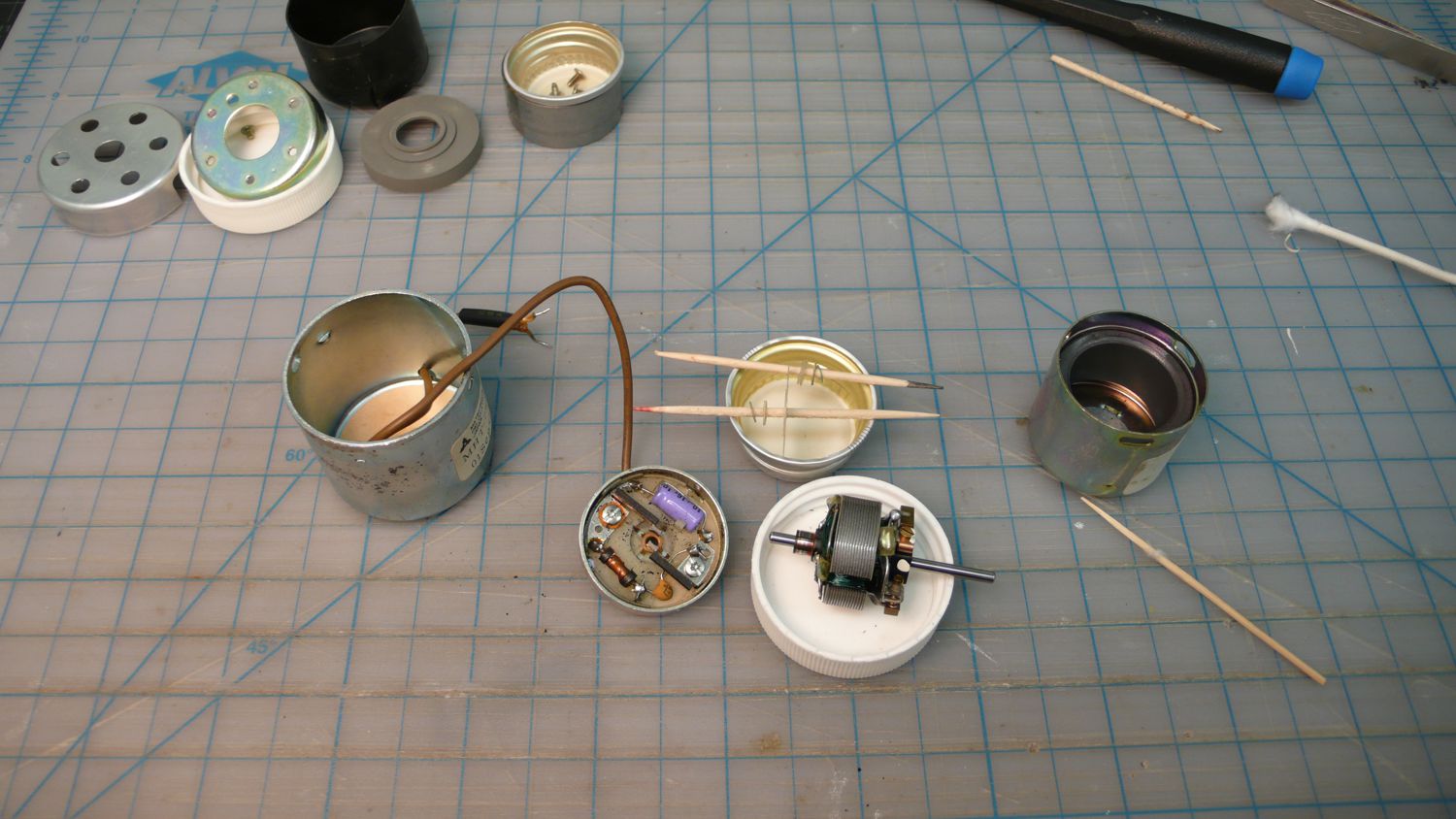

    I did not know that, I thought in-motor speed regulator is something more basic! looks like opening the motor and digging out its regulator is your only 'correct' choice. I remember it was doable for JVC El-Diablo motor, it was held together by screws
