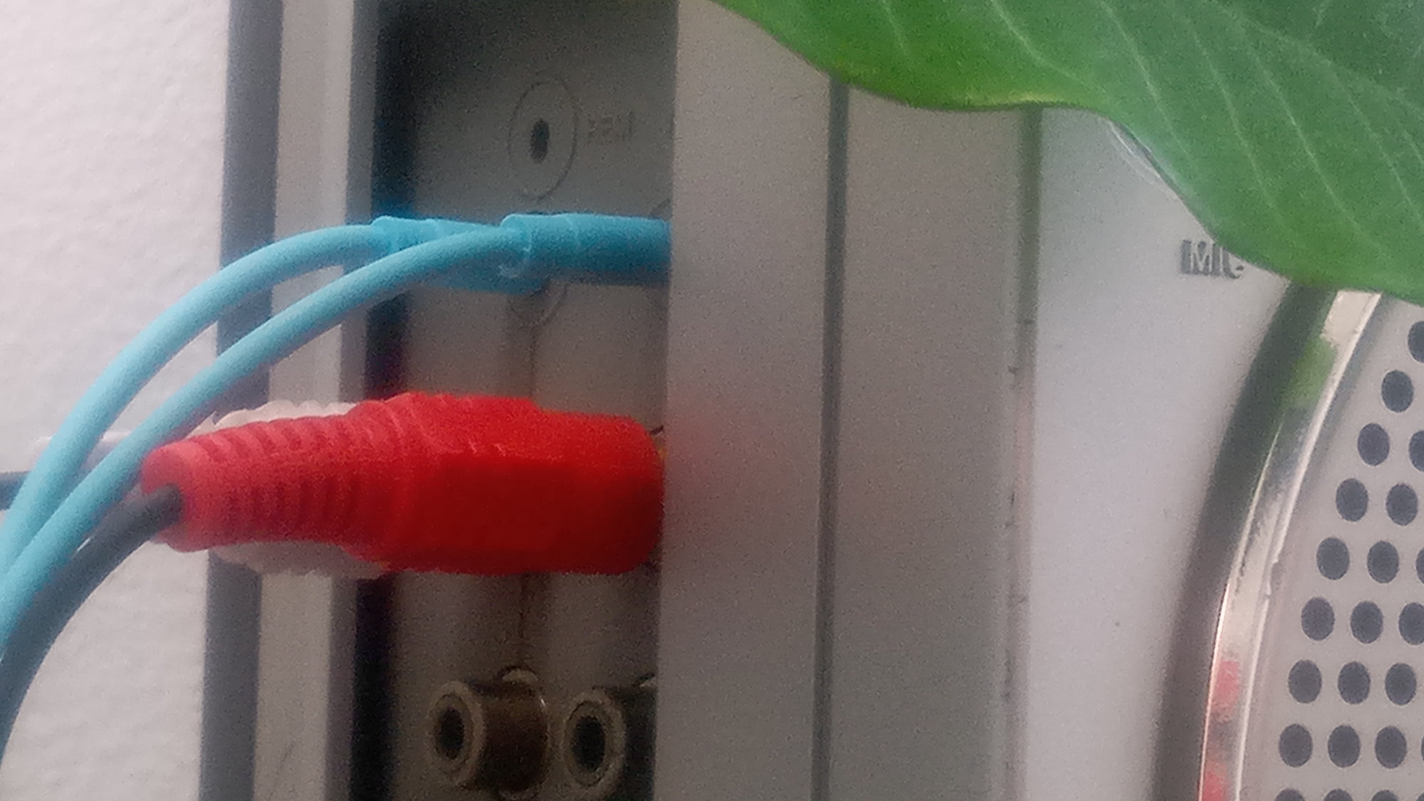

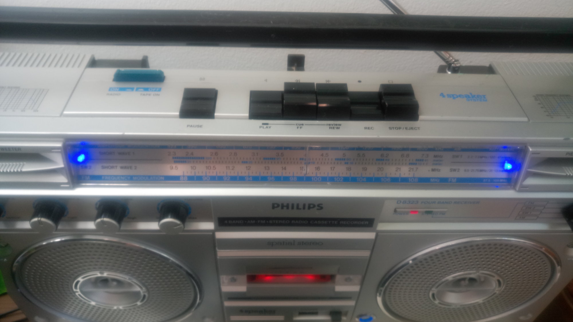

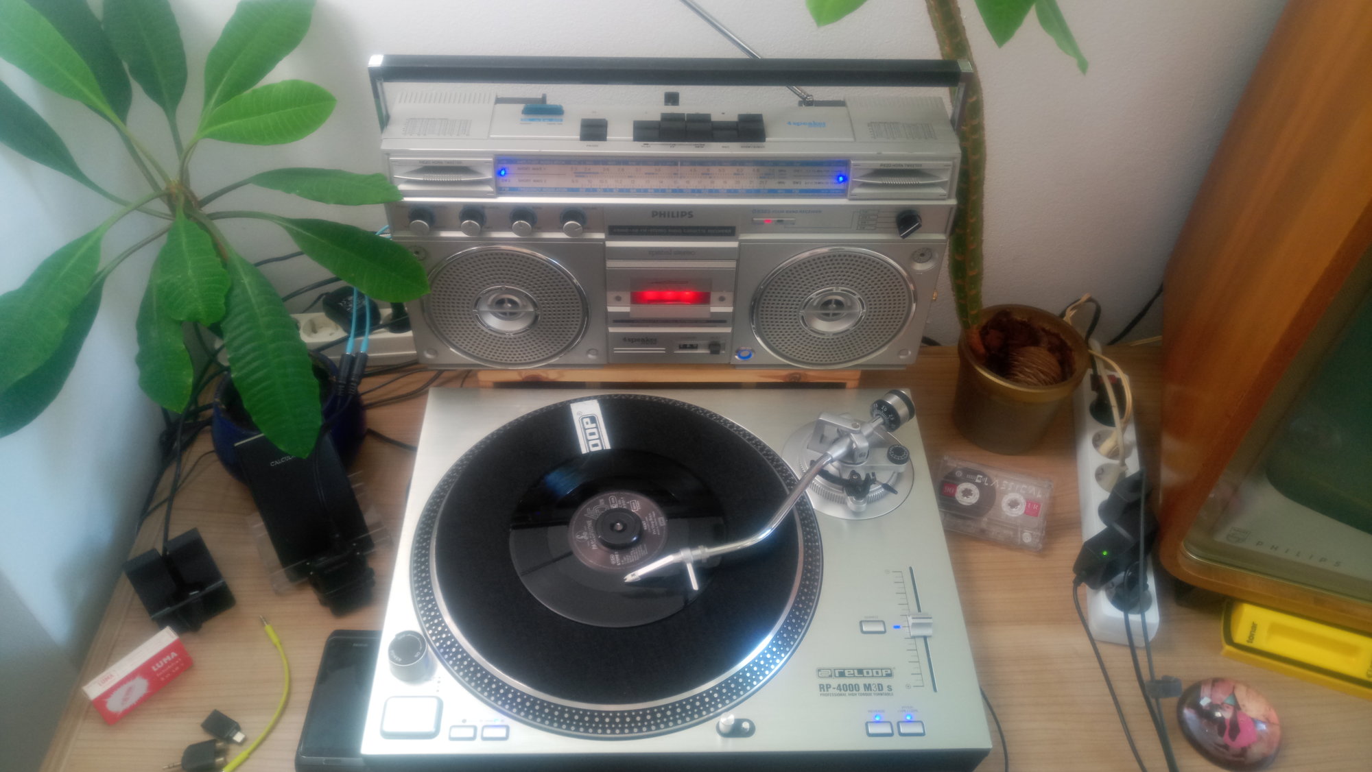

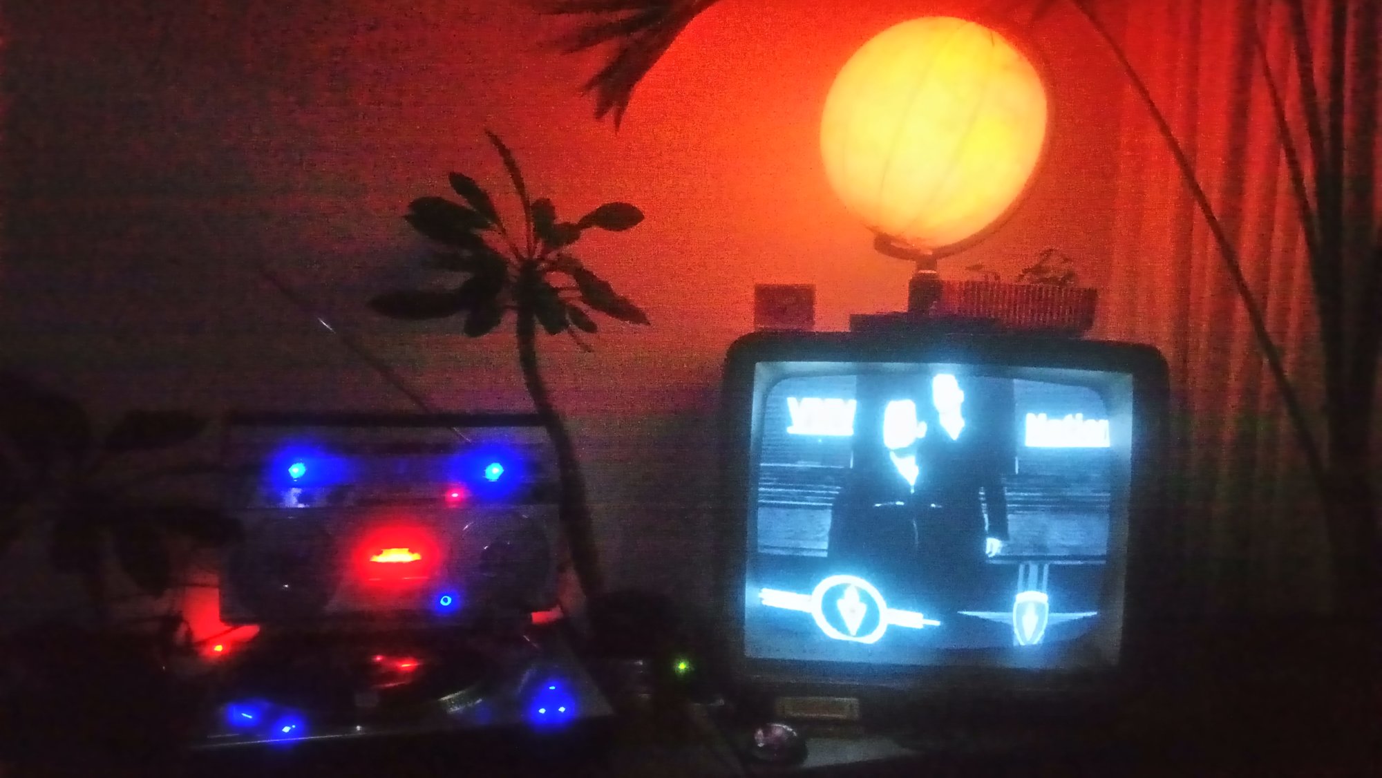

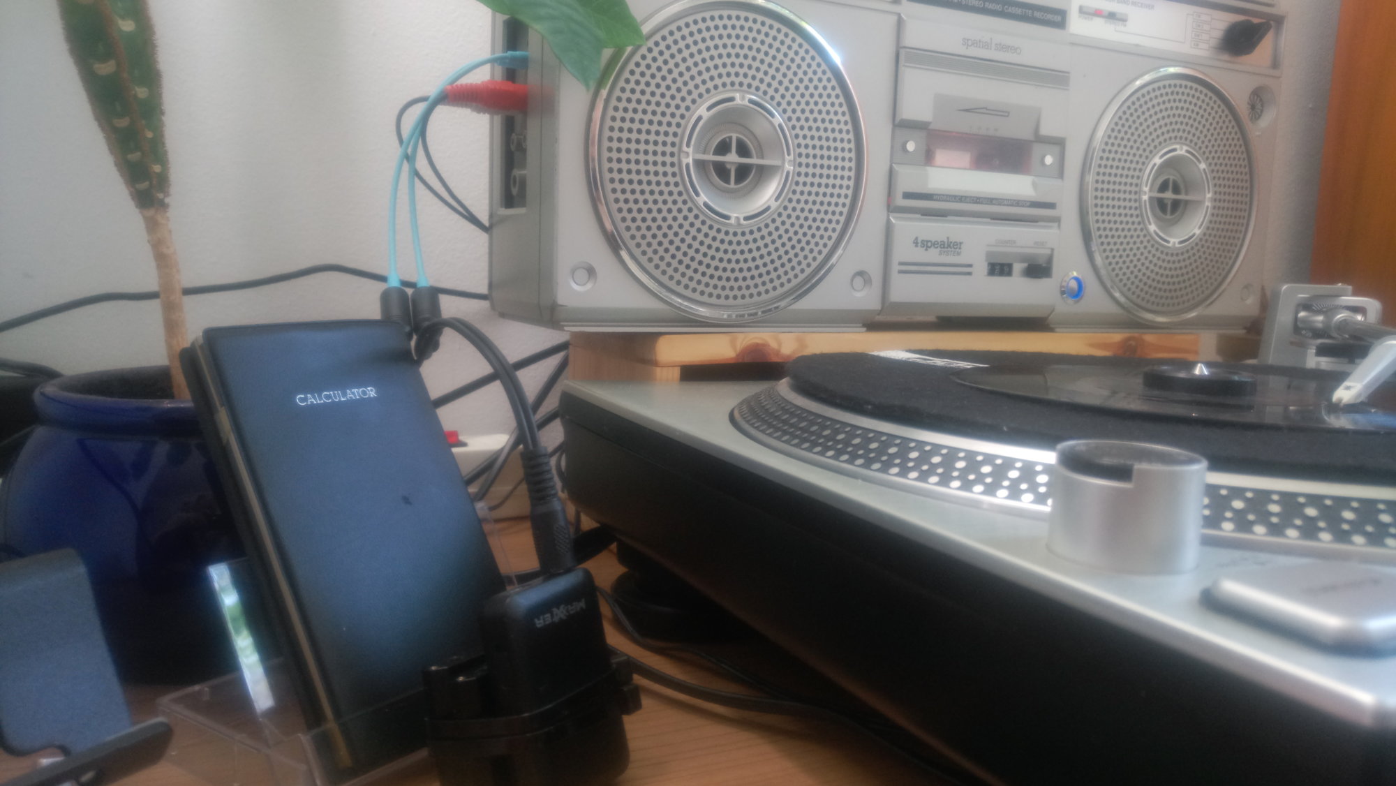

    As promised a few pics of my set up: content%3A%2F%2Fmedia%2Fexternal%2Fimages%2Fmedia%2F200150.jpg
    Line in cables to rf>>av>hdmi>chromecast-converter > television.
    Mic in cables blue > splitcable black > bt-receiver.
    Cheap Maxxter bt receiver, buzzed a lot when I plugged it in the "line in".
    Now plugged in the "mic in" socket no buzz at all.
    content%3A%2F%2Fmedia%2Fexternal%2Fimages%2Fmedia%2F200157.jpg play, rec buttons pushed in: the volume now is much louder (amplified?), no hiss / buzz.
    Listening wireless bt from my smartphone
    Playing music videos on yt through chromecast from my smartphone. Sound & Vision by Philips

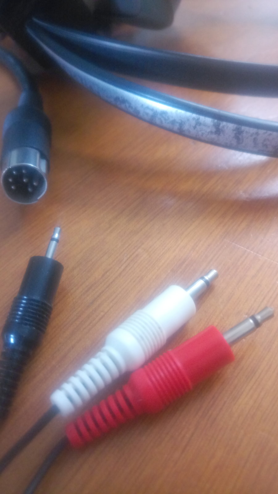

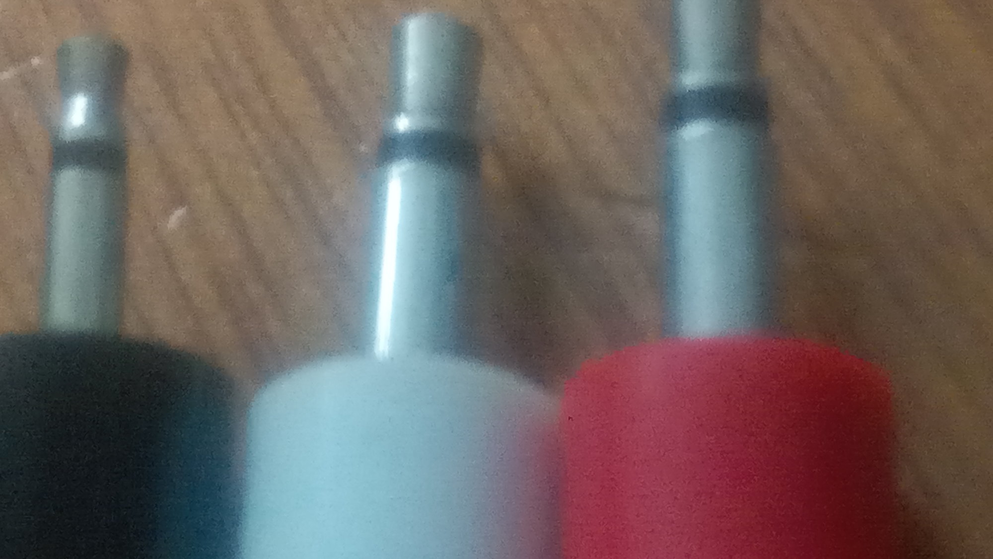

    content%3A%2F%2Fmedia%2Fexternal%2Fimages%2Fmedia%2F201840.jpg content%3A%2F%2Fmedia%2Fexternal%2Fimages%2Fmedia%2F201839.jpg
    @Reli
    I tried the "remote" socket with an old cable. It works! The tape motor stopped immediately when I plugged in the plug.
    Note: it has to be a 2.5mm plug (the black one is the 2.5mm). Not a 3.5mm, that won't fit in the remote socket.
