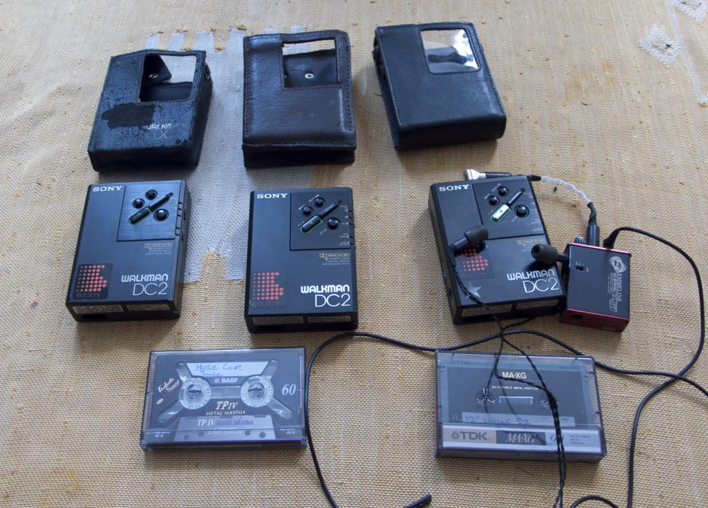

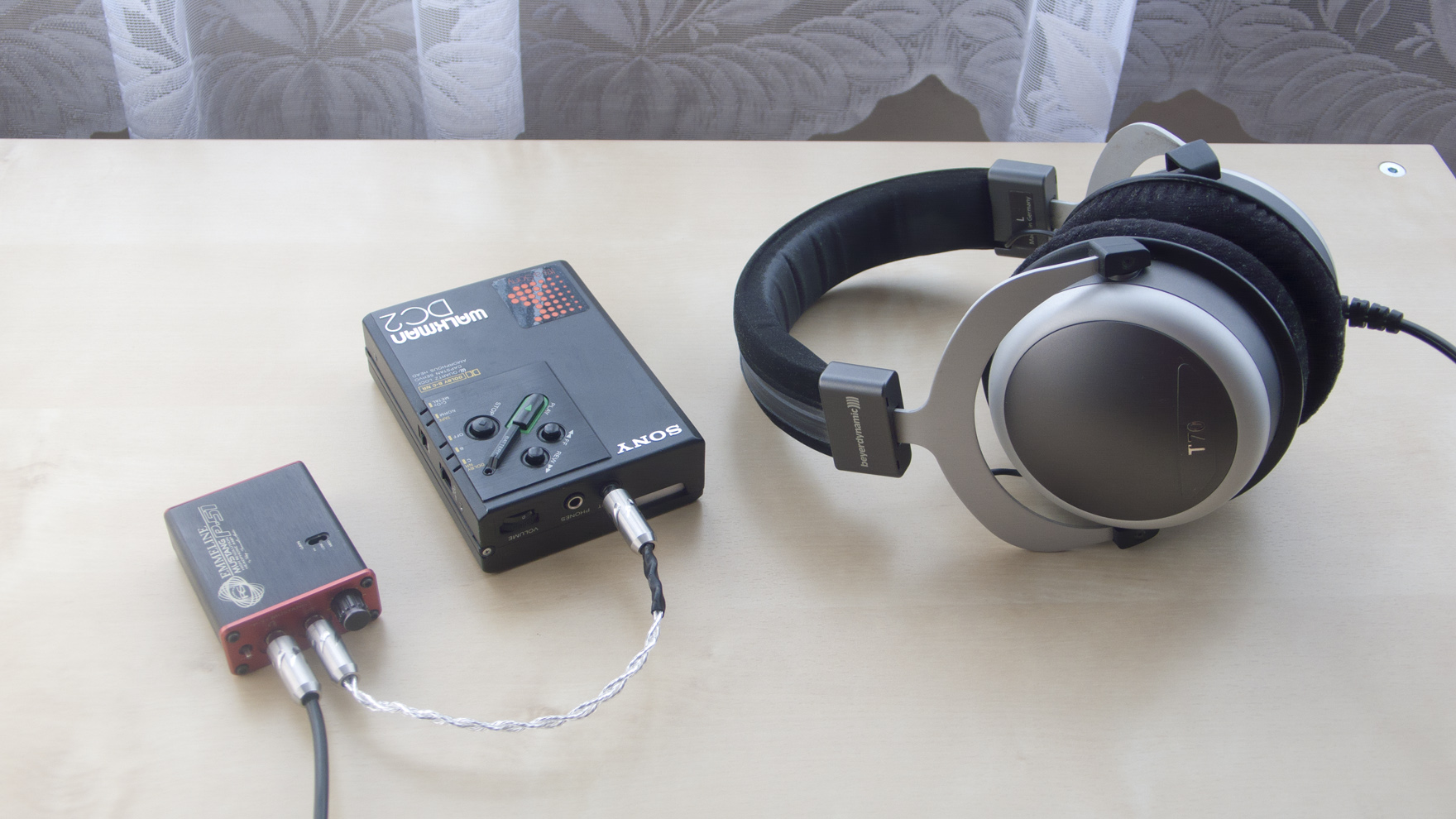

    The issue is sensitivity / efficiency, the headphones you are using a too sensitive / efficient. I take it your KZ are in-ear monitors? (IEM), IEM’s are sensitive and being close to your ear drums reveal many things.
    So either use less efficient / sensitive IEM's or get an amp that can cope with the sensitive IEM's between your personal stereo and your IEM.
    I use a Ray Samuels P-51 Mustang, it has 3 gain settings Low, Mid and High. I use the low setting for IEM’s, mid for most things and anything difficult to drive get’s the high setting.
