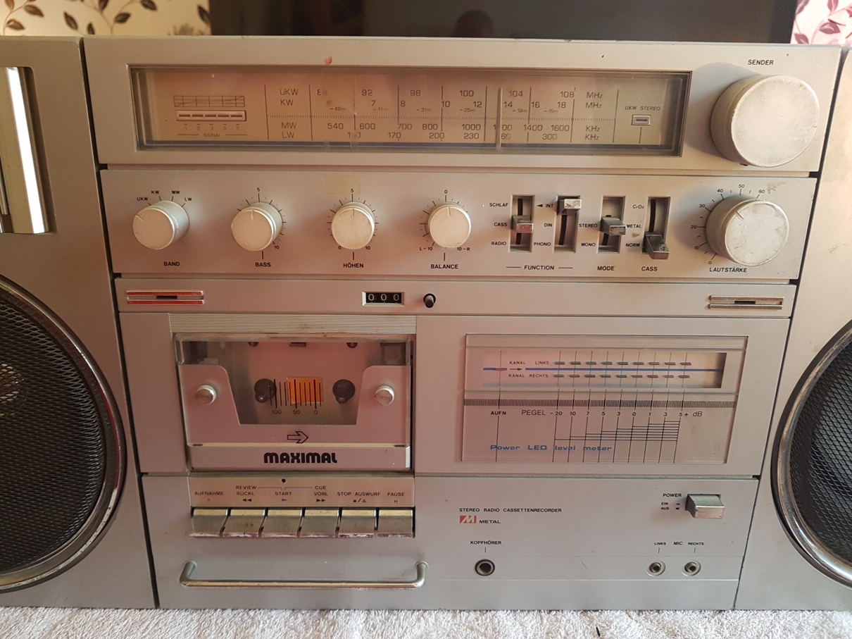

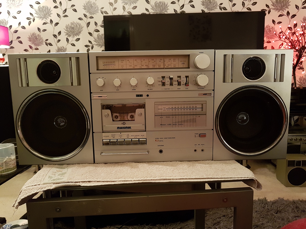

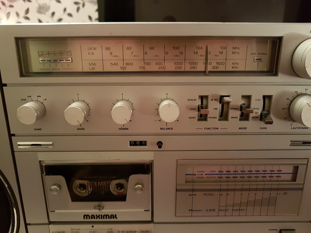

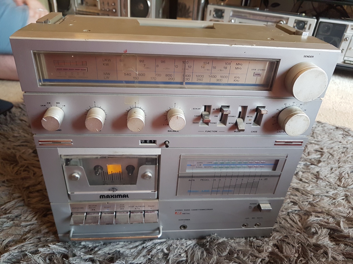

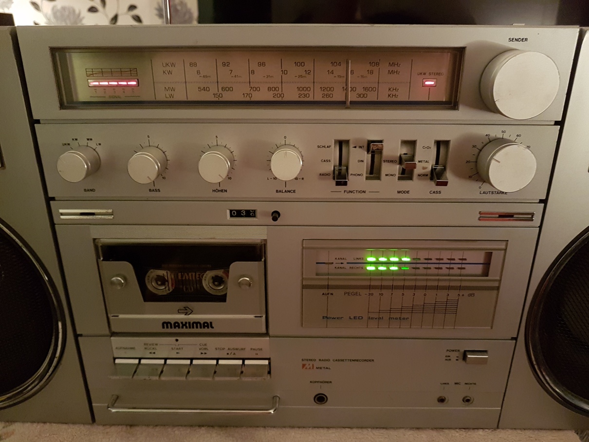

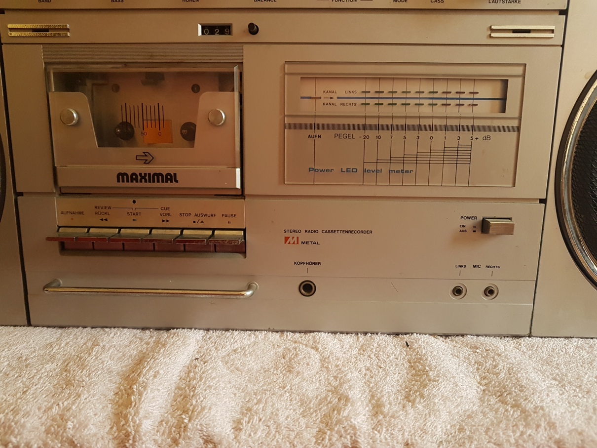

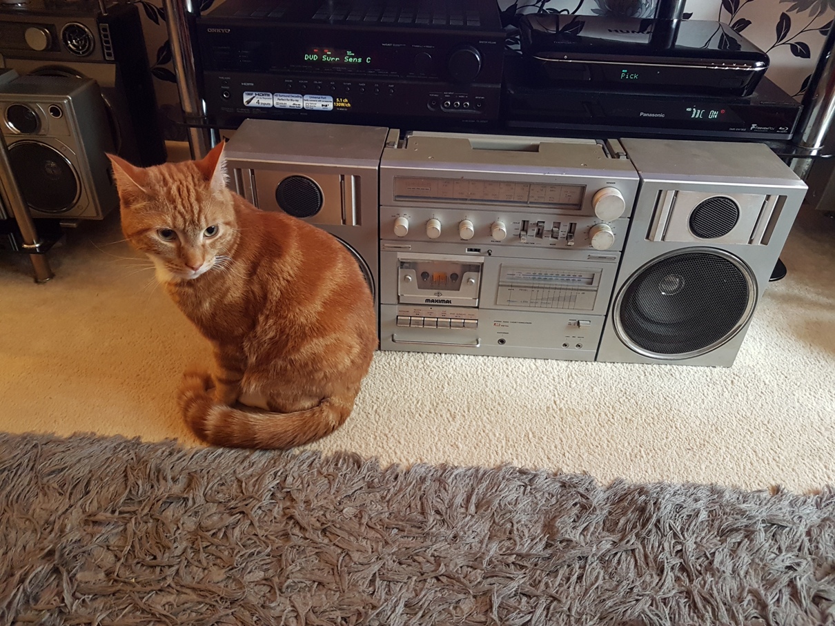

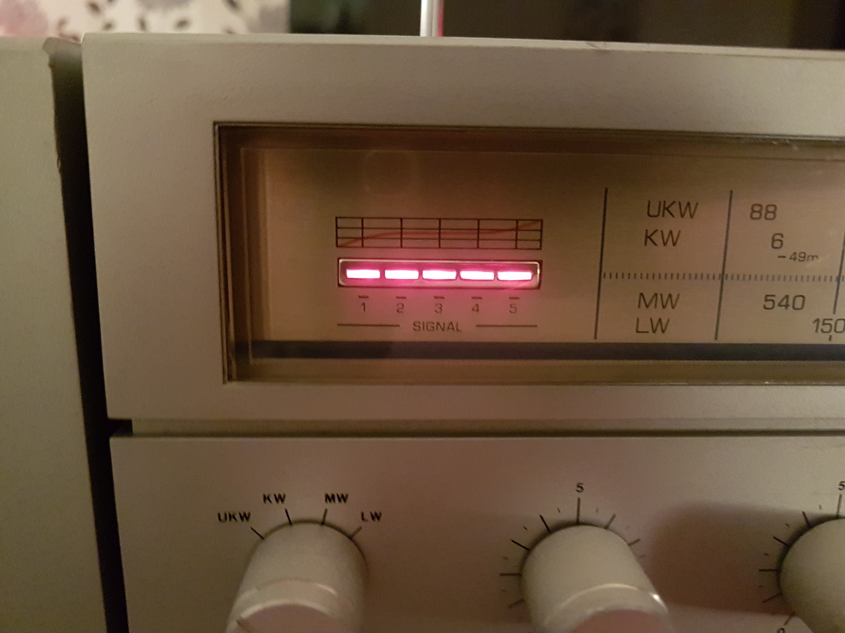

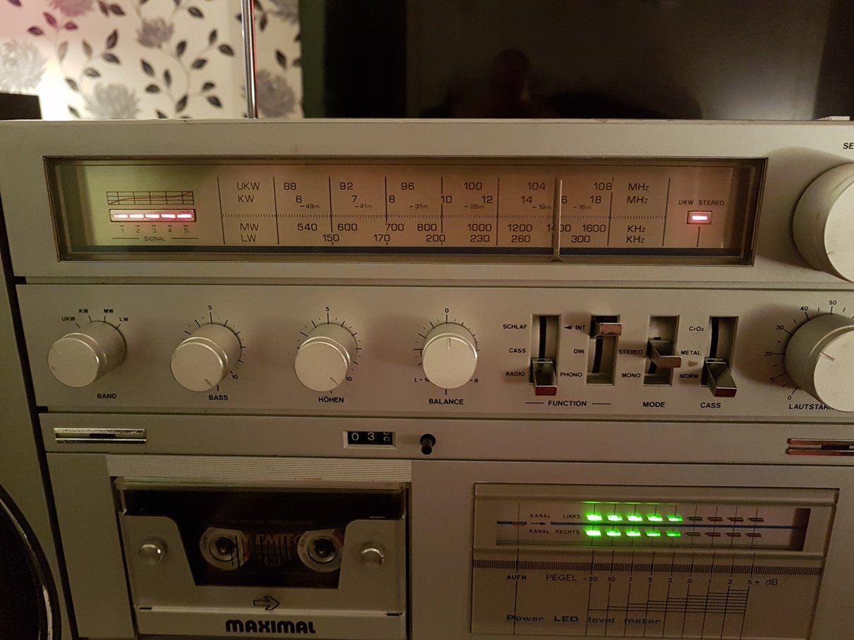

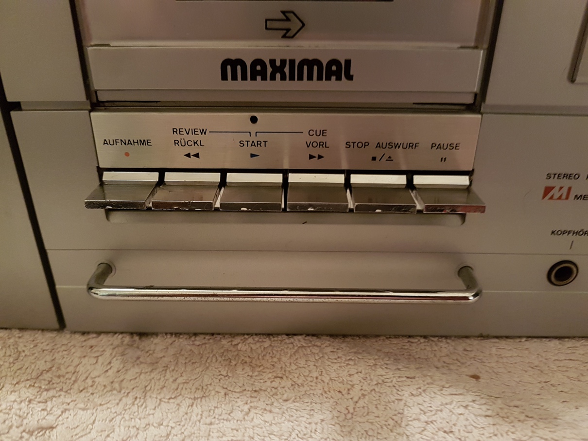

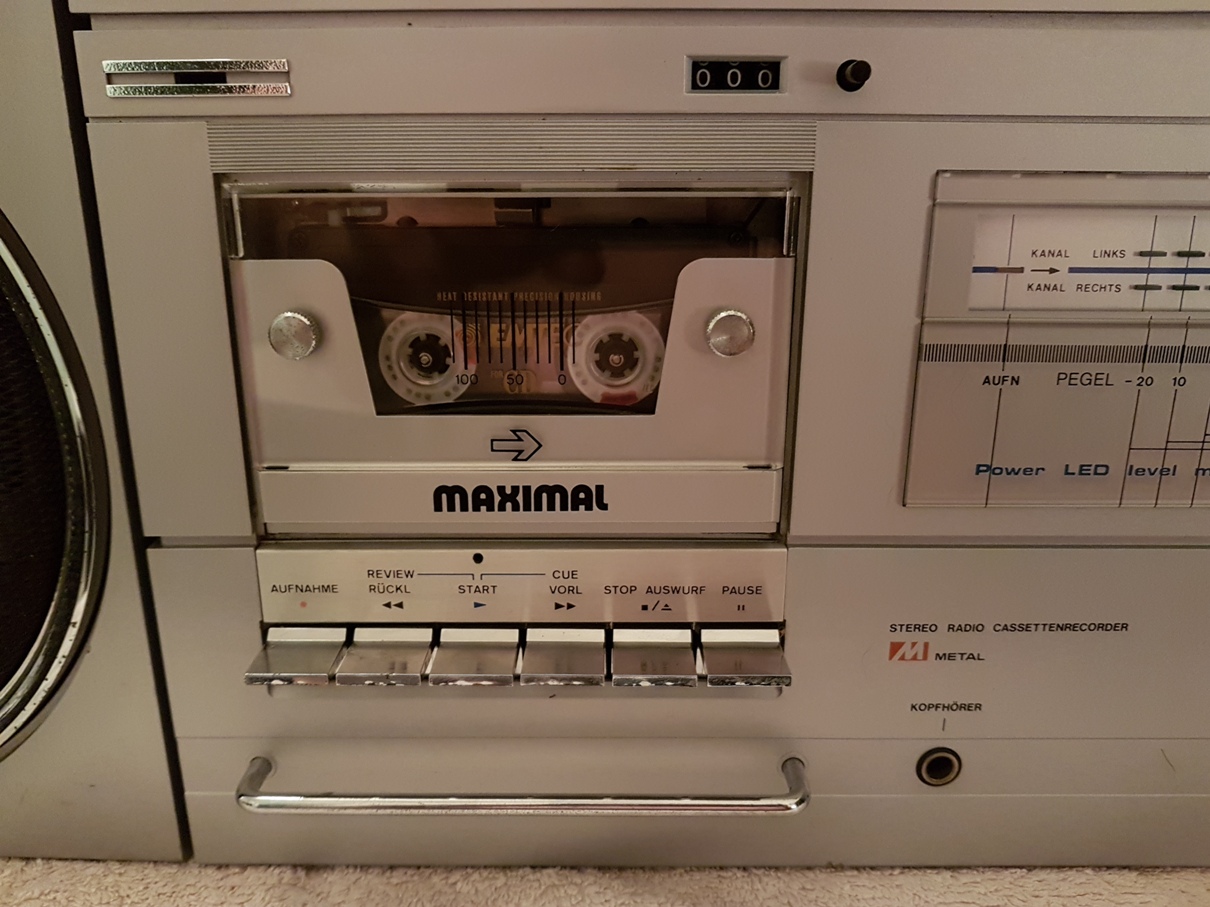

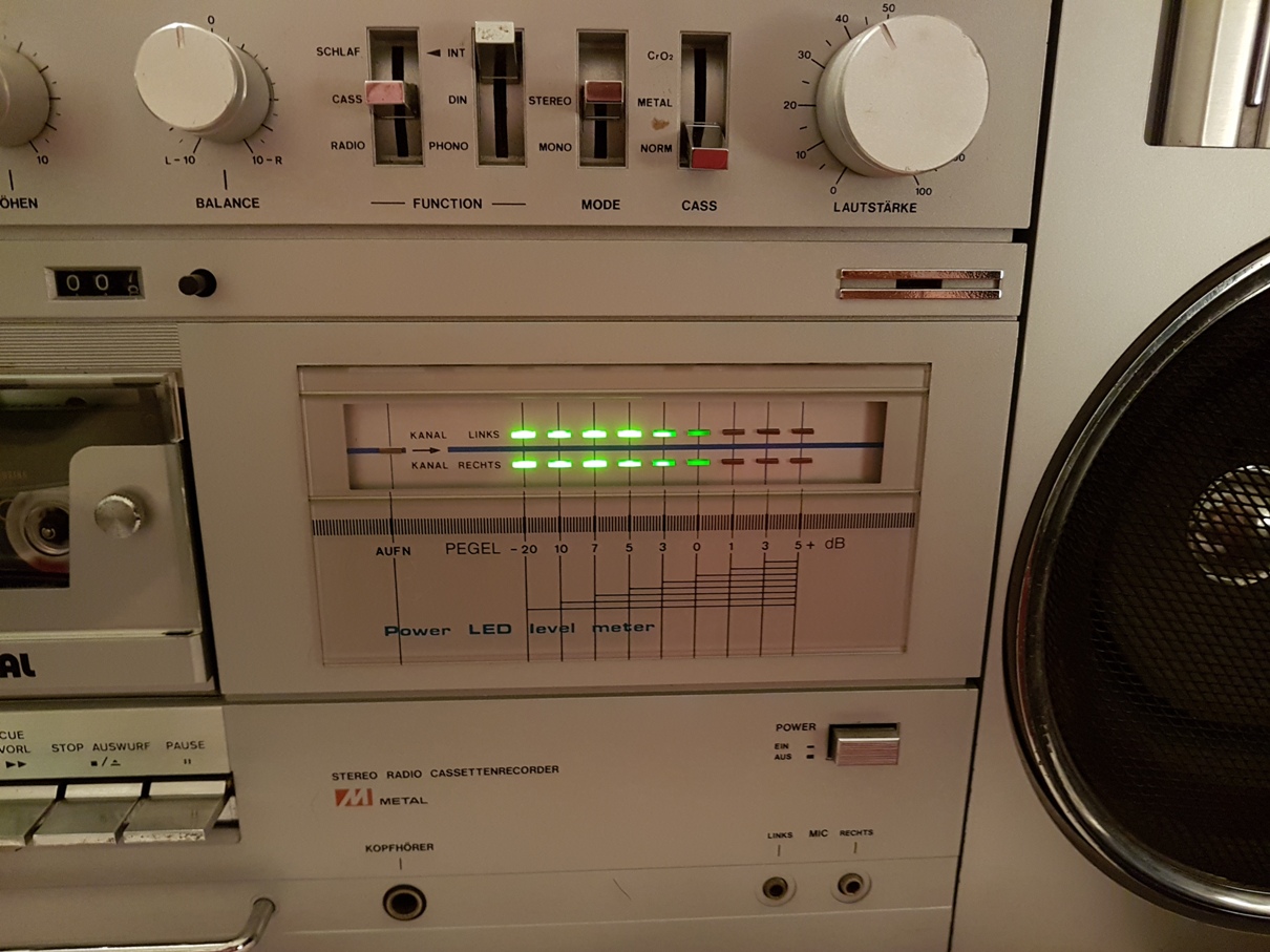

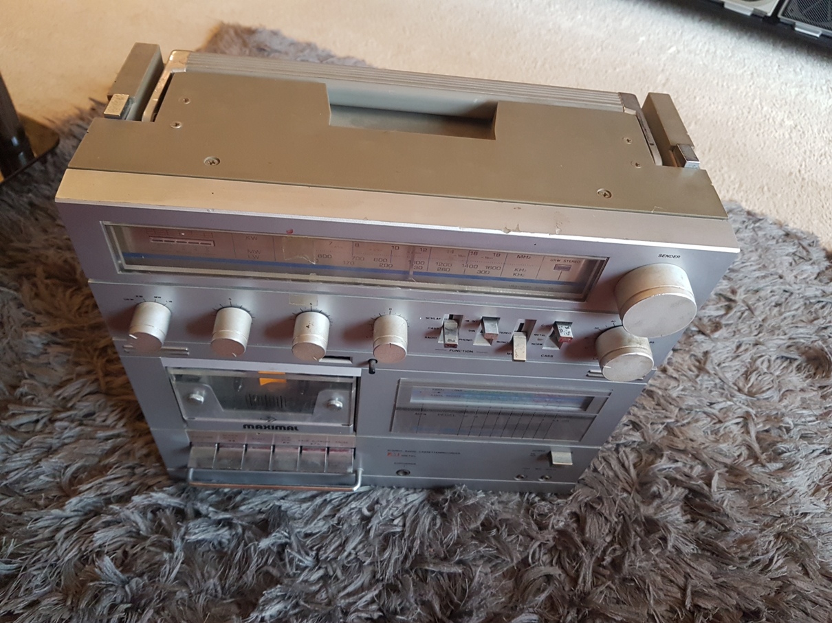

    This massive machine arrived today from Germany!!
    I simply can't resist these early 80's generic stereo's, they are never killer beasts but at the time they offered poor people (Like Me in the 80's) the chance to own something a bit different (& large!!)

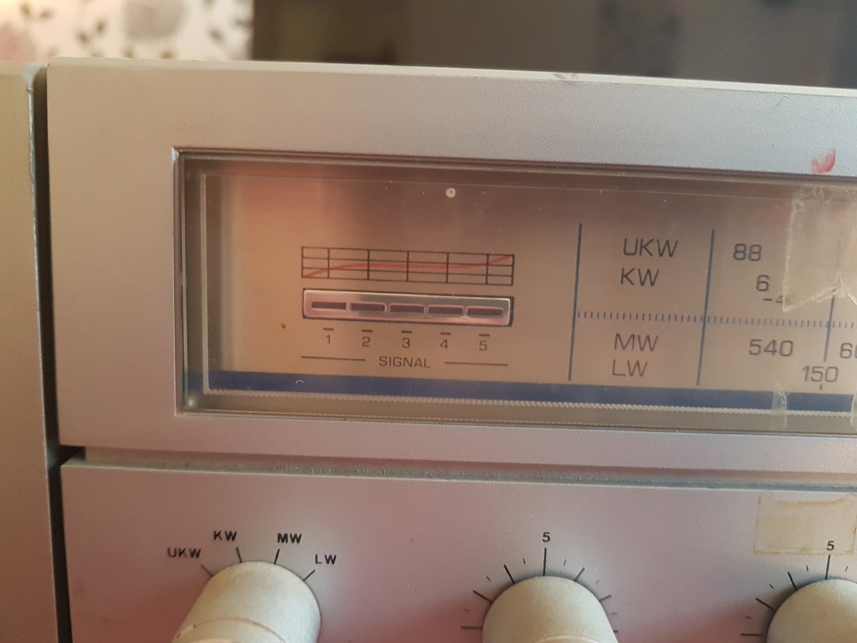

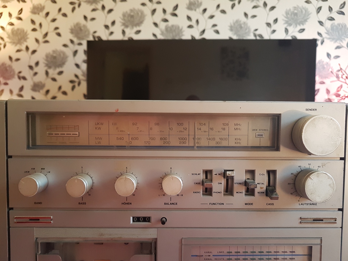

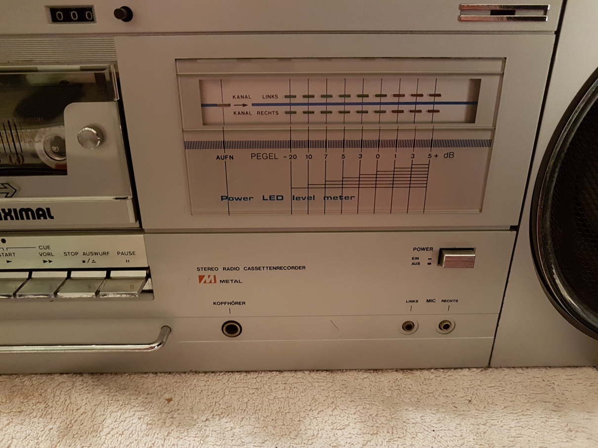

    This one goes under the moniker of the 'Maximal 3040' :biggrin: :biggrin: :biggrin: & arrived here FILTHY & I mean dirty, crud & yellow staining all over the main unit & both speakers! Also sellotape on the tuning dial Perspex & the silver frontage :iconconfused: :iconconfused: :iconconfused: Why would you????? This had been stuck there for years & was a pig to remove!!
    Now I am familiar with these silver monsters, they also sold under the Bush/Binatone badges, not this one specifically but you get the gist................
    Always a slightly dated at the time but a pressed steel tape deck built like a tank surrounded by passable electronics & with this one - a very sensitive & stable tuner :nodding: :nodding: :nodding:

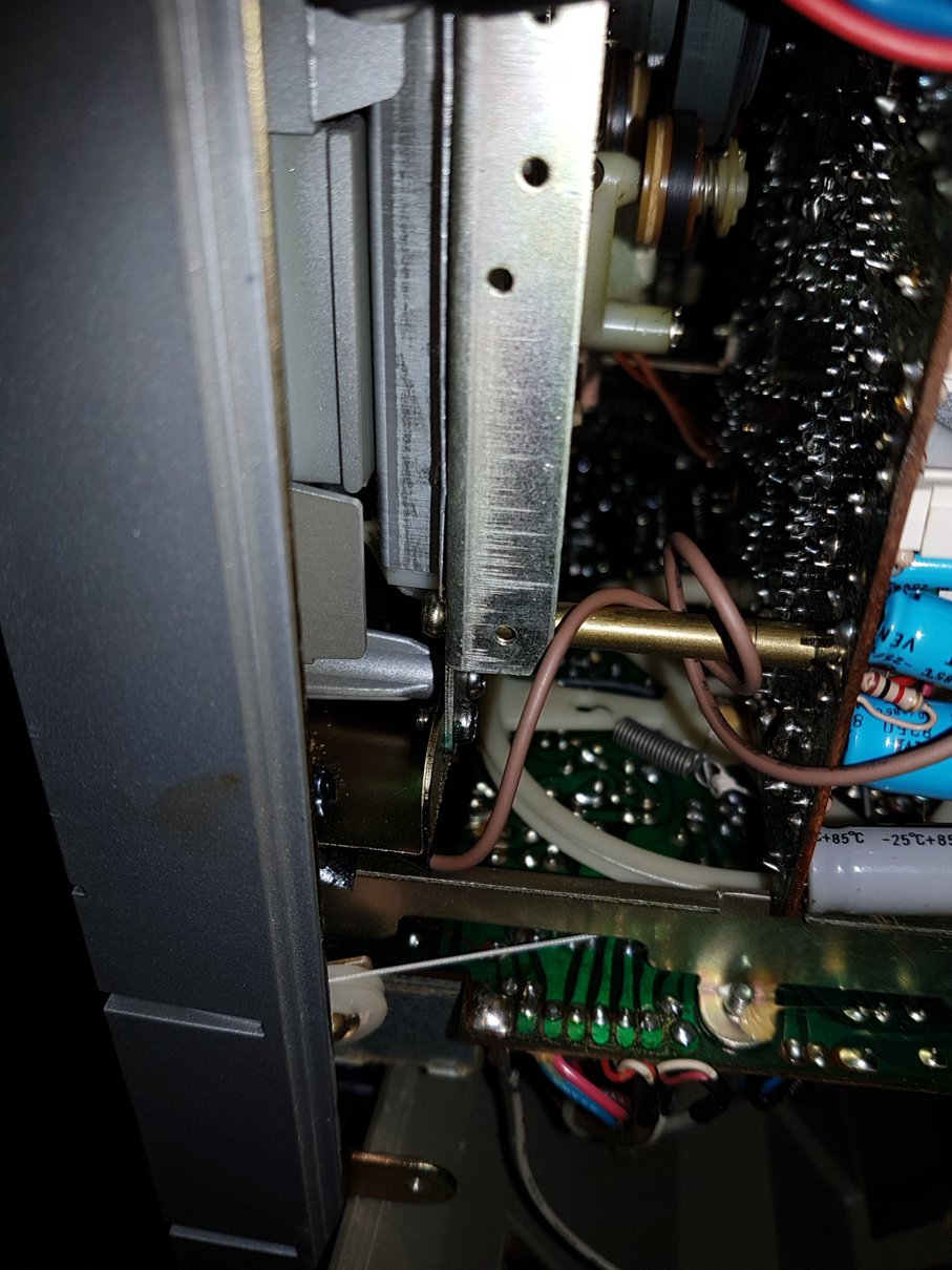

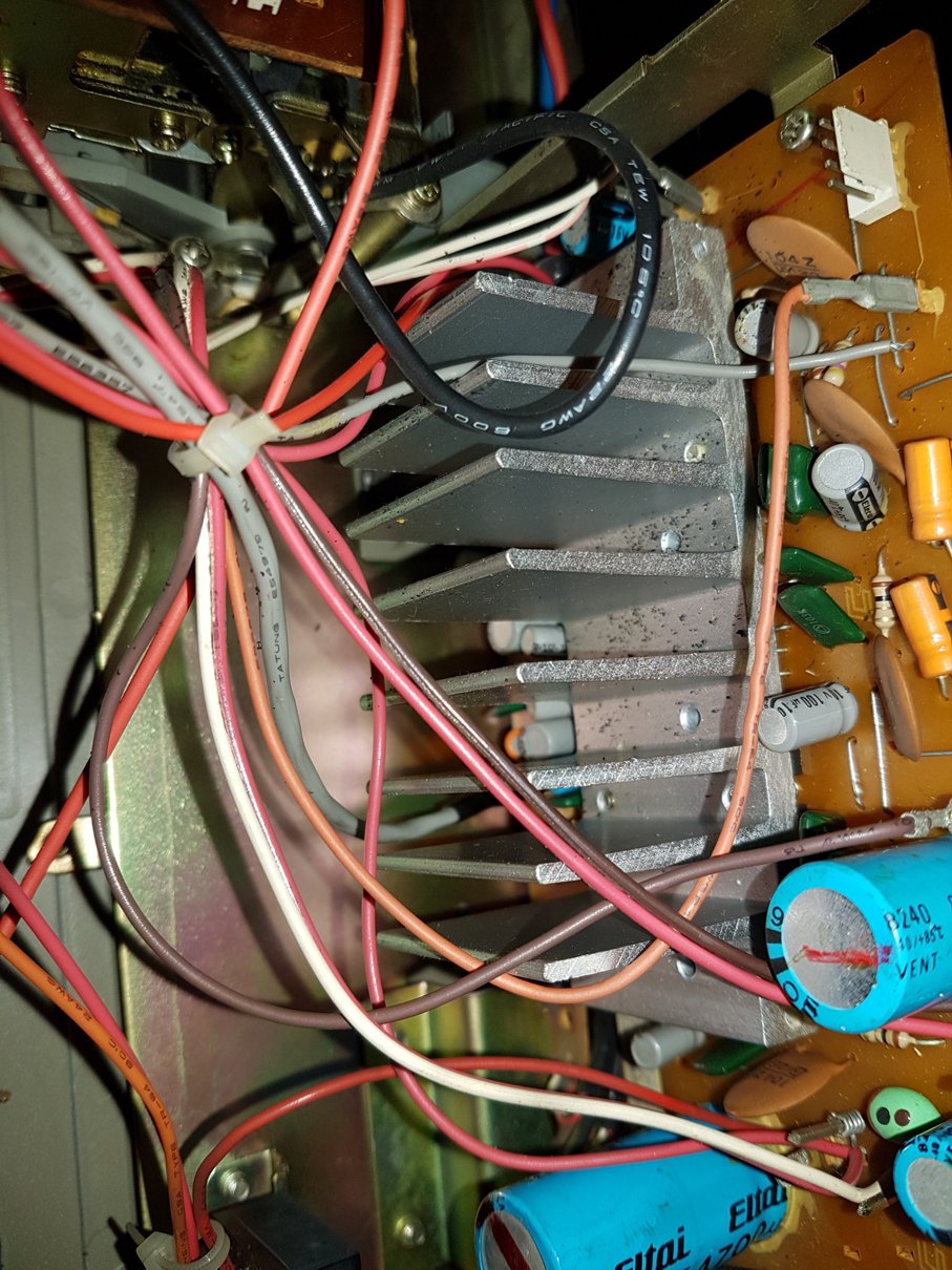

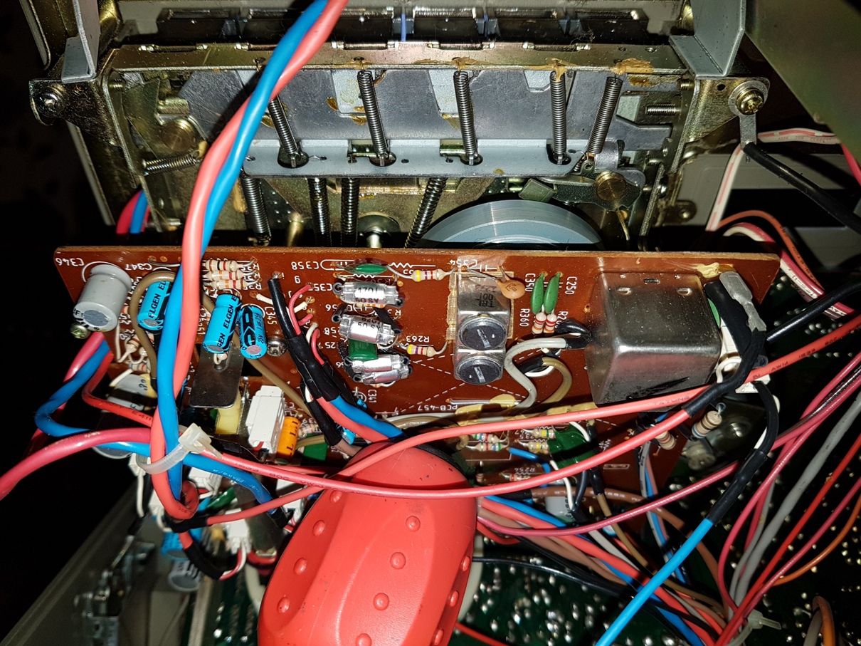

    Not a great deal to do internally really, took so many pictures & they were so helpful on
    reassembly as there a lot of wires inside & not all pluggable as per bloody usual :nono :nono :nono

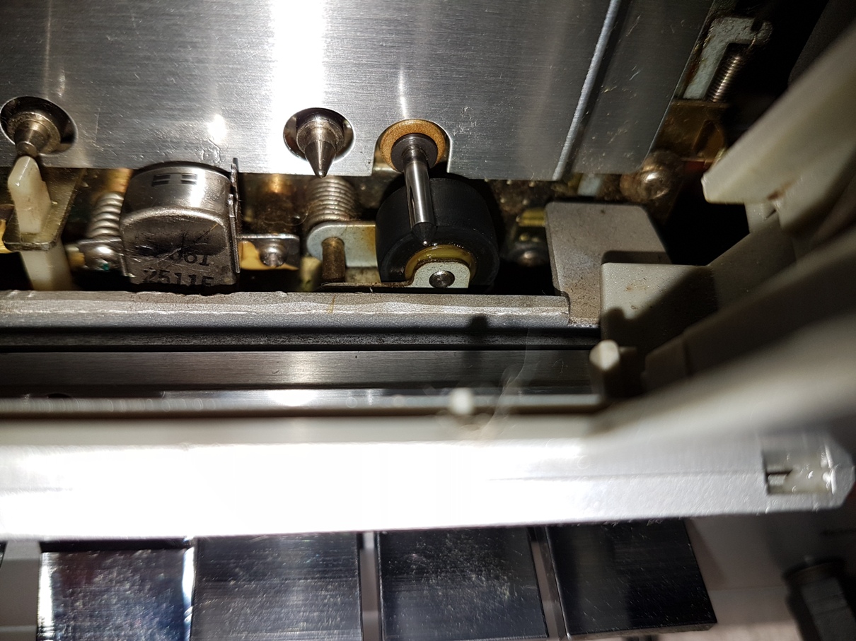

    Replaced the single belt after lifting the deck electronics board out of the way - This was childs play to replace the only thing I wasn't happy about was the motor...........it's mounted upside down as opposed to most mechanisms meaning: No access to the speed adjustment pot inside the motor :shakehead: :shakehead: :shakehead:

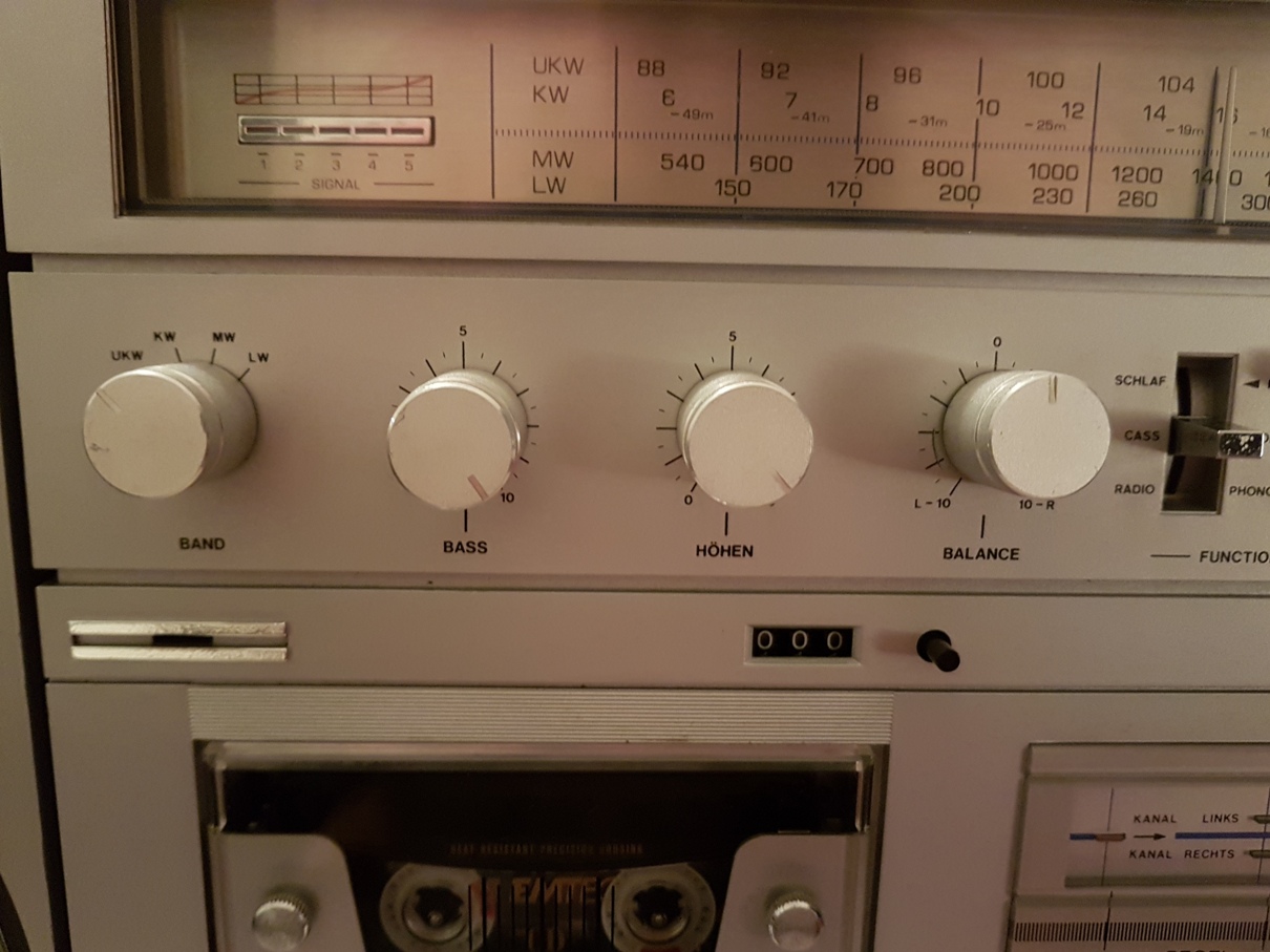

    Next came a thorough switch clean throughout before starting to put it all back!!
    Big Tits was busy cleaning all the switches (& knobs :lollegs:) while I got to work on cleaning heads pinch roller etc
    The cleaning took us longer than servicing it was so yucky!!

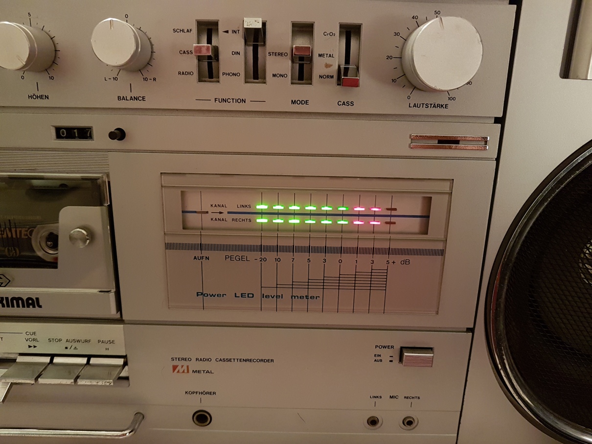

    The tape deck came back to life & all functions were just fine :reelspin: :reelspin: very pleasing when that happens - But of course, the speed needs adjusting as it is slow & the azimuth was way out & I mean way out, no treble & very muffled..........3 full turns of the adjustment screw resulted in really nice treble & so that was now sorted.........
    Just got take the deck out & try to run it while all apart to adjust the speed pot - So annoying :shock :shock :shock
    Here's a condensed down selection of images from start to finish :) :) :)
    Oh & it sounds Ace!! It's a powerful beast & I love it & so large :)
    As you would expect, there is plenty of bass & a sweet treble - I know how good these things can be - I didn't expect to be this bloody big but, of course I am not complaining - This is a keeper for sure which is why I bought it!!
