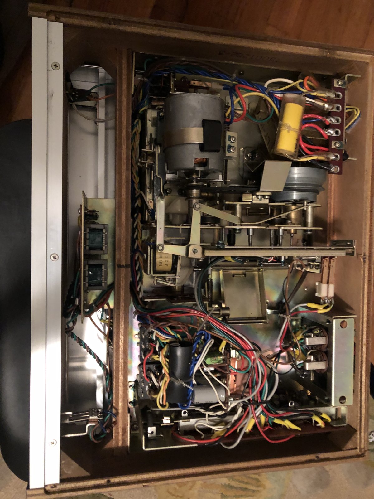

I was recently going to create a mixtape for a friend but my cassette deck plays/records too fast and I was planning on adjusting the speed, I thought this was going to be a simple job like adjusting the speed on a Walkman but I was wrong! This cassette deck is the concord F-120 cassette auto changer. I don’t have the user Manuel nor could I find any info on servicing, anyone have a clue on what I could do where the speed adjustment would be on this?

it may have the wrong belt on it, too thick someone replaced it? was it working ok before? cant see the pullies too well
I think your belt is placed wrong at the capstan side , try to move the belt at the point that shows the red arrow and see what happens.
