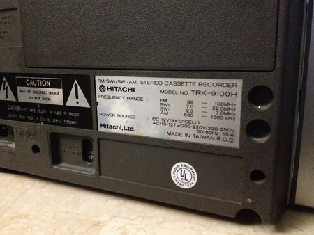

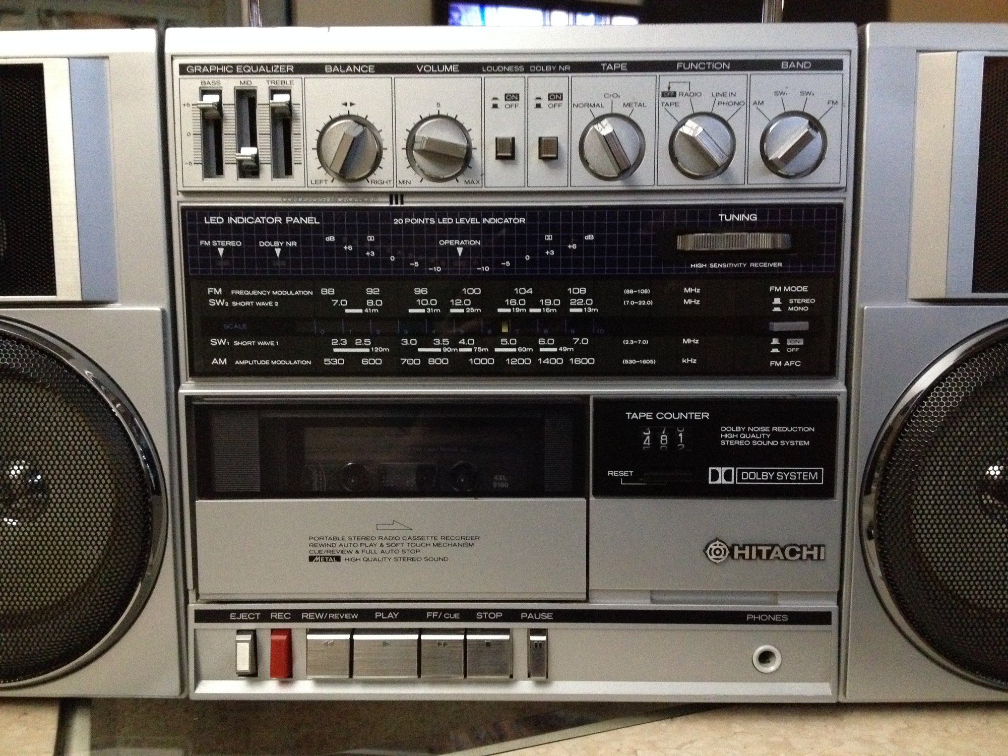

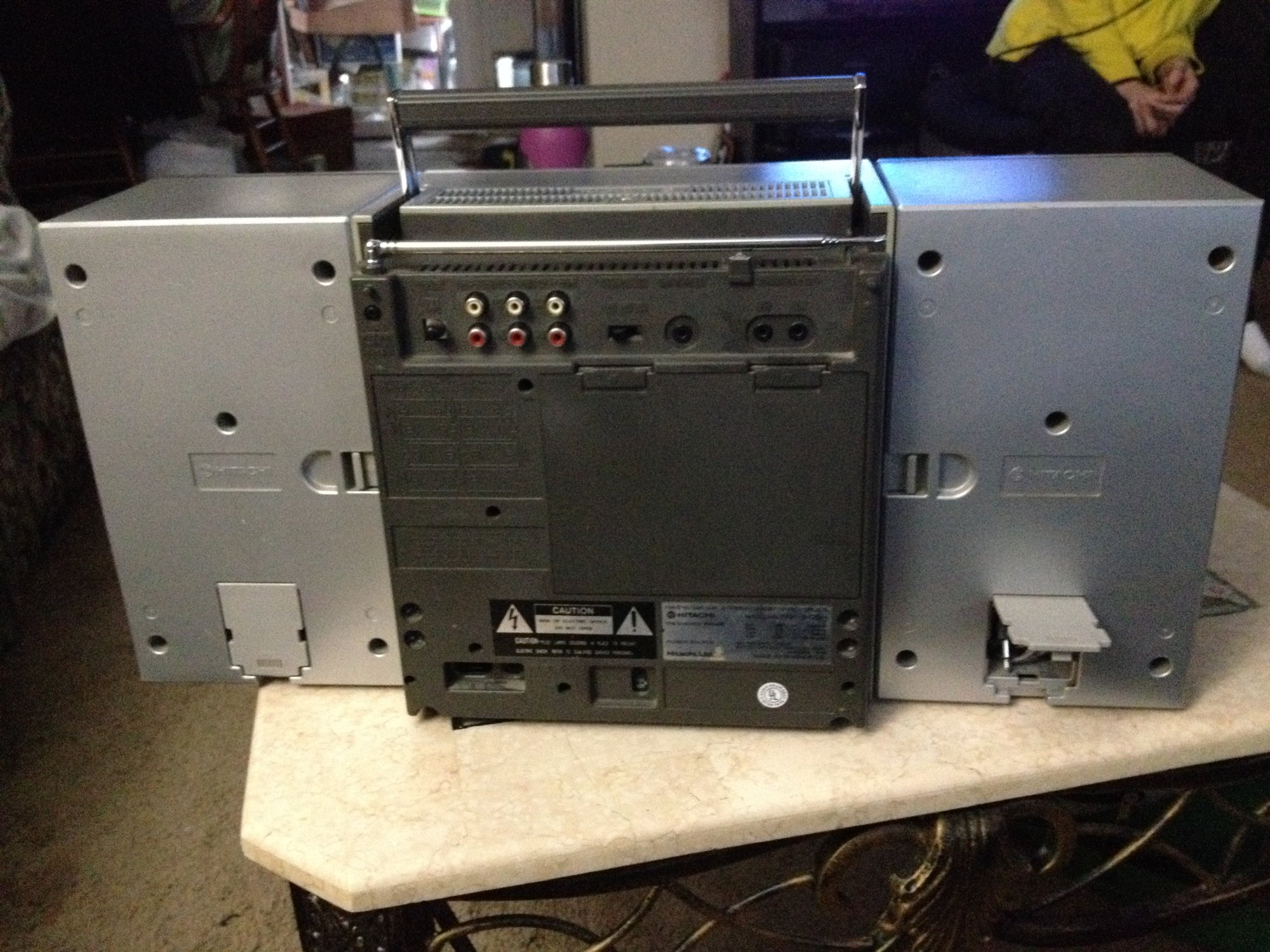

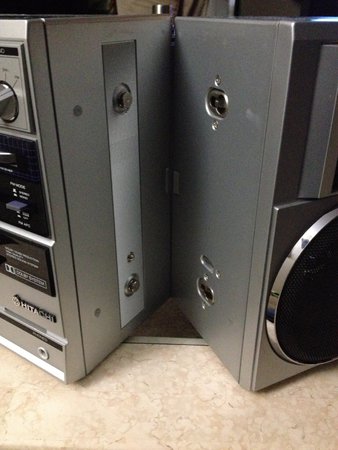

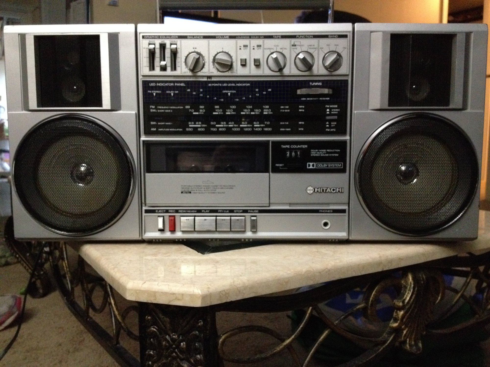

    image.jpeg I just got my first Hitachi boombox for a great deal. I had to replace the cassette deck belt and clean it up a bit. It turned out to be a great looking boombox and heavy, too! This thing weighs more than my Panasonic 5085, or my Aiwa CS 800U! Solid as a rock! The sound, on the other hand is a bit meh, but great construction and the tape mechanism has a heavy steel flywheel for smooth, clean playback. image.jpeg image.jpeg Wireless speaker connections on the side image.jpeg compartment in back of speaker boxes contain the wires for when separating speakers image.jpeg AM, FM, SW1 and SW2 bands, 3 band EQ, and Dolby noise reduction! image.jpeg

    Ingenious compartment for the speaker cables. I wish all 3 piece models had this. Very nice Hitachi!

    I did just that! The original speakers had no give to them whatsoever. No wonder there was no bass! I found some others I had out of an old basket case and these were black and had plenty of throw. Low and behold, we have bass! Sounds so much better now. Now for some better tweeters! image.jpeg Looks better, too!

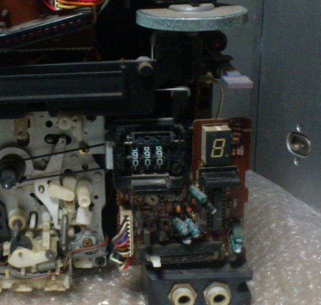

    Yes, I have seen photos of the grey ones. I do prefer the platinum colour much better. I also saw a photo of one that had a digital numerical display for an auto music search. Must have been a Japanese model. Also seems to have a Mic input with mic mixing slider. image.jpeg image.png

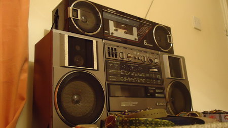

    I have one of these and really love it - useful with a DIN to mini jack Line in - plus, the flat top means you can stand another boombox on top - I have a Sanyo M7740k which looks very sweet on top!

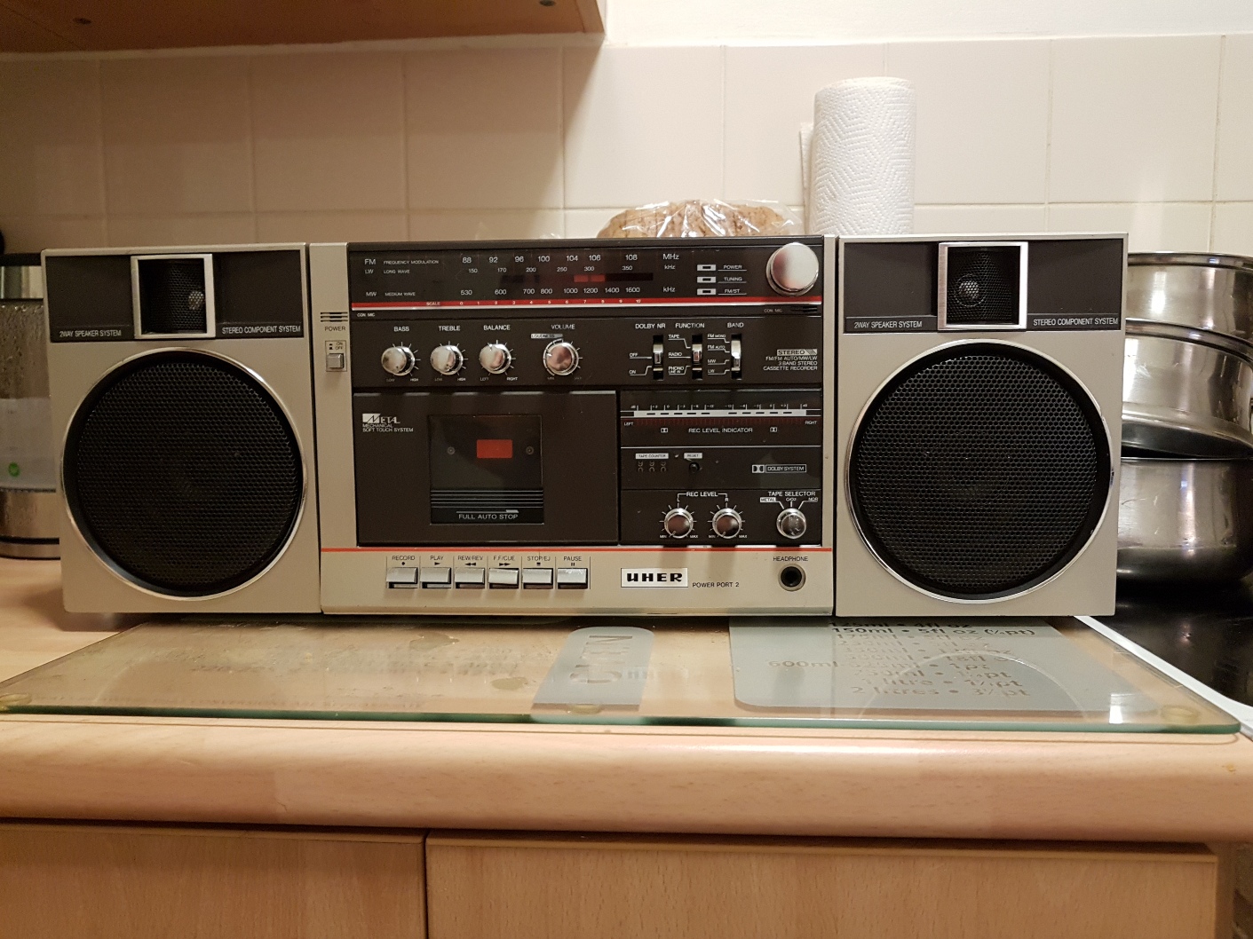

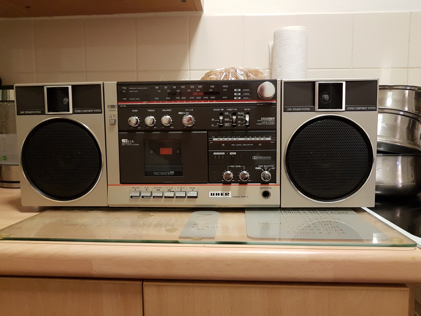

    I like these Hitachi's a lot............as I have said before though, they struggle to deliver & I'm talking before the 3D's came along - This was a common trait with so many Hitachi stereo's!!
    They are so reliable & like the Sharp models the electronics rarely go wrong leaving a simple belt repair to bring back to life................

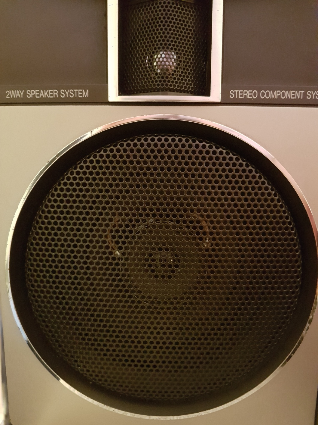

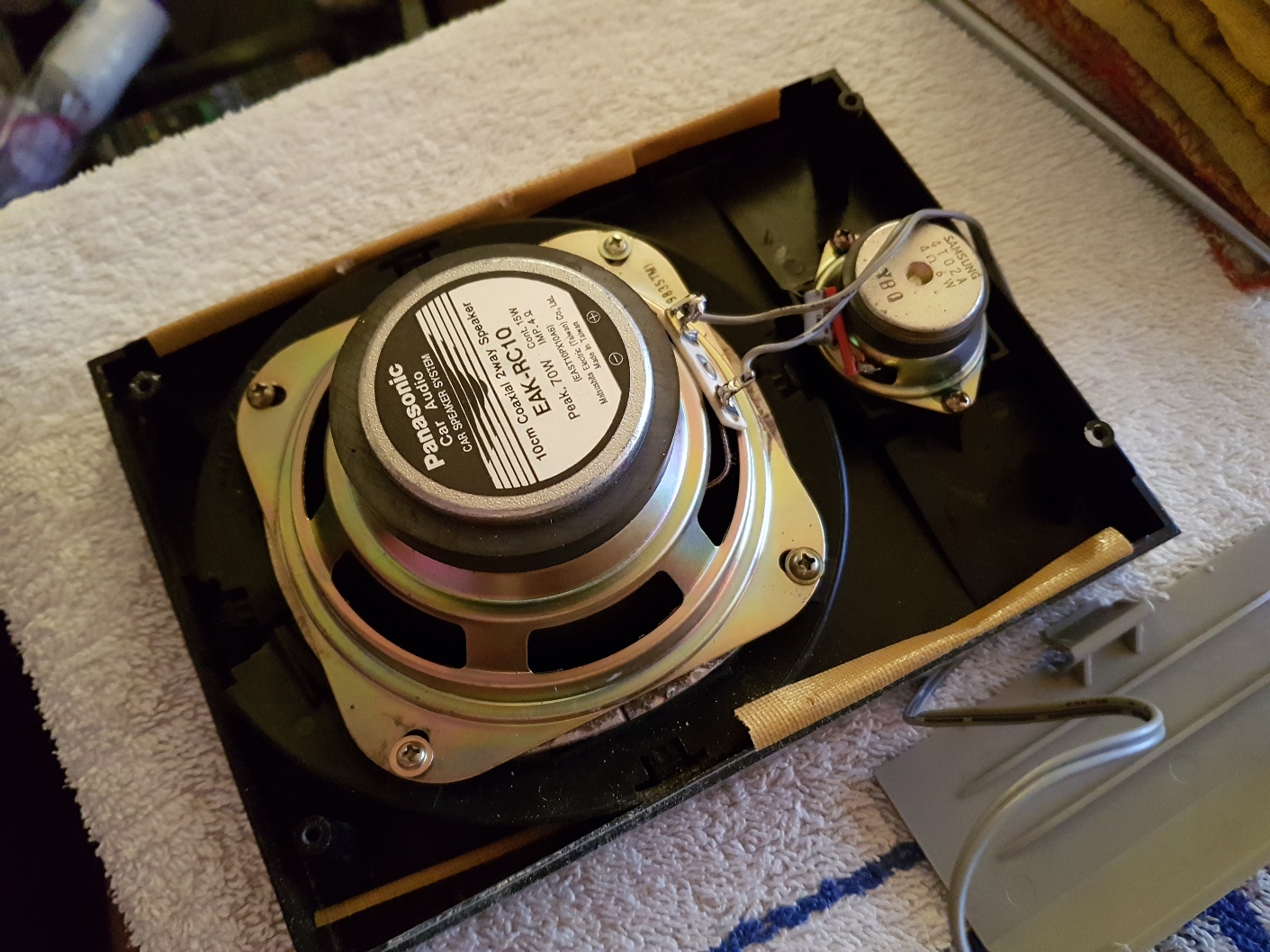

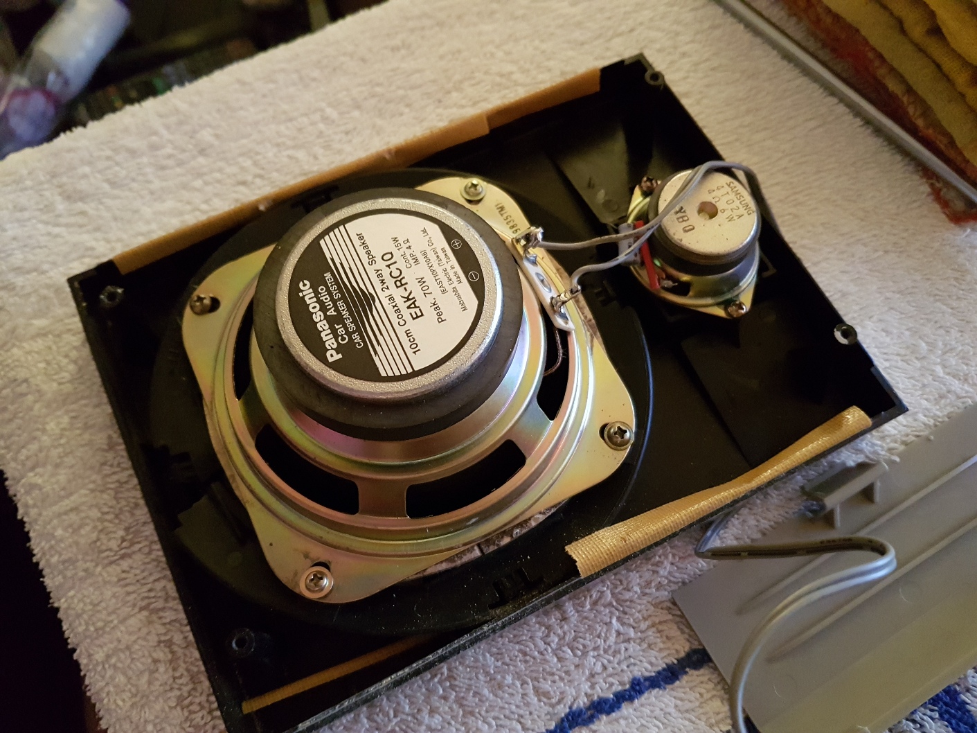

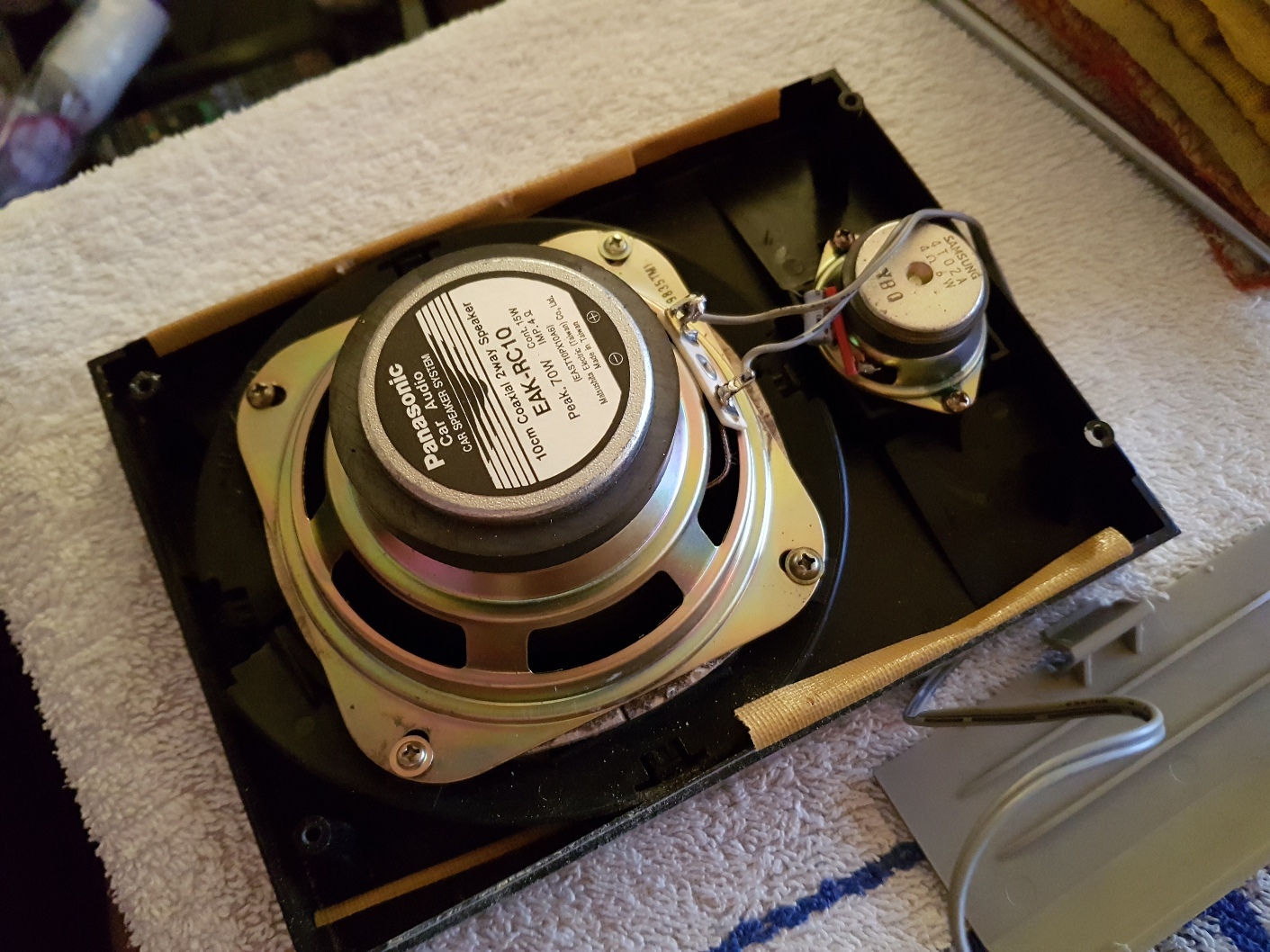

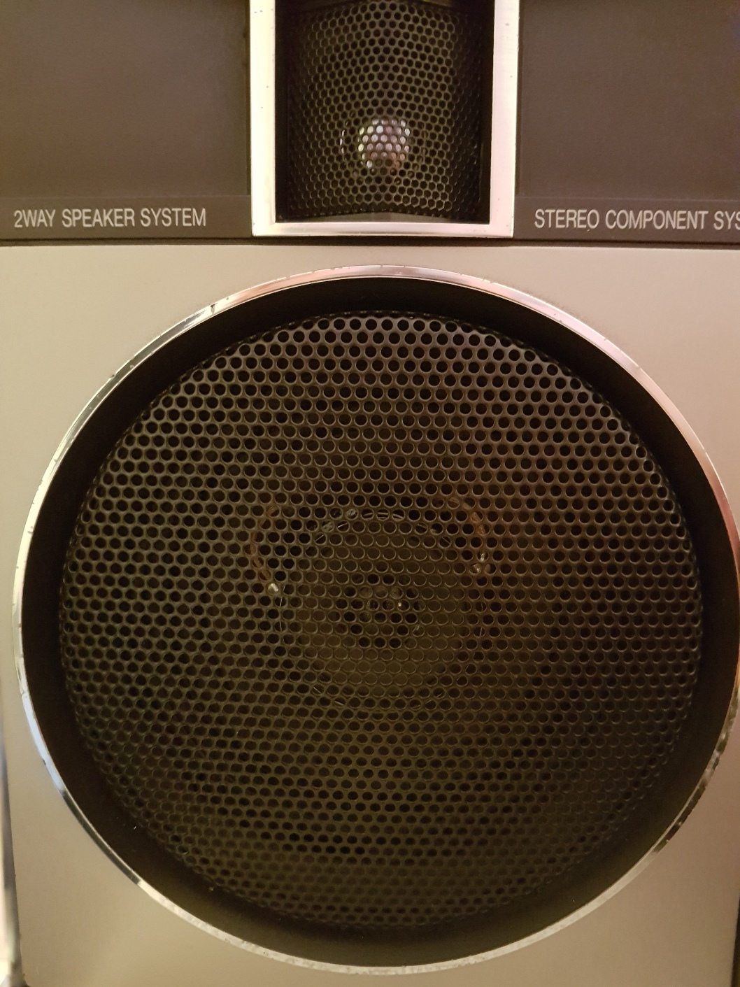

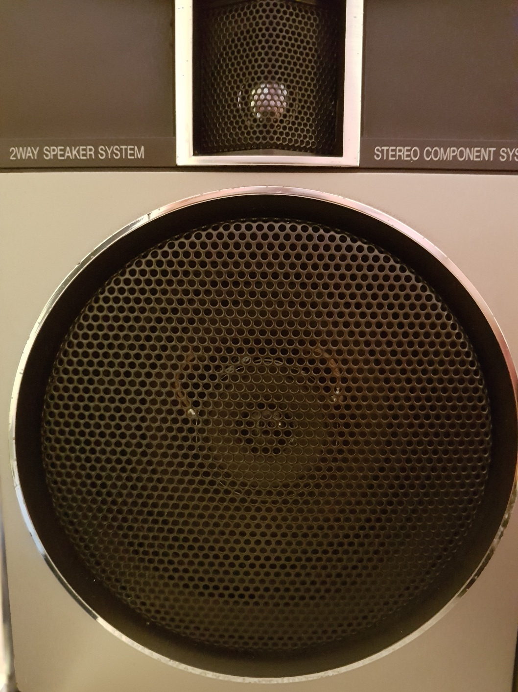

    After my recent Uher speaker transplant, it really can make a huge difference - the Uher speakers were not at all worn, they were just not very good :shock
    With these 3 piece stereo's replacing the speaker drivers is child's play I had to make up templates for the bass driver as they had a tiny difference in the cone circumference meaning there was no tight seal between the cone & the front of the speaker box!!
    The difference now is like your Hitachi - big improvement & as the replacements were co-axial units I was able to disable the nasty tweeter units & let the new Panasonic tweeters do their stuff resulting in a nice subtle treble instead of a splashy nasty sound the originals made :wink: :wink: :wink:
    Uher Power Port 2 Speaker Transplant - January 2017 (3).jpg Uher Power Port 2 Speaker Transplant - January 2017 (6).jpg 20170204_192048.jpg

    I bet those coaxials sound sweet! How do u fill the gaps around the speakers?

    Used some cork tile which was similar to the original seals! Sound is very nice now :wink:
