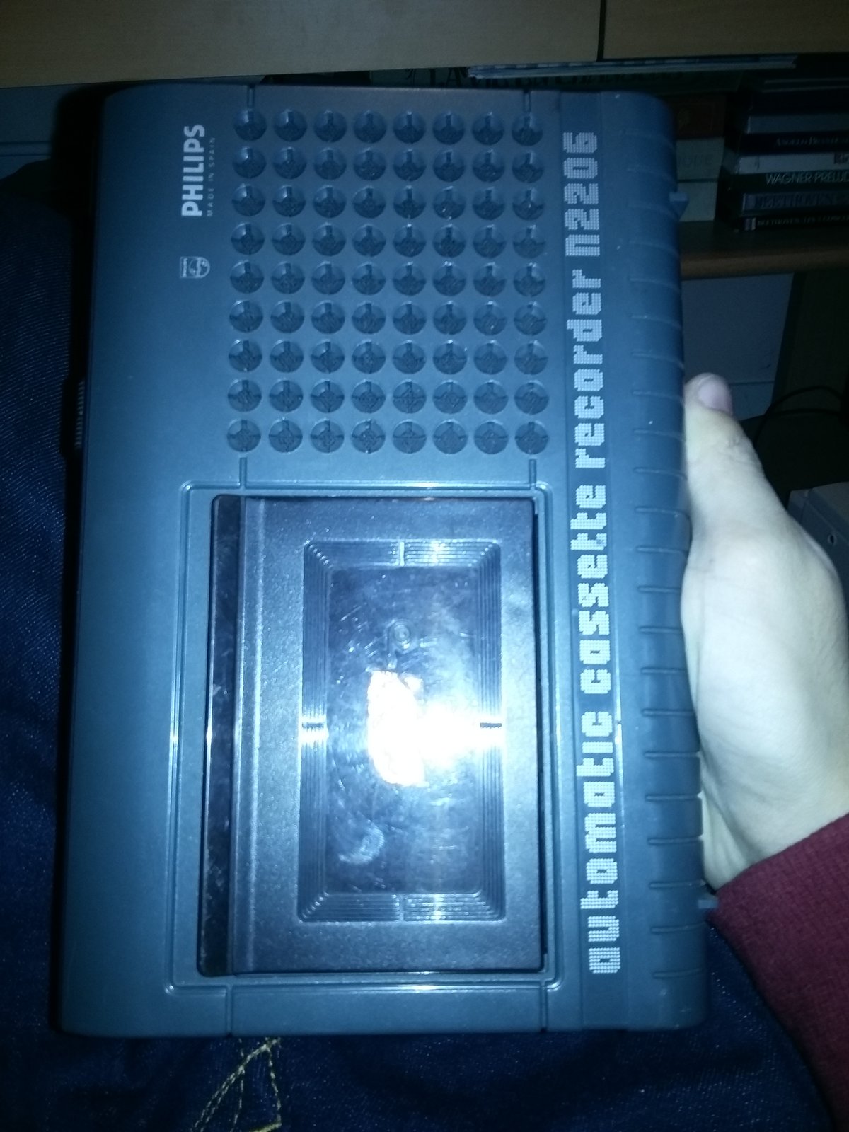

    Hello, while I was digging through my grandfather's attic in search of a walkman I found this Phillips automation cassette recorder n2206 in pristine condition. I tested it and I think the belt needs replacing. Should I spend my time fixing it or rather spend my limited time (2 days) on finding and/or buying used walkman? My budget is 250-350 euros and I'm in the vale de loir region also I don't have a car. I'm looking for a d6c or dd9, if needed I'll order replacement belts and other parts. image%3A104759.jpg image%3A104758.jpg

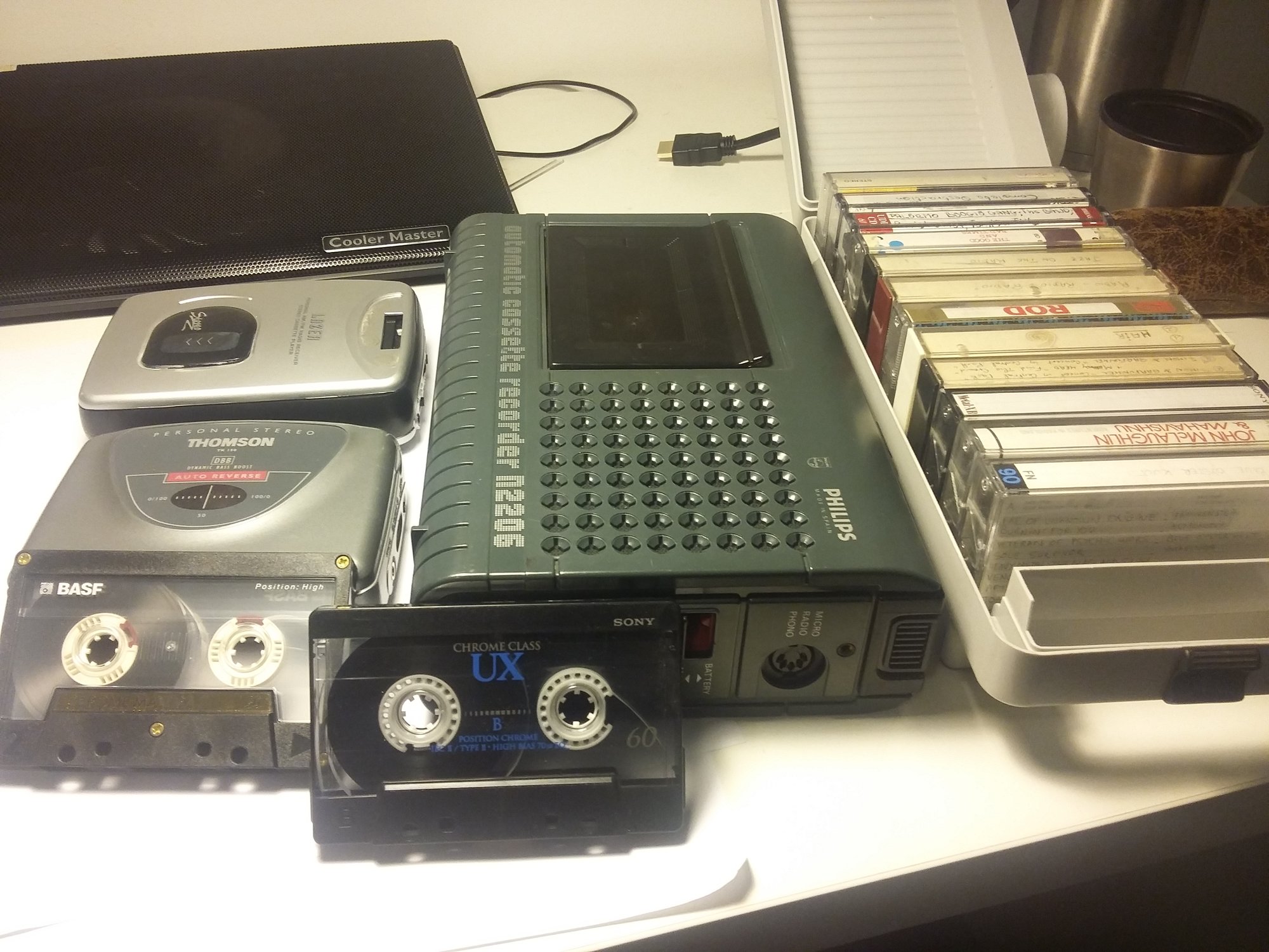

    I'm back home, here's everything. I'm going to attempt to open walkmans now, I have no past experience doing this. If anyone has any tips or guidance it would be highly appreciated. image%3A105733.jpg
    I'm also kind of stuck on how to repair the slow tape issue please have a look

    Ok after fiddling around with it I found out about the speed adjustment trick, and fixed it :banana::headbang:
    Also I opened the phillip and ordered a replacement belt, would it be safe to clean the phillip with water? Also after digging on ebay I found a goldmine, an affordable working Aiwa hs-pc202mii. I will make another thread when all the things i ordered arrive.

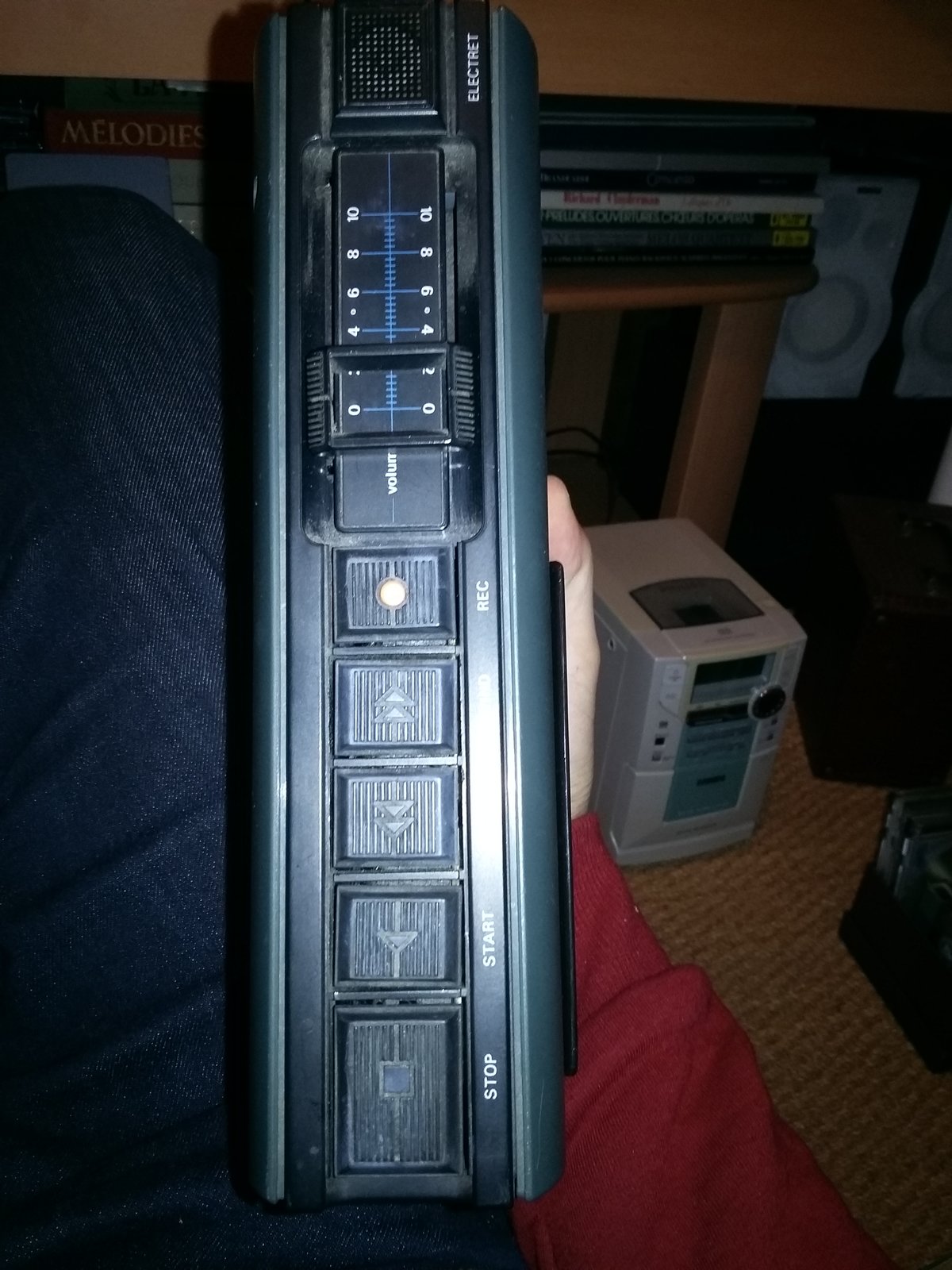

    I was cleaning the gears of the N2206 and for some reason the mechanical controls stiffen, before when it was dirty it didn't stiffen. I thought it might need a cassette but no, now when i put in a cassette the only button that doesn't stiffen as much is the record key, does this have anything to due with me cleaning out the weird gunk that i found on a couple of the moving parts? if so what should/can i do to fix it?
    Edit: after fiddling around with the philips i fixed the mechanical issue, every key are connected to drawback system which is activated by the stop button, the drawback was stuck in its motion.
