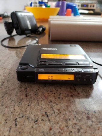

    I just found my d-555 from grade school in a box

    Waiting for power cord to come today then Ill be listing it. was working when I put it up in 94

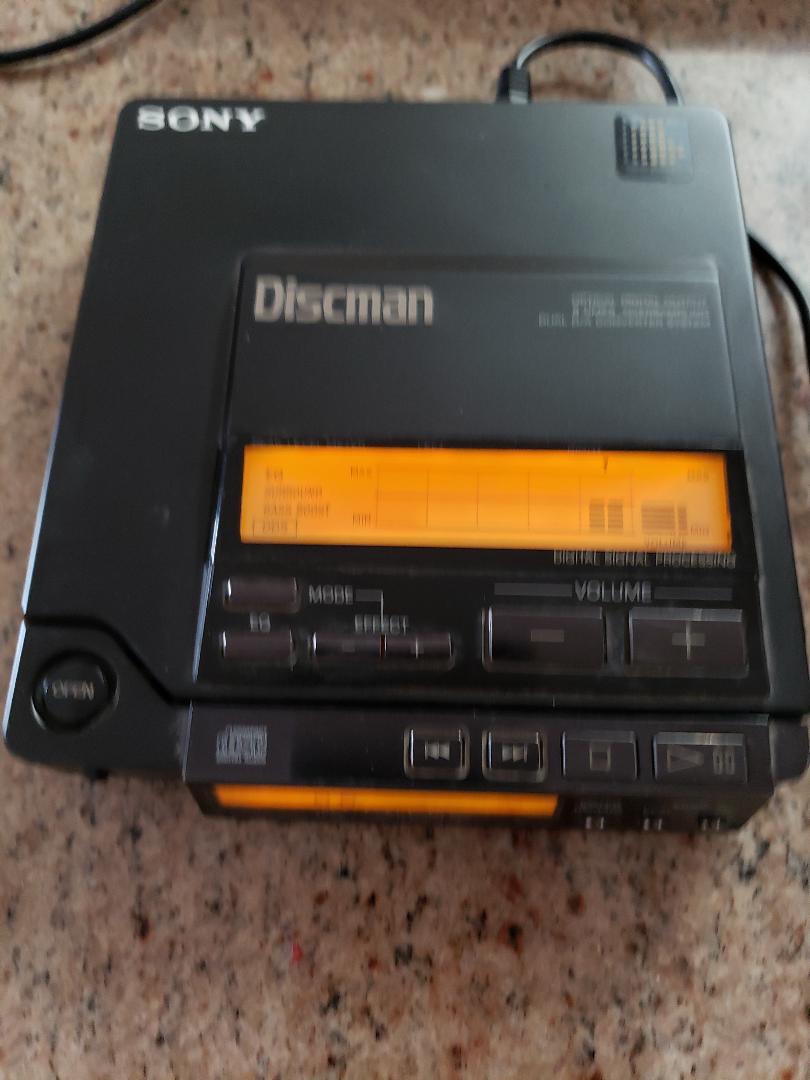

    Power supply came in .. Powers on hit play then it turns off . Does it need the battery to operate. .I hear the disc starting to spin. Track 0 comes up and turns off

    Fires up and turns off after 15 seconds .

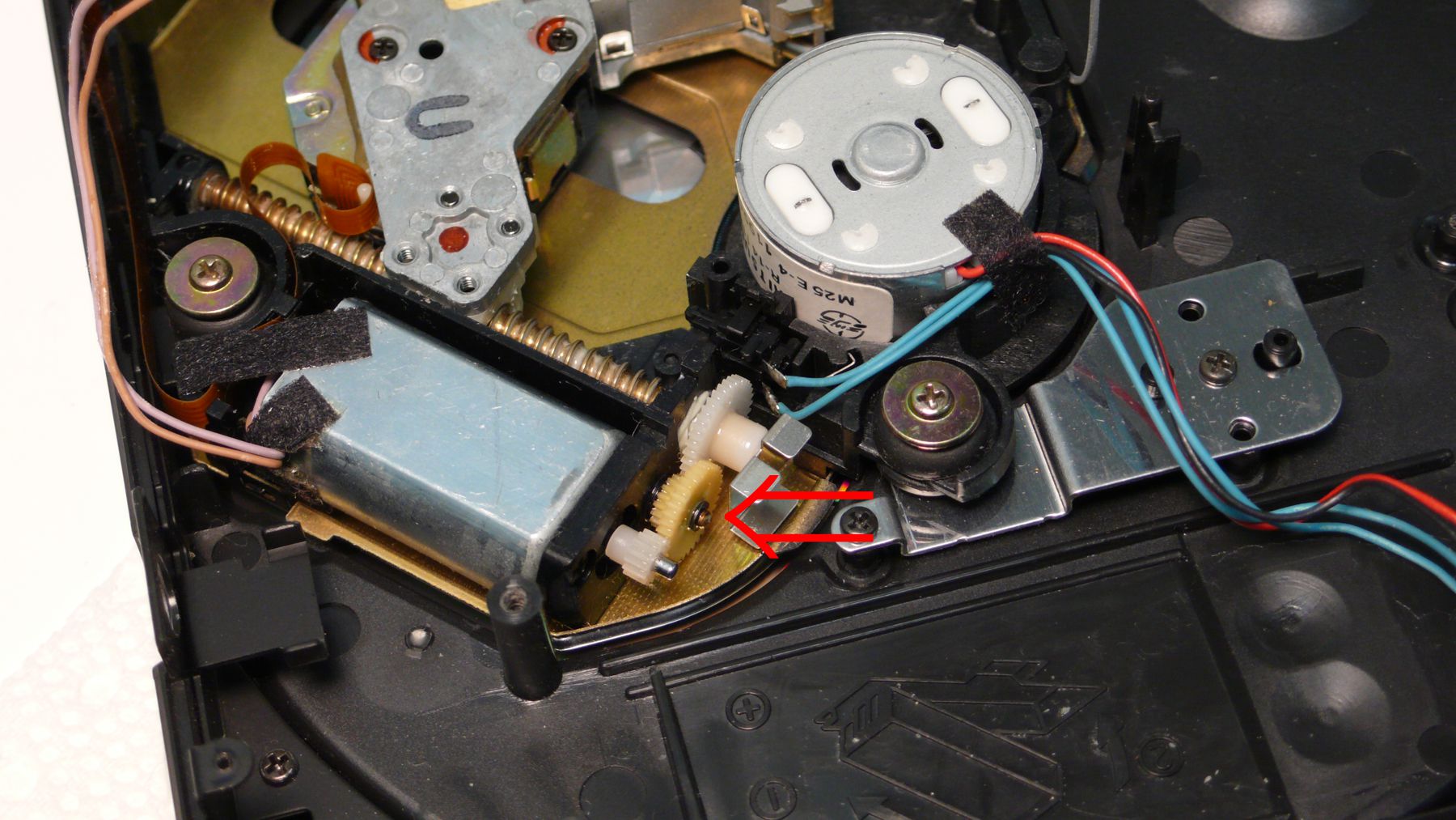

    If laser mechanism does not move on its sled then probably the infamous 'middle gear' got frozen:
    You have to open her up to see what is happening. Post photos

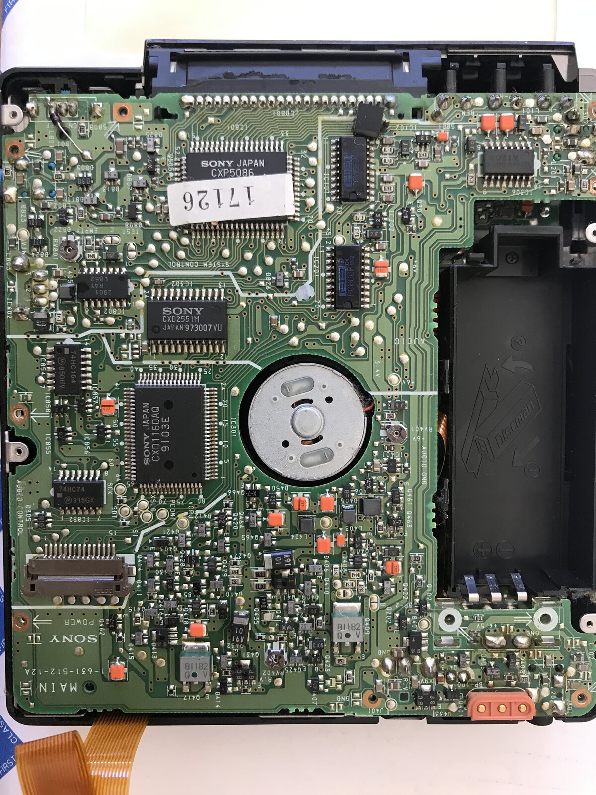

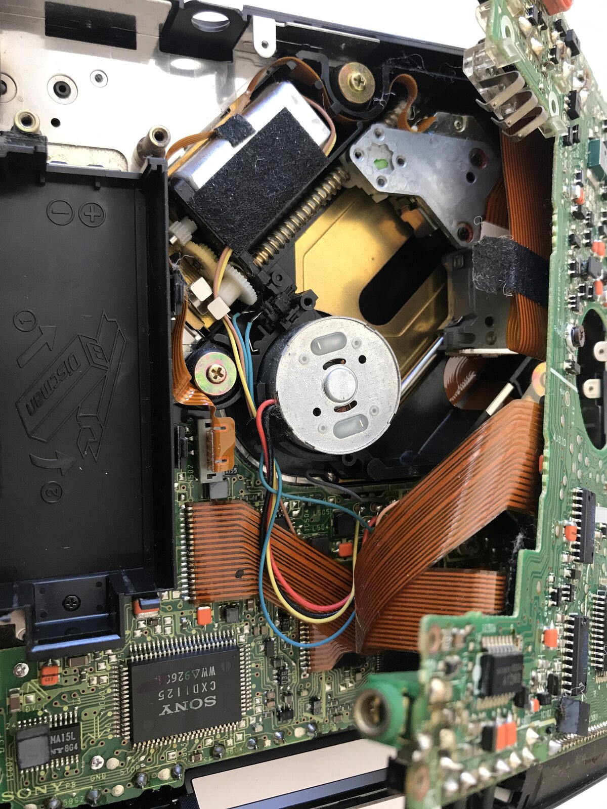

    Thanks! and thanks for the detailed pic with POINTERS :). I opened it up, and now would love to know how to move the motor, like I've read in some other user stories, as I'm sure forcing it would not be advised.
    The last time I probably used this was likely back in 1994. Would love to resurrect this gem somehow. IMG_0428.JPG IMG_0424.JPG

    1. remove battery compartment
    2. move Brown/Yellow sled motor wires out of the stainless-steel clip. Bend Blue wires of center-stop up
    3. with pointed forceps remove ss clip. A bit tricky: it is already dome-shaped when looking from above, if you bend it a bit more while pulling UP with strong forceps, it is a 5-sec job
    4. with X-acto blade pop up tiny washer holding 'middle gear'. Easy because washer is split, try not to lose it when it pops out. BUT: do not press on the gear, plastic is pretty soft and sometimes even brittle
    5. if gear gets broken, you can buy a new one off eBay for ~$20
    6. put droplets of motor oil on the spindle, both sides of the gear and let it soak in for a few min
    7. use two toothpicks to remove frozen gear: one sharpened as a shim push between the gear and plastic, another sharpened as a flat screwdriver/chisel GENTLY rotates the gear. This is a step where you can shave a tooth and then go to step 5 :mad:
    8. use Windex, cotton and toothpicks to get rid of greenish hardened oil, then soak in Windex, more cleaning...
    9. air-dry, do not use any oil or if you must then use only plastic-safe oil. Motor oil will destroy this 'middle gear'
    Report your progress :)
