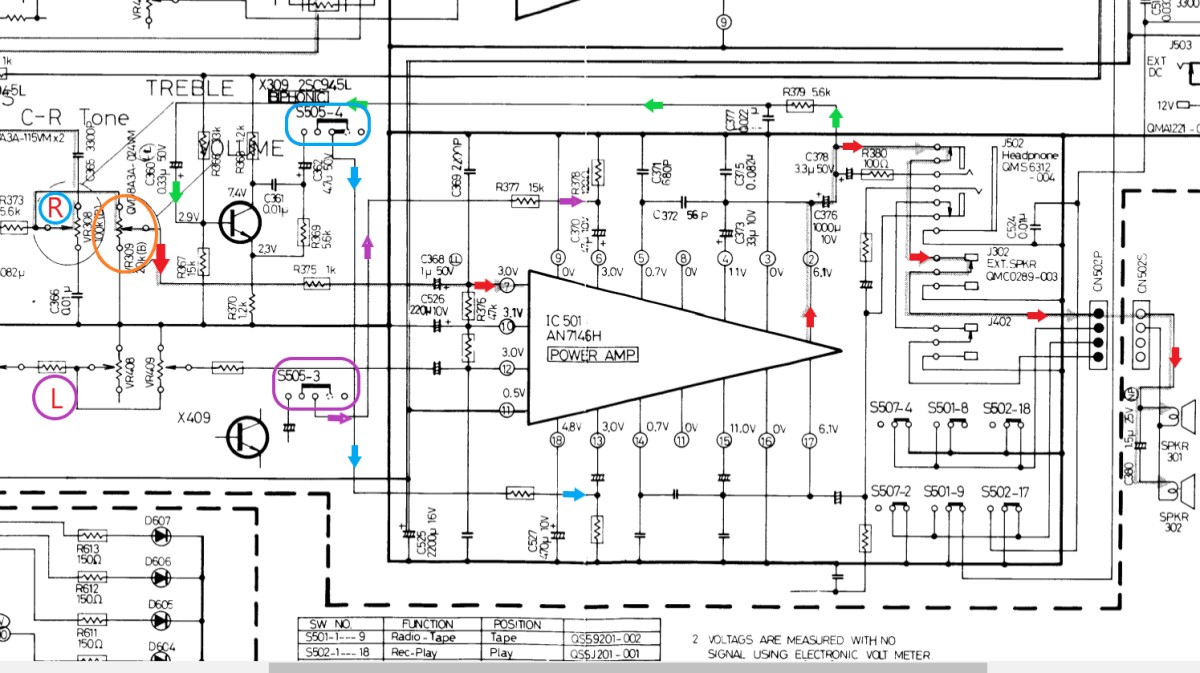

    I would like to explain a little about this biphonic system from jvc .. How it works electronically ... I have not taken the 828 schematic which is a bit more complex and looking at the schematic uses a chip to do this function ... But I found the Biphonic system also in the schematic of the Rc 656 lb which is this in the picture ... Well I try to explain ... starting from the orange circle, the potentiometer of channel R, the signal (red arrow) enters the amplifier chip from pin 7 .... and exits from pin 2 amplified towards the speakers ( red arrow) But one part (green arrow) goes back to a small preamplifier composed of a single transistor. On the output of this there is the S505-4 Stereo - Biphonic switch ... as seen in the diagram and in the Stereo position, so this part of the signal stops .... But when you switch on Biphonic the signal reaches (blue arrow ) pin 13 of the amplifier ... This amplifier chip AN7146 is a double amplifier and pin 13 is part of channel L ... not R we were examining ... Same thing happens with S505-3 channel L (purple arrow ) which enters the amplifier on pin 6 which is on channel R ..... In practice, the two channels are inverted ... So while listening we will also hear channel L on channel R (with a slight delay) almost not audible and vice versa ... on channel L we will also hear R (with a slight delay) the result is that of having an expansion of the sound .. The test that can be done is to put a signal only on one channel .. in stereo mode you will hear it to the right or to the left according to the selected channel ... passing only one channel on Biphonic l or you will hear both left and right. All this theoretically because I do not have a jvc boombox to try on the contrary if maybe someone can confirm ... I hope I have explained myself and helped to better understand this system

    @Silver965 : nice technical explanation of BiPhonic... that sounds like a really complex system!
