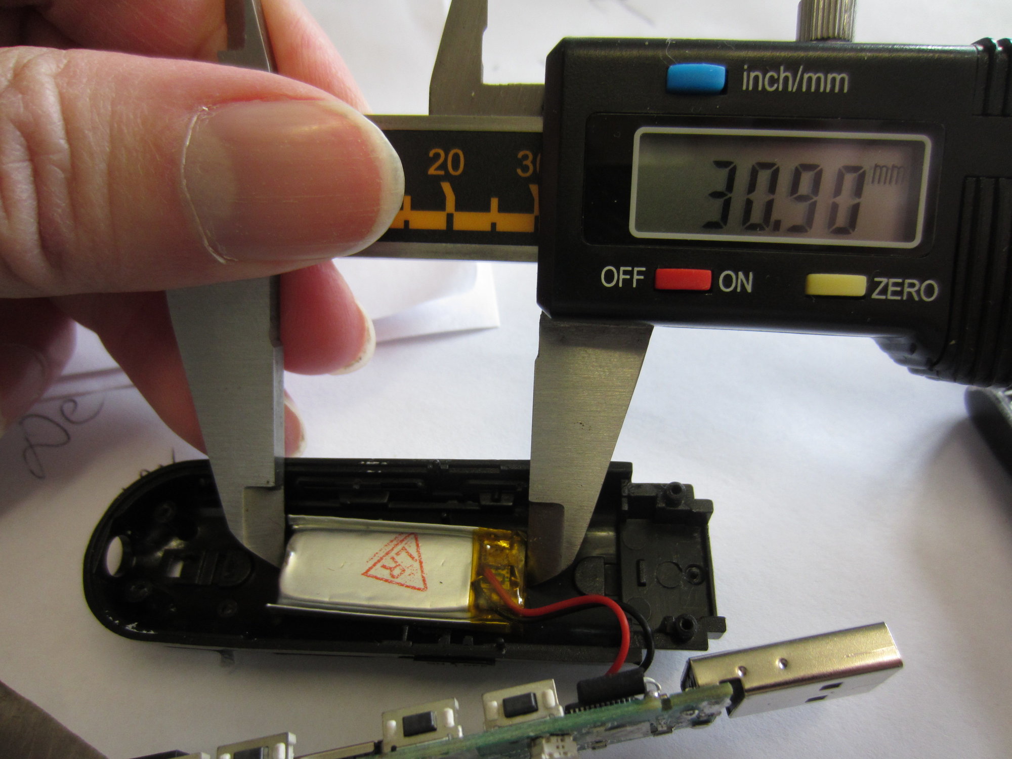

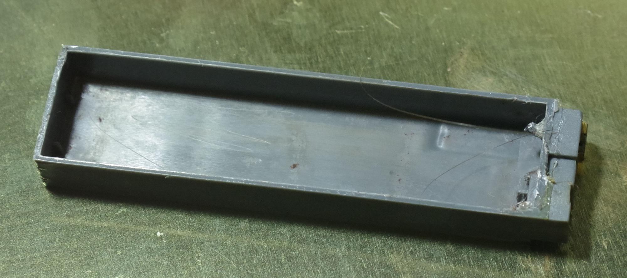

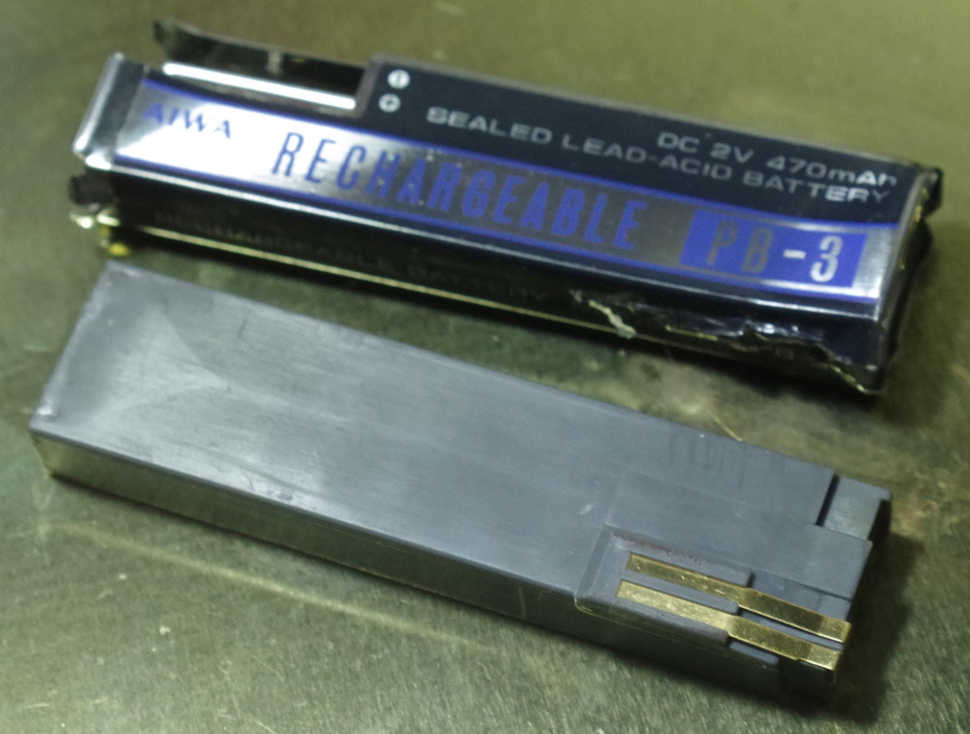

    So, after badgering the heck out of a load of people on an electronics forum, the conclusion is that trying to rejuvinate/revitalize/resucitate the old lead acids is a shot in the dark. Or rather, the pitch black.
    As a result, I decided to take one of the cells apart and see what was inside. After the dead, inert chemicals were gotten rid of, this is what was left....
    A space measuring roughly 60mm x 15mm x 6mm ... give or take a prong.
    Two options remain...
    1) Find another cell that will deliver 2v and fit in that space.
    2) Fit a voltage regulator circuit, and a usb socket to the arse end. - This will get around the need to feed it an endless supply of AAA batteries, or tracking down a commercial 2v DC power supply.
    As I have the P202 units to mess around with, then these units will go first with the experiments (once the old lead acid batteries reach me, and can be gutted) ... and some voltage dropping circuits are on their way. The only ones small enough, appear to drop to 1.8V ... the variable version might be too tall.

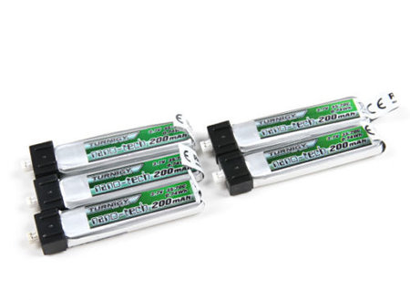

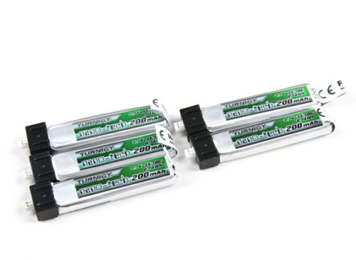

    So, after a while talking on the EEVBlog forum, here we have the intended source of power. A small battery meant for models...
    RC Turnigy nano-tech 200mAh 1S 35~70C LiPoly Battery
    It is 2mm too high, which I should be able to recover by removing the cap. Then I'm going to have to find out what circuitry is already in front of the battery, and then work out how to drop it to 2V (it supplies 3.7 at 200mAh, so dropping to 2V in theory might gain me the same run time as the original PB-3) and also allow the walkman to charge it, all within the remaining 7mm of space. So... no pressure then...

    I'm probably going to be using these - https://www.ebay.co.uk/itm/3-7V-500...501646-for-Recording-Reading-pen/262500045648
    ...with three 0.6v diodes to bring it down to 1.9v... unless I can find another dropping mechanism that doesn't waste power. But 500mAh is a good amount for that size. There was another battery suggested ... https://www.ebay.com/itm/3-7V-450-m...oth-mp3-mp4-/261285922057?hash=item3cd5dac509 but it is a little longer.
    It will need a small external port (possibly where the black thing is in the battery case) to hook up to one of these chargers ... https://www.ebay.co.uk/itm/2pcs-5V-...ging-Board-Linear-Charger-Module/152070669880
    I have been cautioned about using LiPos, as they are not the most stable and need care while charging. All this lot will take weeks to arrive, so who knows. I've run out of cash for this month, after just a few days in, so it will be early Feb before I can do more. Ultimately, finding a battery closer to 2v is proving difficult. There was the suggestion of posting a high res picture of the board, to see if people think that the unit can handle 3.7 volts. I did post some of the circuit and it does seem to be running at 2v... no one could see any obvious kicker components.
    These poor P505 will deserve a medal by the time I'm finished with them!!!

    I've dropped him a note just now. I do have concerns about LiPo batteries, however, especially after what I've been reading. They seem to be the only ones that fit inside that space with any reasonable amount of power to them. Thanks for the heads up.

    Hi Michelle looking at what you are doing to get your units working again with the batteries, nice good work hope it all goes well.
    I have to say with LiPo’s the nominal is 3.7V but the voltage is actually 4.2V when fully charged, I know this as I fly radio control helicopters and use Lipo’s. Like people have said before LiPo’s are very volatile, handle with care.
    Because I have loads of large ones I use on my helicopters i.e. 5000mAh 6S, I carry them around in armo boxes. I know you are only dealing with 200mAh – 500mAh 1S but you still need to be careful.
    Personally I would look for something else rather than LiPo, good luck.

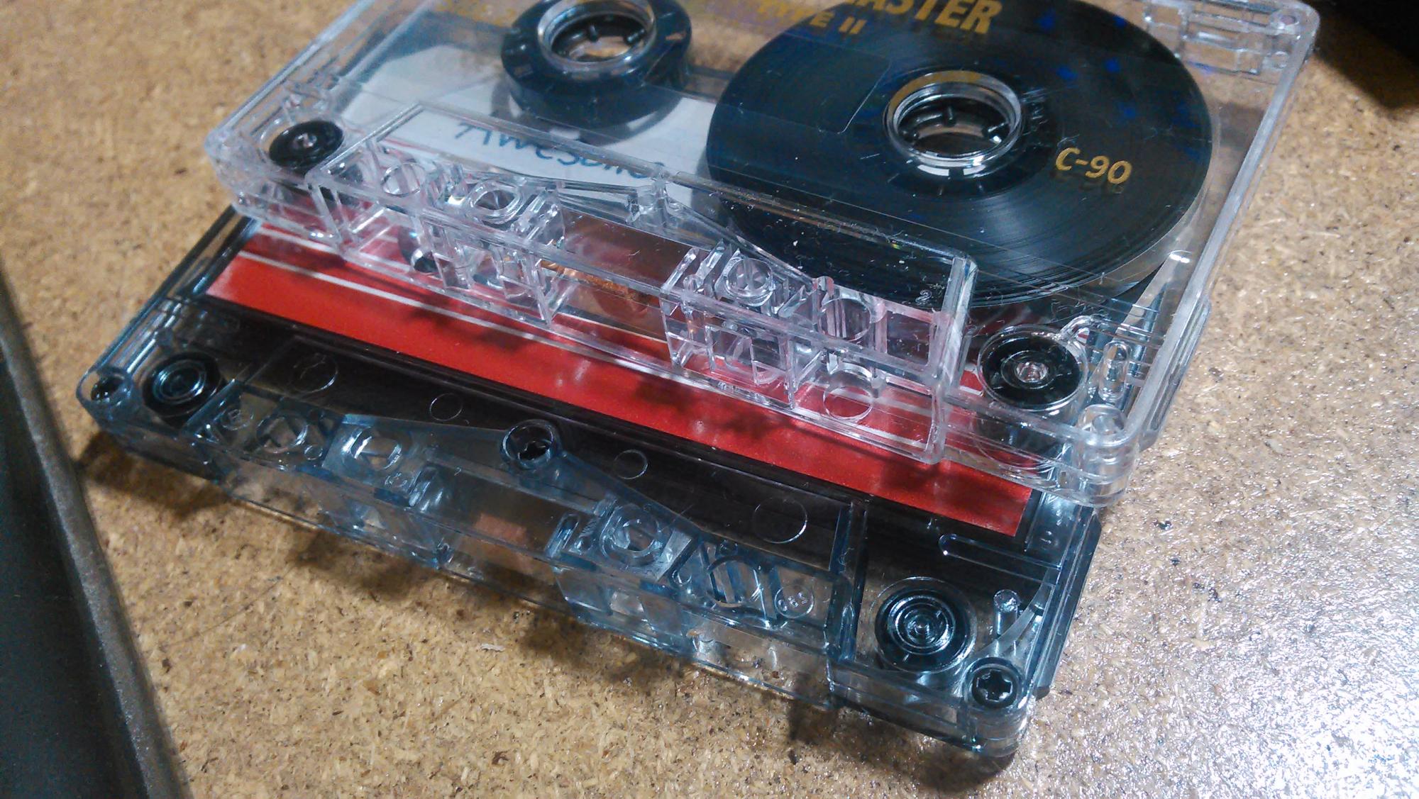

    The three 303 units are all in the state where they start working the moment they are powered on, but the silver one hasn't had the caps replaced yet. Work on this is going slowly because the small home office is in a mess and needs tidying up, before I can concentrate on things once more.

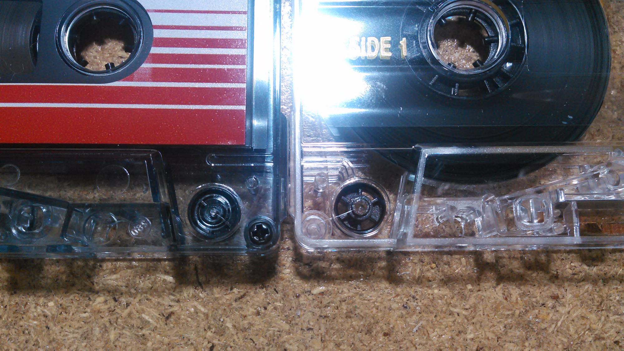

    The P505 went for a walk with me last Sunday, along with Guardians of the Galaxy tape 2. The AAA batteries easily saw through two playings and I finished my walk before I ran out of battery, so that was good. I did, however, notice a muddy bass, and I had used tantilums to repair some of the caps on this, so when the Mouser order arrives, I'll replace these and see if I still have the same mud. Overall, the GoG2 tape performed well, but the hiss between tracks was obvious, and bearable, but obvious, if you know what I mean.

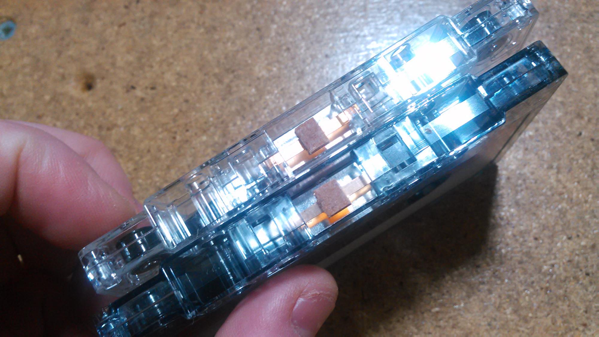

    Interestingly, here is a comparison between the GOG2 (type 1) and 799 Studio (type 2) tapes from NAC for comparison. I won't actually be using the 799 until the RS-B705 deck is back with me, however.

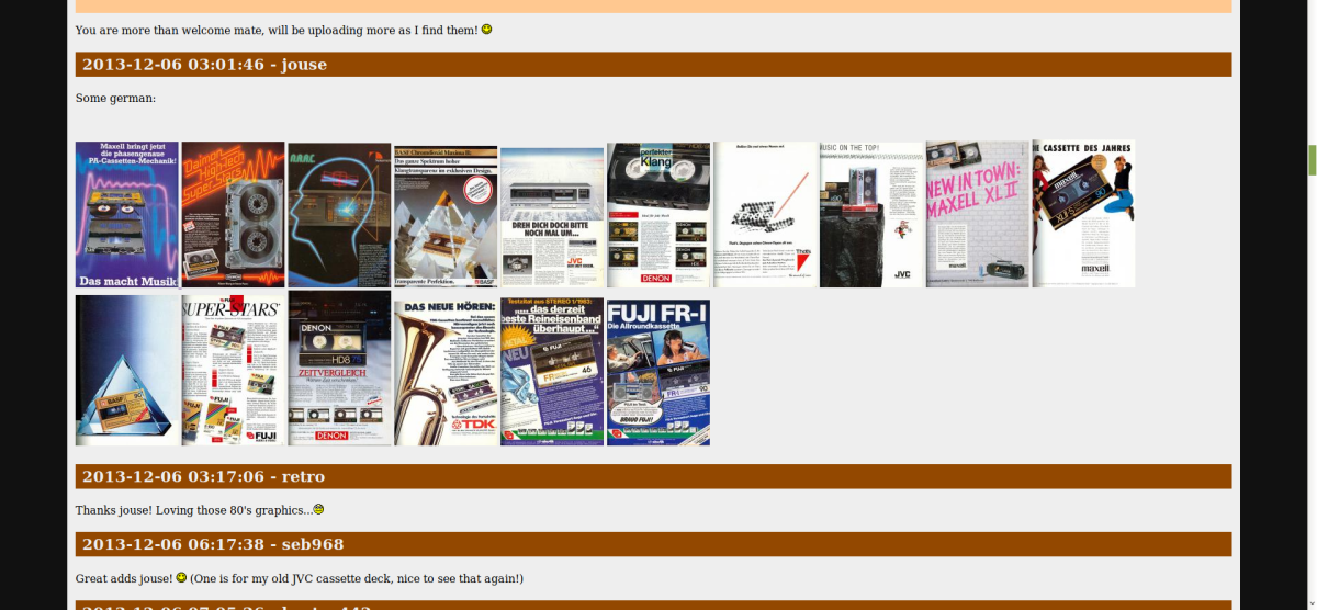

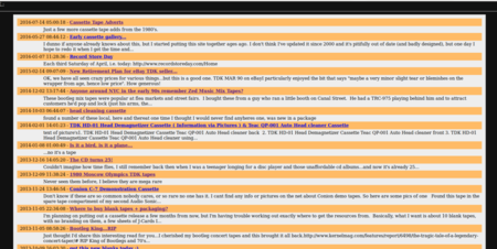

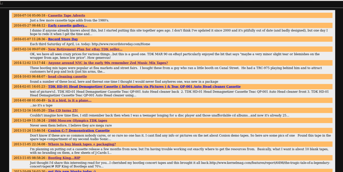

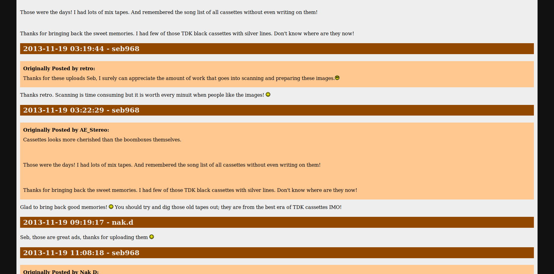

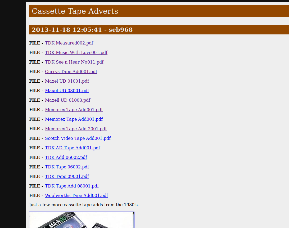

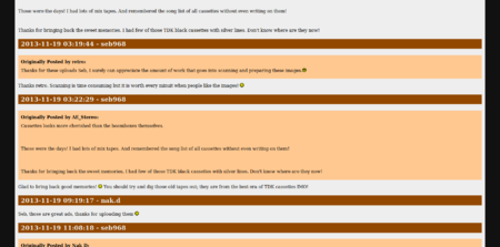

    Today has been work done on accessing the old forum posts. Attached are a few shots showing the initial layout and colours I've used. No search function yet. Tomorrow, I make a start on tidying up the office. Not much else I can do until the capacitors reach me.
    Screenshot at 2018-02-03 17-30-01.png Screenshot at 2018-02-03 17-30-11.png Screenshot at 2018-02-03 17-30-20.png Screenshot at 2018-02-03 17-30-44.png Screenshot at 2018-02-03 17-30-56.png Screenshot at 2018-02-03 17-32-56.png
