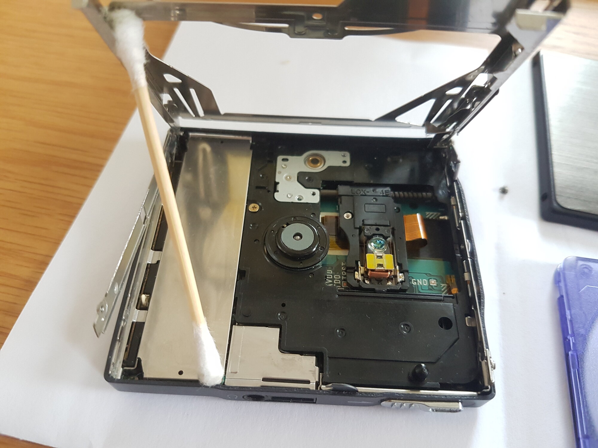

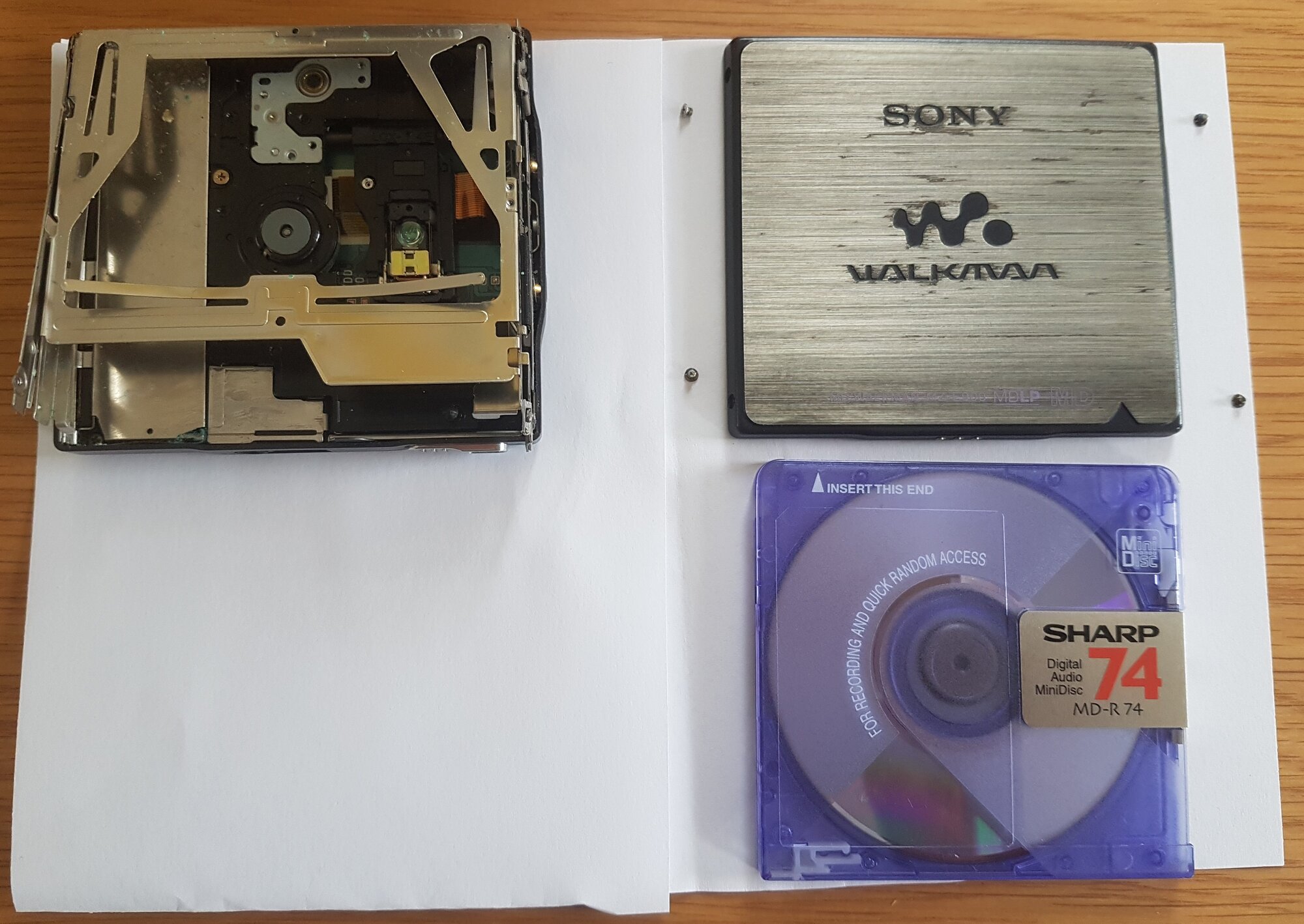

    I'm not sure how far you got with your repair but I've just taken my MZ-E900 apart to have a look. The E900 is significantly different to the R900 but it's easy to get apart in order to clean the laser head track. Just remove the 4 screws from the top cover then gently remove the lid, then you can squeeze the metal cage to unhook it from the side rails to get better access or you can un-hook it at the hinges to remove it completely.
    Unfortunately for me, it's not so easy to get to the main board, my unit has a problem with the battery contacts inside and I can't work out how to get it apart. There are 3 screws inside the base but I've removed them and still can't get it apart. There is a very delicate black plastic rim which I assume should come out with the laser transport.

    I re-read the manual and the laser mechanism can be removed from the front - so I'm making progress. There are some other screws underneath that hold the main board in place and there are 2 points to de-solder - so not as straight forward as taking the R900 apart.

    RTB. Here's my e-900. Notice how the black from the W logo has run over the surface of the mini disc player. I can only put it down to using the player in hot, humid conditions. Have tried a rubber suggested by a forum member but no luck. Yours looks ok. A other possibility could be the constant handling of the unit. Derek.
