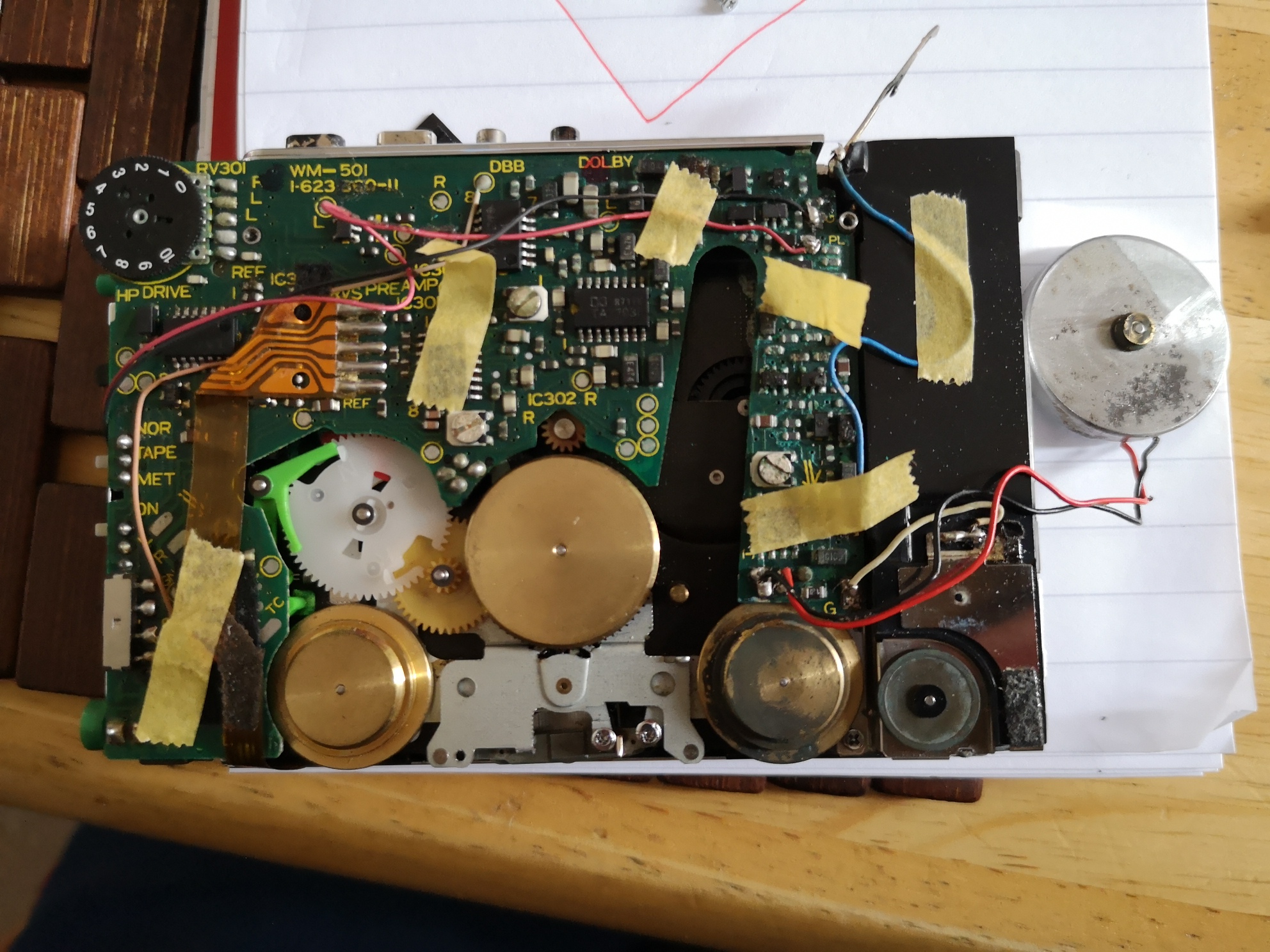

    Hi
    I'm trying to restore this after the poor thing clearly had some battery acid damage :( the motor is completely locked up, does anyone have one that I could buy?
    Kind regards
    Ross
  2. Emiel
    1,061
    Would a B602 motor be a good replacement?
  3. Valentin
    1,676
    Unfortunately the B602 has a different motor. It's a brushless 3-phase disc motor, while the WM-501 is a normal brushed motor. One of the worst designs I might add as the bottom bearing doesn't have a hole to lubricate it.
    The WM-100/200 series also have a different motor: similar 3-phase brushless design but different than B602.
    I would try to unlock the original motor or buy a donor unit.
    There are a couple of methods I would try:
    1. With a thin piece of cotton immersed in IPA clean the area beneath the pulley.
    2. Put some oil or WD-40 into the top bearing and let it sit a couple of days.
    3. Remove the pulley: it can be easily removed by heating it with a soldering iron until the brass expands enough to not be a press-fit anymore.
    Emiel likes this.
  4. Rossoe
    Rossoe Member
    35
    ok thanks I'll give that a go.
