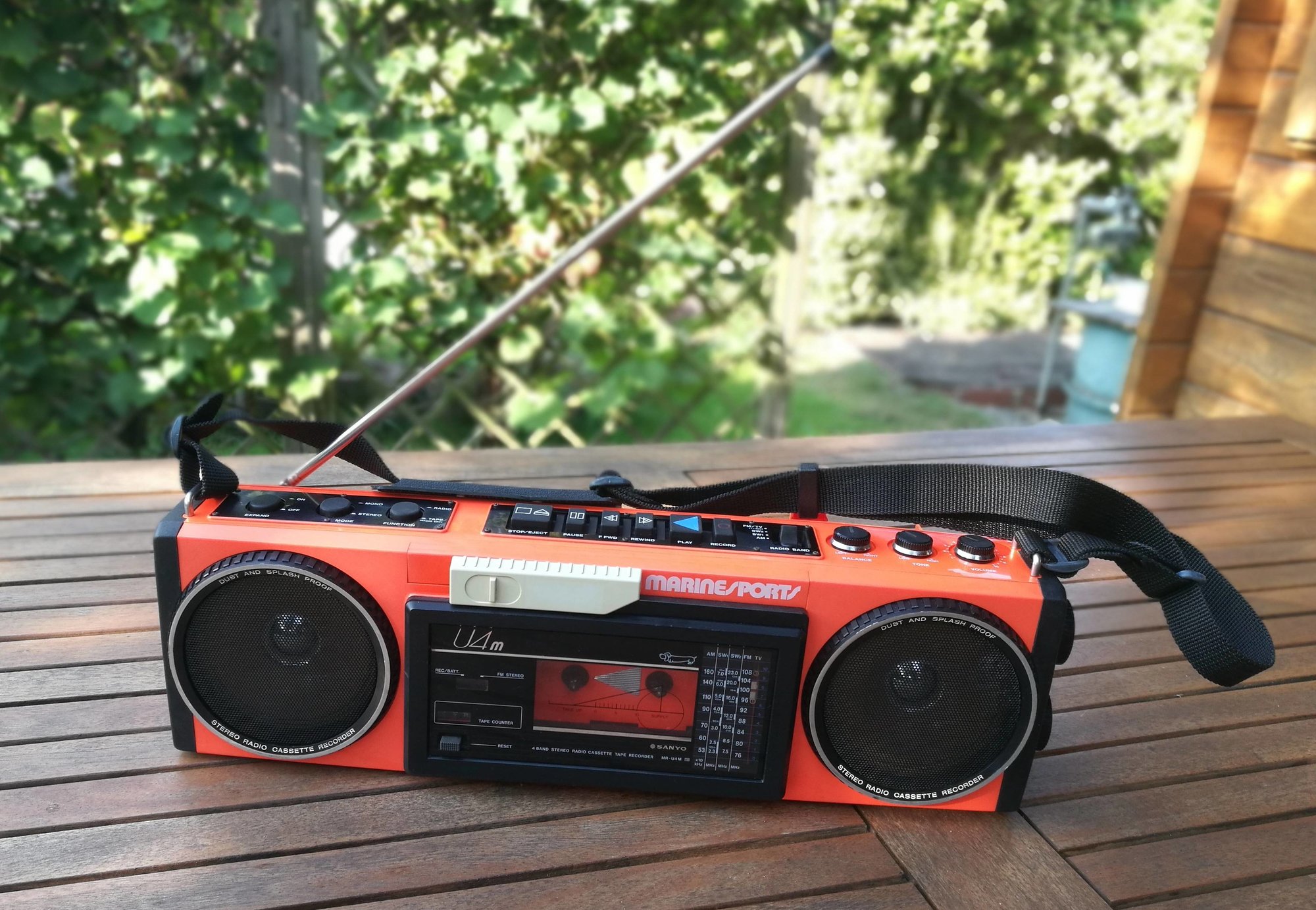

    I have the Japanese version of Sanyo M-GT7 "The Outsider" - the MR-U4M "Marine Sports"
    Everything works, only the tape speed is to slow. Does anybody know, if there is a screw or a variable resistor that I can turn to adjust it? Or does someone have the service manual for M-GT7?
    Thanks

    OK, found it by myself. There is a screw on the motor, that can be turned. To the right - faster, to the left slower.

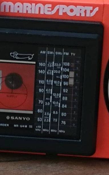

    You are right. To have AM, SW and FM at a Japanese domestic boombox is not typical. They have mostly only AM and FM.
    The real FM Radio frequency band in Japan is from 76…92Mhz (at least in the past). So, in boomboxes from the 70’s you find only these frequencies (e.g. Victor M70, Aiwa CS-J88)
    I think, beginning of the 80’s they extended the FM band with analog TV channels (1,2,3). These TV channels are between 92…108MHz. Luckily with this change the old boomboxes are usable also for European and American FM radio.

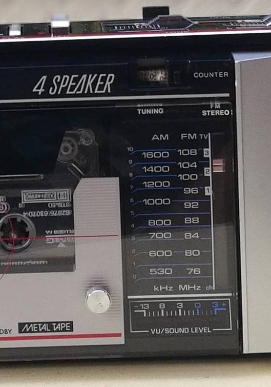

    See here the closeups Sanyo MR-U4SL - M7780 Scale detail.jpg Sanyo MR-U4M - M-GT7 Scale detail.jpg

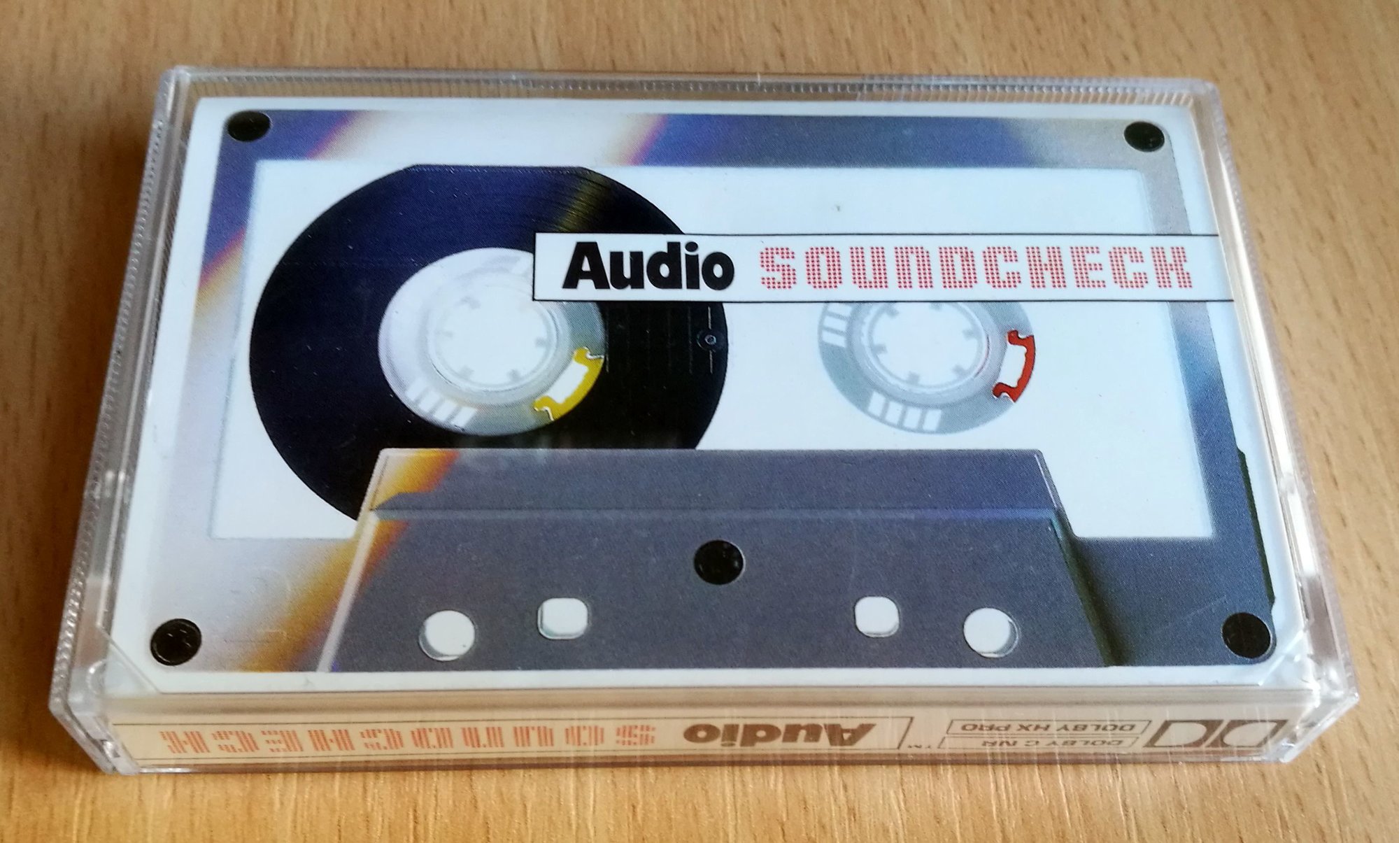

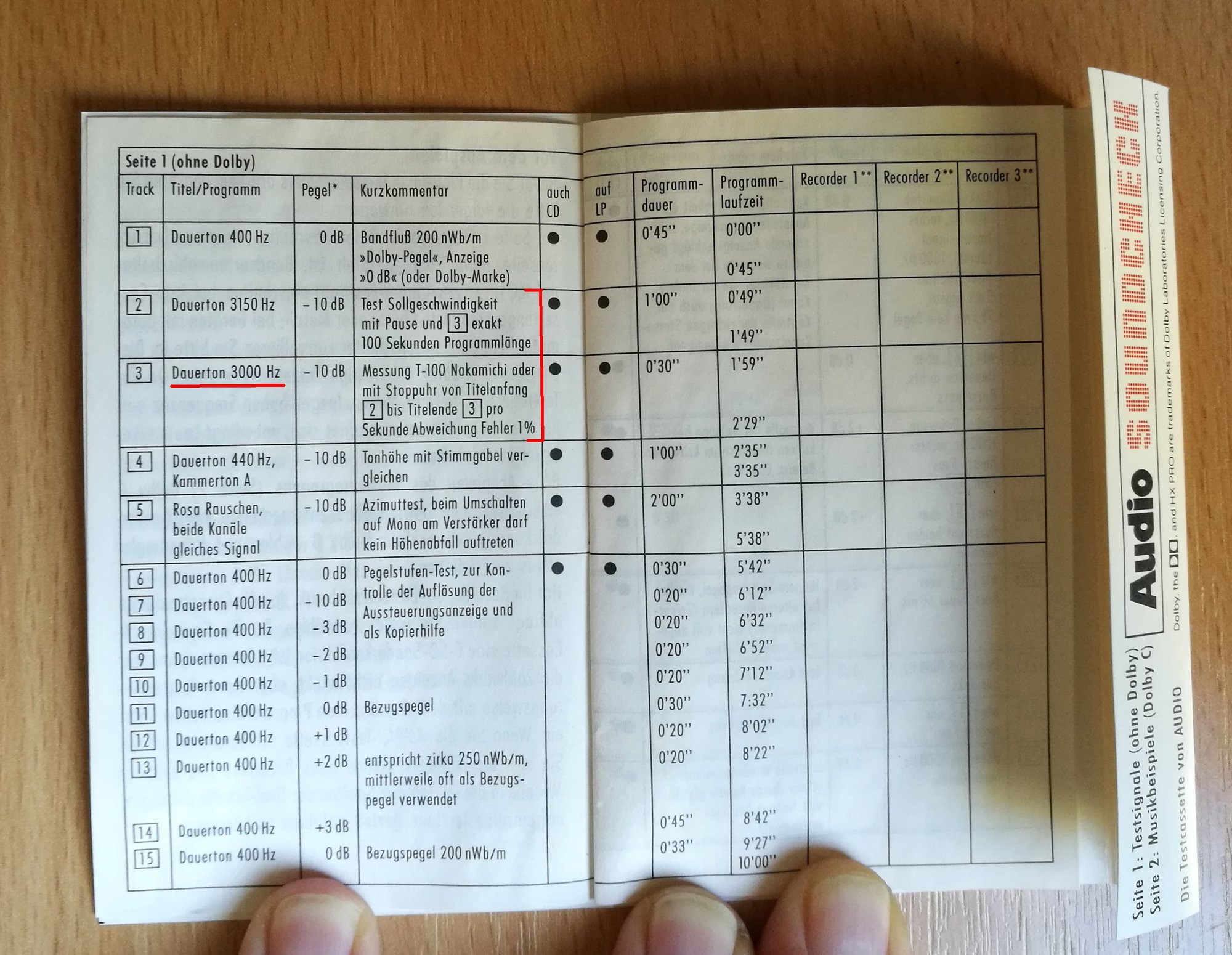

    For the speed alignment I used an old universal adjustment cassette. There is a frequency recorded (I think 3000kHz) were you could adjust it with an oscilloscope. But additional there is also a signal with a predefined length for those, that don’t own an oscilloscope (like me). Together with a stop watch I adjusted the speed so, that it has fitted to the defined signal length. It took some trials until it was perfect.

    I am not a technician or "savvy" with electronics. But I think that rupi99 meant "3000 Hz" and not "3000KHz" in his October 5, 2018 reply to the message of the same date from Mister X :hmmm. A 3000 kHz signal equals a 3.0 MHz signal: a shortwave broadcast, in effect! (Well, probably navigation-related; probably not much by way of news- or entertainment-related programming :shrug:)
    I seemed to remember seeing people selling 3000 Hz speed-calibration audiocassettes on eBay. And I certainly found some sellers of them on eBay tonight. This is maybe the second time that I have found sellers of those speed-calibration tapes. They often seem to cost quite a bit of money: dozen of American dollars. Perhaps the reason for such prices is compensation for the labour and expertise to open up the sound system and then connect sound cards to its cassette-deck mechanism and to calibrating computers while the cassette deck connected to the sound card plays the speed-calibration cassette. (Or thereabouts.)

    Wow, I'm a technician, and made this mistake :shock
    The "k" of course has to be removed. 3000kHz is already ultra sonic :biggrin:
    This is the tape, that I used for calibration. I used (2) and (3) which had a total length of 100s. Every second would be 1% speed deviation.
