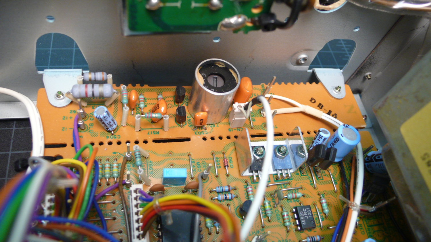

    Fully restored and up-to-specs LX3, with brand-new belts/tyres and rollers from BlackReel-Audio had suddenly stopped recording. Record button always engaged Mute option which could not be disengaged, playback got noisy: infamous NAK polypropylene ("orange") caps failed. Yesterday my order of 21 PP caps arrived from DigiKey: four PP caps for the Logic&Power PCB, ten for Dolby-NR PCB, and seven more for the Main board.
    I started with Logic&Power board. All you have to do is remove top and bottom plates (4+6 screws). No need to remove the board itself, when LX-3 is placed on its side it is possible to recap with minimal contortions and joint pains.
    Logic&Power board with four suspect Orange Caps:

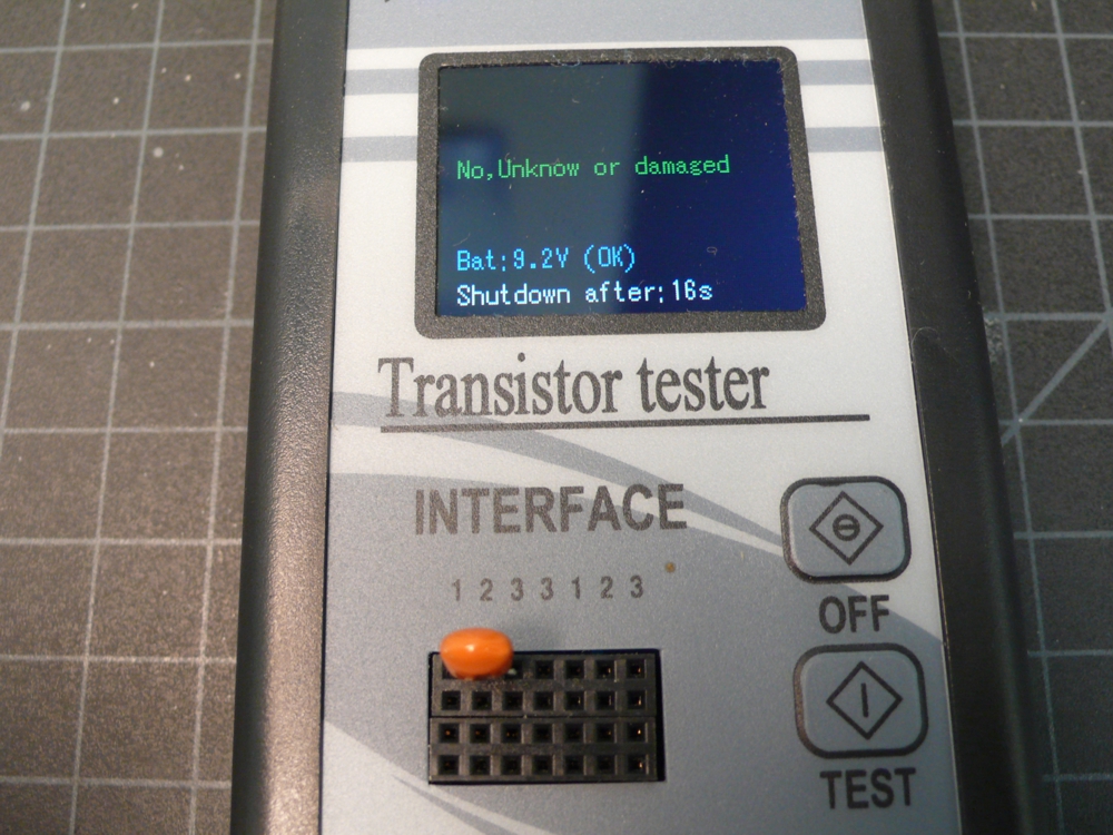

    One cap, C502, was bad:
    To get to Dolby and Main boards LX-3 has to be seriously dismantled. So I checked if the problem got fixed. Lucky Me!!! LX-3 plays and records like new again!

    With a little help from my son I managed to upload a list of orange PP caps for LX-3 here: square-2
    Yes, its real strange that all electrolytics still work, but unbreakable PP caps fail. Bad production batch?
