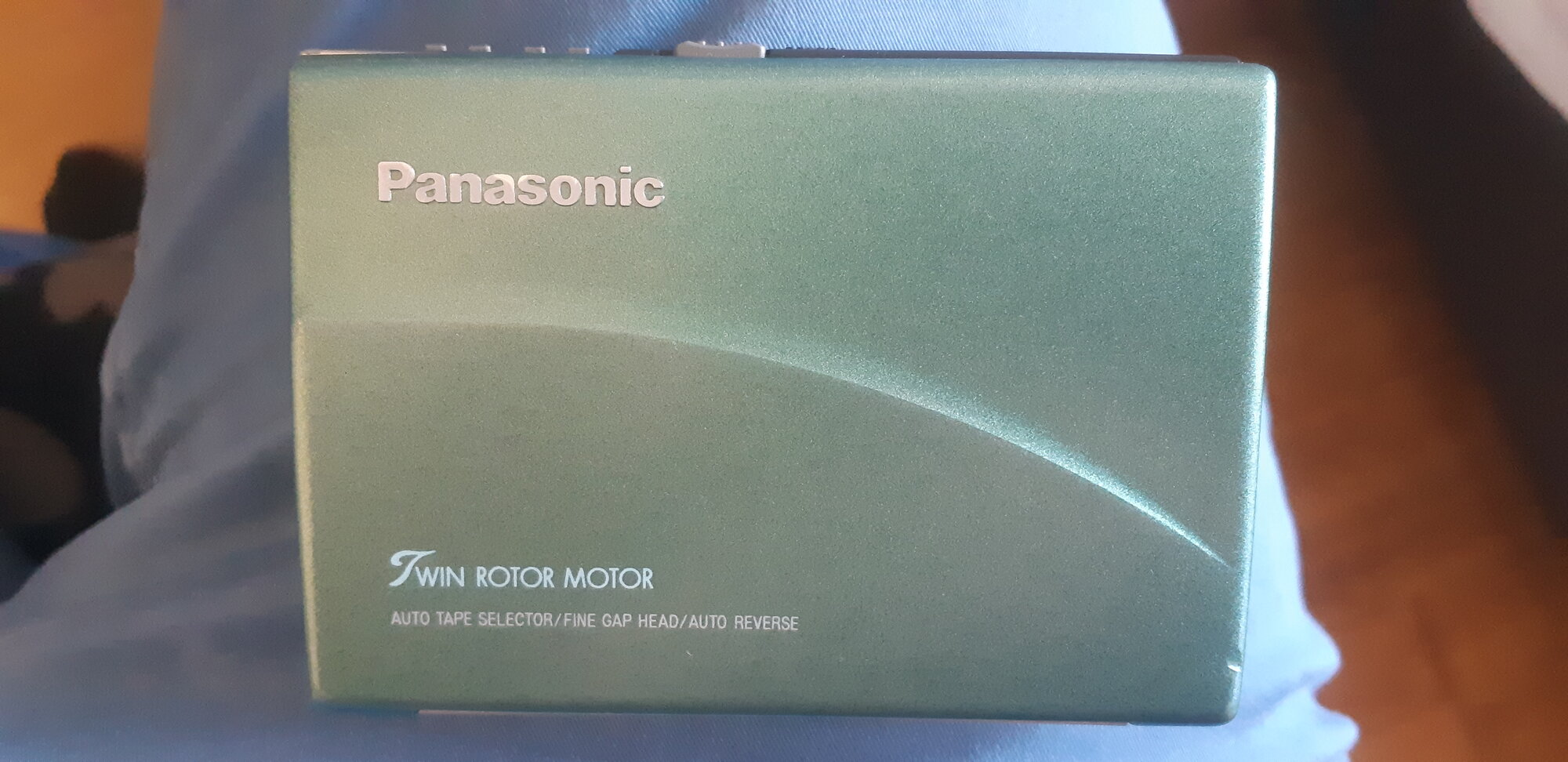

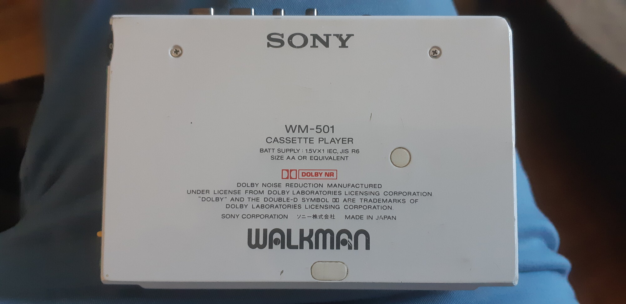

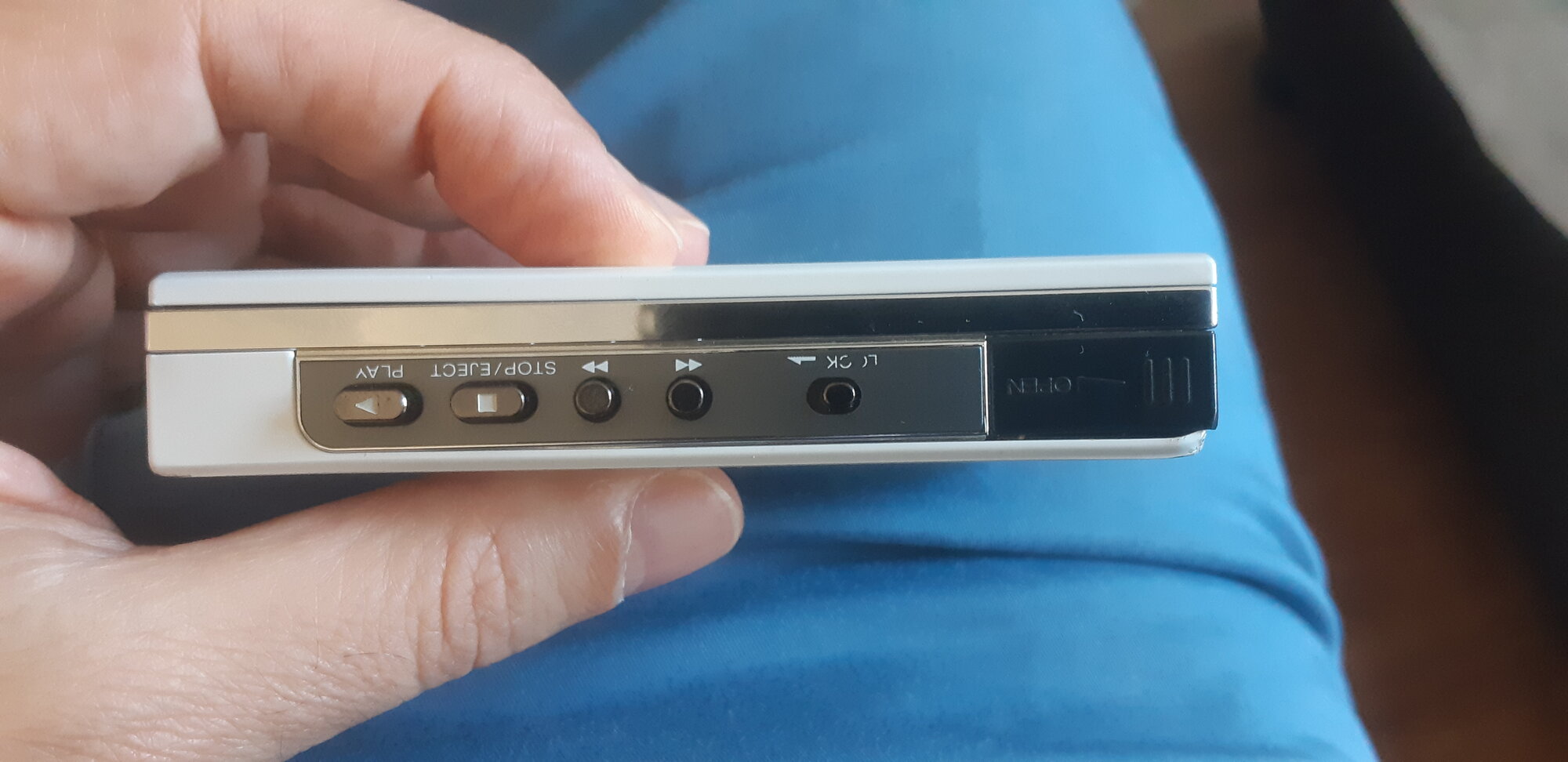

    I have just get two new babies, a Sony Wm-501 and a Panasonic RQ-S35 from the same customer as a faulty items for spares. The Sony without accesories, no battery adapptor, only the walkman, I couldn´t test. Panasonic cames with the battery adapptor and the walman itself. Panasonic was tested, It doesn`t play, try to start when you press the play buttons but doesn`t.

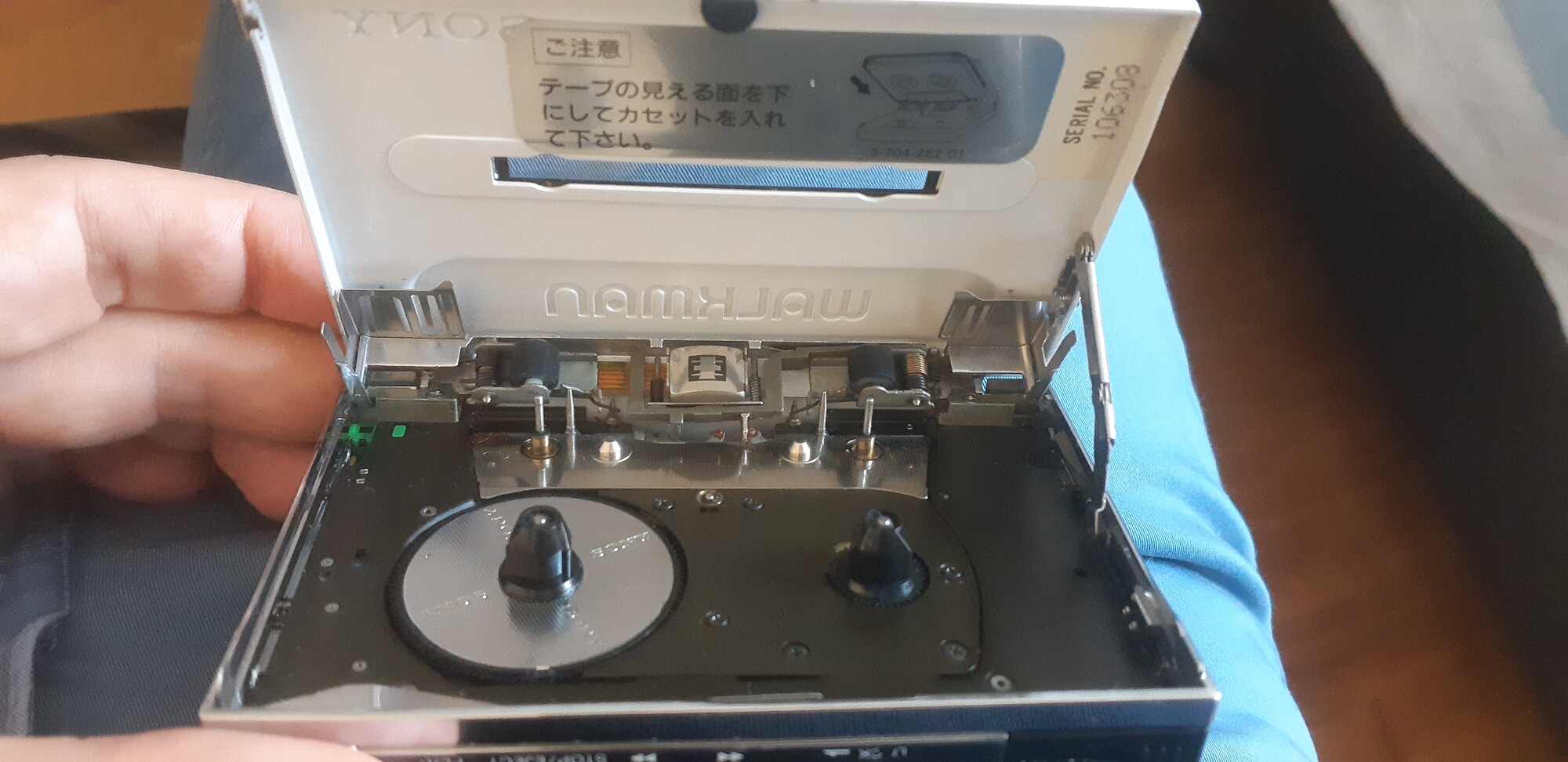

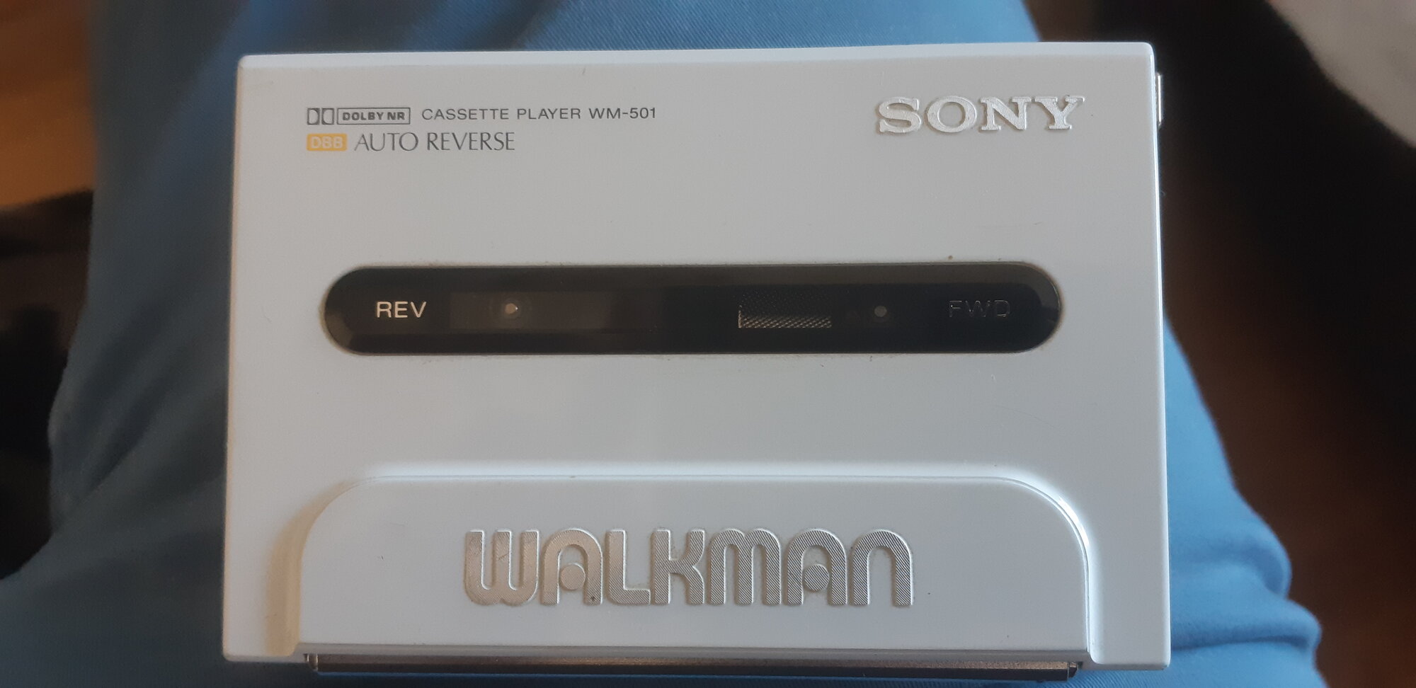

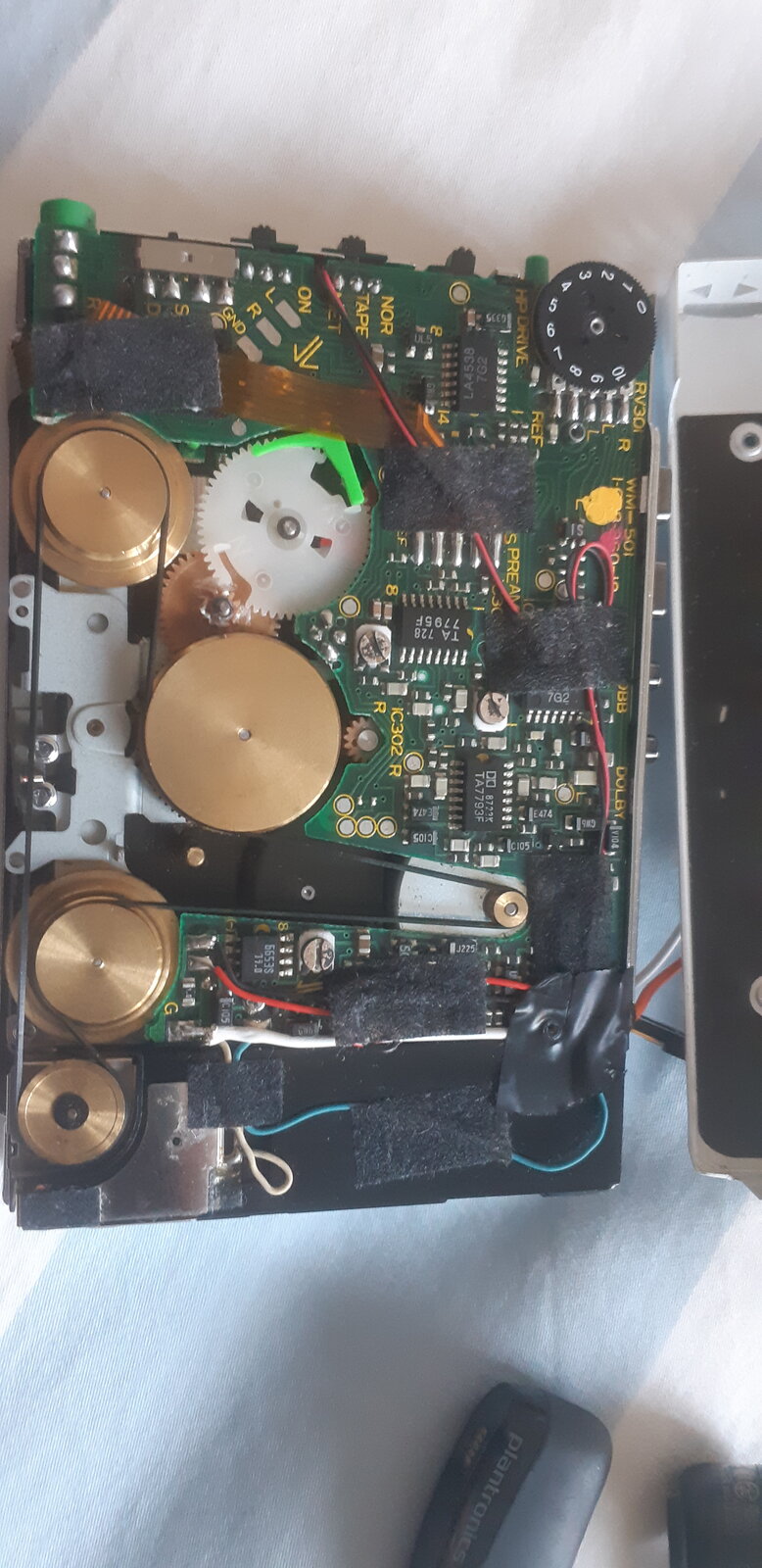

    First impressions after reviewing:
    Sony WM-501: sticky belt, remove it and clean the gears and capstan with IPA. The secondary gear stuck, maybe old grease. Removed and runs free. Tested with a alkaline battery and a pair of wires, the motor seems to run ok. I'm wating for a Marian´s belt and a rechargable battery to test it properly. The problem is I have an old Panasonic NiCd charger and the one´s I have ordered is a NiMh. As I`m aware to charge a NiMh battery on a NiCd charger is not the best option, If erverything it´s ok I´ll buy an intelligent charger.

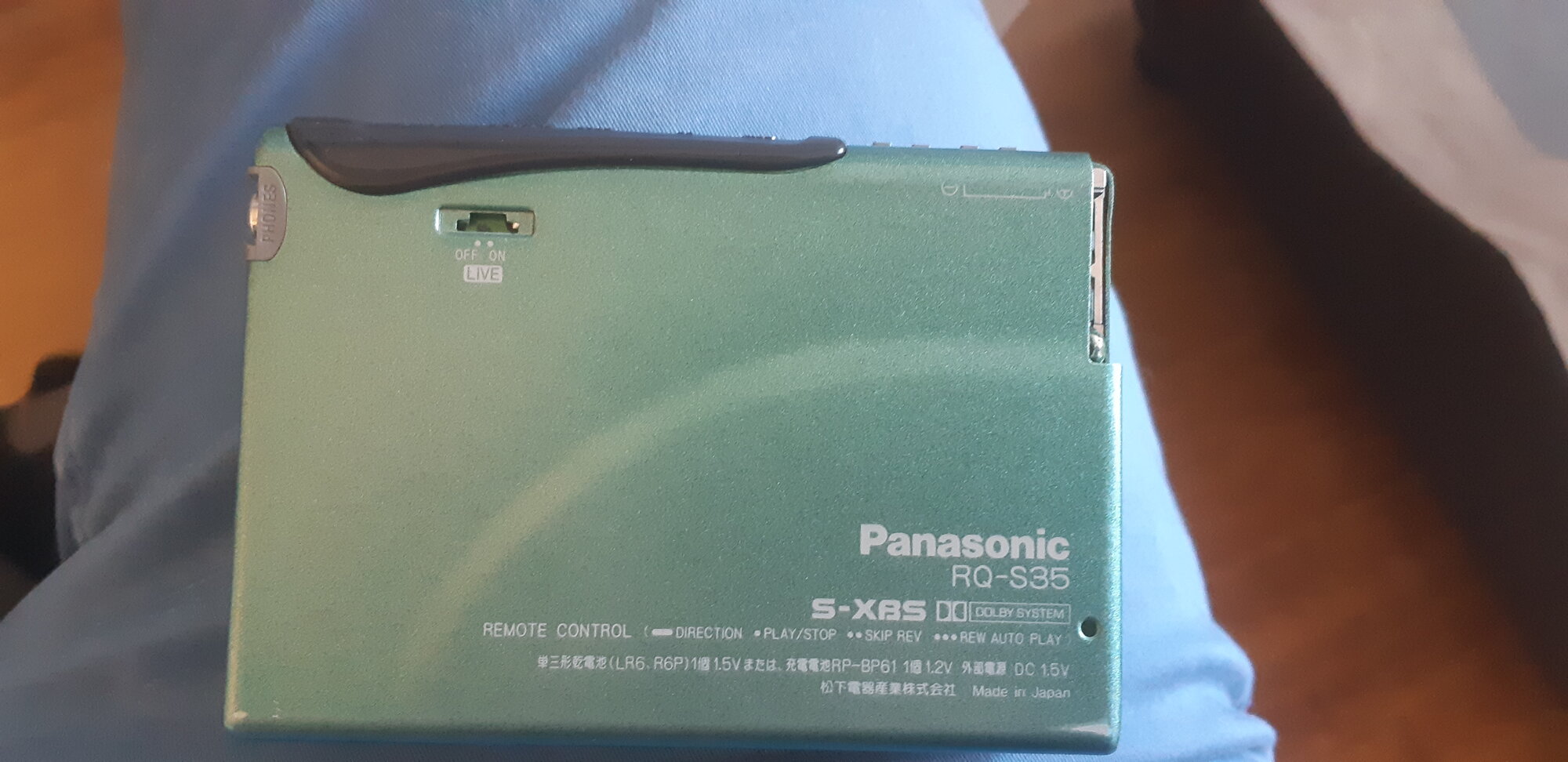

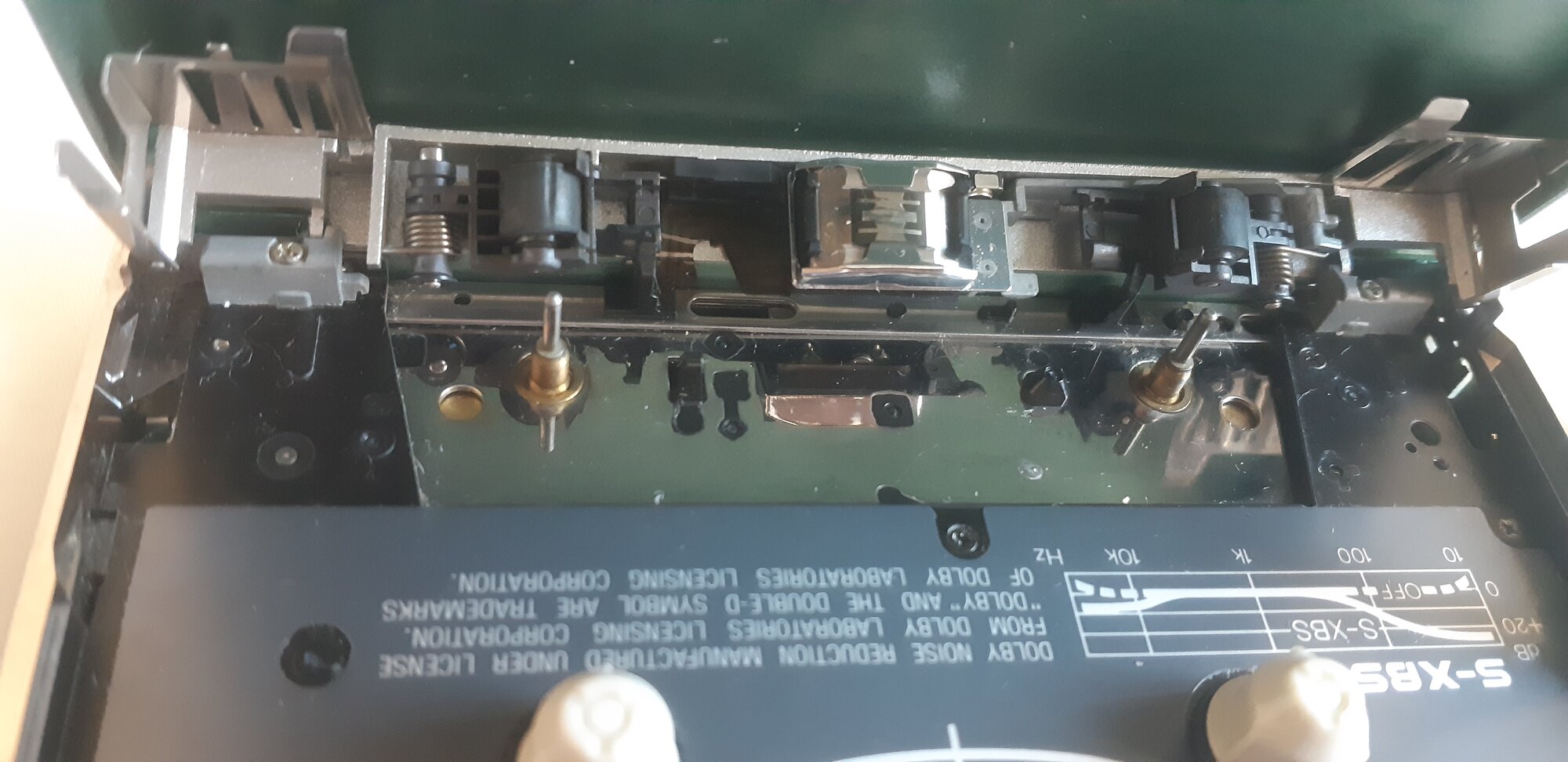

    Panasonic RQ-S35: sticky belt cause stucking motor, dissabled rotor and clean it, after that runs freely and smooth. Waiting for Marian`s belt. In order to check the status, the pcb was desoldering: 4 solder points motor, 2 points solenoid, one more for Ac (I think so) and I have to desolder 4 points for the tape selector, these are jointning the main pcb and the tape part in 90 degrees angle. I hope don´t have problems resoldering again. One more issue, one pinch roller with a mark made by the capstan (last picture). Once I have tested with the new belt if works I´ll have to search for a new one.

  5. Silver965
    Silver965 Well-Known Member
    676
    Torino
    Hello... that roller will be difficult to restore it you better change it

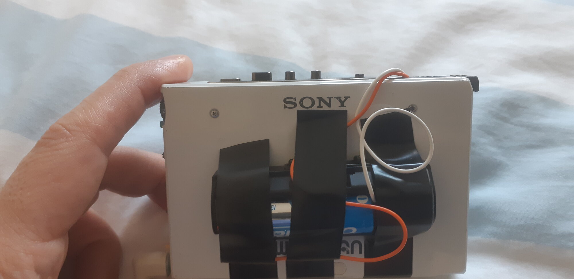

    I'm still wating for the Marian's belts. This weekend I was seeking in my box's spares for and old Sony wm-ex1 belt replacement that I bought many yeargs ago but never could use for motor issues. Well, it fits perfectly in the wm-ex501, altought I din't receive yet the gumstick battery I tried with an alkaline battery, and ... Back to the road again!

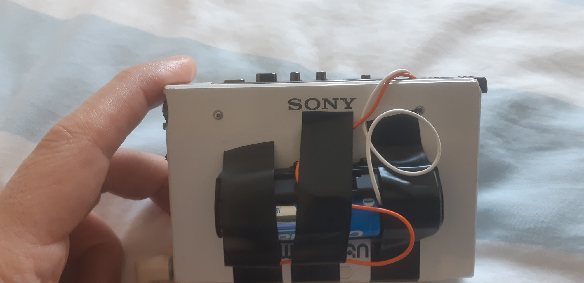

    All seems to work perfectly but autoreverse, when you press the grenn botton to change the direction the side b starts to play ,but in a few seconds stops the sound and the tape stucks on the pinch roller. I don't now why. First of all I lubricate the axis of motor and capstan, and regrease the gears. The mecanisms runs quiet and smoothly

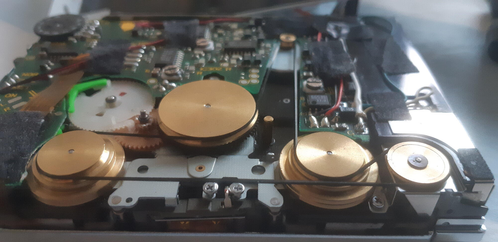

    The belt needs to be very thin, or it may get stuck. The belt that was in my WM-501 when I got it was too thick and wouldn't work. Marian's belt was really thinner and works fine.
    Here's a picture of the old belt in place. You can see the second right pulley where it was problematic.

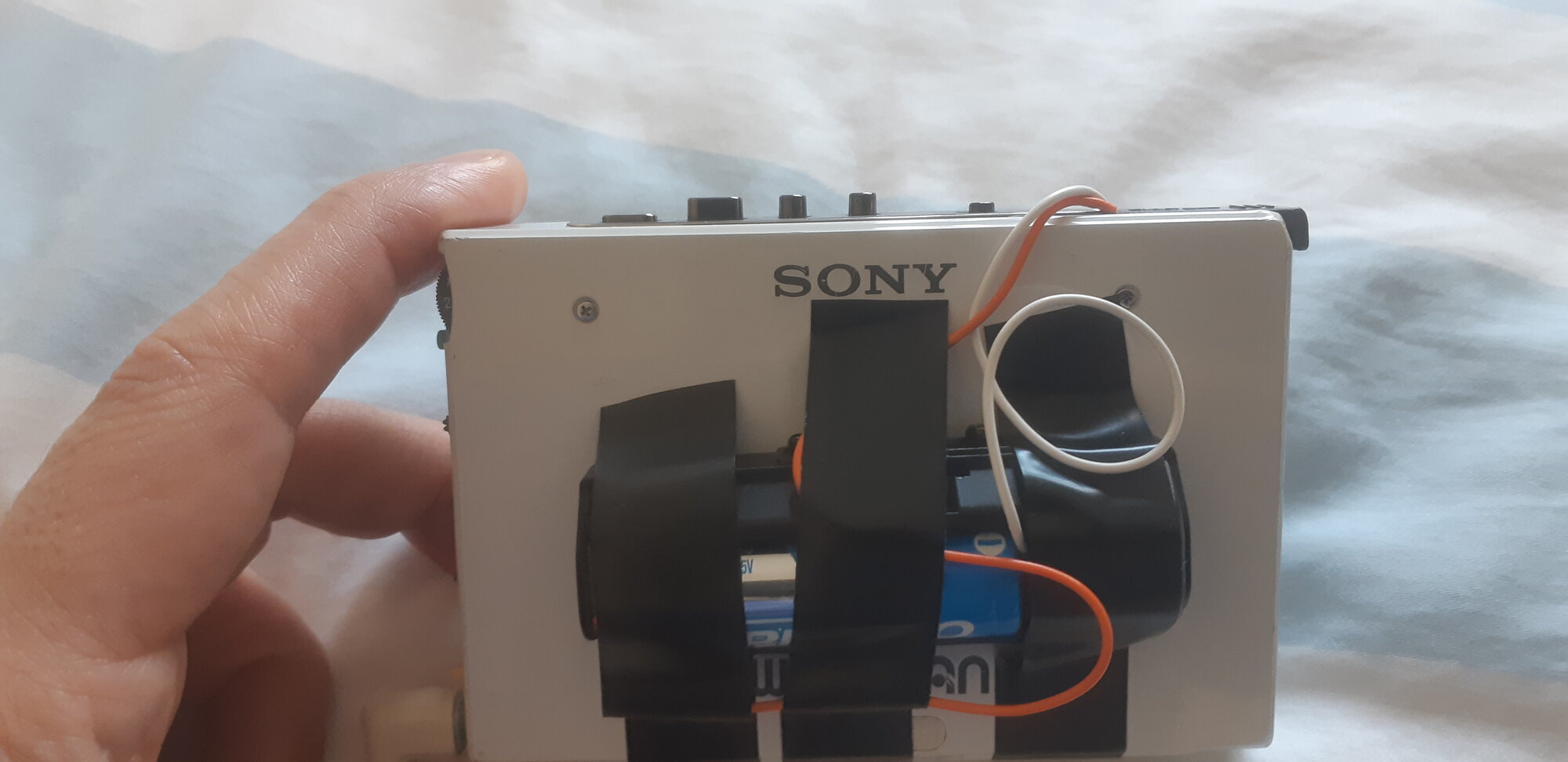

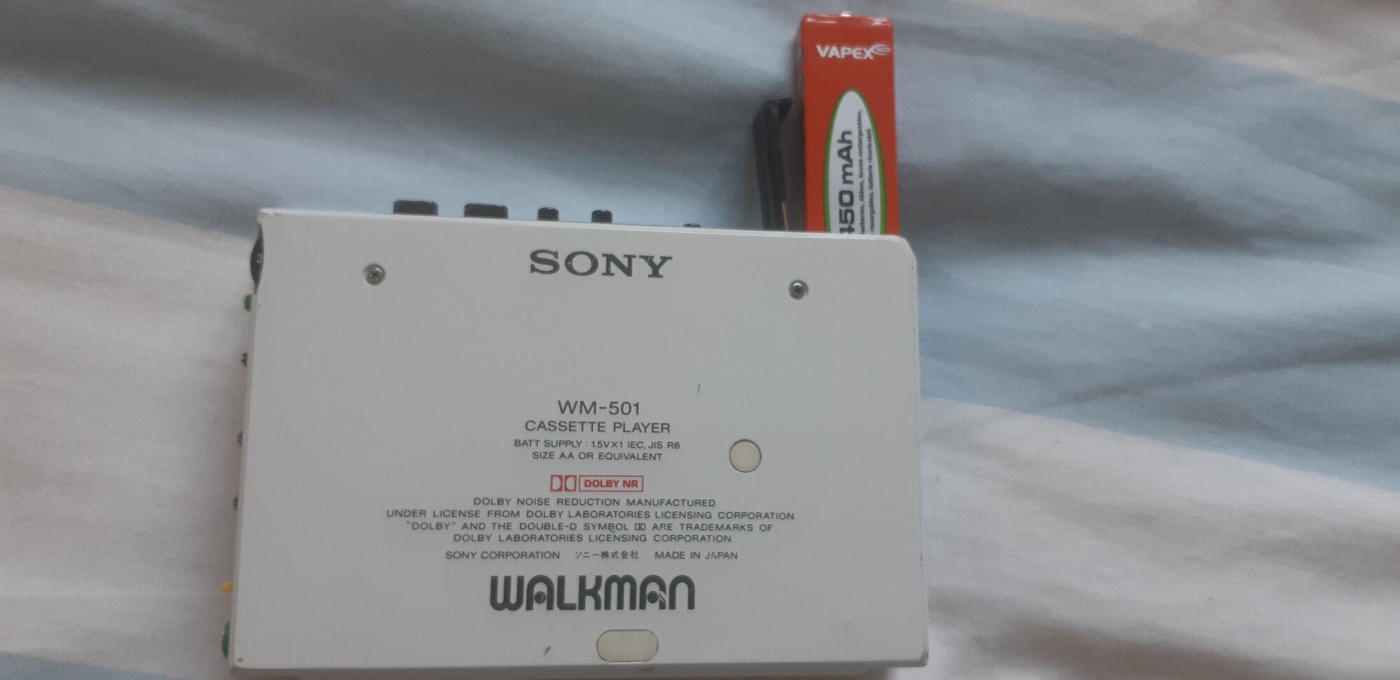

  20. JUAN ANDRES MONTIEL DIEZ
    JUAN ANDRES MONTIEL DIEZ Active Member
    191
    Spain
    Charged during two hours and a half with a Panasonic's NiCd, during the process the battery only warms a litlle. Not sure if this was enough I checked with a Panasonic Rq-sx52's battery tester, it shows 3/3 charge level, after a few minutes shows 2/3. Since that 1 hour and a half of continous reproduction in wm-501 and back test with 2/3 results
