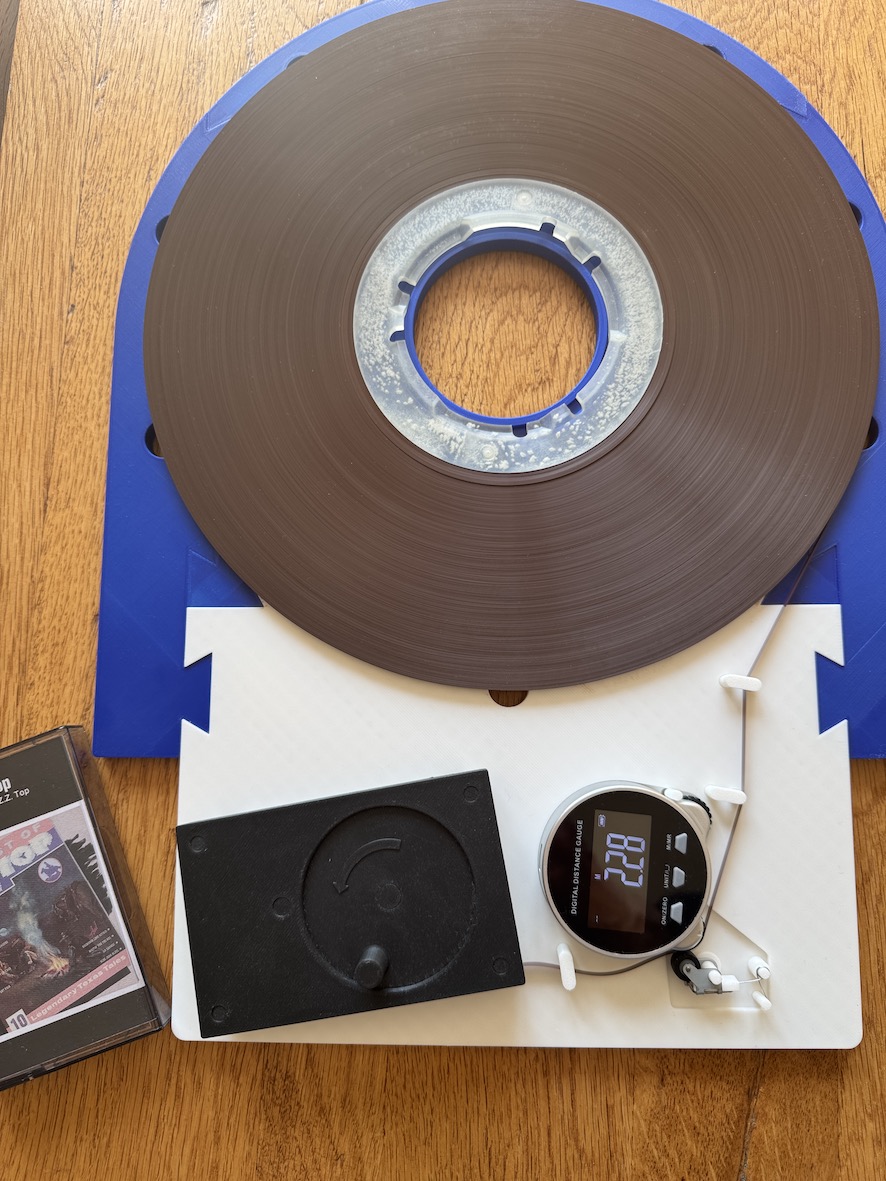

    So I asked the company in Germany that assembles the cassettes for the 3 ??? (in German: Die Drei ???) and many more famous series for a roll of raw material. They were kind enough to sell me a roll of 3'800 m of Type I tape for a very fair price.

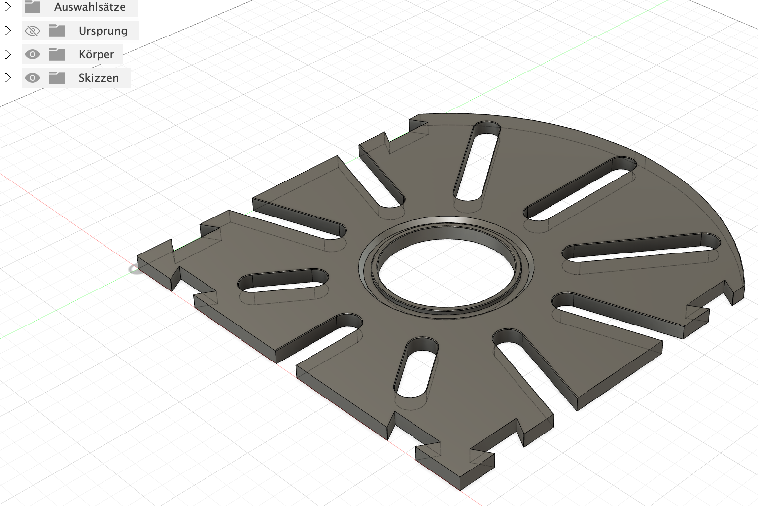

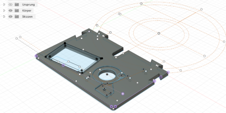

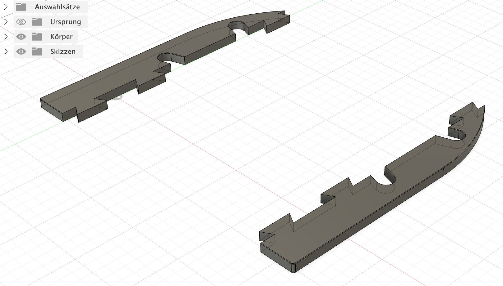

    I used the 3D printer to construct a small tool. The printer is limited to 256 x 256 mm, so it was necessary to split it in different parts. The colours are random because I used leftover filament.
    Bildschirmfoto 2025-03-30 um 19.08.12.png Bildschirmfoto 2025-03-30 um 19.07.42.png Bildschirmfoto 2025-03-30 um 19.07.17.png
    The counter is used to match the length of the tape to the play time of the tracks on the A/B side.

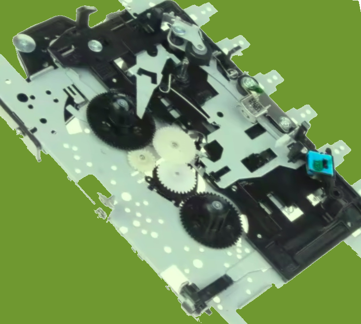

    The pinch roller comes from an entire drive mechanism that I bought in China for a ridiculously low price (about 3 EUR for the whole unit including playback/recording head, motor and belt -see picture). The drive looks suspiciously similar to that one used in a model that was new introduced some years ago. I hope the similarity is only in the way it looks and not in the quality…).
    This little tool allows to rewind new blank tape material on pre-record cassettes and then re-record the content without having to sacrifice blank cassettes just for the tape material. 3.8 km of tape will last for a while
    I prefer a cassette that is not 100% original rather than a 100% original that is bad in sound or even no longer playable.
    If anyone is interested in the .stl or Fusion files, let me know.
