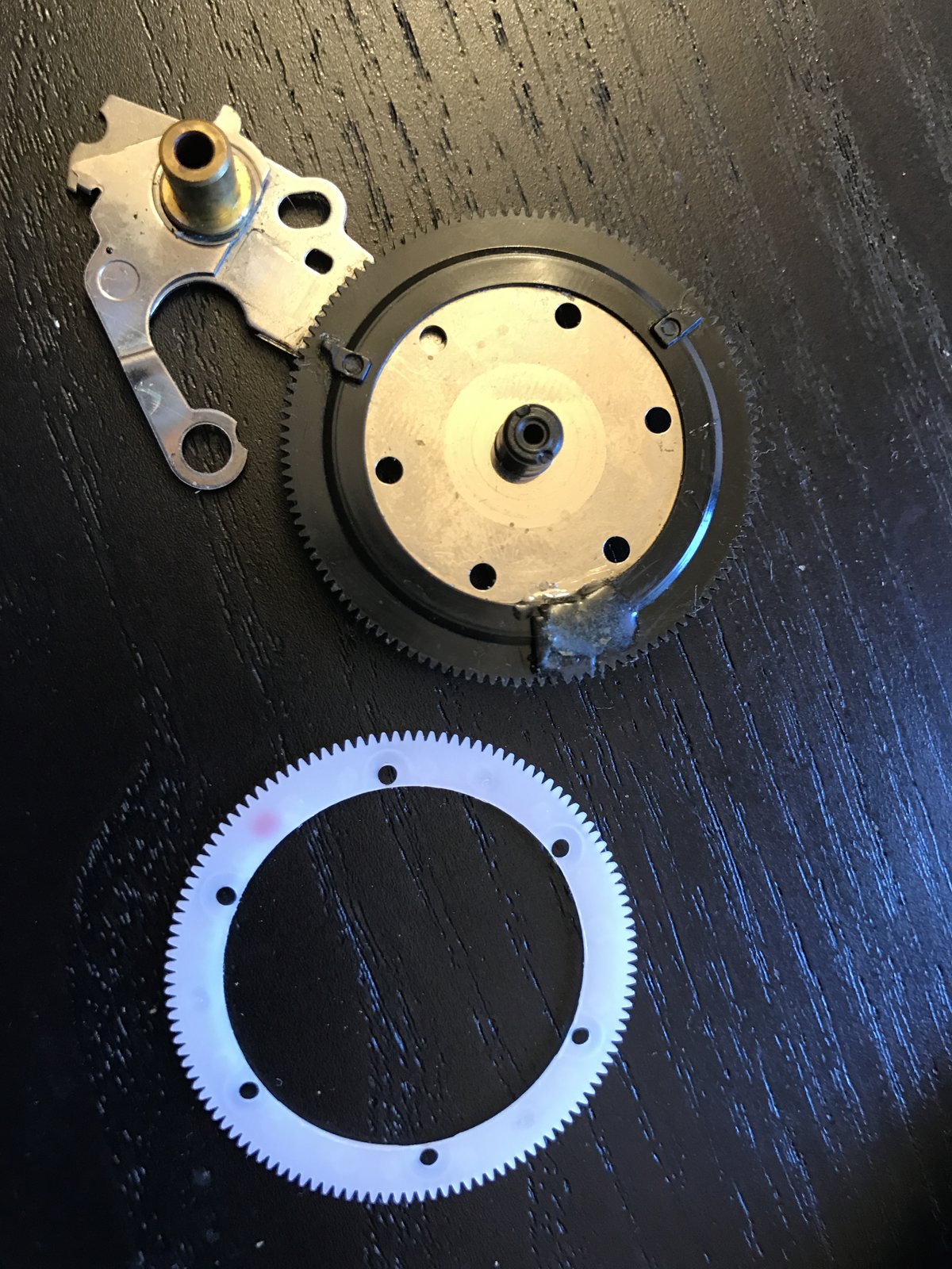

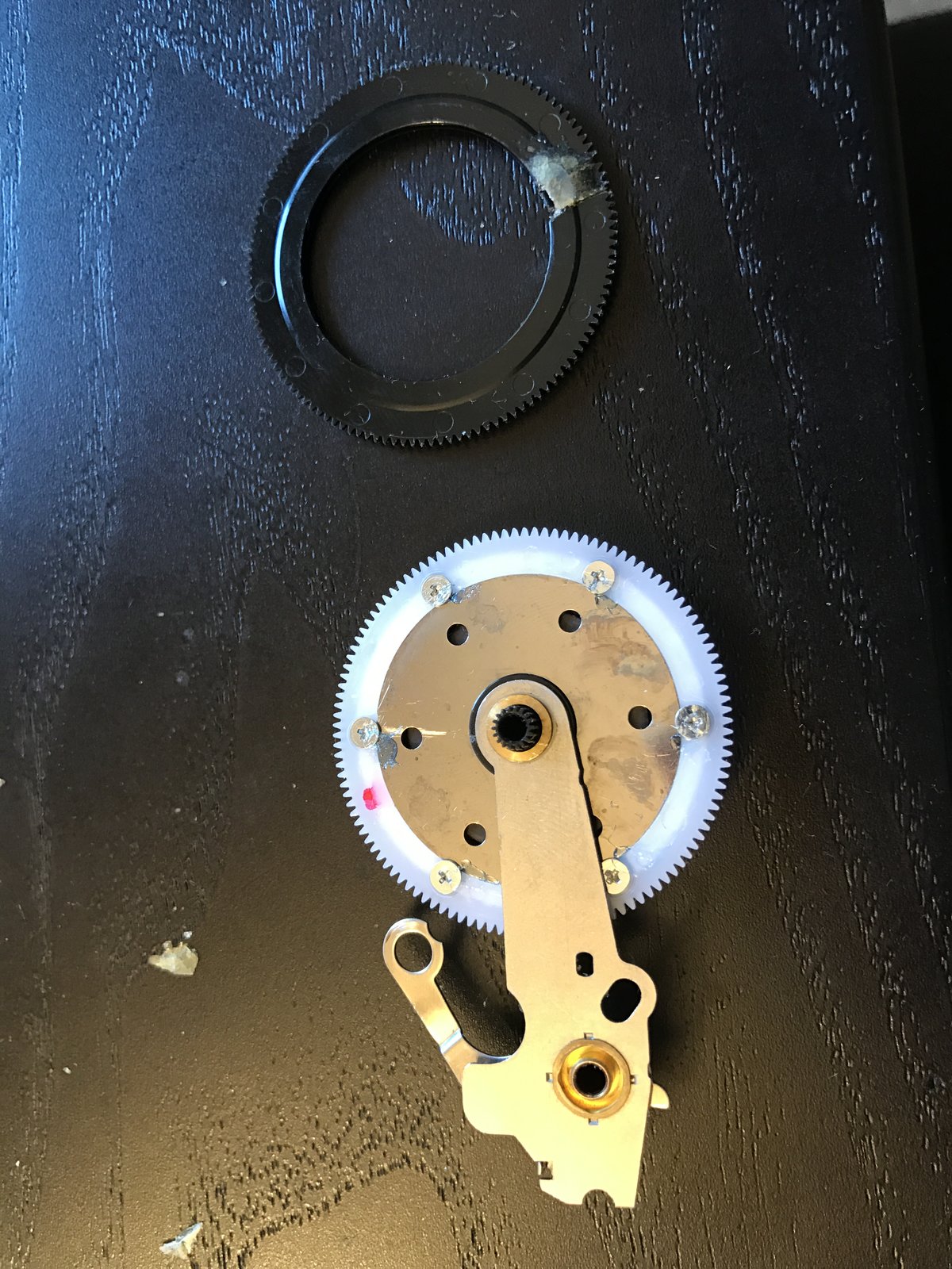

    Just put in a new gear in my DD33! The new gear is absolutely spot on, and now I know what it feels like to own a "perfect" DD!
    The previous owner of my DD33 (bought for parts on ebay) had the center gear repaired via the addition of teeth and epoxy. It was actually a decent repair and I never had any problems with it.
    It was a little painful to break apart the previous owner's repair, but the potential for lower wow/flutter from the new gear is too enticing to pass up!
    This was a relatively simple repair and the guide is excellent! I will add a note about the head slider however. It needs to be replaced with the notch covering the autostop prevention lever for FF/REW, or autostop will prevent FF/REW from working correctly.
