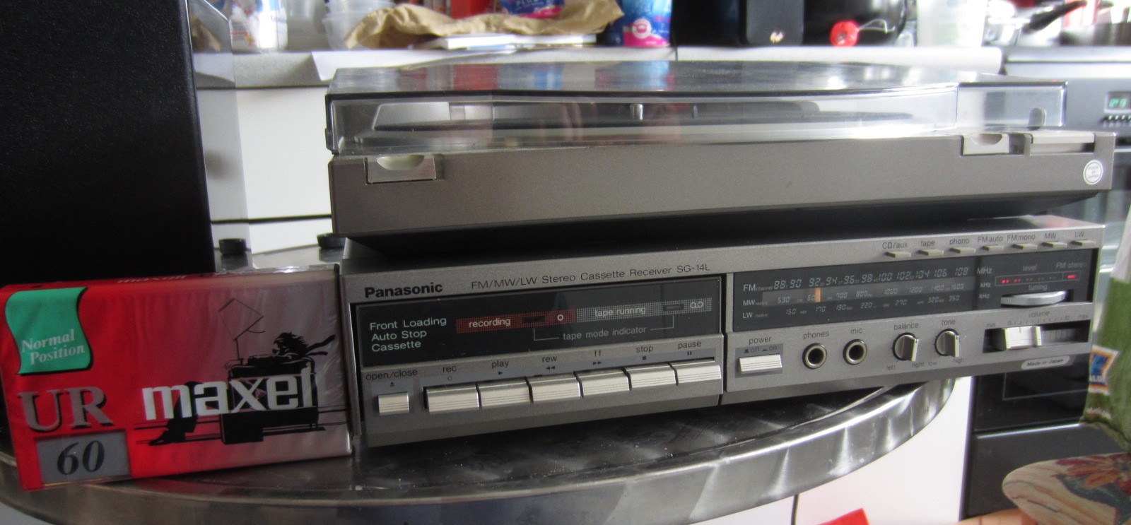

    Another item it was designed to match was their SG-14L Casseiver (which does incorporate a phono pre-amp). The Casseiver is the same footprint as the turntable, and the height of a cassette case. To achieve the low height it uses a drawer loading cassette mechanism. I think it was designed to be one step up, and one size smaller than Panasonics popular music centres like the SG-X10.
    The "7 segment" Font on the Analogue tuner is amusing
    Having acquired both in a Charities Ebay auction last year I thought I should get around to repairing it, before starting on my Sharp VZ2500. As sold the cassette mechanism was jammed open. Inside part of the mechanism was bent. I was surprised to find that the drawer opening and closing mechanism is (apart from an extra switch) all mechanical and belt driven off the cassette decks motor, although most of it dis-engages when not operating the drawer. I suspect that the belt went slack and then someone tried to force the drawer in making matters worse.
    Having re-belted to unit, straightened out the connecting rod (taking a few attempts to get the correct length) and added a screw at the pivot point to replace a broken plastic clip, I got it all working. Electrically everything in the unit worked fine as received.

    That's a nice little set-up and I'm sure it's happy to be working again. I've only seen one front loading cassette deck, an 80's Marantz at the thrifts years ago. You guys may have more over there but some reason they're pretty rare here. That front panel screams Technics, I bet there's another version of it.

    I think the Panasonic/Technics Cross-overs were more European, they kept the brands very separate over here. I kind of think the design units were in different buildings, you can see some of the Technics Design Cues, like the rotary dials, headphone jacks and small square buttons, that are Technics calling cards. Even the size matches a bunch of Technics 80's Components. It looks like there was a National Version of that TT as well.
    One of my micro stereos is branded Panasonic but I always thought it might be more Technics. I popped it open one day and all of the chips were labeled Technics, even though they probably all came off the same machine used for Quasar, Panasonic or Technics. My stereo is extremely rare and was expensive, most people wouldn't spend over $1000 USD for a Panasonic Stereo, but might for a Technics. If the unit had larger production I'm sure the chips would have matched the branding.
