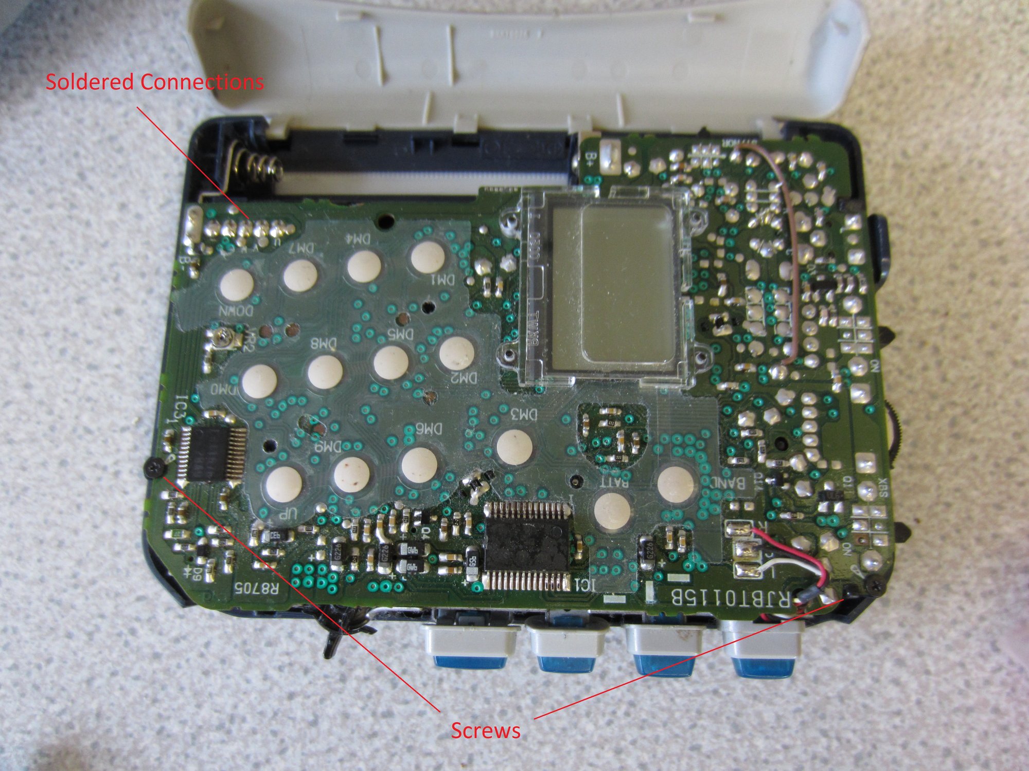

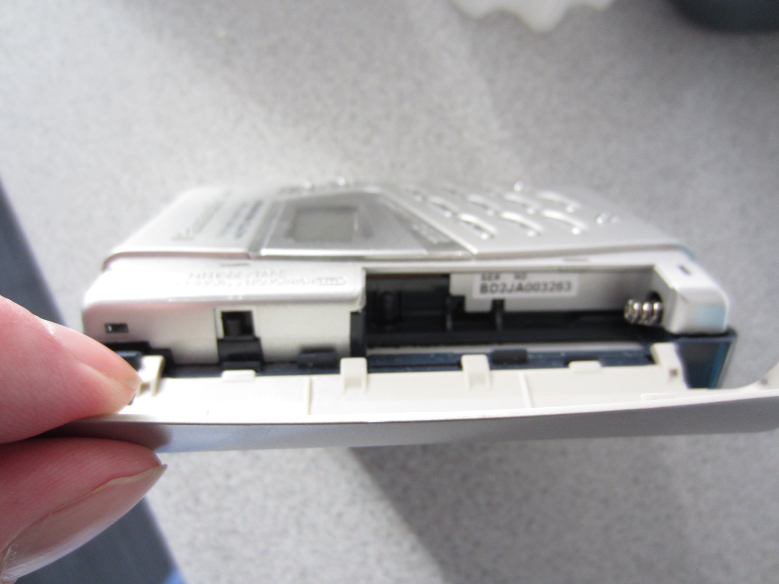

    There are no screws in the case, it just clips together.
    As the tape controls go through it you have to start unclipping from the battery compartment end (with the battery door open).

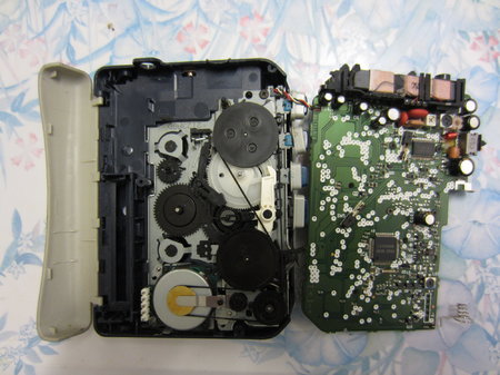

    Inside the main PCB is on the top, blocking all access to the mechanism
    It is held in with just two screws :wink2

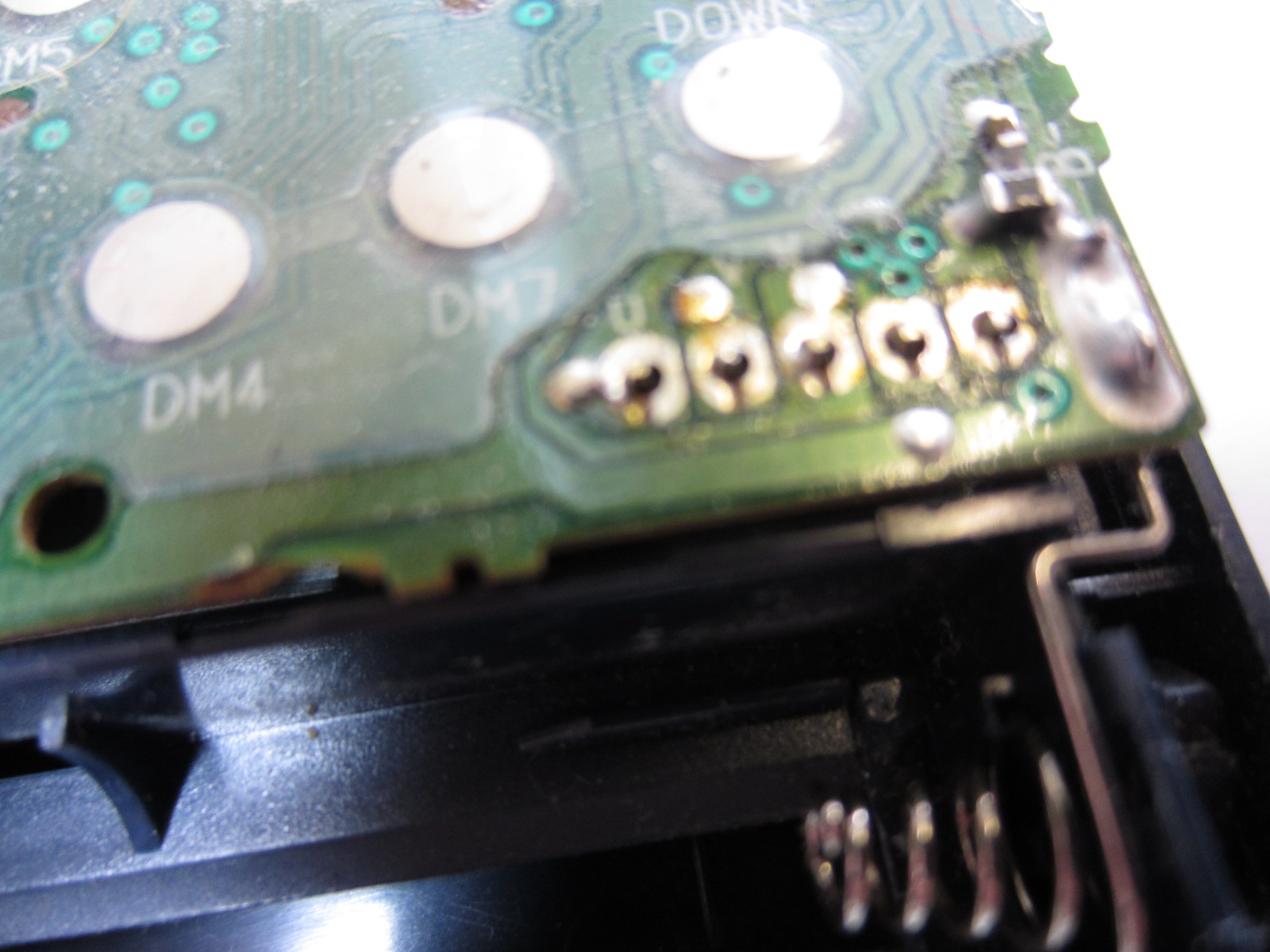

    and 5 solder connections connecting a header on the motor board to the PCB :shock
    These have to be disconnected - I used desolder braid which is great for this type of job,
    being less likely to damage the tracks than a desolder pump.
    The board can then be lifted up being careful not to damage the wires near the play head.

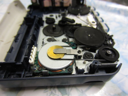

    It was at this point I hit a problem.
    Mihokm's kit had two short belts while my player had one long one.
    Contacting Mihokm he was very apologetic, explaining that Panasonic must have changed the design.
    However, using pictures of the belt I had taken out to judge the size, he would send me a new longer belt in the post.
    This turned up very quickly and appears to fit but I was too busy to solder the player back together.

    I was impressed to see that they have used a brushless pancake type motor. These were orginally
    designed for applications like spinning the head on VCRs and disc drives, where speed stability
    is very important.
    With the new belt the player is now working properly again
