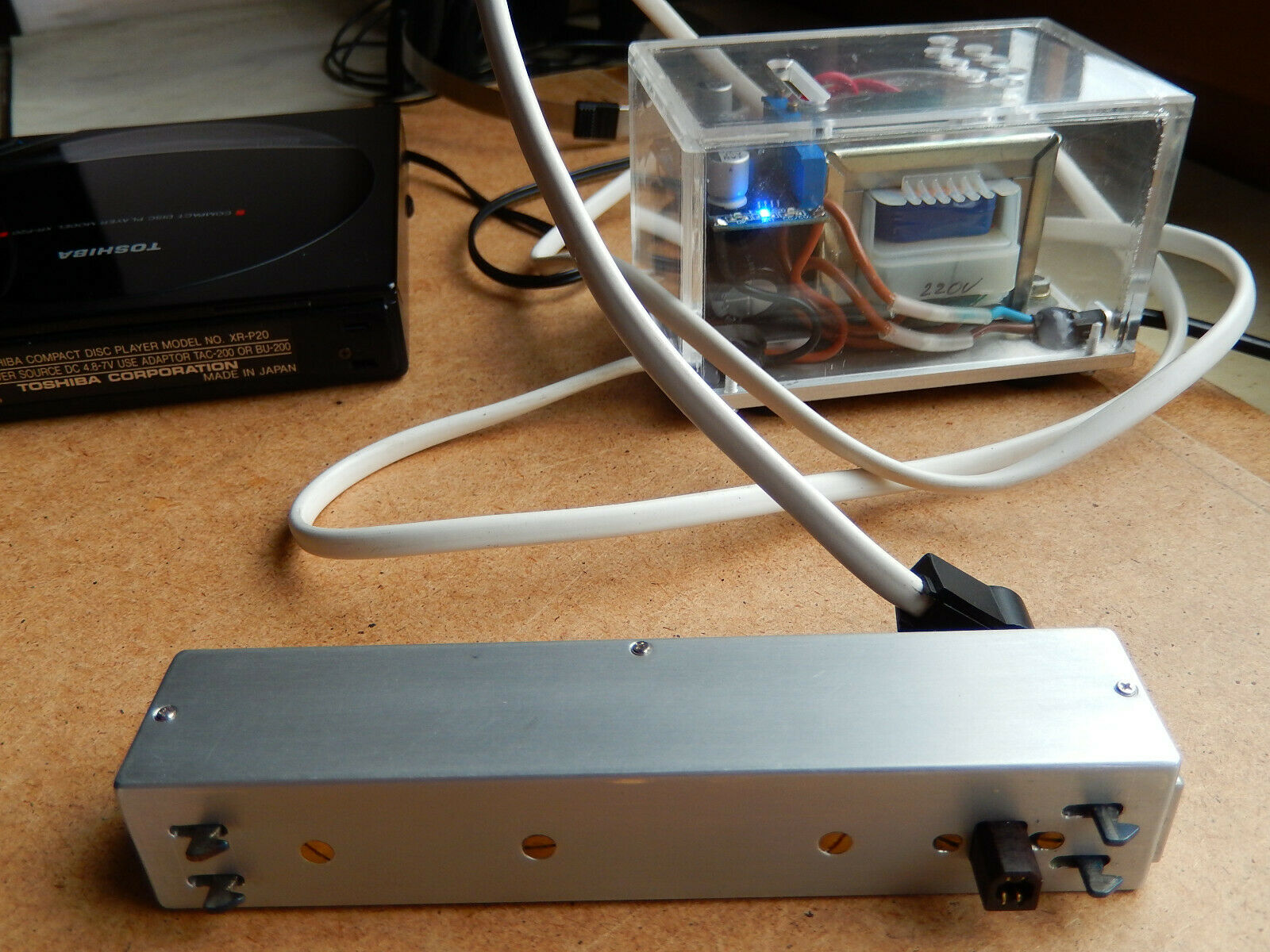

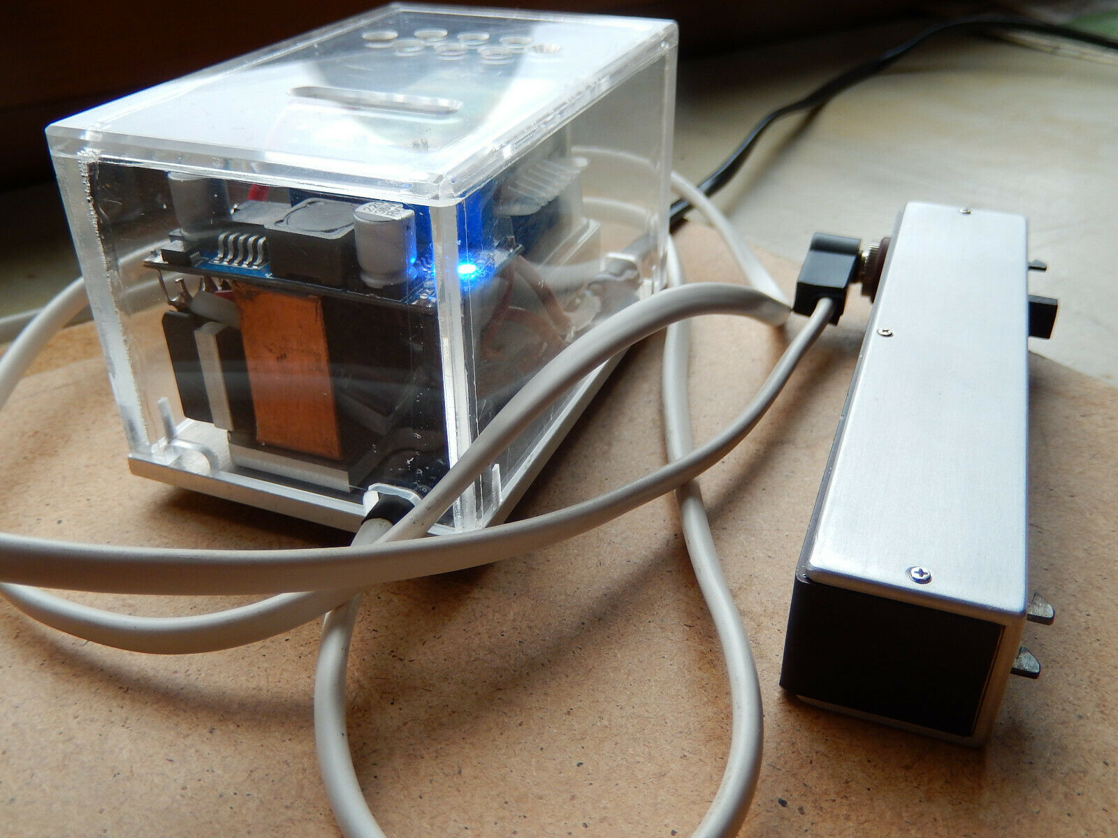

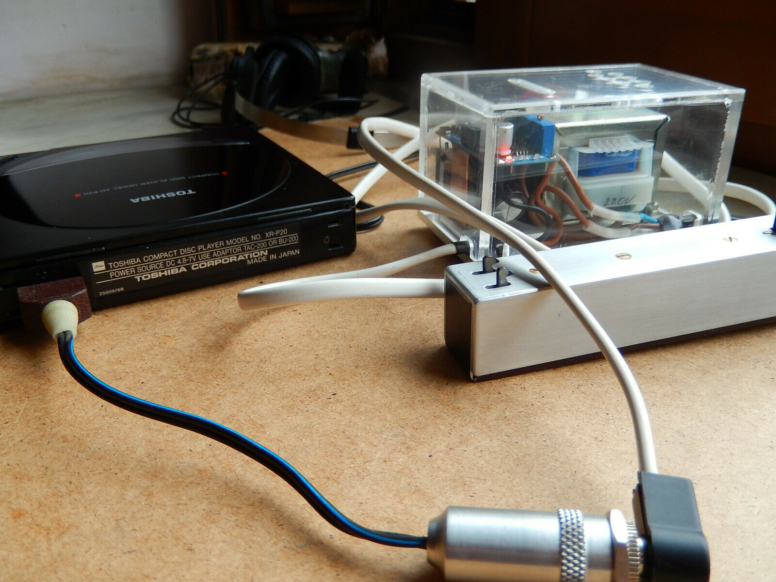

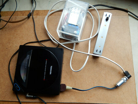

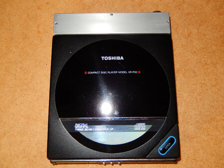

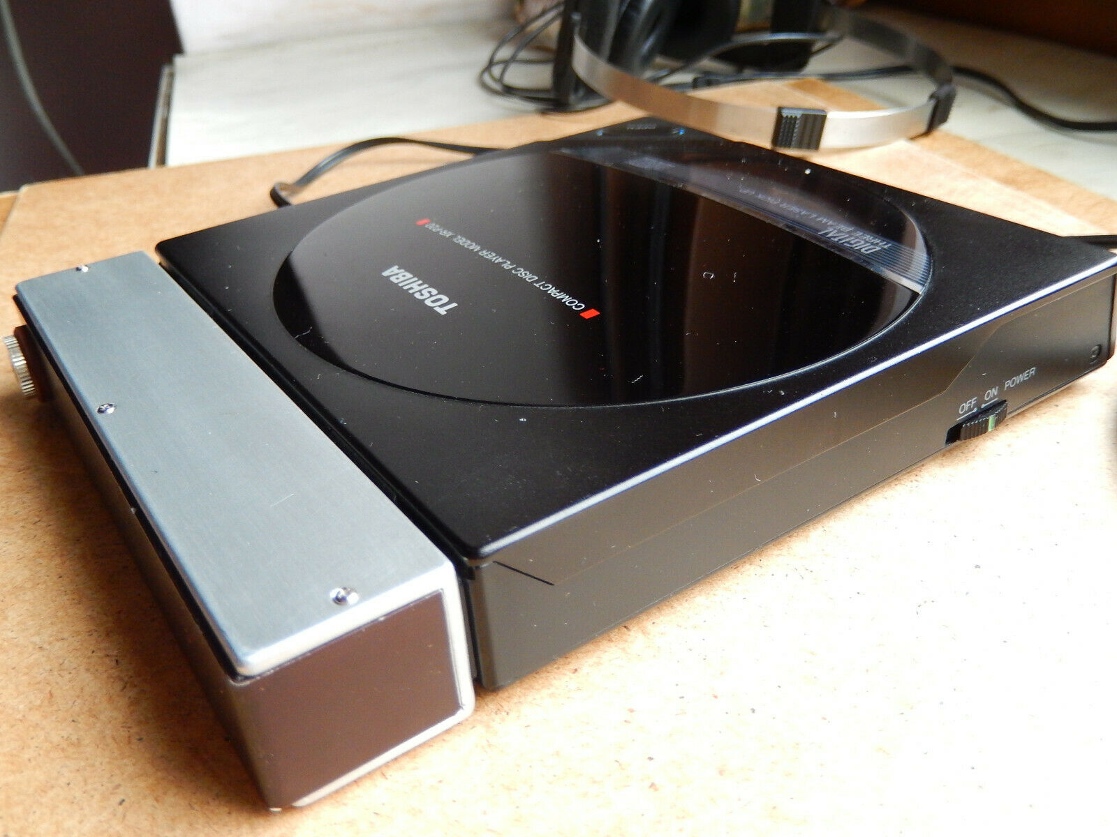

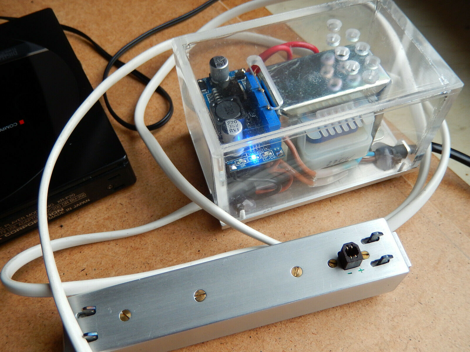

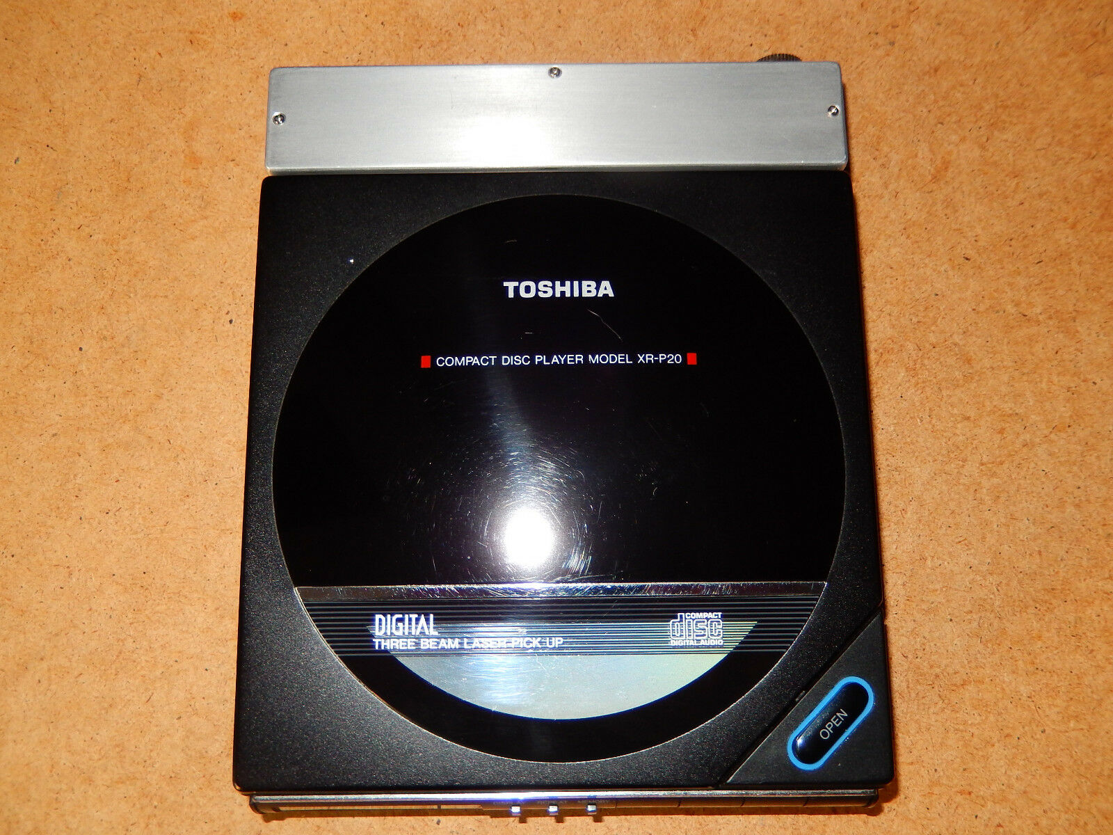

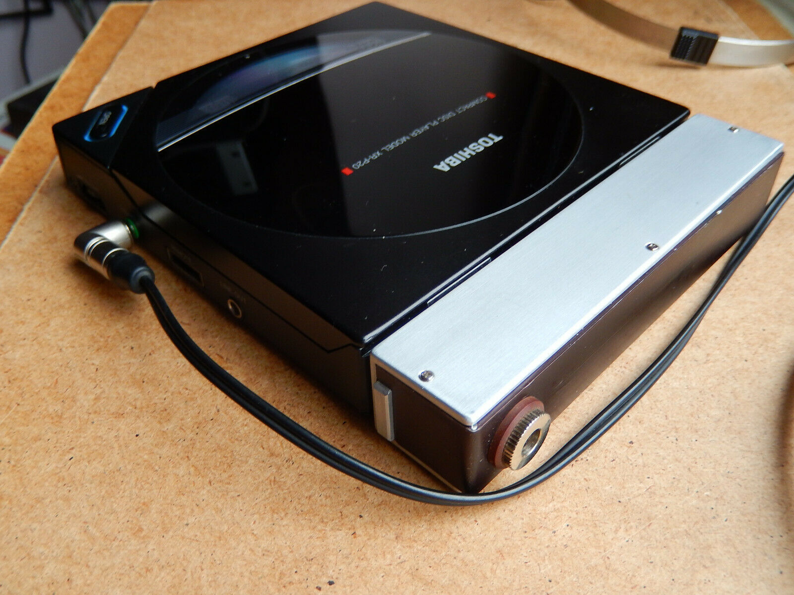

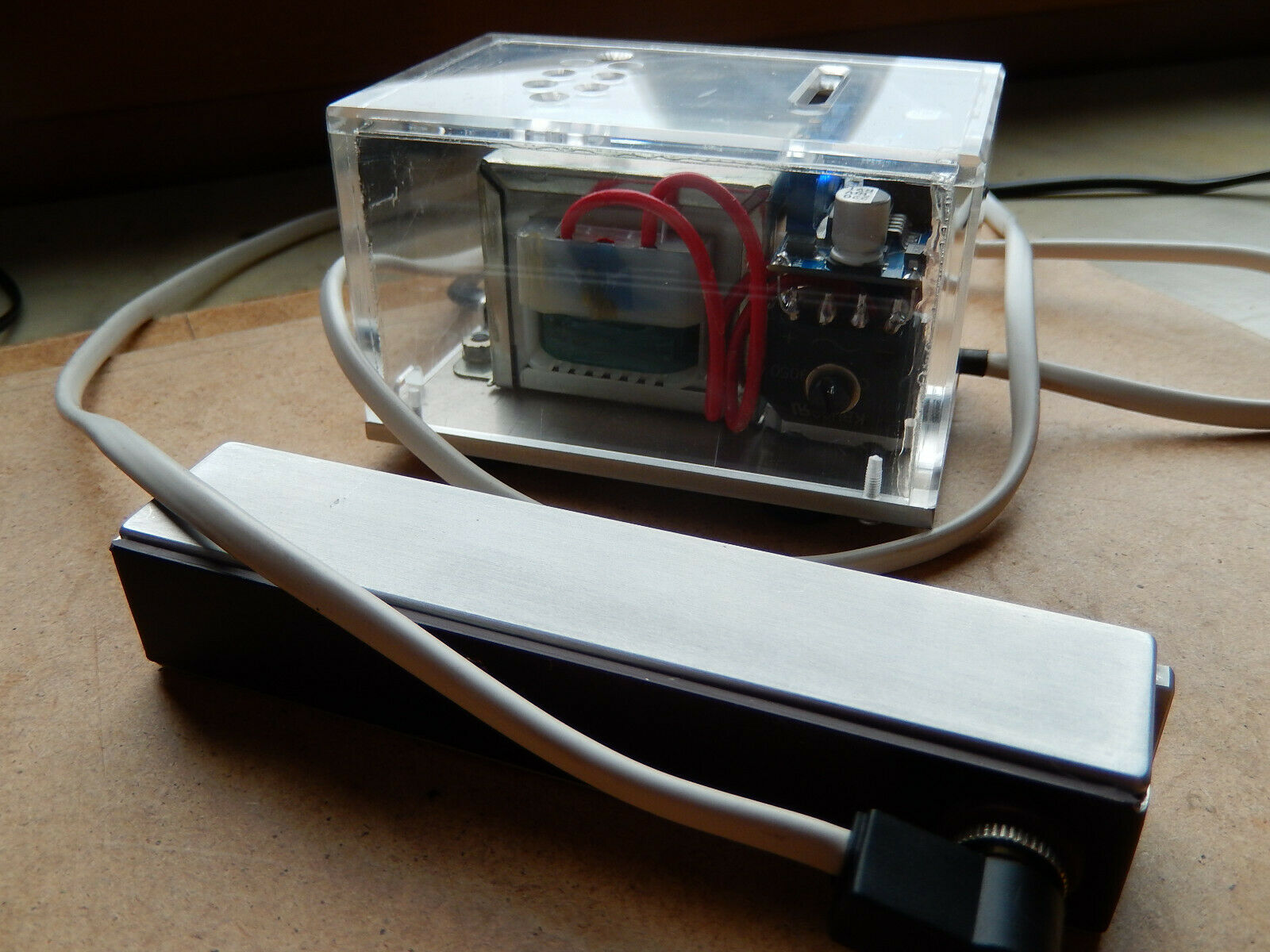

there is our brother in Kaunas, Lithuania who did an amazing job of an add-on battery 'gondola' for my favorite discman: Vintage Toshiba XR-P20 cd player Proves that Anything is possible!!! For when listing gets sold/removed by eBay I load some of those photos:
Have no idea, but with 5 x 1.2V gumsticks inside 'gondola' must be sealed. I contacted seller thru eBay asking to join S2G.

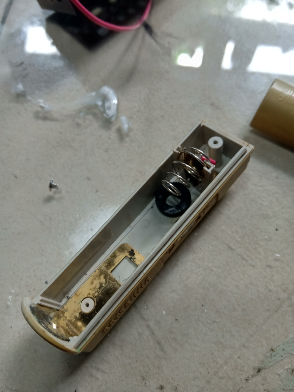

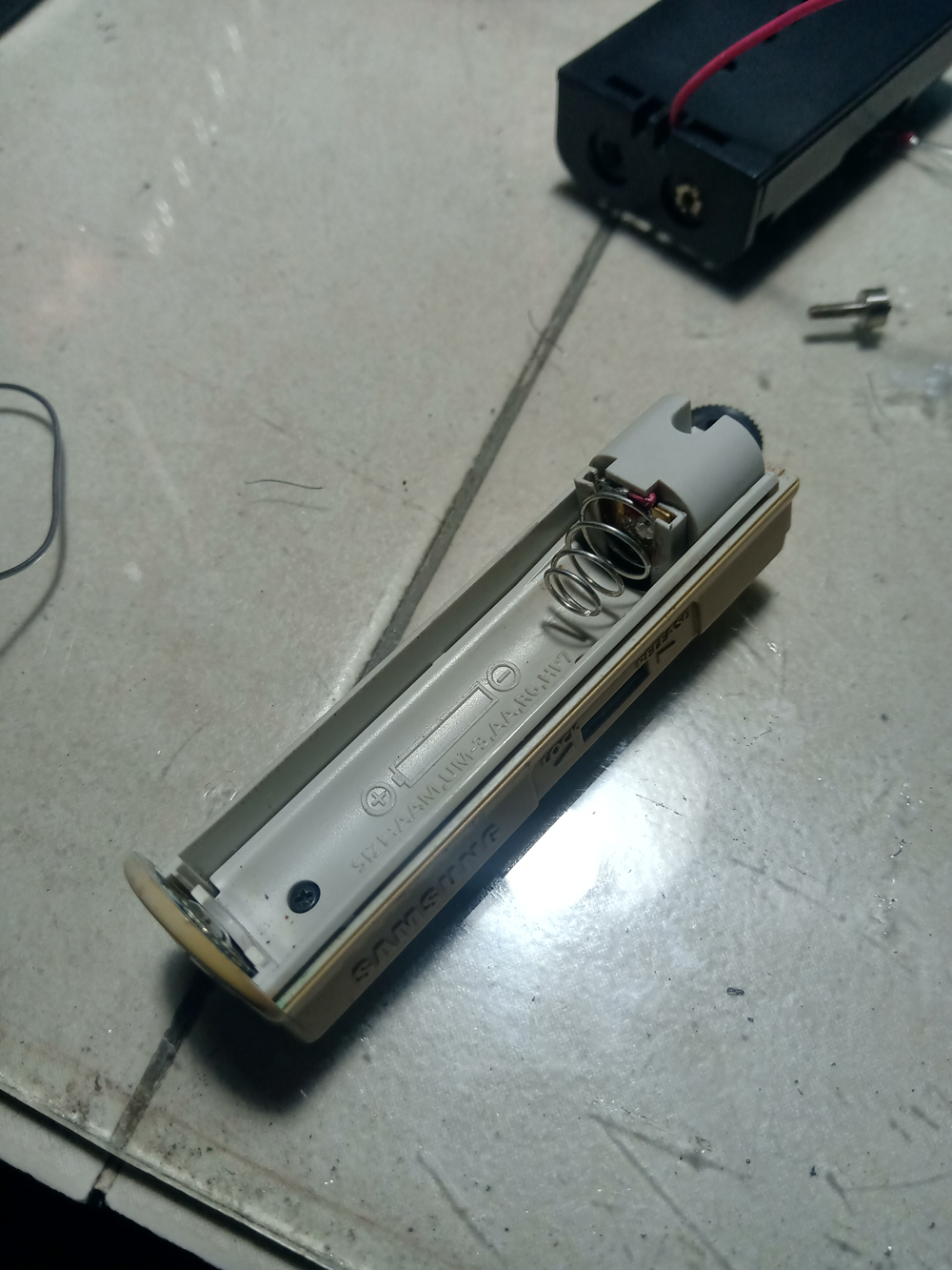

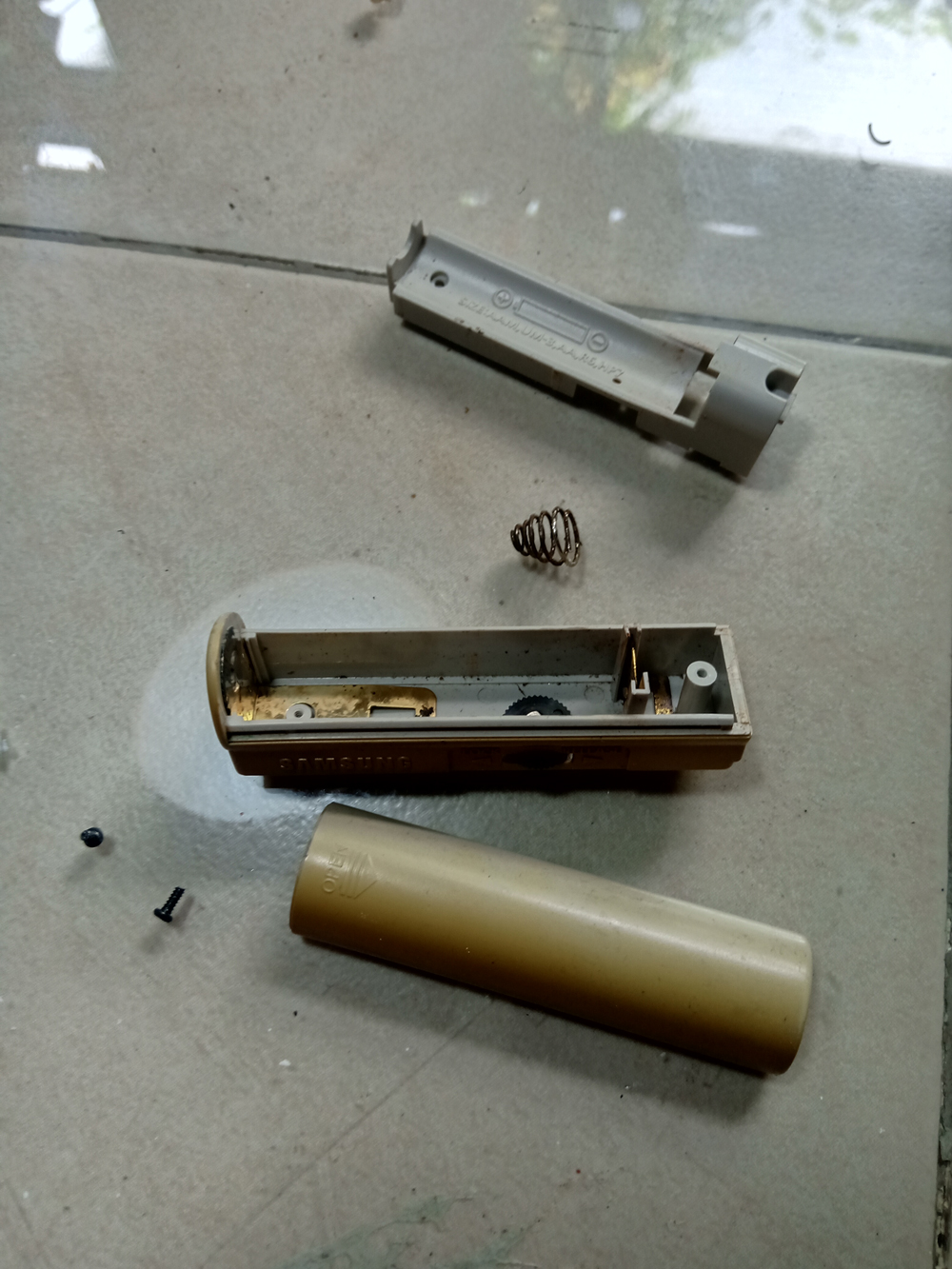

Looks like excellent craftmanship! The walkman 'gondolas' are comparatively simpler though, as you only need ~1.2-1.5V Here's a Samsung 'gondola' I repaired recently which is equally as thin as the Panasonic's. No capacitors in this one:
Oh yeah... That's specific to each brand. This one is different from the Panasonics. If I remember correctly, the Panasonic has 2 small contacts near the corner. I'll take pics when I got my hands on one.
