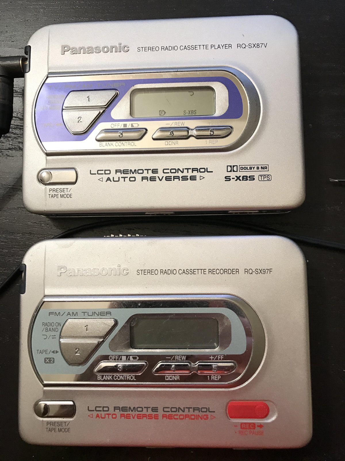

    I just got one of these Panasonic SX units working, but I can't turn the awful S-XBS off without the remote.

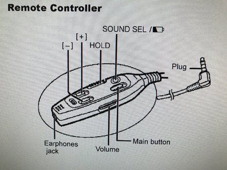

    I've looked through the service manual and the furthest I've got is to trigger the reset test point. Unfortunately reset does nothing to the S-XBS as it is on by default... If anyone has a spare remote for one of these things, let me know! They should look like this:
    Alternatively, if anyone knows how to spoof the remote, that will be even better! The service manual does not include the remote's schematics.
