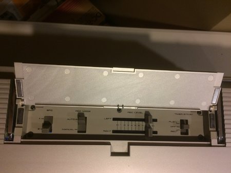

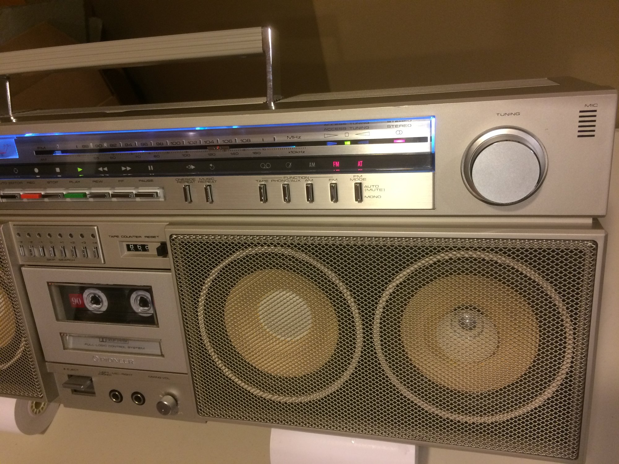

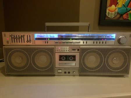

    Ok, so here it finally! The SK-900 has finally arrived and it's been repaired, but it's not quite there yet. It has some trouble playing metal tapes. It chews metal tapes or in this case, it nicks them by chewing them ever so slightly on the very edges of the tape, I have two metal tapes that I can luckily use to test the unit. It's chewing/nicking the tape about 1/3 of a mm just on the side of the tape. It plays Type I and II without any problem and with great sound. I have no idea why it bites the metal tapes though.
    I'm posting some pictures, after all I've waited long enough to do this, but I'll repost this Pioneer once it's all just like I want it.
    IMG_4203.JPG IMG_4205.JPG IMG_4206.JPG IMG_4209.JPG IMG_4210.JPG IMG_4213.JPG IMG_4215.JPG

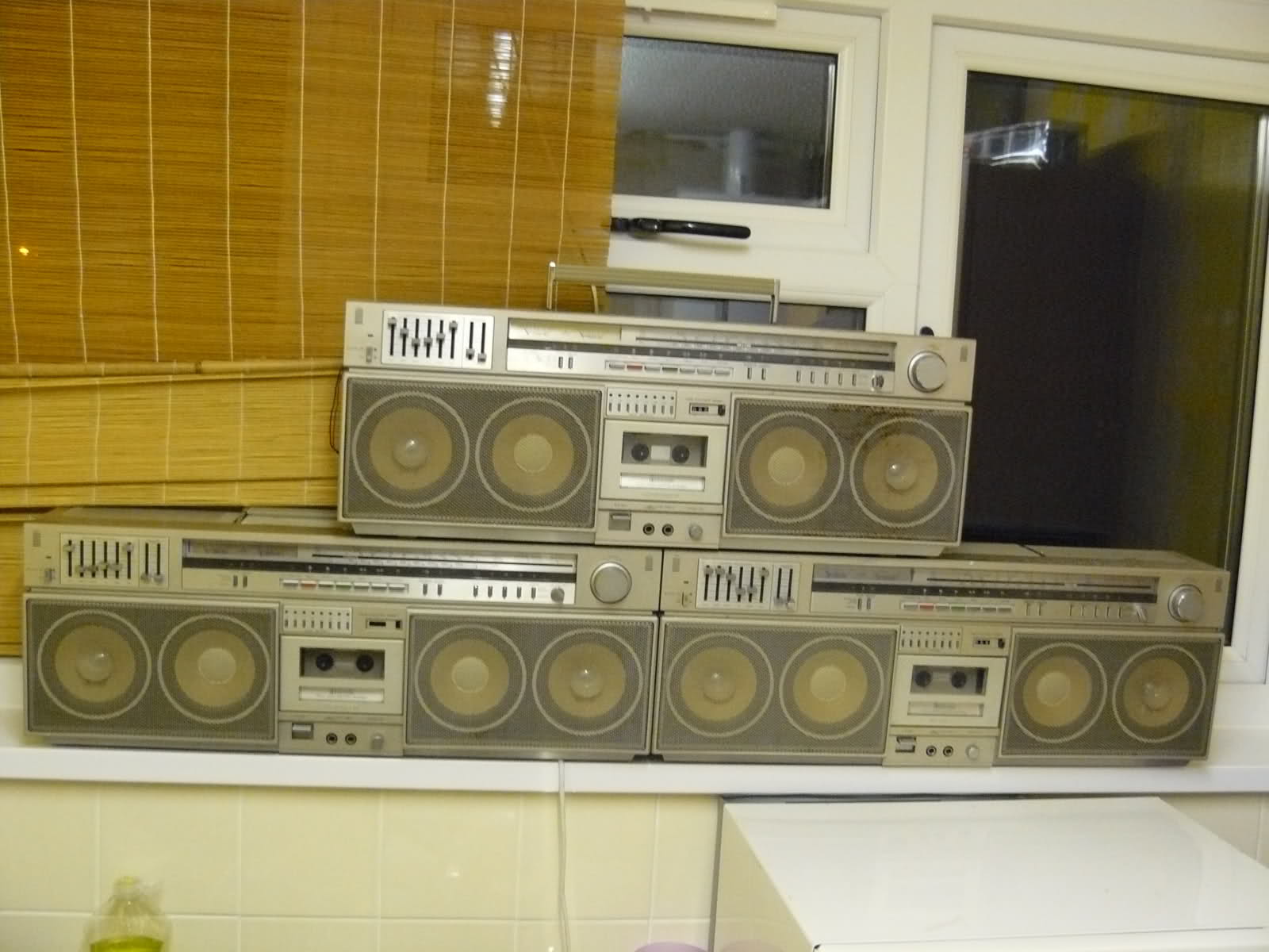

    Thats one of my old pics incase you don't see them
    welcome back mate, btw change the pinch roller, that is 100% the culprit, don't try and repair the roller because you can't dosen't matter what anybody says, good luck

  4. Ω SK-95
    Ω SK-95 Active Member
    106
    Barrie, ON, Canada
    You have these many SK-900's?? Wow!! That is amazing! Nice going!
  5. Radio Raheem
    1,953
    Aint got a clue why she don't like metal tapes tony, just change the roller job done, iv tried dosens of times to fix rollers with no succes latest one was an m90 i spent about 10 hours on the roller and still no go, she only chewed tapes at the beginning, new roller job done lad, btw there are a few of my boxes posted up think there on the main forum

  8. Brutus442
    Brutus442 Well-Known Member
    473
    Toronto

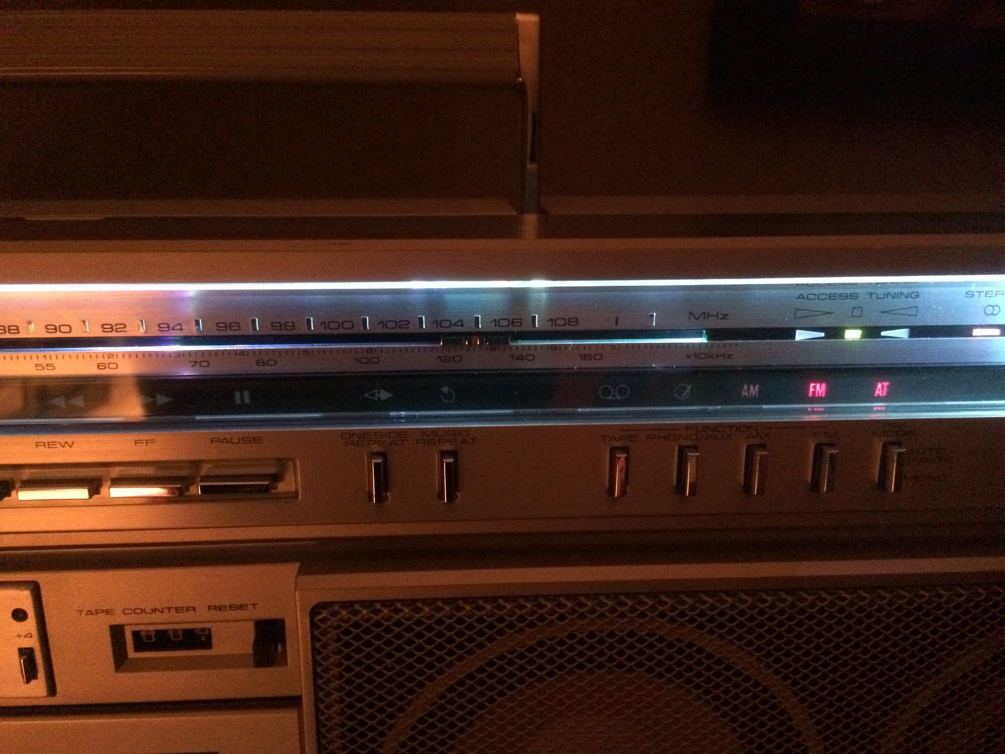

    Tony,...... beautiful 909!!!!!
    Those backlights are not original correct? If not who did the mod? It's real cool!

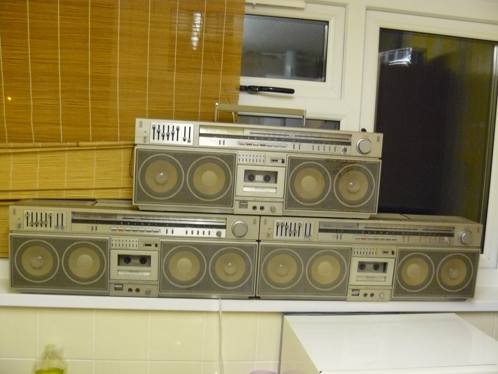

  19. Radio Raheem
    1,953
    Btw thanks for resurrecting that pic Allan those 3 pioneers look stunning, gosh were they mine lol
