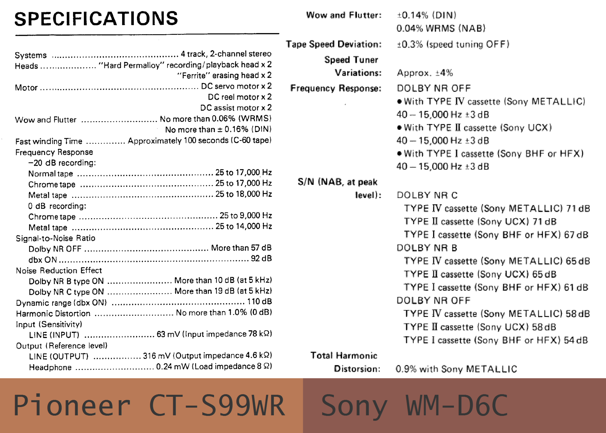

    I can't really change the bias on my deck as it is a double deck without any bias controls. So that limits what I can do with my recordings. Also my deck doesn't have HX-Pro.
    However my double deck a pioneer st-s99wr already has dbx as part of the NR's as well as Dolby B and C.
    Dolby C is a bit specific and sounds muffled on my everyday walkman my aiwa hs-pc202 mkii.
    Also dolby C when played on other walkmans like my d6c sounds muffled on the mid to high frequencies.
    The issues I have with dolby C stems from the fact that it's not all that stable on my Aiwa. I don't really need to use dolby B, the hiss only affects low frequencies.
    I did the math and have found that if I record on a normal cassette using dbx, I have a dynamic of range of 110db which is still higher then if I record using a metal cassette on a wm-d6c with dolby C.
    The only thing i don't really understand from the specs sheet when comparing them both is the pioneer's frequency response (i don't know the difference of a -20db recording and a -o db recording)

    If you can't properly adjust bias and sensitivity my suggestion is to stay away from any NR system, they will make recording's sound worse.
    With a fixed bias tape deck, you should buy only one type of tape (one model from one brand ..) and calibrate the tape deck for that specific tape. That means adjusting the internal potentiometers for bias and rec level so that the recordings are correct both in terms of frequency response and sensitivity.
    Anyway, as a general rule, if you are uncertain of bias, recording without NR system will yield a better sound.
    110 dB of dynamic range is a huge number, roughly the difference between a completely quiet room and an airplane taking off. The specification of the tape deck calls for 92 dB (which is still rather unrealistic to me) but more in line with the numbers boasted when dbx was presented in the late 70's
    That refers to the level of the recorded signal on tape; typically the frequency response is specified at -20 dB VU where the tape is far from saturation; at 0 dB (VU scale ?) you are close to the tape MOL/SOL and frequency response is much more limited. That is also more dependant on the tape rather than the deck, not sure why Pioneer included that spec.

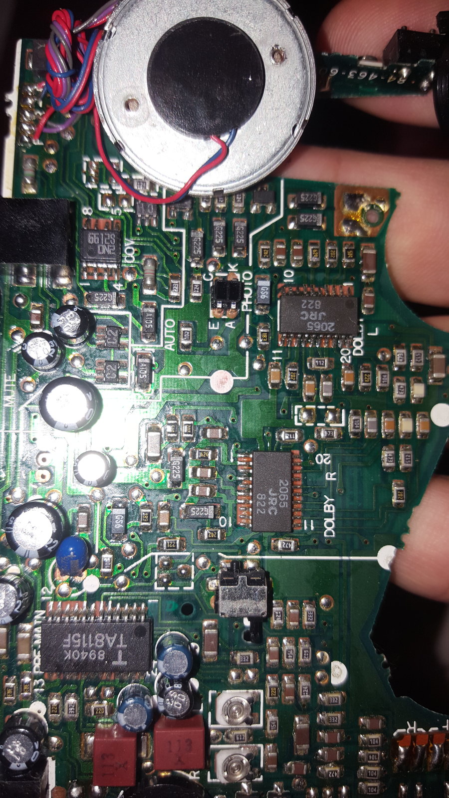

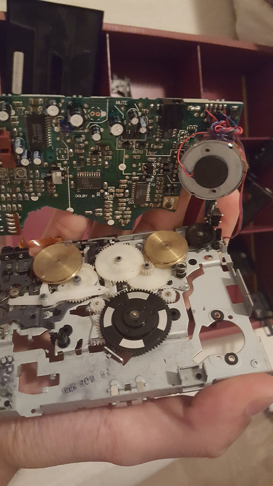

    I was testing it as well on my Aiwa, yet sadly I think it died on me; :swoon
    On the left channel there was some kind of humming that was unheard of previously.
    On the right channel, a scratchy pot that scratches at specific volumes, not randomly.
    After that it just wouldn't turn on with the batteries... I don't think the warranty covers this ;_;

    Trying to give an alcohol bath (90% denaturated alcohol) is usually what fixes 75% percent of all my electronic problems, i care too much about the aiwa to gamble on this one.
    I'll save money and once I'm down with a job and out of university I'll buy a 3 head deck (and a better dac) to blow my current deck out of the water.
    I'm thinking of either getting a Nakamichi bx-300 or a Bang & Olufsen Beocord 9000. (hopefully when I can afford those the prices will remain reasonable)
    For the meantime, I'll be spending money repairing the Aiwa.
    I'm assuming Sony repairmen can take care of Aiwa products. If so I may found one near where I Live
