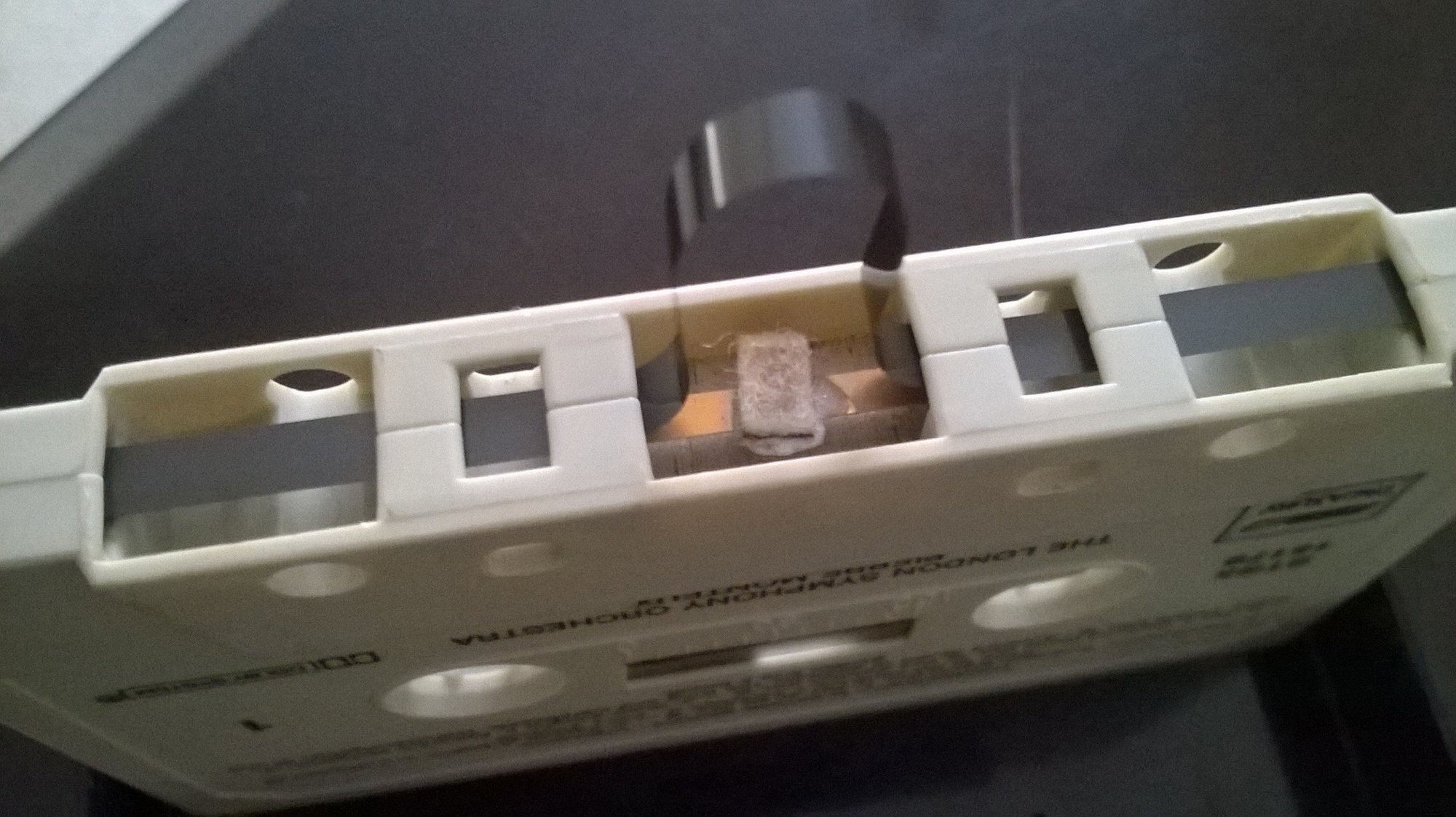

    In January 2017, after repeated and frustrating screeching during playback, I closely examined the Tchaikovsky audiotape and noticed that the pressure pad (or felt-tipped pad or whatever the part is) in the tape-heads opening was loose beneath the magnetic tape itself. I found some Gorilla Glue and, trying very hard to not get that tenaciously sticky stuff on the wrong cassette parts (or on me), I managed to put a tiny bit of the glue on the square part of the bronze-coloured steel strip that the tiny pad is originally attached to. Using tweezers, I put the pad back on the glue-touched square part of the steel strip and held the tiny pad against the steel strip's square part with something -- perhaps a Q-tip that I held -- while the Gorilla Glue dried. (That was the same day that I returned the Aiwa.) The repair attempt isn't perfect; one look shows that the felt pad isn't perfectly positioned on its squared steel base beneath the magnetic tape. One can also see bits of the since-dried glue bulging out between the pad and the pad's base along the bronze-coloured steel strip. But would that necessarily affect playback?

    February 10 , 2017 (Post-2:55 PM ET) Update:
    This AM photograph shows the tape-heads opening where the repair occurred. In this image -- with the item positioned in the upended, black rear portion of the cassette case on the desk -- the magnetic tape is pulled up, away from the felt pad/steel strip assembly to more clearly show the glue-repaired area.
    FEBRUARY 10, 2017 PHOTO' OF THE GLUE-MENDED, eBAY-PURCHASED TCHAIKOVSKY AUDIOCASSETTE.JPG
