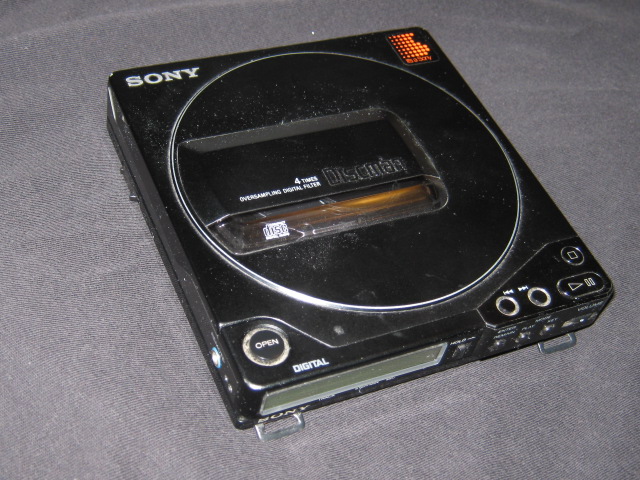

    Hello all,
    Just scored a D250 at a rummage sale. It's missing the US power cord and the battery is flat. Any suggestions before I dig up and try the 9V one from my old Nintendo?

    1,717
    9V, center pin must be negative. New batteries available from kaosuncd.com

    Midwest, US
    Thanks! I'm going to rummage through a box of adaptors to see if anything matches. Otherwise, it appears the Sony ac-940 will need to be ordered.

    Midwest, US
    Hit the thrifts today, nabbing three neg-tip 9V adaptors, two which worked.
    Good new: it powers up and spins
    Bad news: it won't read properly and display flickers to disc speed

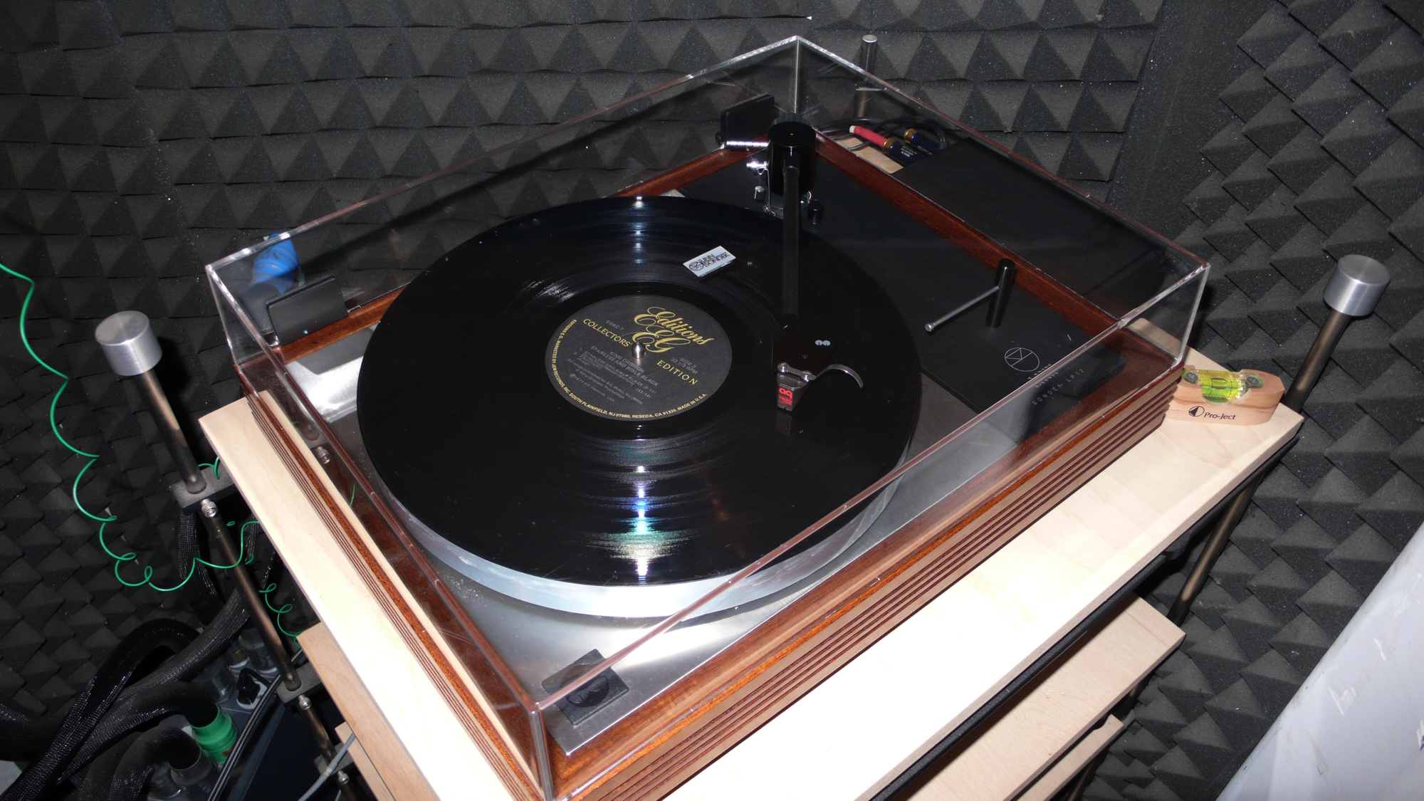

    Plex is next to impossible to catch on photo, unless it is nicely "aged" under a layer of dust ;)
    once dusted, there is not much to see:
    About "how to": whatever you do, do Not use Dremel! At least in my hands it made more damage than polishing. Also, talking to a professional about polishing plex edges I've learned about the flame-torch technique... Thanks God, my Boss was not at home when I tried that tip! :eek:

    1,717
    You need a torch (evidently;)) and then make QUICK passes over the cut and pre-sanded edge... Very-extremely-simple, ha-ha!!! If you are too quick, nothing happens, if thorough then plex bubbles and you need to cut again. If you are like me, you will stick with sanding and polishing pastes, after a lot of cursing and extinguishing a few minor fires o_O
