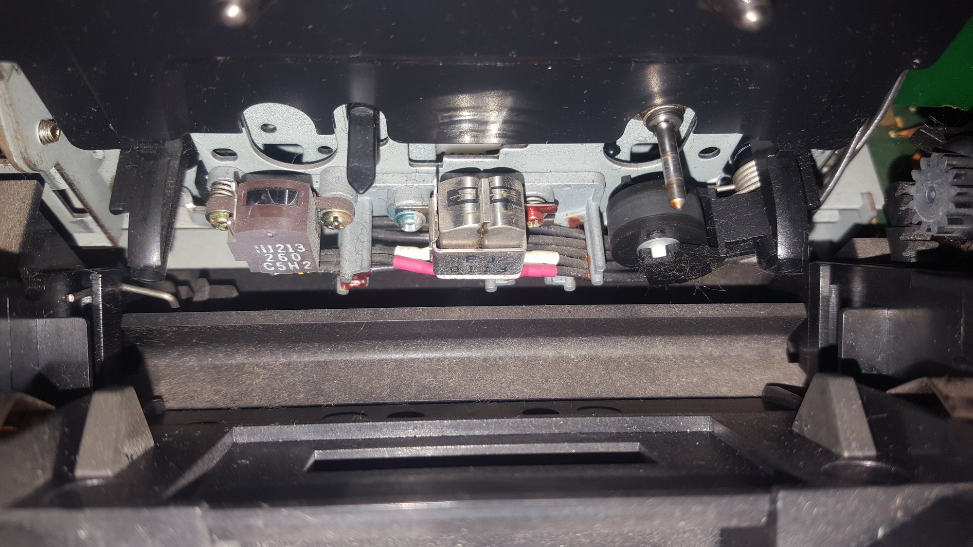

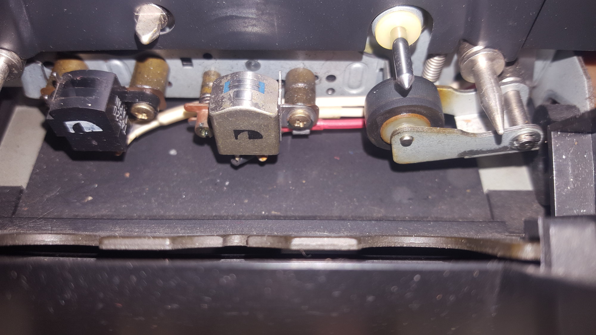

    Here is something to note @Michelle Knight if you are buying your deck online.
    The declared specifications will vary greatly from the actual product.
    See for example tthe Teac v-1030:
    On paper, it outperforms the Nakamichi in every way.
    But looking at the heads of the teac and the nakamichi, you can already tell which one has been taken care of by the owner.
    While the teac works, it sounded absolutely horrible. The nakamichi doesn't seem to work, the FW and RW don't work, it plays for a couple seconds then stops.
    But all these defects allowed me to lower the price, I got it for 40 euros. I just need to either repair it myself or find a repairmen, coupling the additional costs to repair it still is cheaper then if I bought it untested from E-bay.
