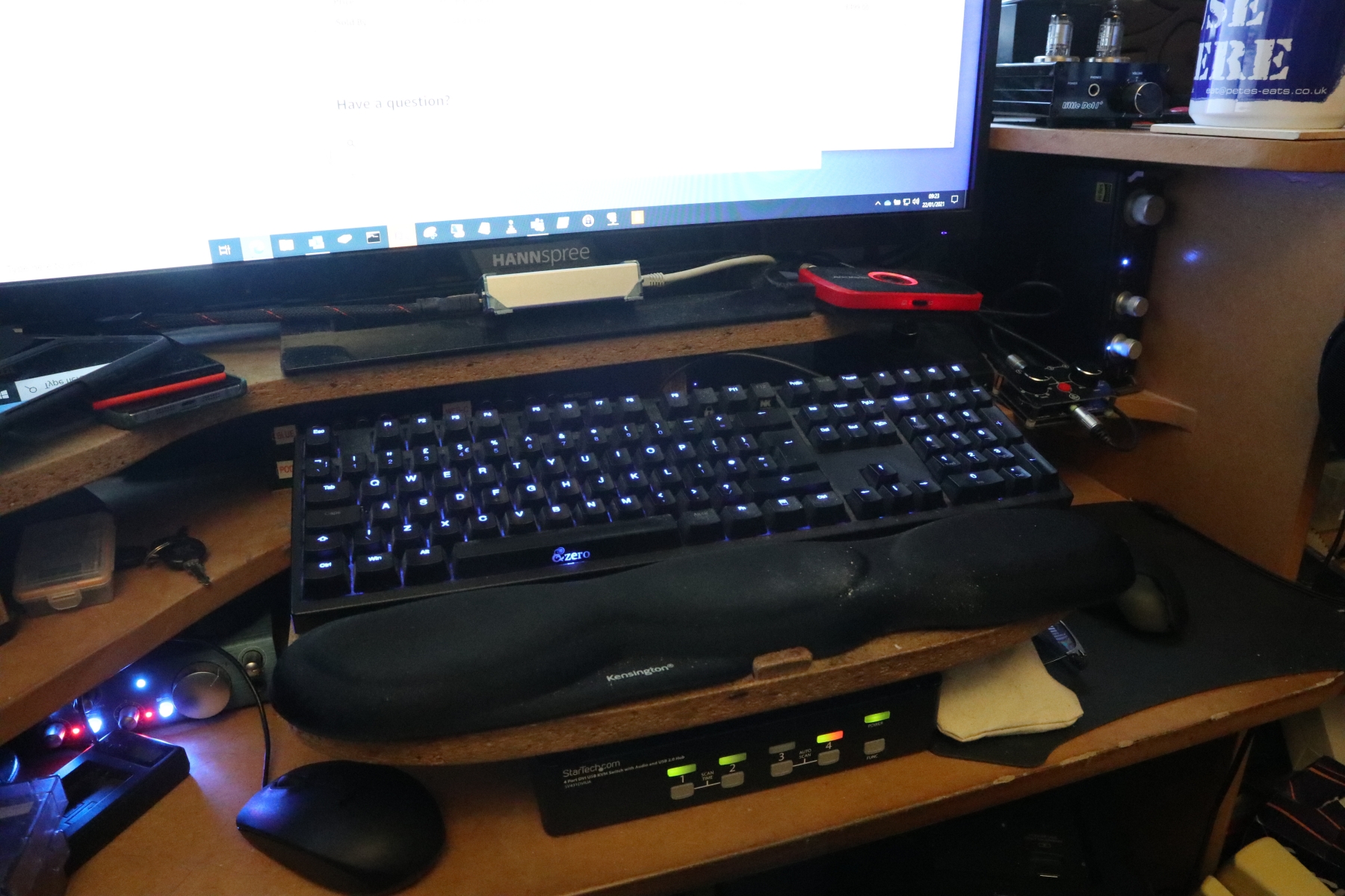

    As you can see from the picture, the Teac is nicely tucked away to the right of the red HDMI stream recorder, and there isn't much space left to put a more usual sized amp. It's just that it's a central piece to the set up... all the audio goes through it... so I can't take it out of the loop while I tinker.

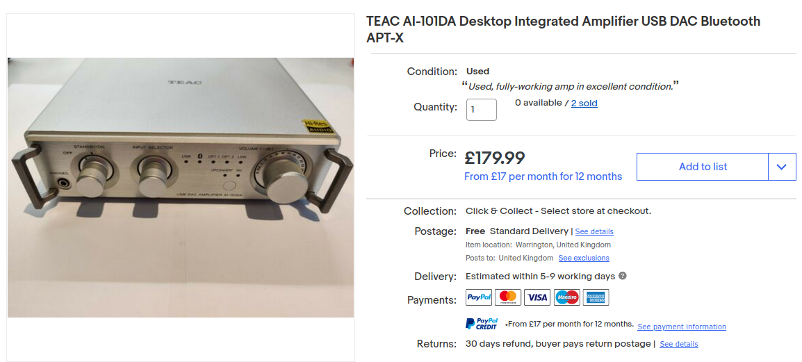

    Getting another one wasn't easy, but I saw this at a reasonable price with a seller with a reasonable amount of good reputation, so I've taken a chance. And Jorge, it's all surgical steel to boot :) ... The volume problem was a well known one with these units apparently, which is why I do have a certain amount of trepidation with buying another one of the same unit.

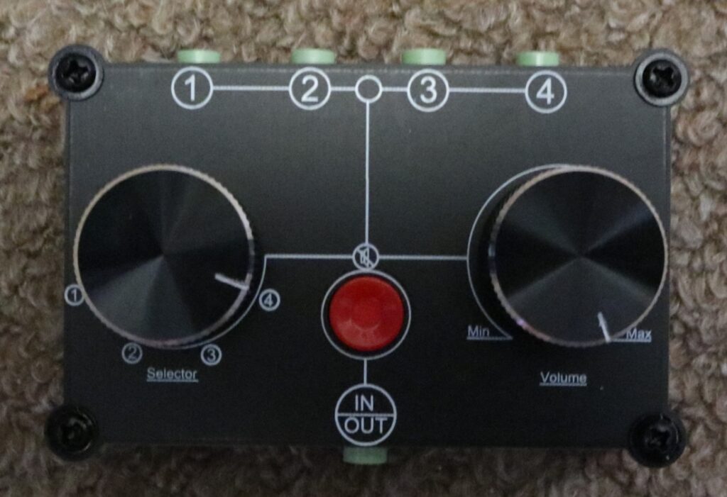

    I do have a Panasonic bbox (RX-C45) which has line in and can drive speakers (sort-of) but I'd never considered using it behind the monitor. I'll have to think about that. Particularly possibly in conjunction with a rather neat little stereo jack switcher I found on e-bay which has a mute and variable resistor. Good thinking.

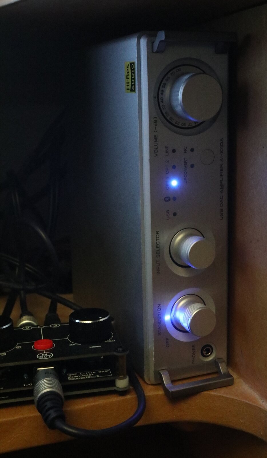

    OK - so the silver one is here and installed. I tracked down my conversation with Teac in 2019 and the correspondence actually happened with a German company called Aqipa. They referred me to Servicecare also potentially known at Sontec Electronics. Or maybe it was Sontec that referred me to Aqipa ... it all got very messy and I can't easily track who I was actually talking to at any particular point. So, I sent another correspondence to ServiceCare via their web site, and I'll wait to see what they come back with, before risking taking the old unit apart and giving the volume control some TLC.
