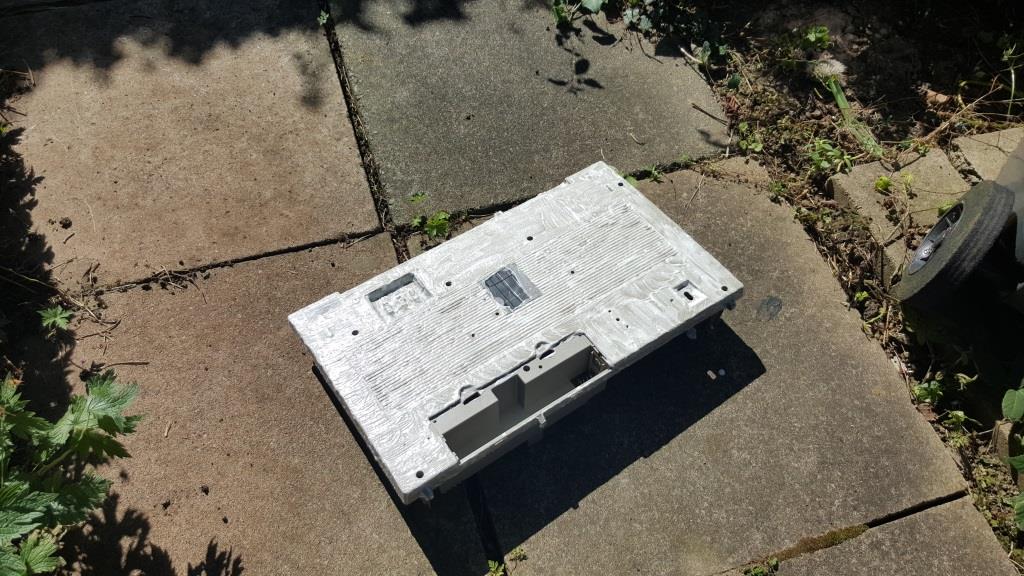

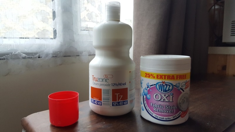

    I have to agree the results are amazing, I have used peroxide creme (12%) mixed with a small amount of oxy stain remove. Any areas that may be damaged by the solution i.e. labels, printed lettering and chrome plated areas etc, must be masked with waterproof tape don't use masking tape.

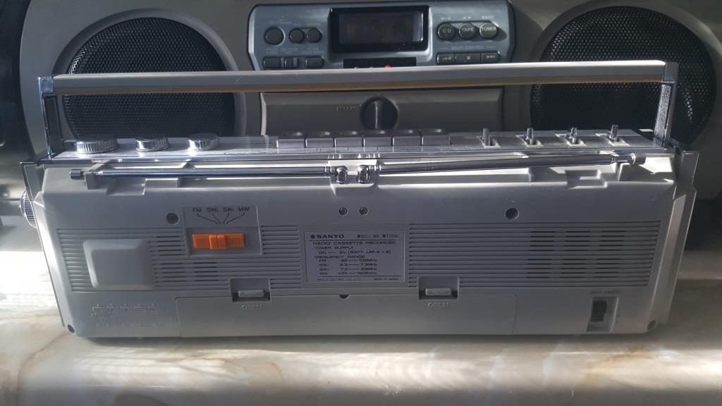

    Sanyo M7750K

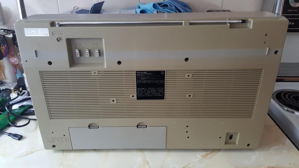

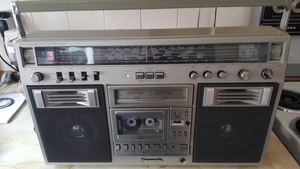

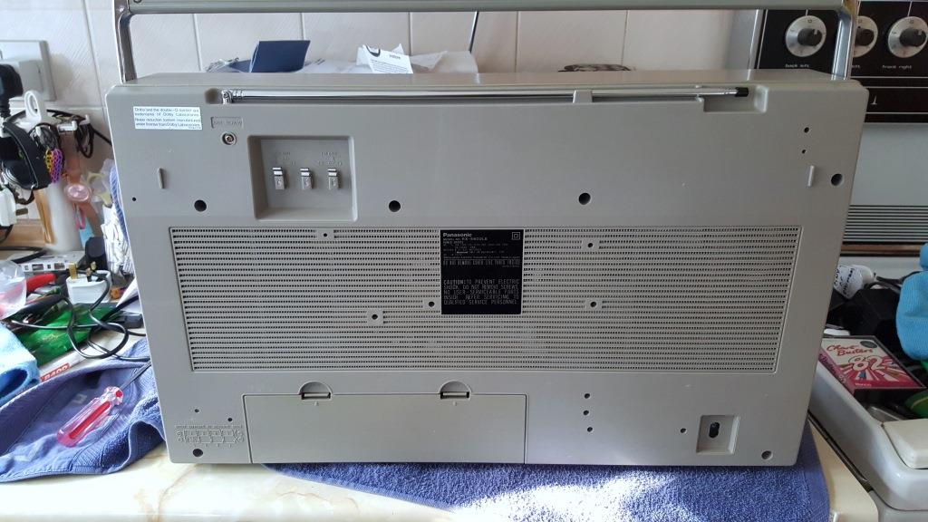

    My very nice Panasonic RX-5600 spoilt by a discoloured back:

    Here's what I use to make the whitening solution:
    Anything similar should work, I use the small red lid which holds about 75 ml and stir in half a teaspoon of the OXI powder (this is granules I crush it into a powder), this was enough to treat the back of the RX-5600, one application was enough it took about 45 minutes in bright sunlight to work.
    Sunlight is the key the reaction will only happen with plenty of UV light, you could use a UV lamp indoors but I haven't tried this. I apply it with a suitably sized brush, it will destroy most brushes after several uses.
    My advice is to experiment on some scrap or unwanted items before trying it anything in your collection.
    I have done a lot of tests on various types of plastic, it works best on the types of plastic boombox backs are made from, it is only really suitable for white or grey. I have tried it on different colours of plastic that have yellowed i.e. blue that has turned greenish and pink that has turned orange, while it did remove some of the discolouration it also bleached out some the original colour and often left streaks.
    Also it wasn't very successful on high gloss plastics, this might be because some of them although not painted as such may of had a clear top coat protecting the plastic beneath. This will also not work on most clear plastic, it may well help reduce some cloudiness but can only work on the surface, and clear plastic will in most cases be discoloured all the way through.
    A warning the solution is quite corrosive and will cause skin irritation, you should wear rubber gloves and some kind of eye protection, it will also remove plastic chrome plating, decals and damage aluminium, so anything like this that can't be removed mask it well with waterproof tape. Once you think you have the required result wash the plastic carefully with warm soapy water.
    I have also found that the solution is only good for a maximum of 2 hours after you have mixed the OXI in once it starts to become watery it's effectiveness is greatly reduced.
    Hope this helps anyone interested in trying this.
