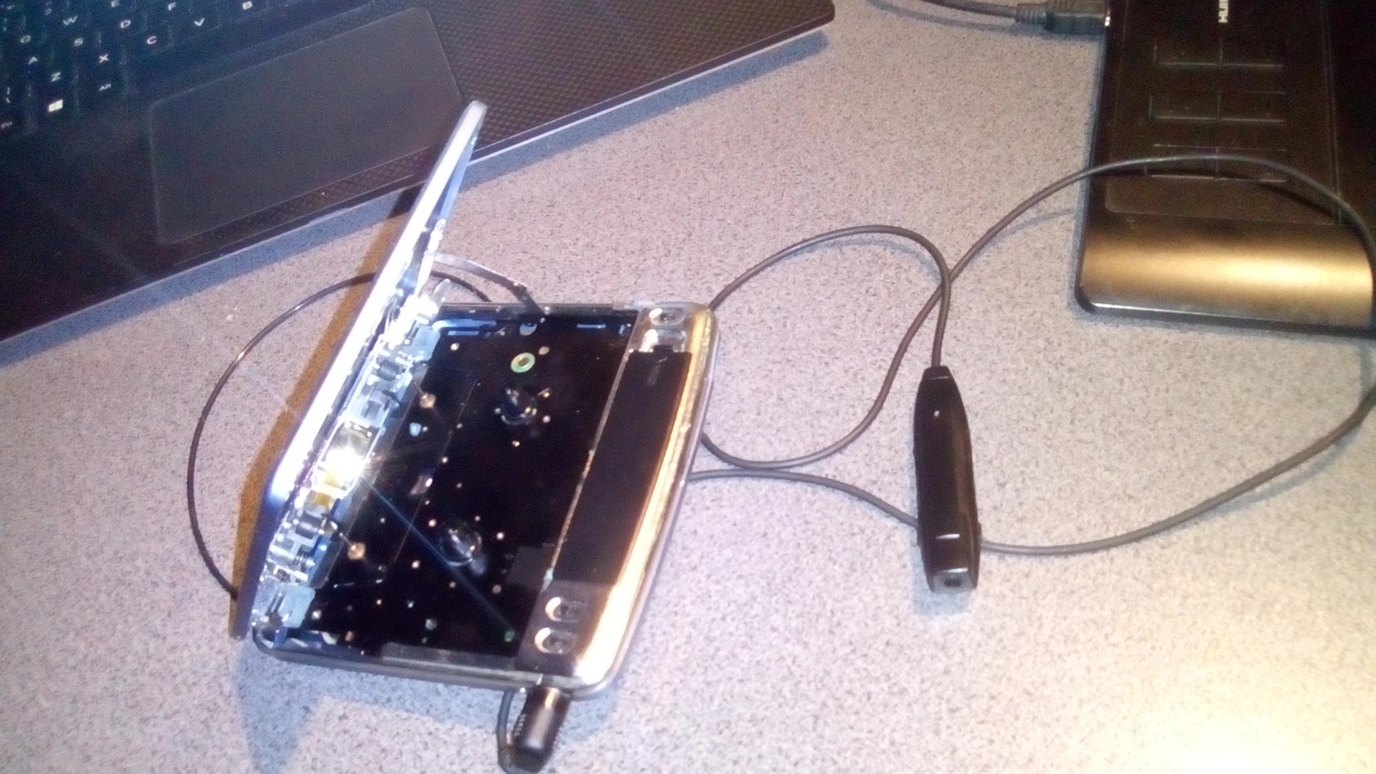

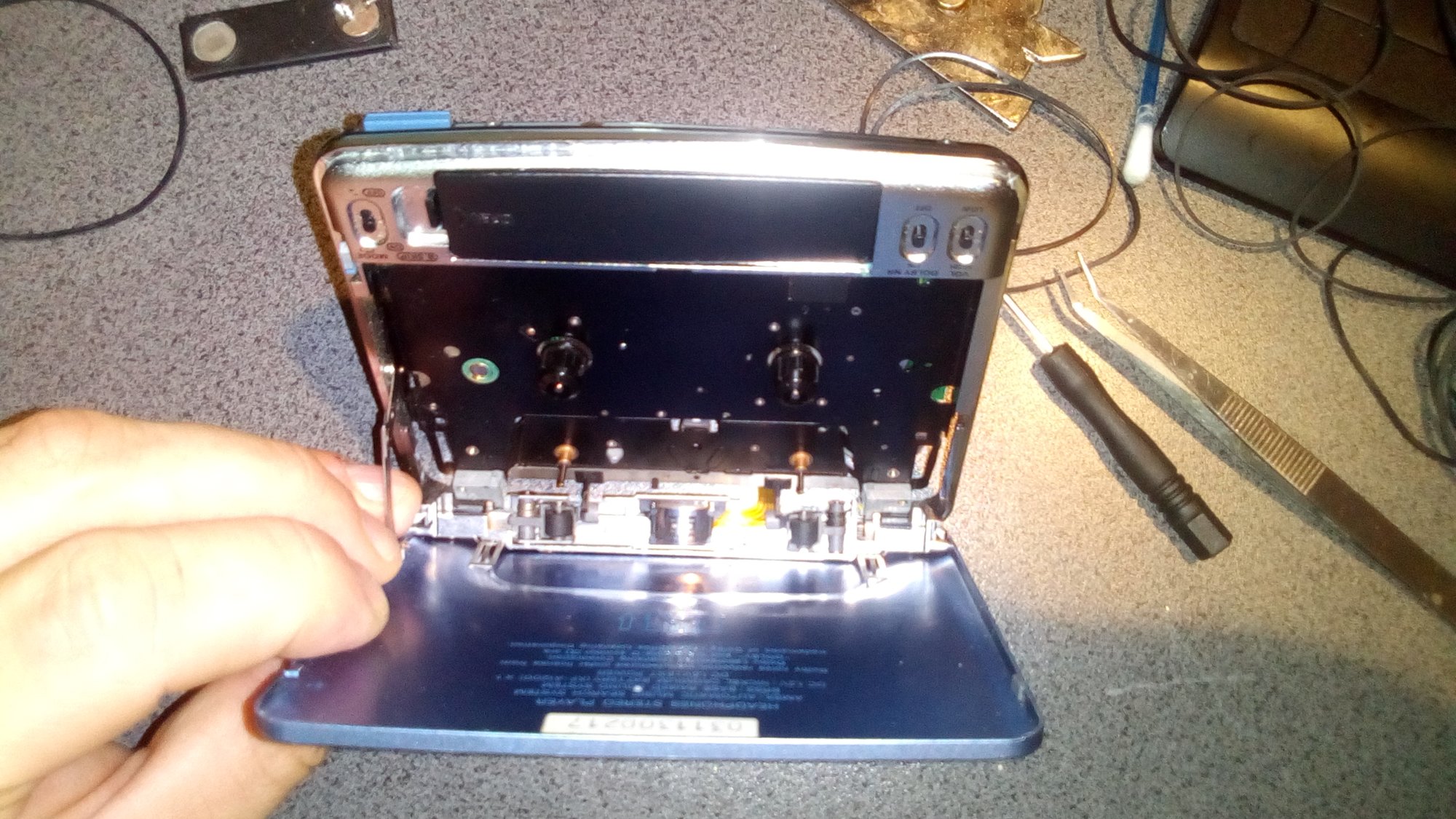

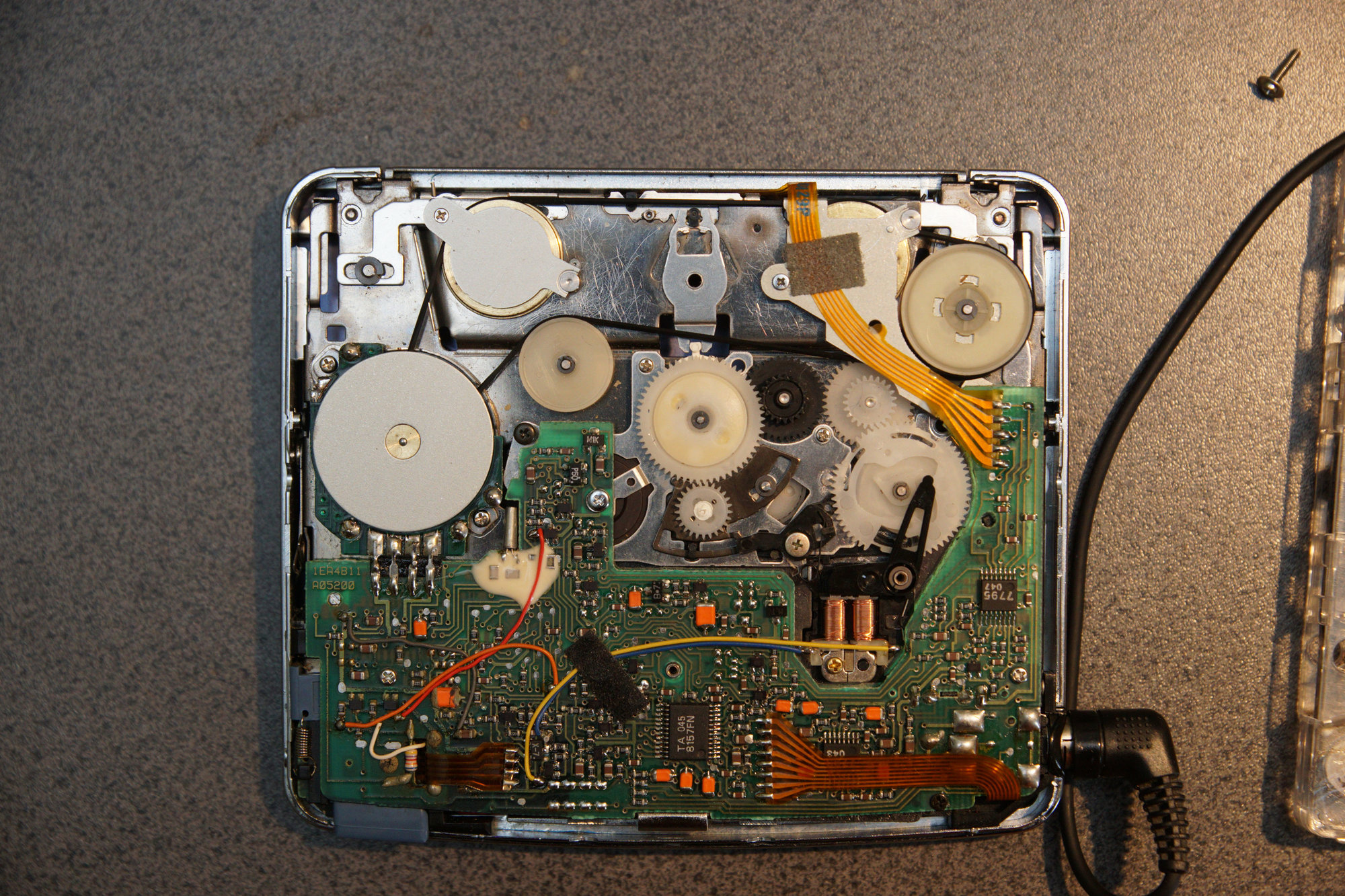

    So, a bunch of drive belts arrived from the 'bay in the post today...I tried over a couple of hours to put one, or two, in place, with little success.
    Seems the bands are the right profile, square/diamond. They're of the right assortment of lengths. They just won't go in!
    Clearly, I'm a noob.
    Well, they will go in, but the motor spins up though it doesn't have enough torque to drive the belt round/there's too much friction along the way.
    Without the band in place, there is plenty of frictionless spinning in the drivetrain.
    I've worked out the way the pinch-rollers rotate; I've kinda realised a pully wheel for the pinch-roller on one side, very clearly contacts the other side of a pully for a plastic wheel for the belt, as this drives the take-up spindle in the correct direction.
    As I can't seem to get the belt in place without a quantity of friction restricting the motor fully turning, I thought it best to ask advice here: Pictures inclded
    I'm guessing someone has some knowledge, even if it's a rather unusual walkman.
    Please, may I indulge you?
    Kind thanks...

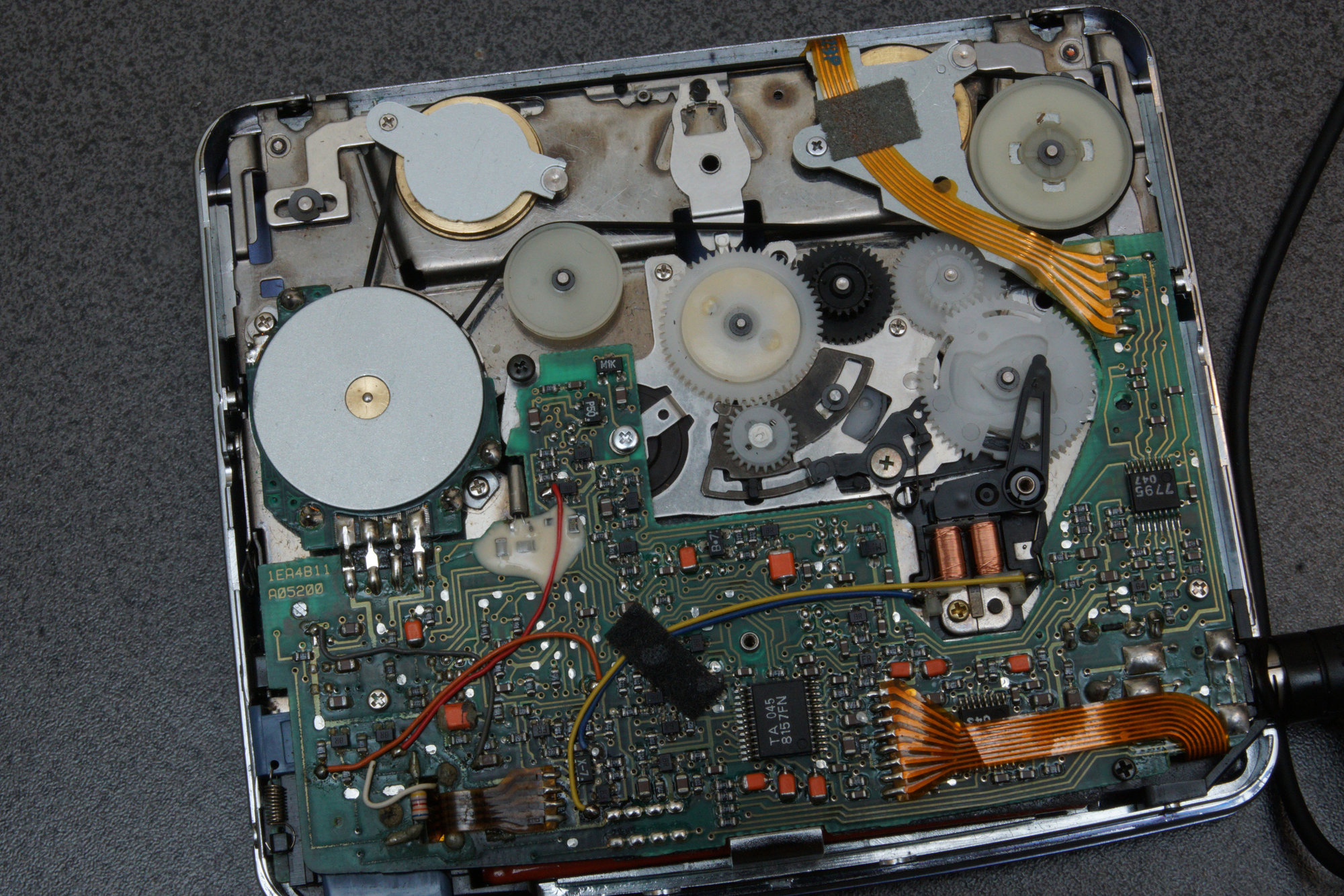

    Well, I picked up a working WM-EX194 in a charity shoppe for a fiver. Sat in my place for a week, then musing it would be a source of a belt perhaps, I just got to it...
    It fits! The belt fits, however, it's still a bit grouchy and won't properly play a tap when loaded, yet will engage both ways when dummied on the sensors in the bay.
    So, with the pics below, could people chip in and tell me if I've got the belt loaded correctly?
    Kind thanks.

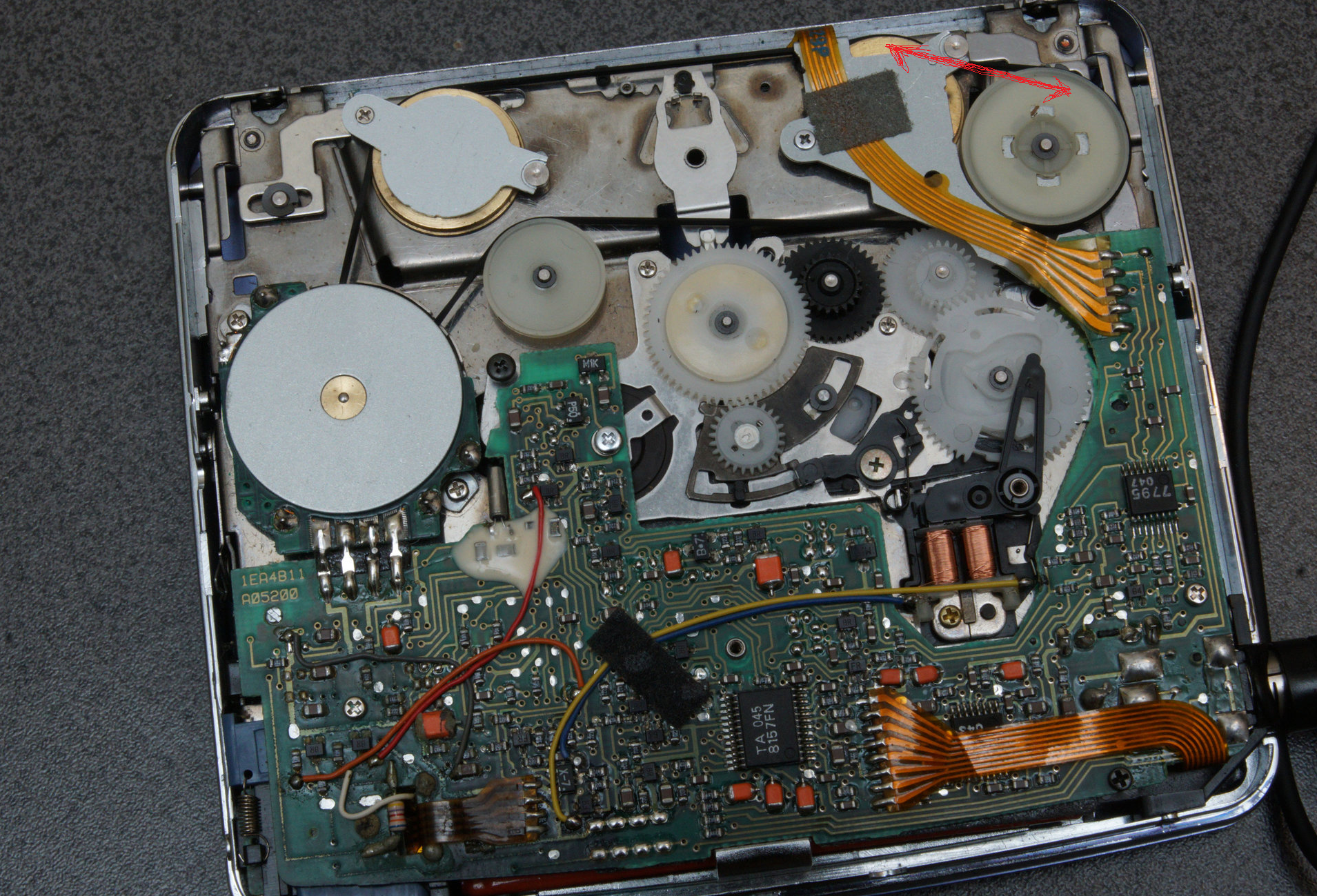

    I am not sure if you placed the belt correctly. I marked the photo where i think might not be correct with a red arrow.
    I do not have this walkman otherwise would open it to guide you but i am sure expert members can help you. What i see from the picture i have never seen a belt to be placed the way you put it.
