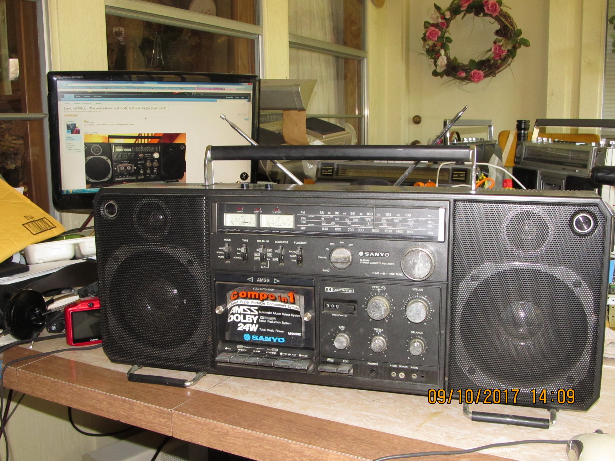

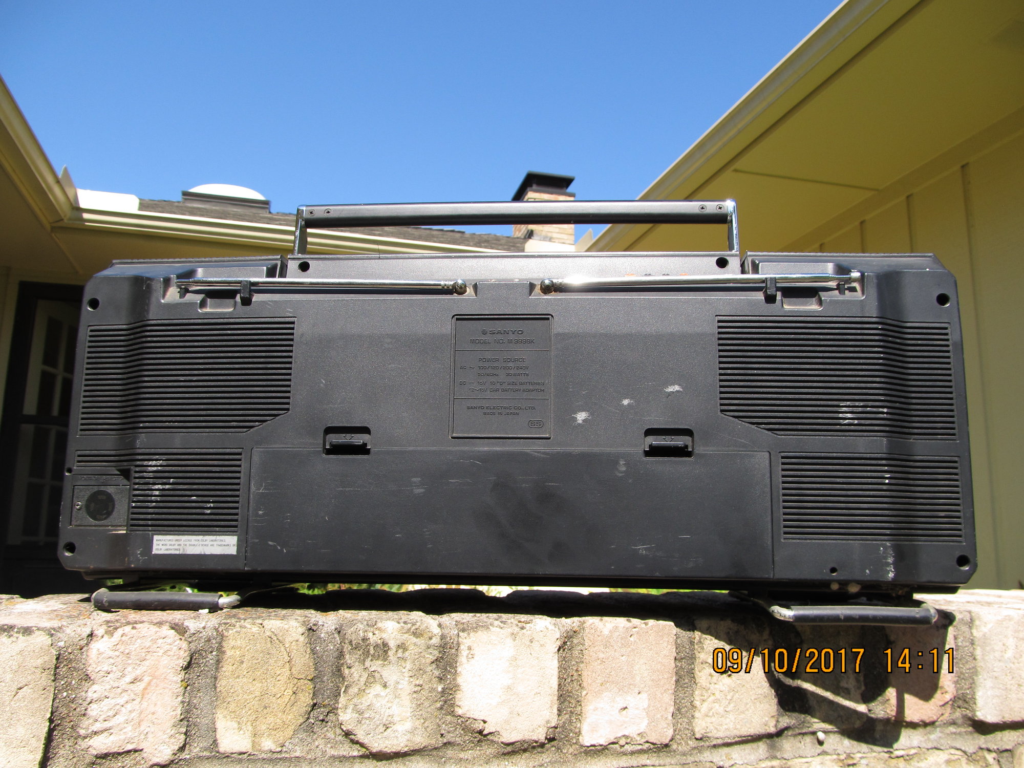

  12. Cassette2go
    Cassette2go Active Member
    166
    I have the K model but this is on my back-log of box's to repair, sharing 2 pictures.
    Someday I will re-belt this and then sell it.
