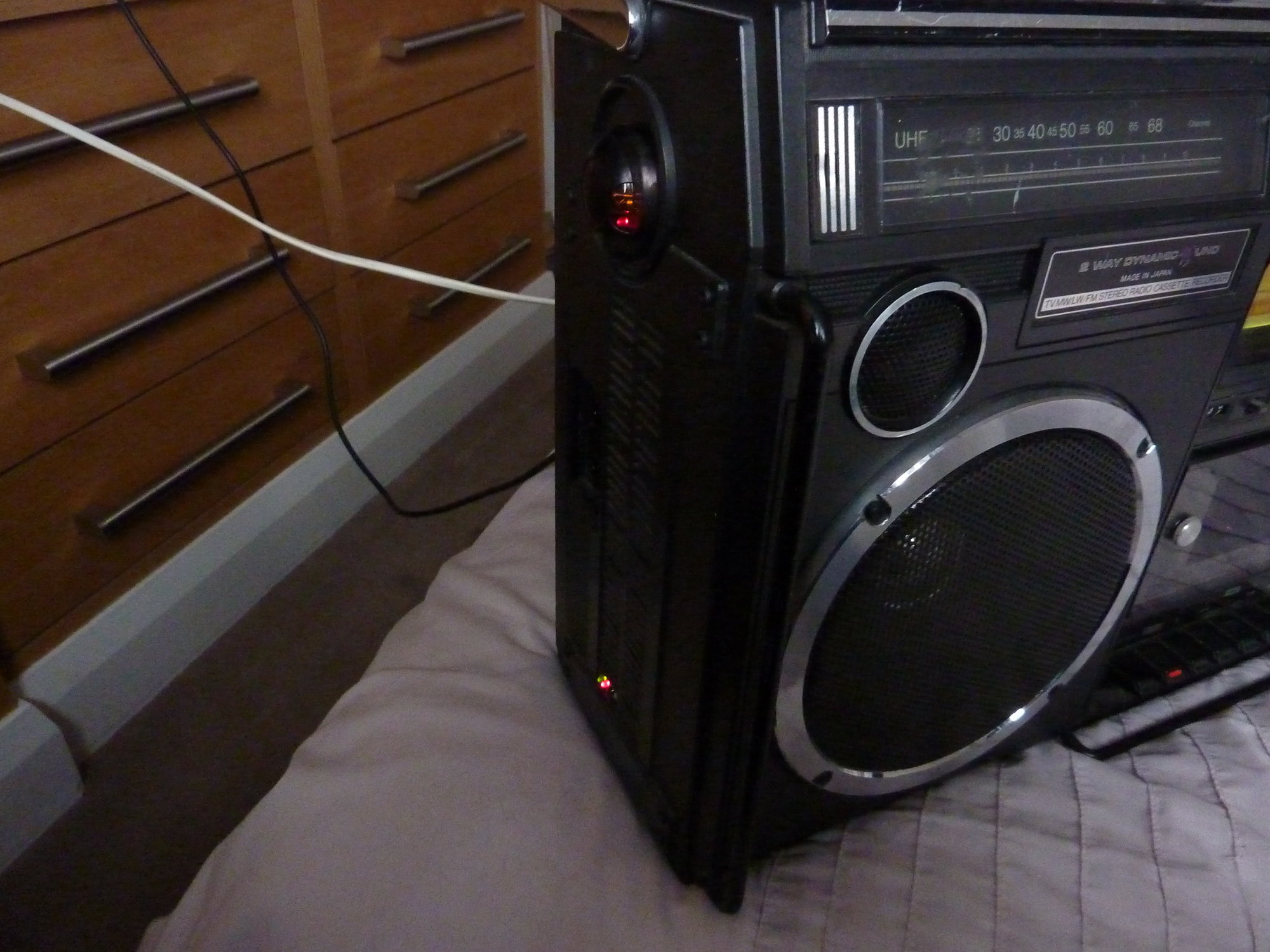

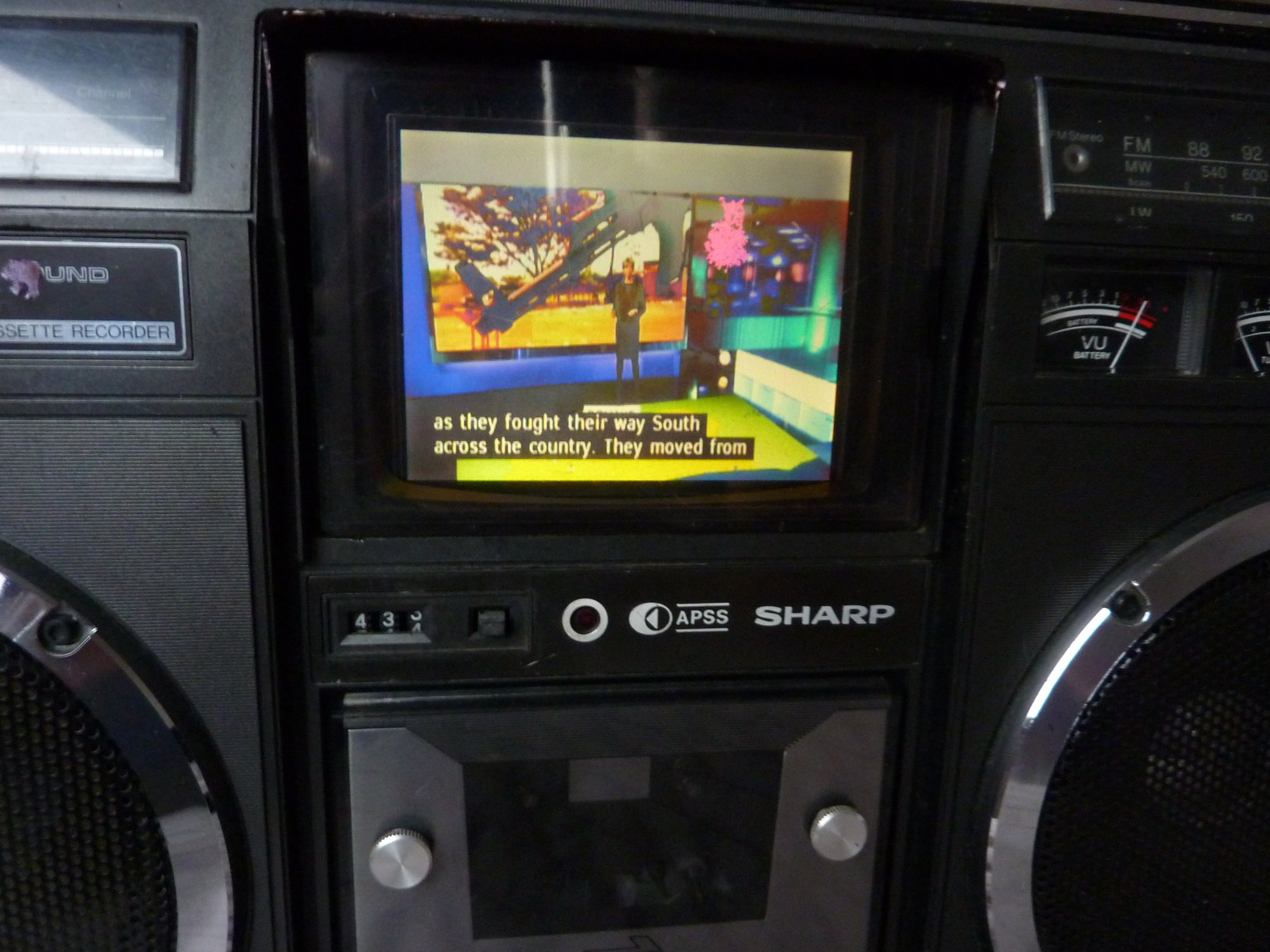

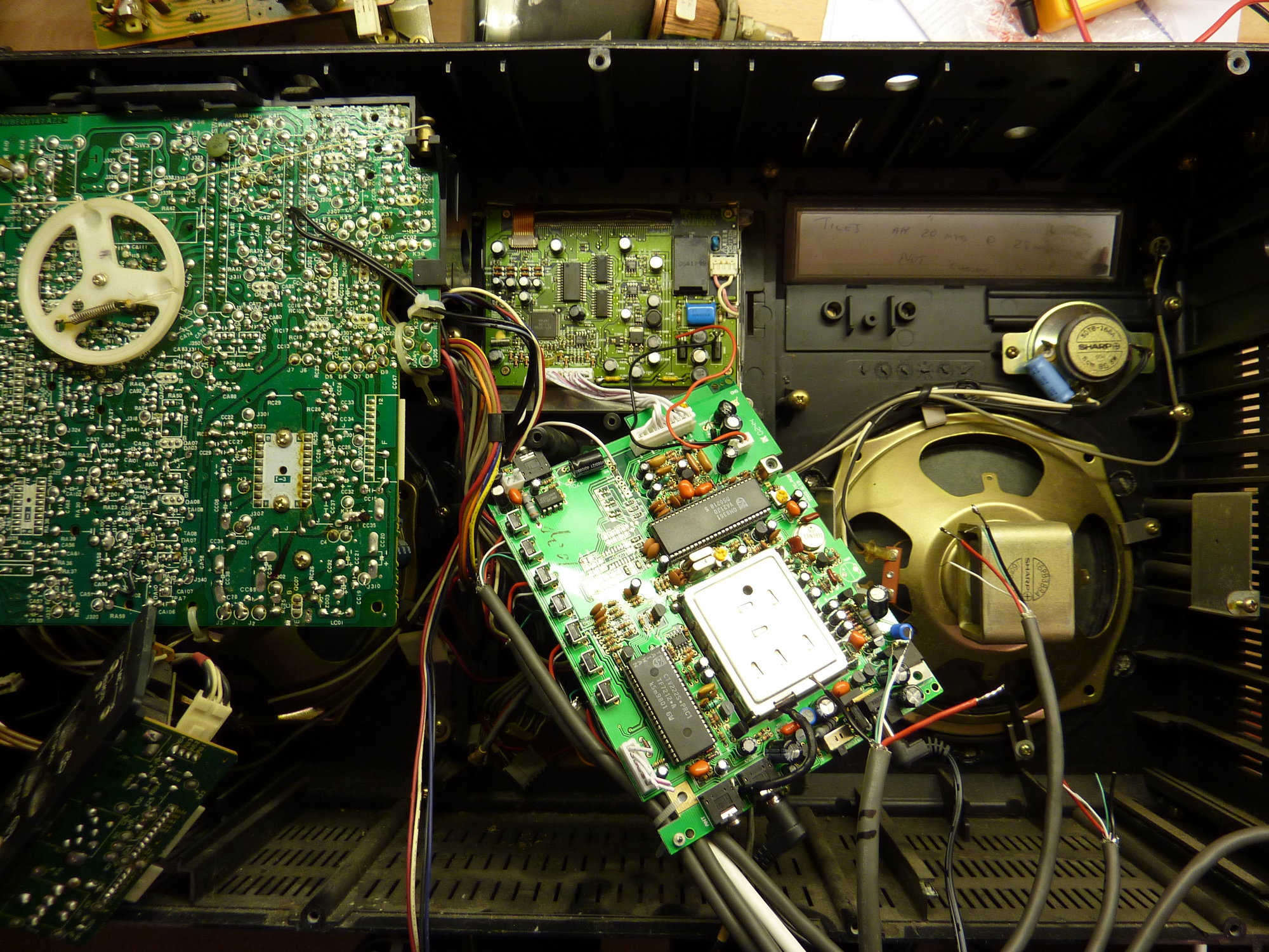

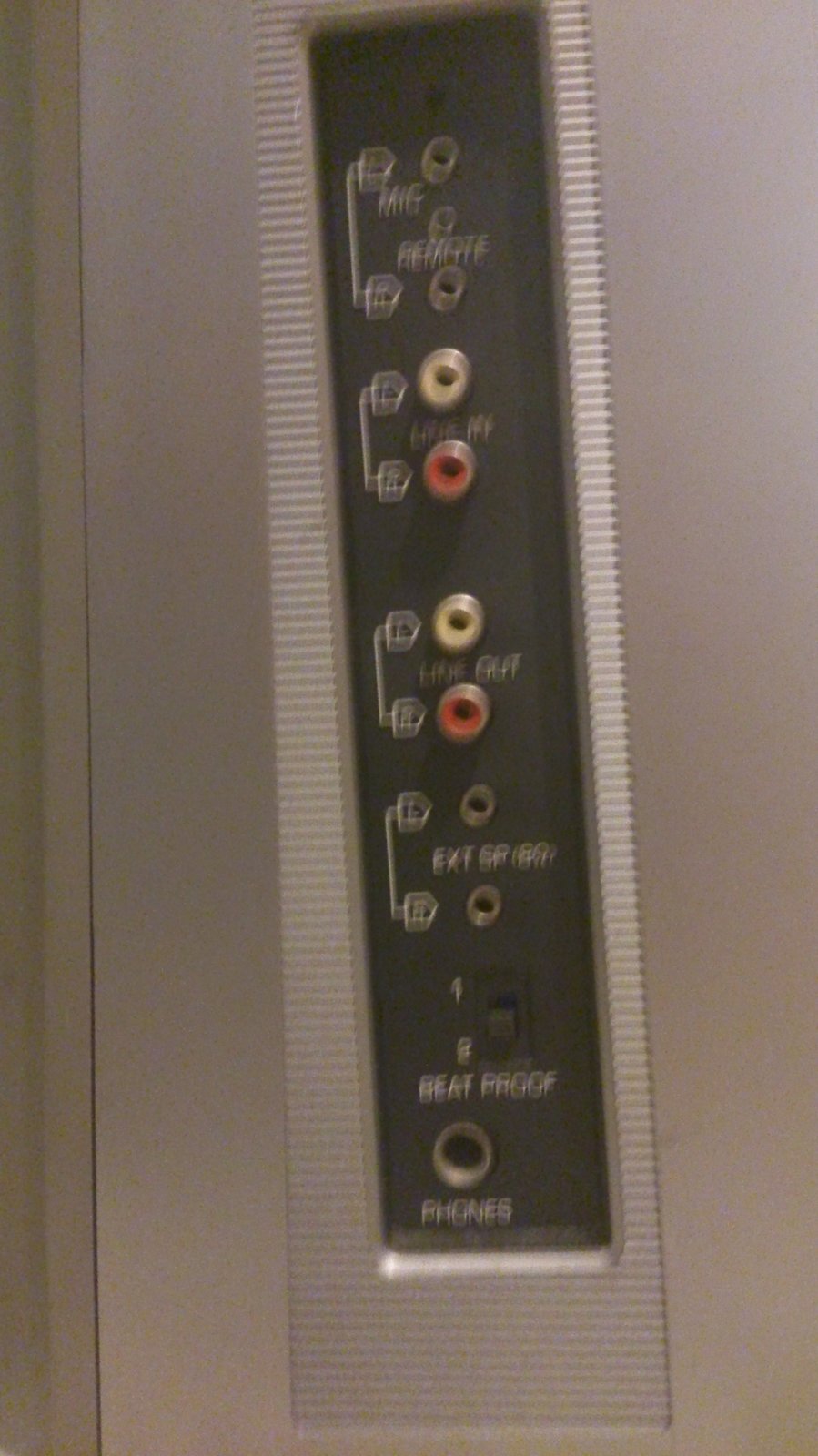

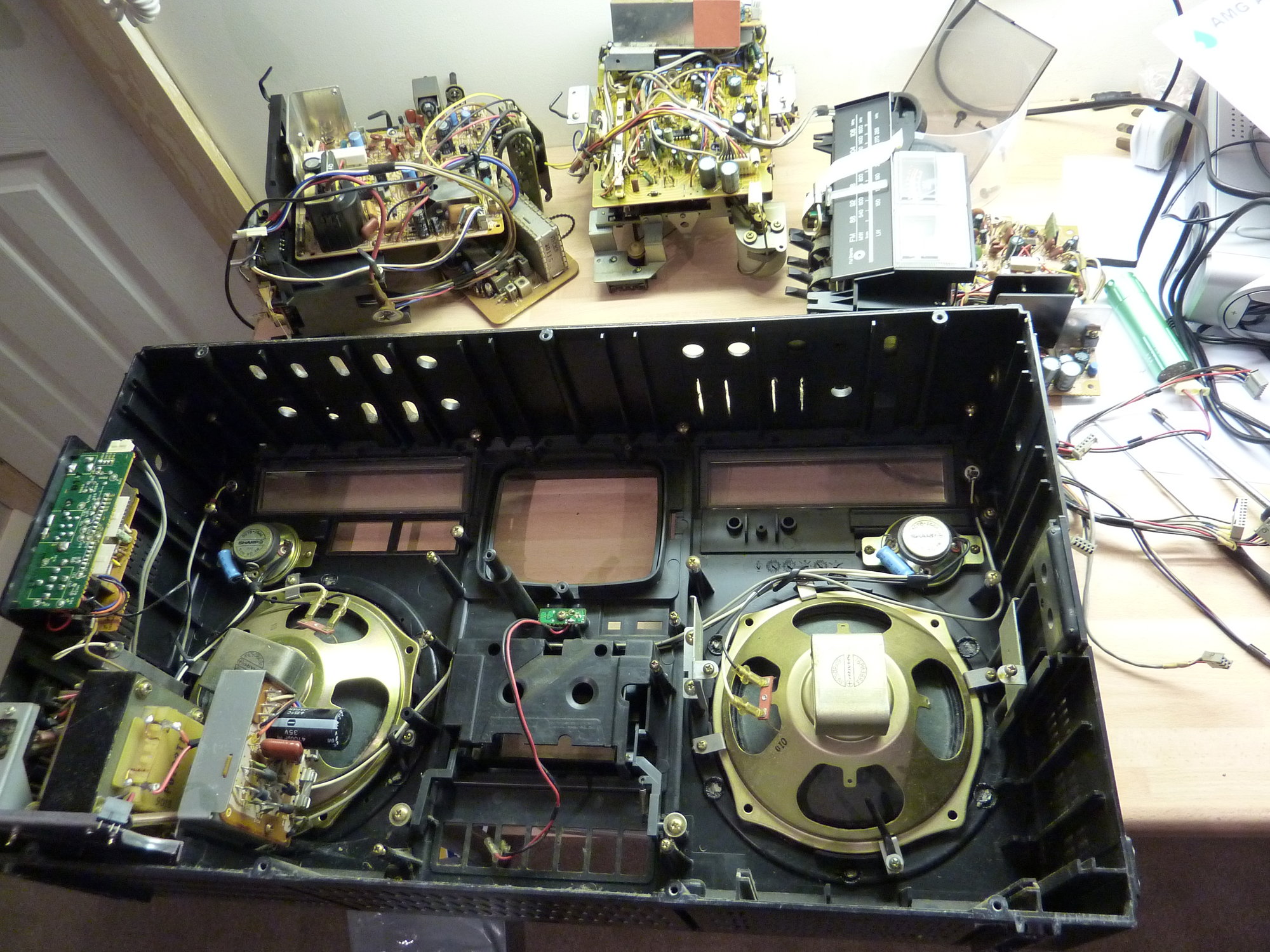

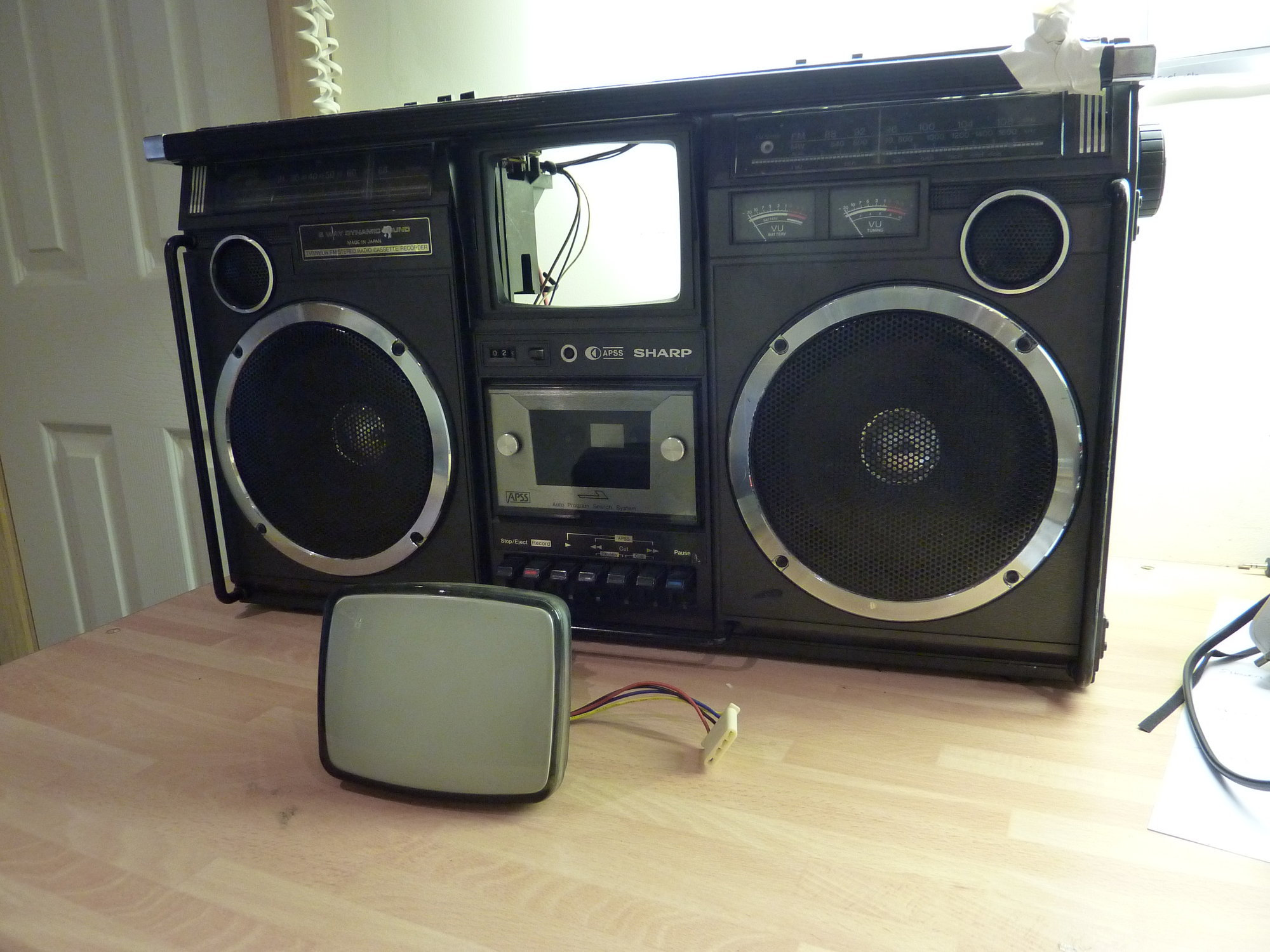

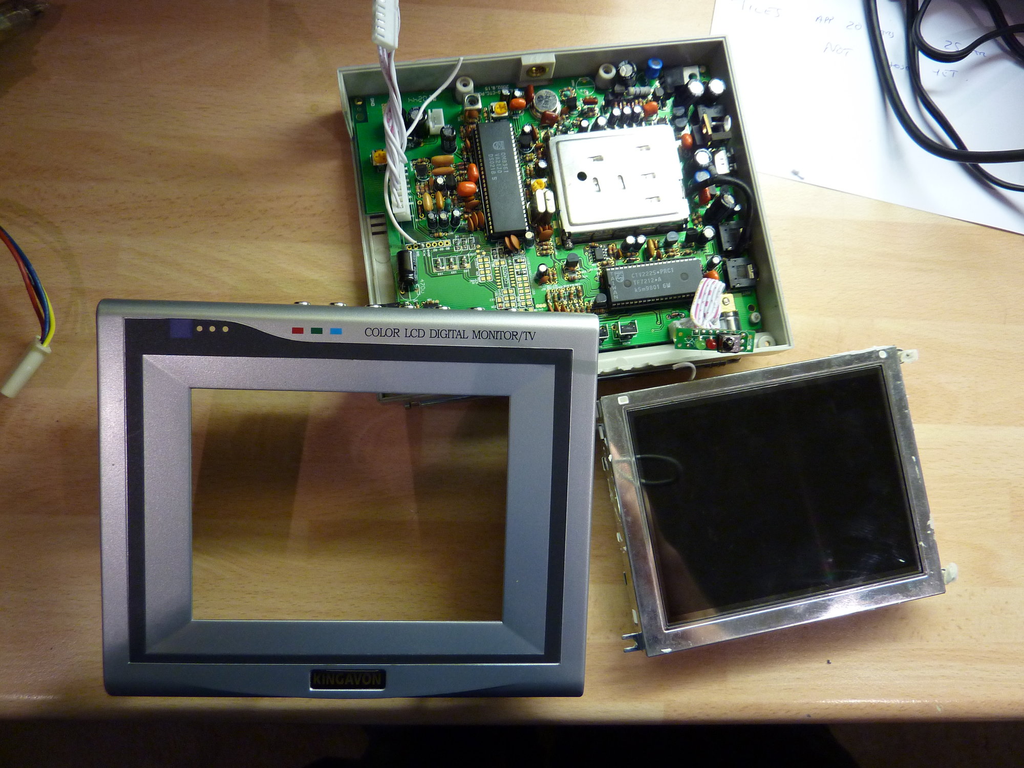

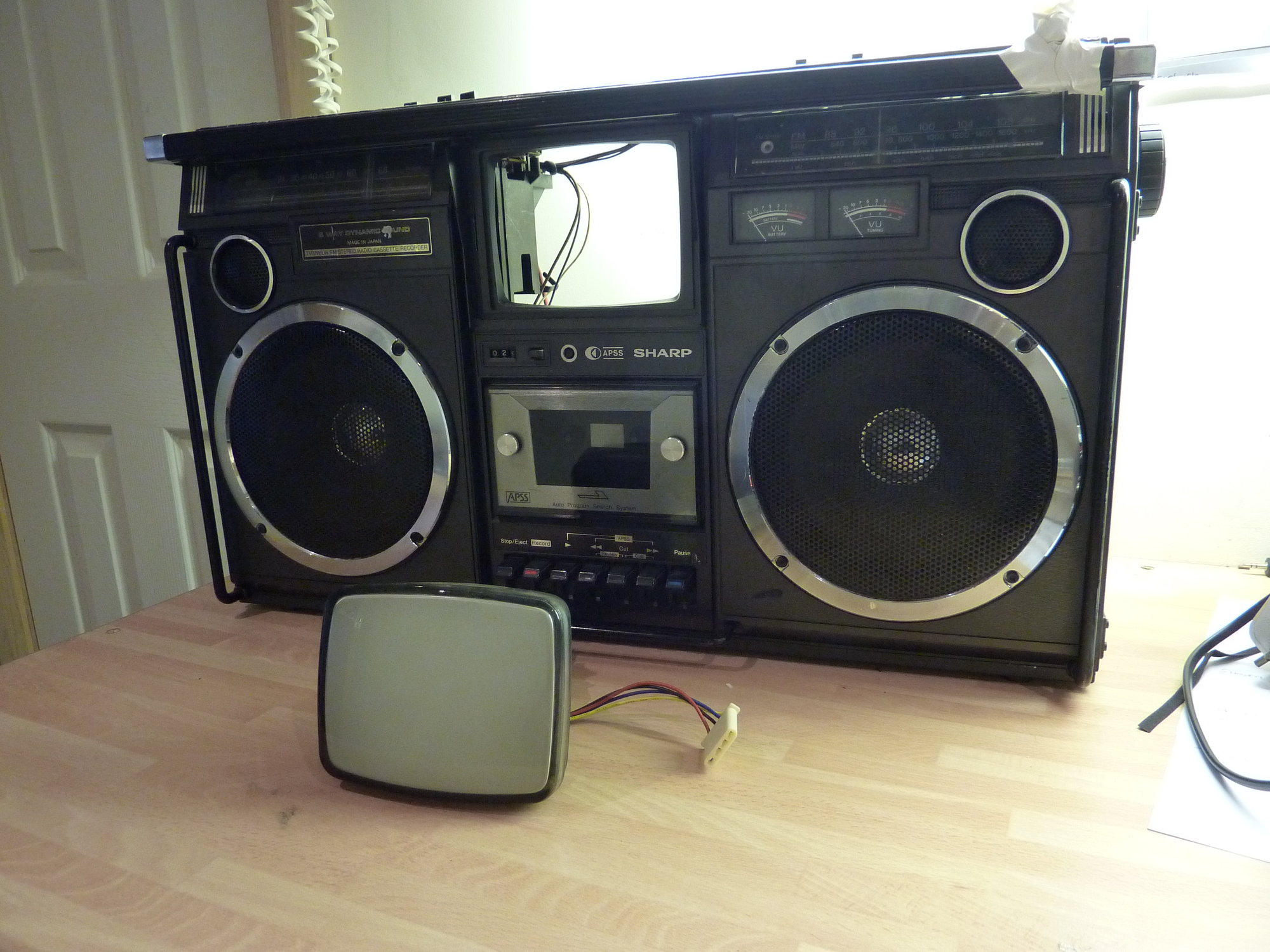

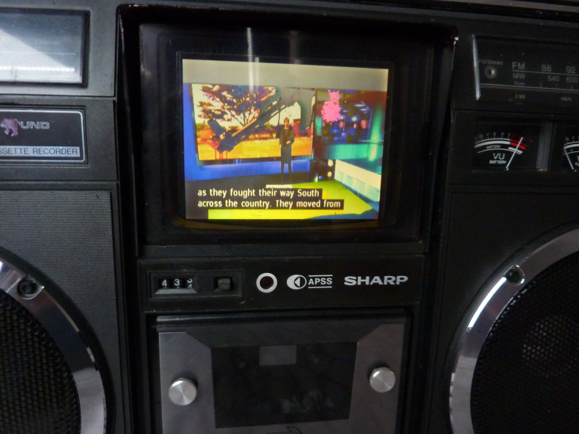

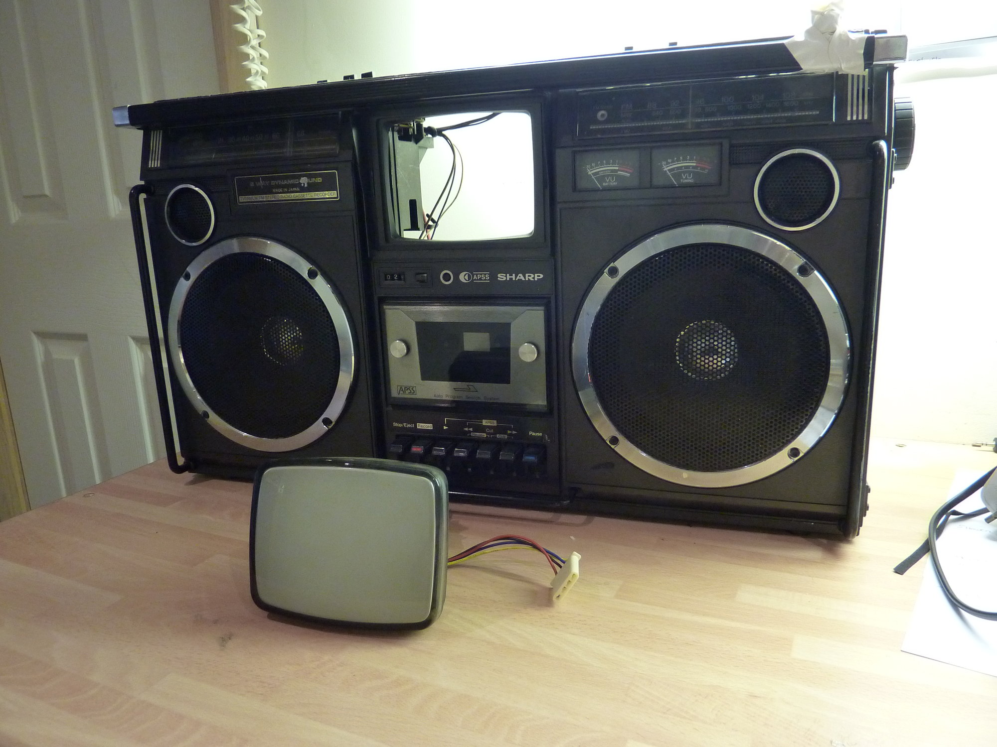

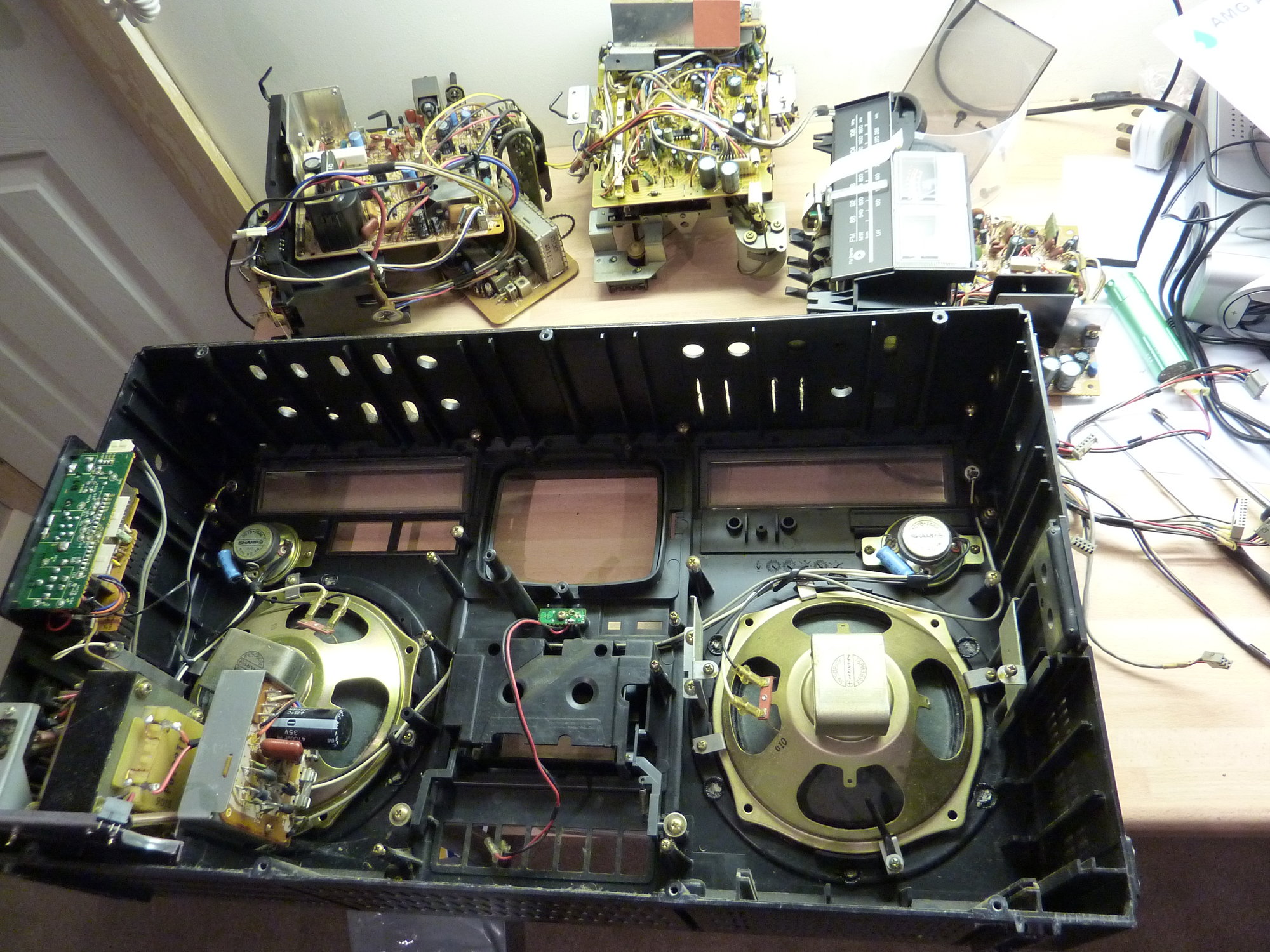

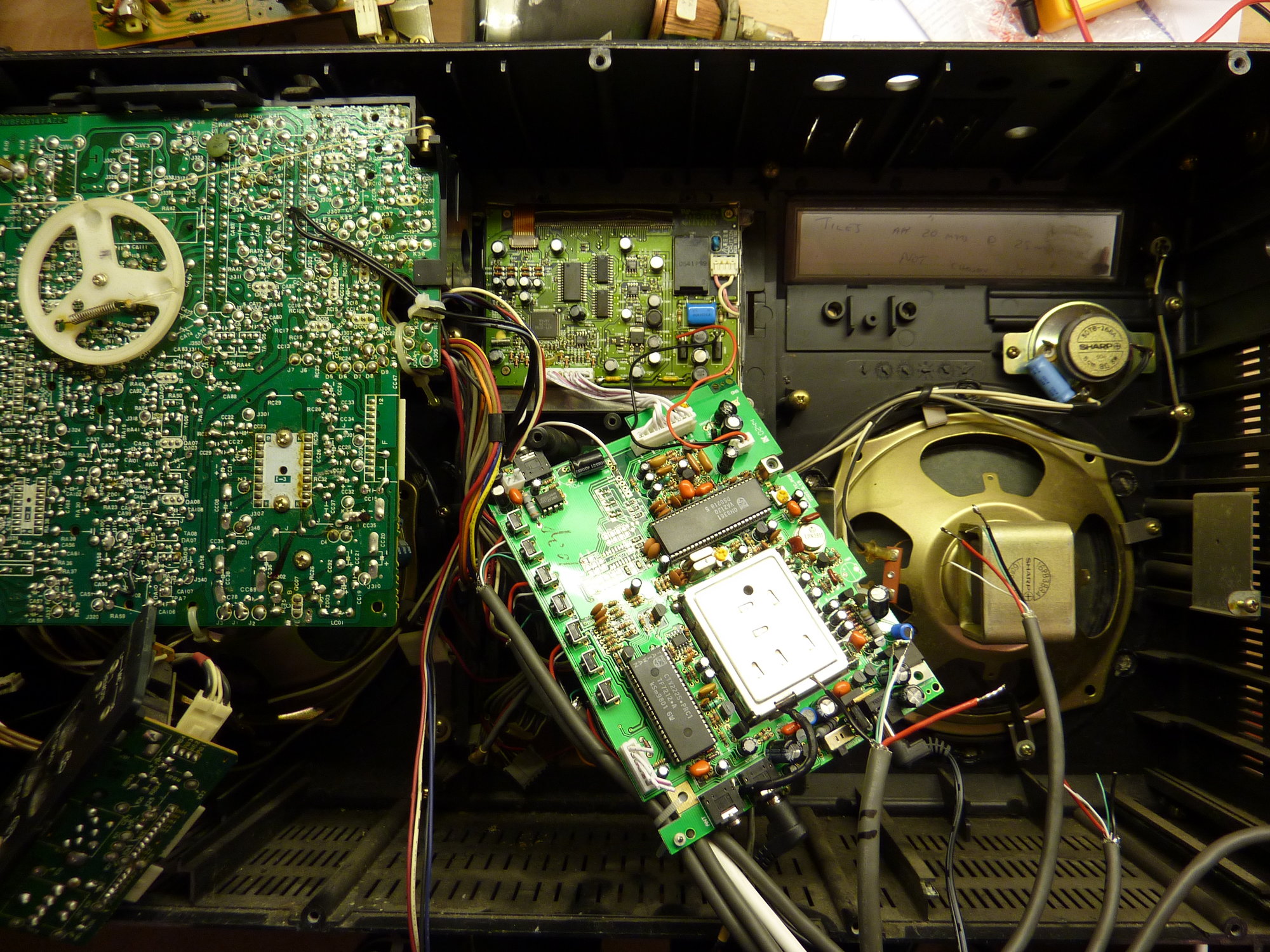

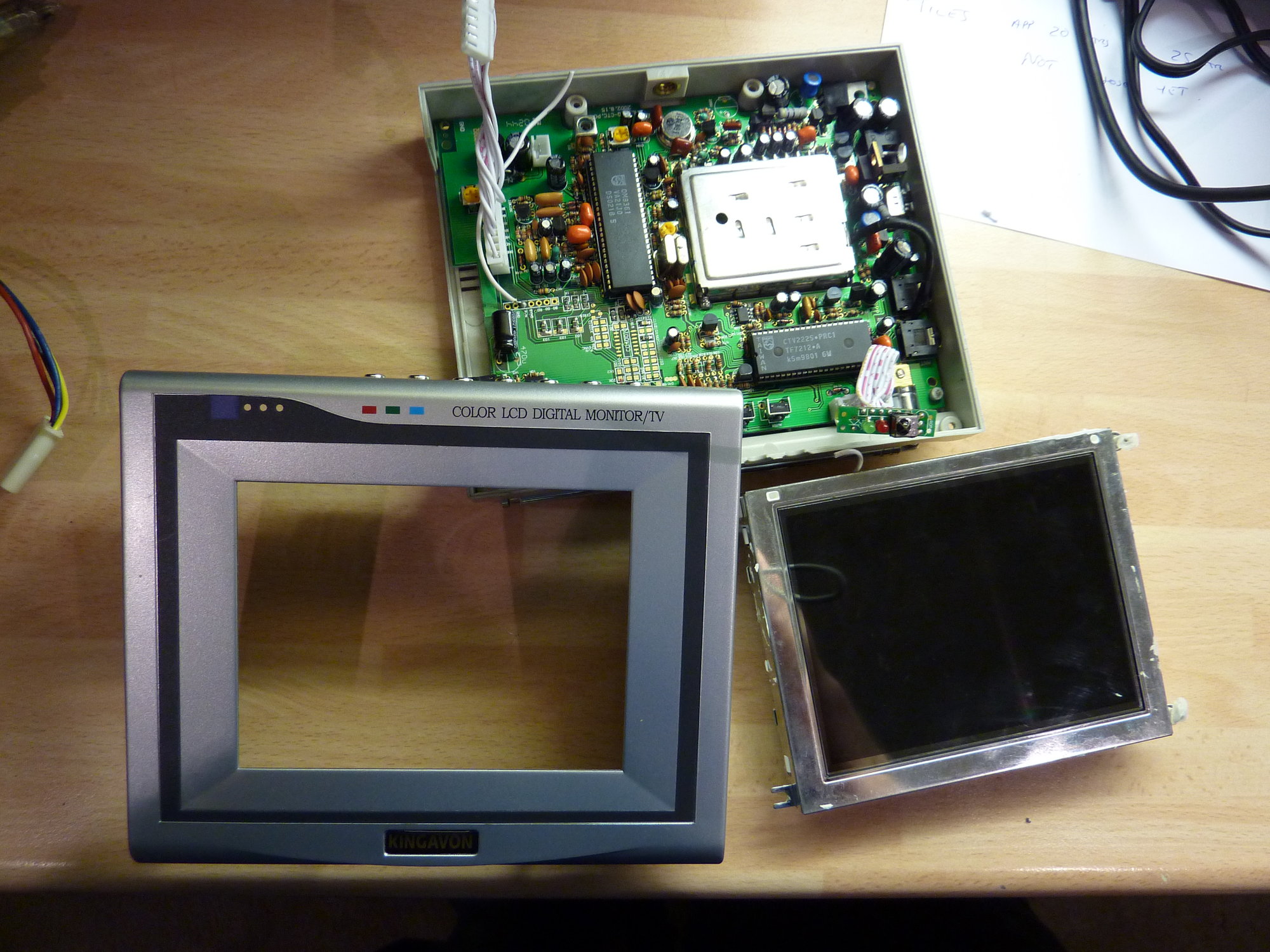

    As requested by a member, here is the conversion i carried out to put an lcd screen in a tv box
    P1010447.JPG P1010448.JPG P1010458.JPG P1010459.JPG P1020019.JPG P1020021.JPG

    As requested Davebush delivers!
    What are the small lights on the side?
    What screen did you use to fit?
    Any other alteration you made?
    Thanks for taking the time showing us rookies.I feel loved in this forum!:worship:

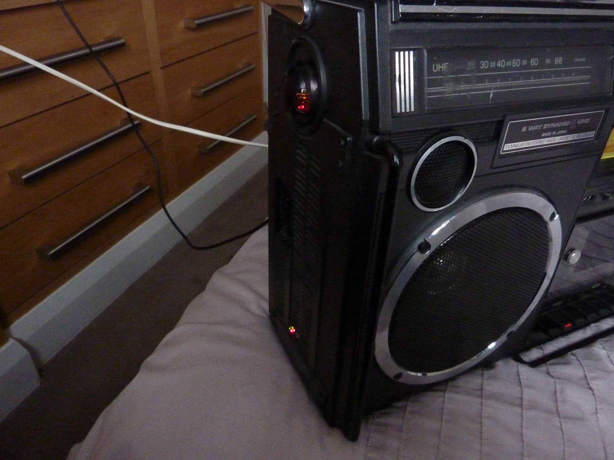

    lights on the side is the pickup for the remote control i think....not looked at it for about 4 years

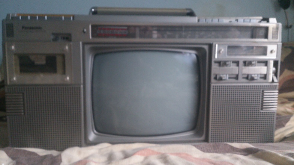

    Could you do a similar conversion to a machine with a bigger screen?, i.e., I just came by a Panasonic TR1200G which has a 12" b/w screen, it could also do with some means (Scart?) of playing video/DVD through it as the 'Ant' socket doesn't work for this. Such a conversion might even make the unit lighter in weight if it's just a flat board rather than the deep tube.

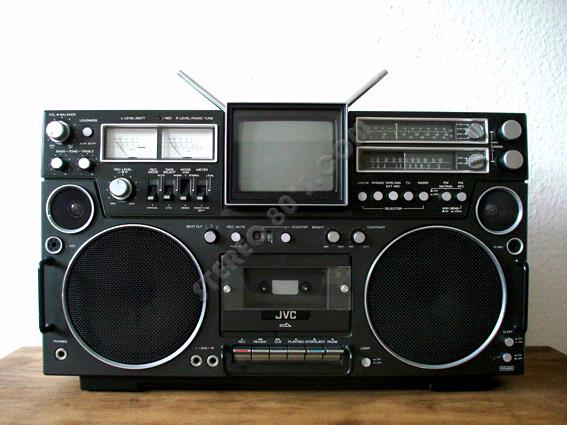

    I would guess you would have plenty of room for an LCD conversion. I have looked at doing this with a JVC Videosphere (it has been done already). https://forums.bit-tech.net/showthread.php?t=141687
    The two main problems are finding a TV with the right size panel, and the fact that the LCD panel will be rectangular rather than CRT tube shape. Most conversions seem to end up with a smaller panel and some kind of bezel to fill the gaps.
    I've already got the VCR/DVD recorder so that's not the problem, getting it to play through the TV on the box is so where do I get the modulator from and is it an external device?, I got the VCR/DVD from Hughes Electrical back in November but not having a TV I was hoping it would work through the computer, that wasn't to be so I set out to get a portable TV and thought one in a ghetto blaster would do nicely.
    The Panasonic TR1200G all works, radio, cassette and TV but can't get anything on the TV for obvious reasons - it's analogue so what Dave did with one would be ideal for mine except this one is four times the size and weighs 13.9kg at the moment on my LCD bathroom scale. A 12" screen is easier to watch than a 3", lol, I'm nearly 60. There's a bloke here who does TV repairs, I don't know if he could do the conversion to digital, LCD and colour is not over important, would just be nice. There was a Sharp 10P35H on eBay but they wanted a monkey for that, I got this one for £58 including postage - BARGAIN!

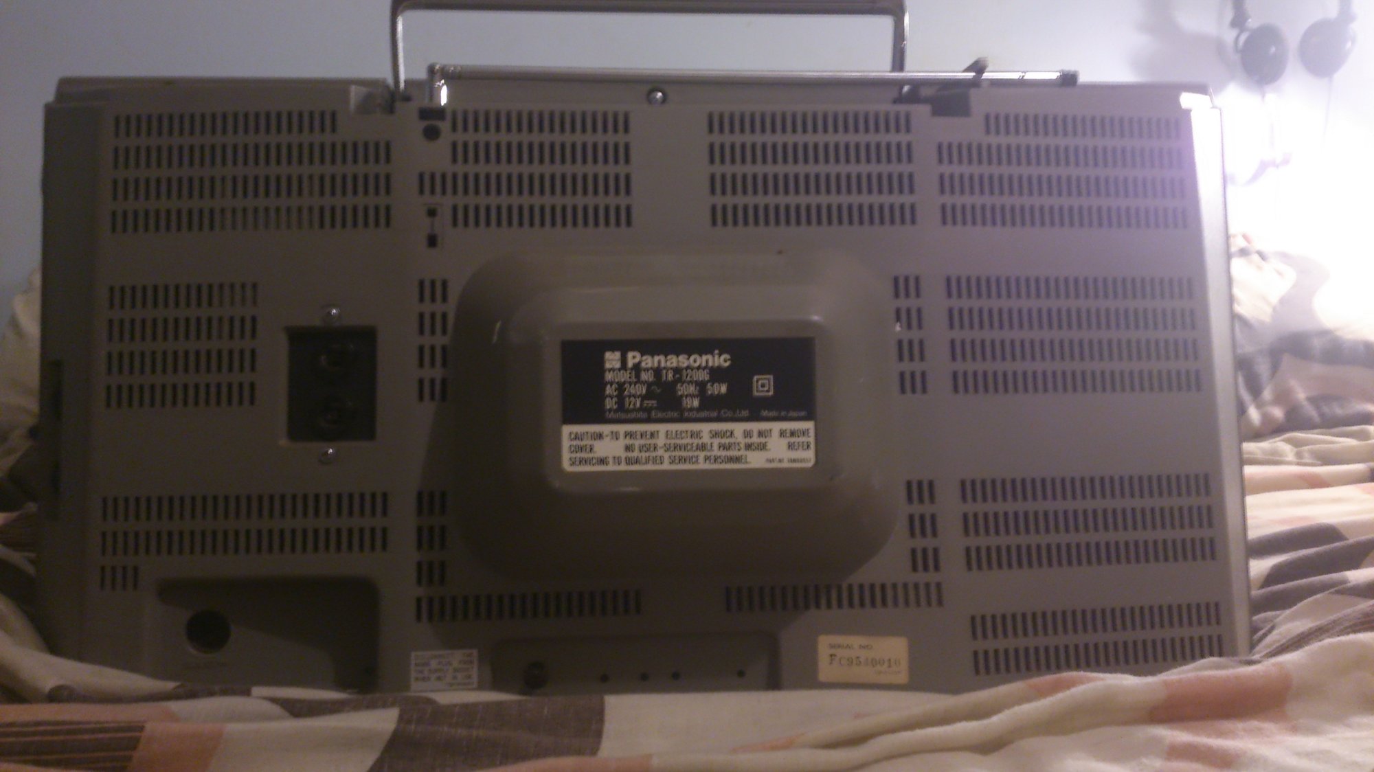

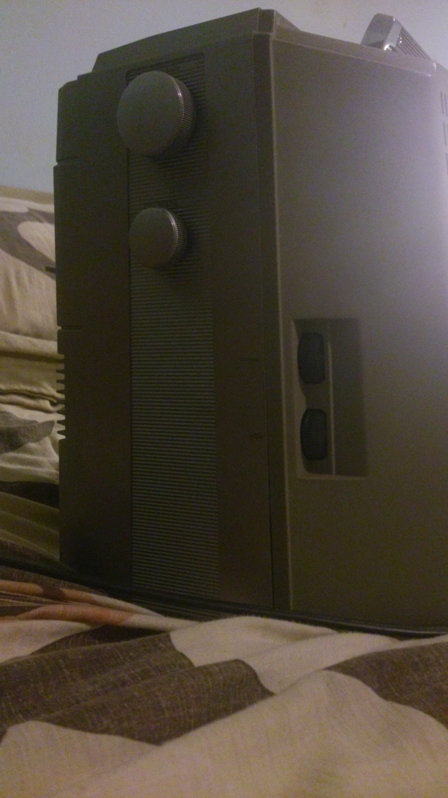

    Did you upload pictures of what you're talking about?, if so I don't see them ("The first modulator I showed"), I'll upload other elevations of the machine so you can see all the connections it's got.
    of Panasonic TR 1200G left rear.JPG Panasonic TR 1200G rear.JPG Panasonic TR 1200G side sockets.JPG
